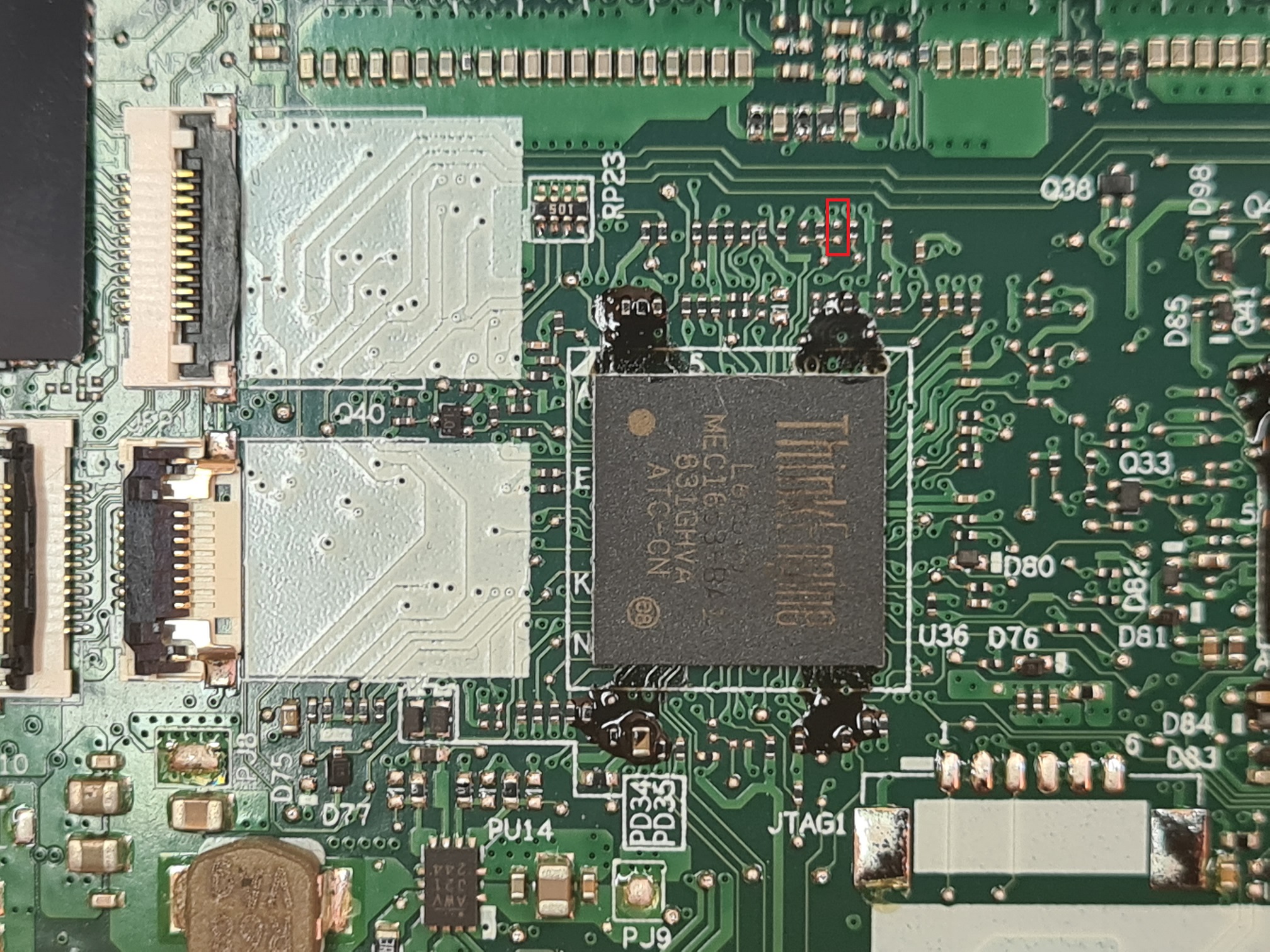

                      #190
                      Re: mec 16xx dump with info block
                      P52 has mec1653, jtag pins are same as other thinkpads.
                      did put the pull up resistor for reset , but Vertyanov_JIG gives error.
                      did anyone managed to read the eprom from P52

                          #192
                          Same here. Everything look good but unable to read data.

                            #193
                            Assuming everything is OK, I suggest to take a look at motherboard schematic, check JTAG interface, you will see each signal has a PULL-UP resistor which are not populated in motherboard.
                            Now check the programmer to see if it has these PULL-UP resistors on JTAG signals.
                            You may have to add these PULL-UP resistors to motherboard JTAG signals for programmer to work… worth a try.

                              #194
                              You don't need a resistor, just jump and read it, if you couldn't read it, you can extract the EC from the original file and then just flash the MEC16xx, nothing more than that. After the procedure you will have to write all the machine information such as the serial number of the machine board and a few more things. Some machines can't read the MEC16xx just write, I had this same experience on a T14 thinkpad, I discovered it after 3 weeks of attempts, so I just wrote it I used the same way I described it above and then I was successful.

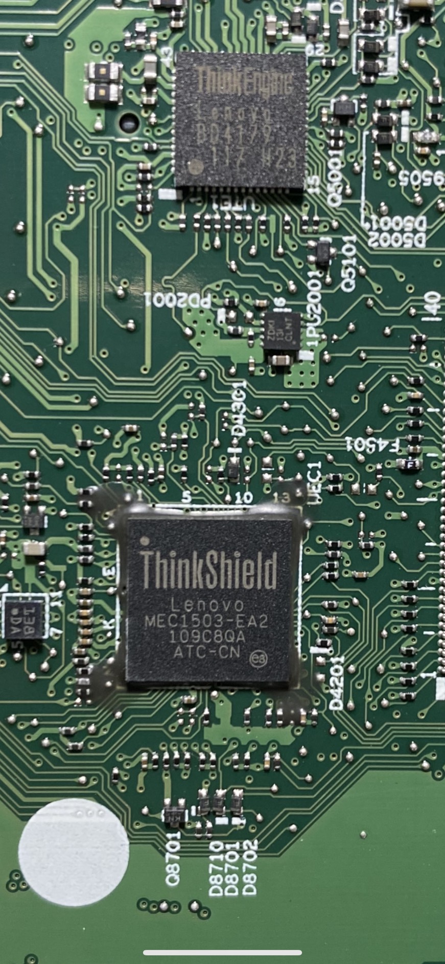

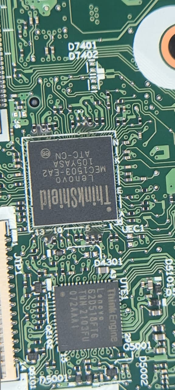

                                  Thinkpad T15 g2 ... SIO MEC1503 jtag pinout .... help me !! thank all !

                                    #197
