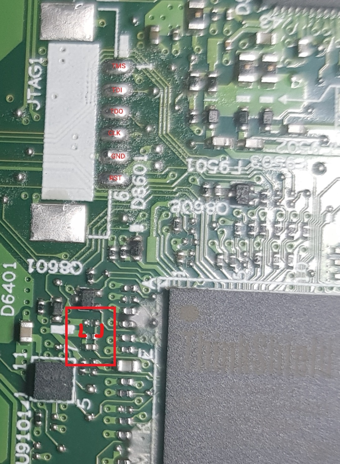

      In X390 i have same result. I try read / write was errored veryfi and different file. But when i extract EC from .exe and try again was upload succesfull and laptop working. Now i try same in T490 but still same errors with read chip (with error, i read X time and all file are simillar but different in HXD and when write chip i have same - error veryfii.
      I have resistor 10k in PIN 1, 2, 3, 4 , 6 ? Good ? in schematic yours i dont see resistor on pin 6?
      And the second question i take 3.3 V from this motherboard ? is good ? or i need supply 3.3 V from other source ??
      I put AC adapter to motherboard - is good ?? or i should use 3.3 from other sorce and should be enought?
      I have RT809H programmer also and is same result like in svode but in svod 1 times works on X390 lenovo.
      edit. i was find schematic for T490::
      So in this case i need only 1 resistor 10k for pin 6 ?? and put only there 3.3 V ?? i good understand ? ?

        Question1: I have resistor 10k in PIN 1, 2, 3, 4 , 6 ? Good ? in schematic yours i dont see resistor on pin 6?
        Answer: Pin6 has a 49.9 Ohm resistor to +VCC3M.
        Question2: And the second question i take 3.3 V from this motherboard ? is good ? or i need supply 3.3 V from other source ??
        Answer2: Pin6 is connected to Vcc through a resistor, you can get +3.3 from this other point where the 49.9 resistor is connected to.
        For X390 you can program using keyboard connector, thorugh FPC cable.

          - Now i use direct connection - i don't have resistor etc... programmer detect ID. I can read / write but all read / write are corrupt. When i read and compare i don't write all information or have different in many place.
          When the motherboard is connect to AC - on pin 6 i have 3.3 so i think i don't need take from board and other source next 3.3 to this PIN. (in this case) like on schematic ??
          I try 3-4 different type of cable and i have same result in SVODE 3 and RT809H programmer.

                        No PULL-UP resistors to JTAG signals needed or 3.3v power suply as pin 6 has 3.3v only connect direct to svod3 all 6 jtag pins.
                        PULL-UP Resitor must move to PULL-DOWN like attached photo and put back after every step.

                          I just moved reset signal resistor and used keyboard connector to do all the programming. Worked well.
