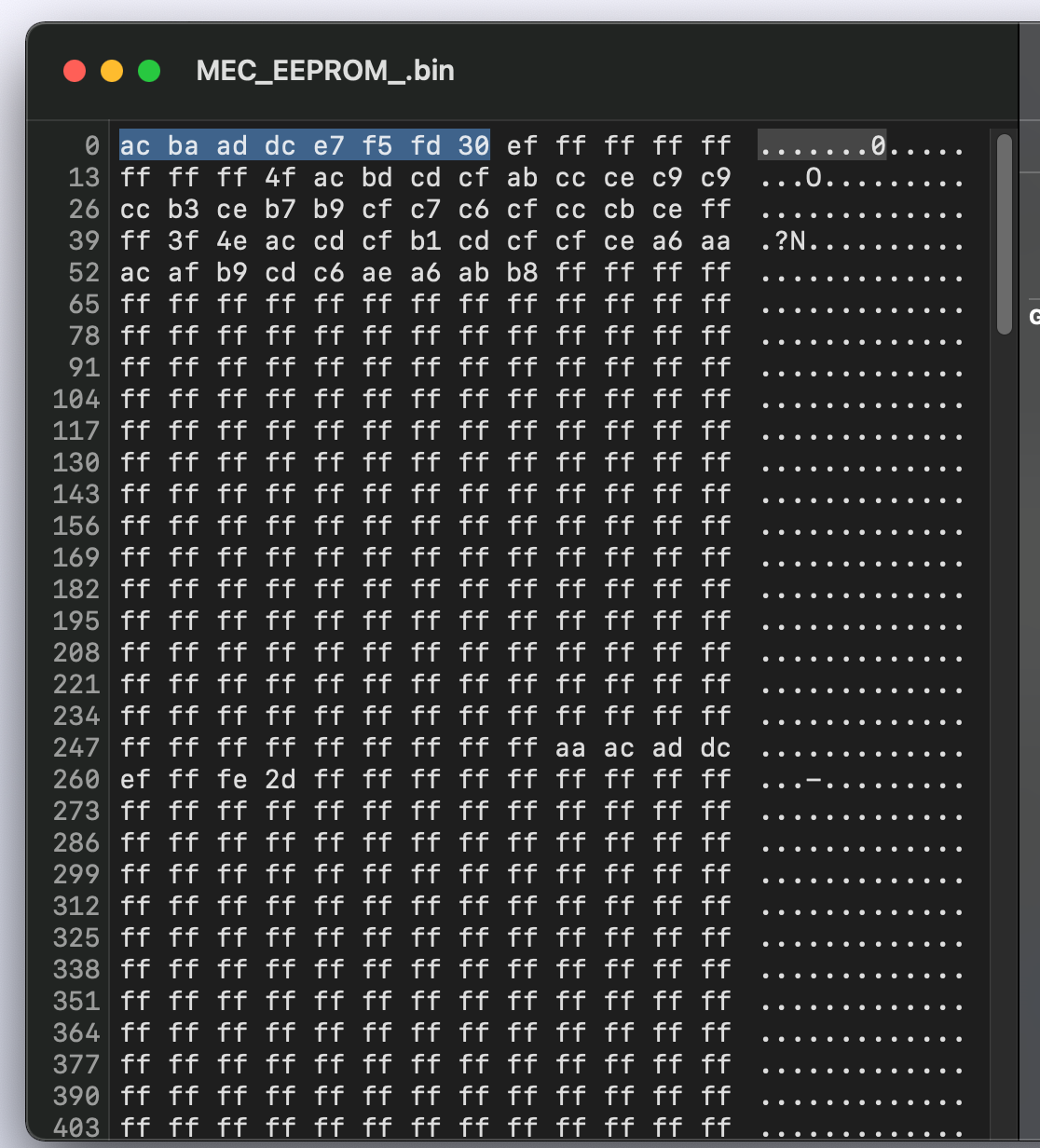

                    I think in my case (Thinkpad T490) the password stored in the first block of EEPROM because when I try to fill the first line with FF I can go to the BIOS setting but with serial number invalid.

                      Try this.

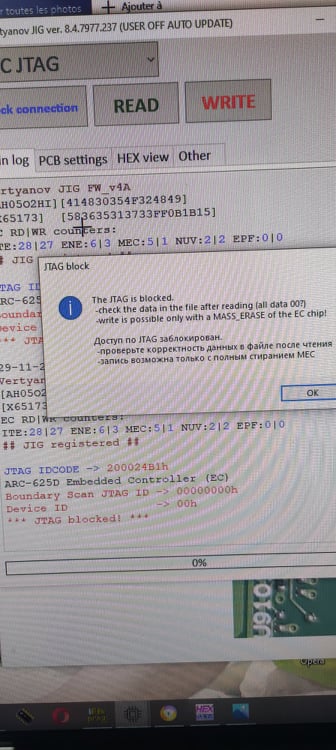

                            Re: mec 16xx dump with info block
                            Thinkpad X13 with password
                            vetyanov gives me this message
                            what will i do please ? erase chip?

                                  I guess I have said many times here already. You have to move the jtag reset resistor in any case.

                                      There is an instruction in the program directory, study it carefully and there will be no more questions like this.
                                      Without reading this manual, you will not be able to use this programmer ...

                                        i tried vertyanov for some others model like T490 with success Bro
                                        read and whrite good
                                        but in this model i used RT809 also i read the the mec but empty without data
                                        also with vertyano gives me message like photo before
                                        Thnks for your answsers

                                          If you have blocked jitag, then you will not be able to read it. First, you need to completely erase, and then write the firmware there in turn, and then eeprom.
