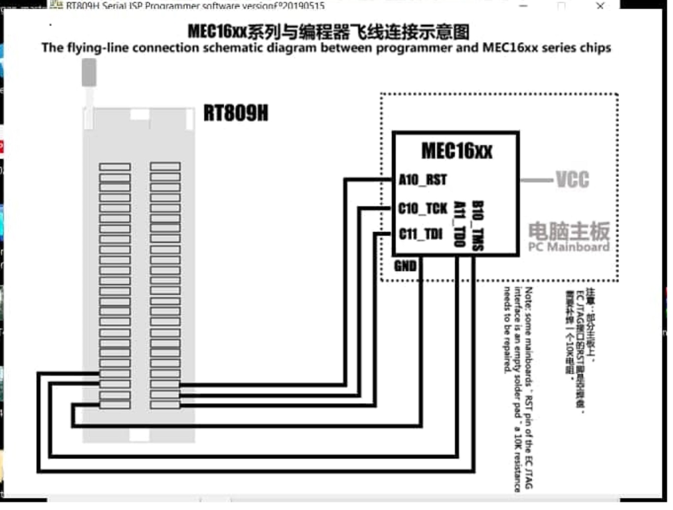

          Hi! Can u plz help me? I'm trying to read MEC1663 from a T590 and used the pinnout posted earlier...moved the 10k resistor and i always get MEC Chip ID: 0xFFFFFFFF
          042: ID verification error.
          I'm using a RT809H

            Hi guys. Still no luck with the MEC1663 from the T590 NM-B901 board. I am using a RT809H on the JTAG but there must be something that i'm doing wrong. I've tried the pinnout from post #31, moved the resistor but i always get Chip ID error.
            I assume that the CLK signal goes to TCK pin on the RT809H..or?
            Anyone that managed to read the MEC with RT809H programmer to explain the steps?
            Any help or ideea is apreciated.

              this is the pin to connect to the programmer

                Have you added the 10k PULL-UP resistors to the JTAG lines? Check a ThinkPad schematic EC/KBC JTAG interface.

                  select MEC1653 from RT809H List, connect the charger and read the chip it should be 290kb.
                  Erase the chip and write the File back
                  (done 2days ago)
