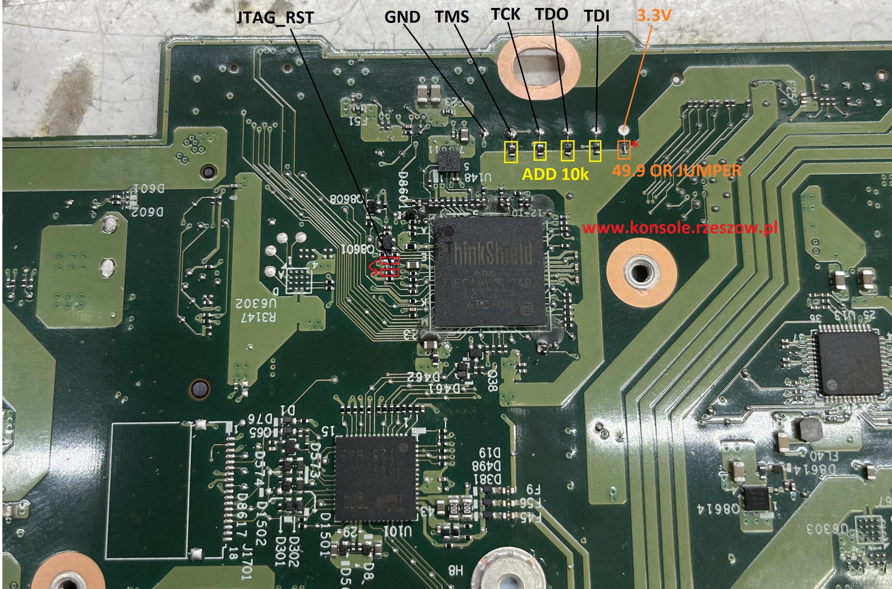

          #204
          Re: mec 16xx dump with info block
          Pinout to:
          X1 YOGA GEN5
          CARBON X1 GEN8
          mobo: GX4A0 GYG50 NM-C881 REV:1.0

            #205
            Originally posted by EvilBzyk
            Pinout to:
            X1 YOGA GEN5
            CARBON X1 GEN8
            no need add 1OK and Jump
            tested and it working

                                • couillu76
                                  • Jan 2022
                                  • 39
                                  • United Kingdom
                                  #216
                                  hi Ghamidi
                                  so no need 10k
                                  i need to solder 3.3v from my svod
                                  and just to be clear tck and clk are same?
                                  thanks

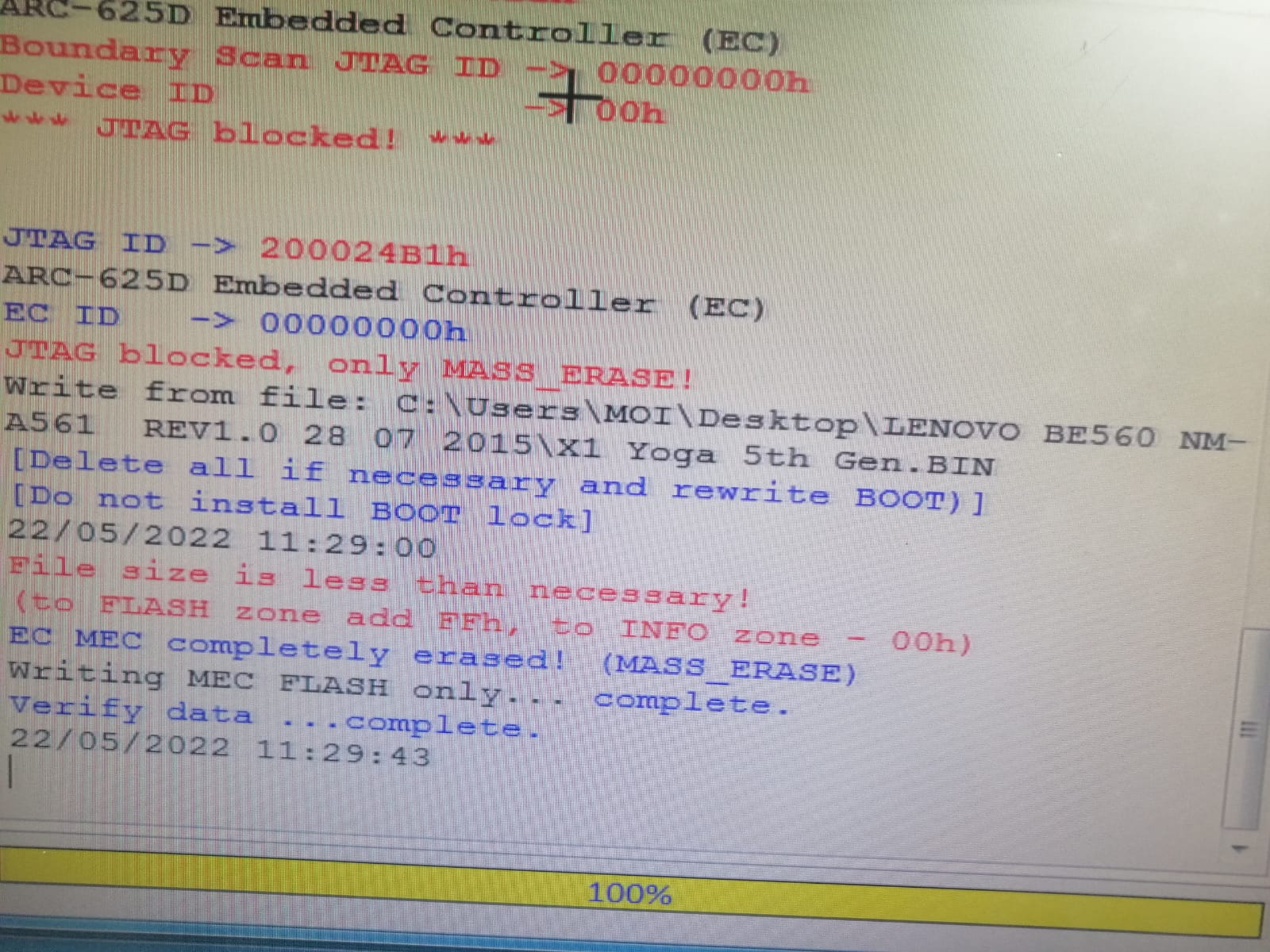

                                      #218
                                      so i try to read the mec of my yoga x1 g5
                                      and this what i have with the svod4
                                      MEC IDCODE: B1240020
                                      Device ID: 0
                                      Device Revision: 0
                                      Device Status: 0
                                      Flash Status: 0000000000
                                      Boot Block in not protected mode
                                      Flash Configuration: 0000000000
                                      what im doing wrong?

                                        #219
                                        what programmer u using ?
                                        Device ID: 0
                                        Device Revision: 0
                                        Device Status: 0
                                          • 21583
                                          #220
                                          svod4
