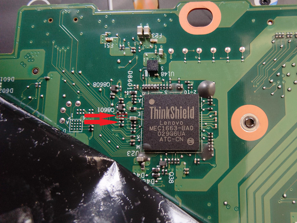

    Hi!
    I have a ThinkPad X270 with a bricked EC image after a bad flash under Windows, I have a svod4 programmer but I can't seem to be able to read the MEC1653, I tried using the 32-pin keyboard connector after taking out R182 but I still can't read it, is there any test points I can use to hook it up directly? I'm a bit confused after reading the whole thread...

      make a clear photo of your board near EC and model of board

        Here you go, NM-B061 Rev. 0.4

            Also, can somebody tell me which one is the 10k resistor? How do you take it off and put back in? Do I have to solder it back in? Thanks

              You don't take it off, you move it to the correct position. By soldering.

                Any idea which is the 10k resistor to move? Cheers

                  measure this one, if 10K, then it must be that

                    Thank, when I tried to measure it, I just realised that this maybe out of my league. The actual resistor is so small compared to the photo. I may not have the right tool to do that.
                    I'll see if my mate can help with that. Thanks.

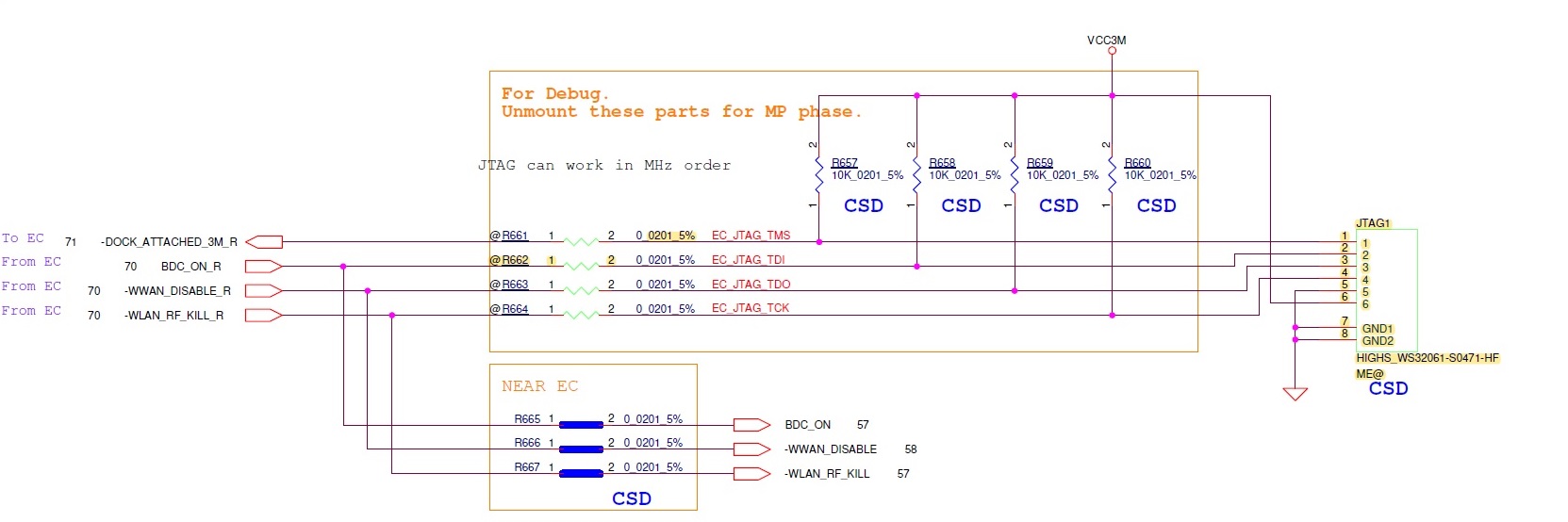

                            I want to share my 1st experience with MEC1663 from Yoga X1 4th gen.
                            Many thanks to AAAC, RethoricalCheese, EvilBzyk, their shared knowledge helped me a lot.
                            1. Connected jtag pins as in picture, no pull up resistor needed. Moved 10k resistor from pull-down to pull-up. Chose MEC1633#ISP. power on motherboard.
                            2. Got message "Chip may be damaged or encrypted, the data is not valid" I did try other options, MEC1653#ISP, MEC1633_256k, same result.
                            3. I hit "Erase" and laptop stops working, no power on/charge led lit.
                            4. I took EC file from bios update and trim 32bytes, the same version it was in bios (I took a photo of info in bios before pulling off the motherboard) wrote the file into EC then power off motherboard. Waited few minutes an power on motherboard, power on/charge led lit. Moved the 10k resistor to pull down.
                            5. schematics IS WRONG! TP1 IS REVERSED WITH TP5.

                                Hi Please Help me Lenovo P52 EP520-NM-B562 Rev 1.0
                                Pull up resistor place? R577 replace R600 ?
                                JTAG enable short 0 ohm resistor R661 R662 R663 R664 ?
