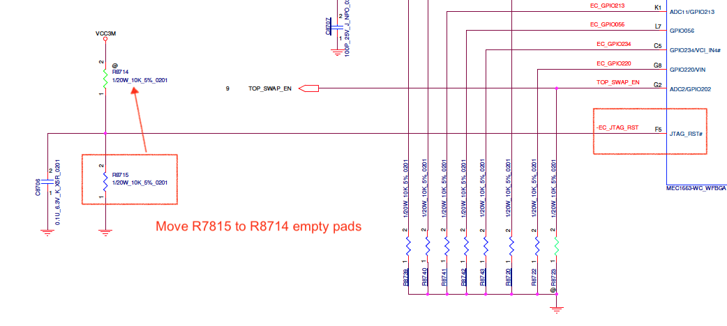

            Originally posted by EvilBzyk
            Pinout to:
            X1 YOGA GEN5
            CARBON X1 GEN8
            mobo: GX4A0 GYG50 NM-C881 REV:1.0

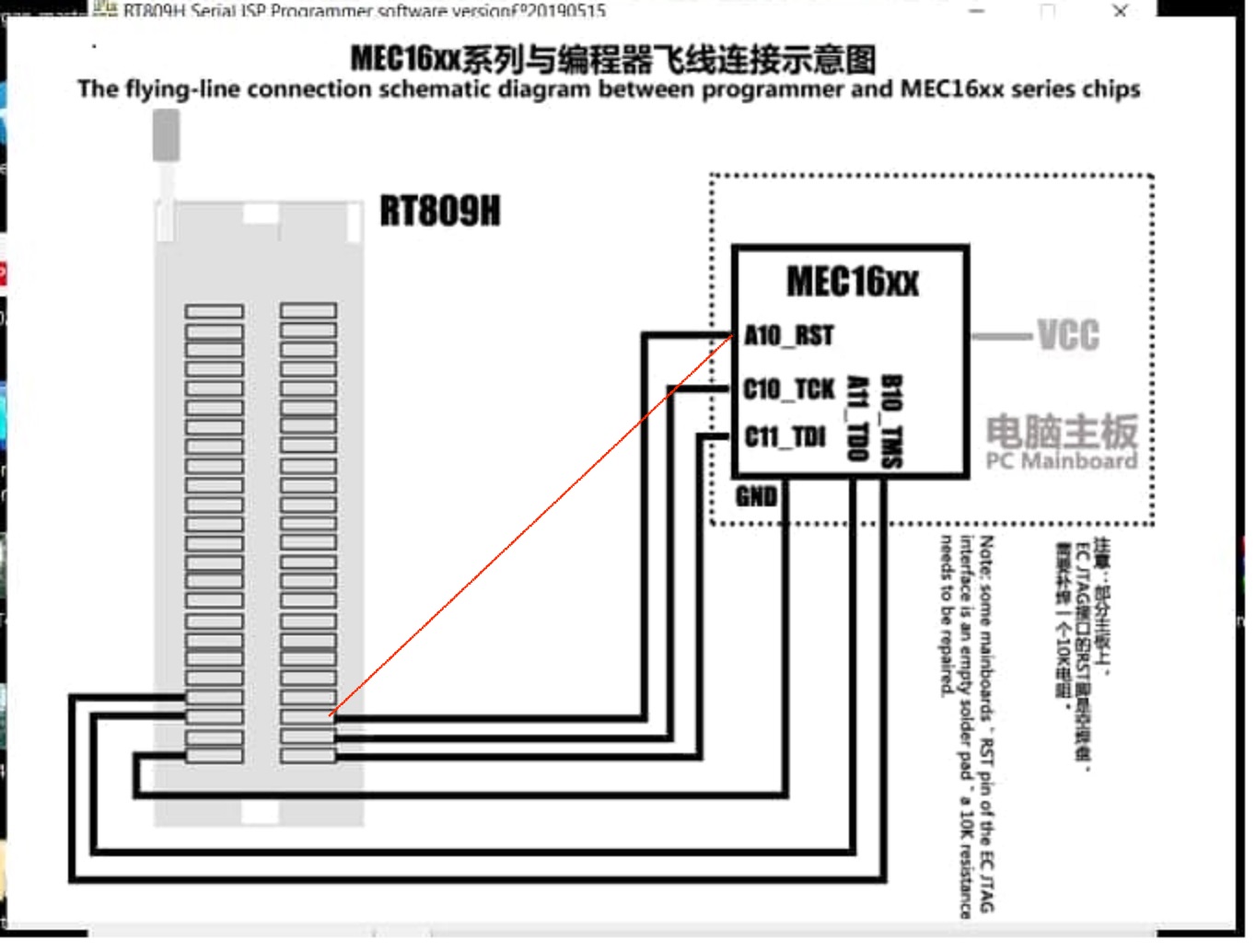

            Hi, tell me where you solder RST wire - pin 7 to RT809H? Thank you.
            • RethoricalCheese
              • Mar 2013
              • 1519
              • Estonia
              #226
              Re: mec 16xx dump with info block
              You dont. You just need to find reset resistor and solder it from pull-down to pull-up.

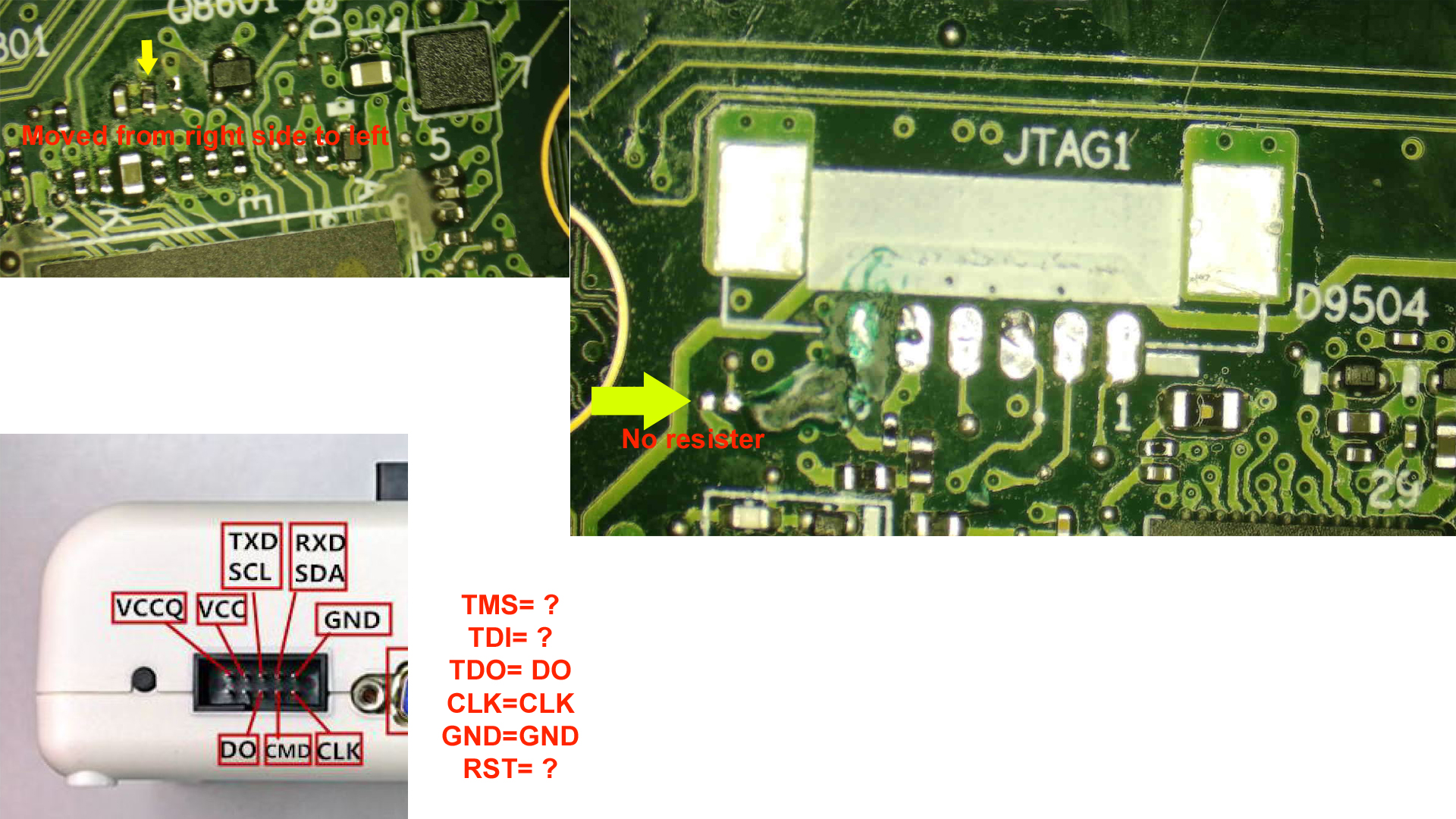

                            #233
                            Can Someone please explain me how to read the mec properly
                            as i used the isp pins from the top area but it gives error MEC Chip ID: 0xFFFFFFFF. 090: ID verification error.
                            but if i use the isp colorful cable then can someone explain me which pins are TMS, TDI, RST on Rt809h plz see the picture
                            also i moved the resistor now to left side is this okay ?
                            also pin no 6 there is no resister can i remove from the same board from other location and use here if i really need to ?
                            will appreciate your time as i have spent hours and got nothing i am first time using rt809h

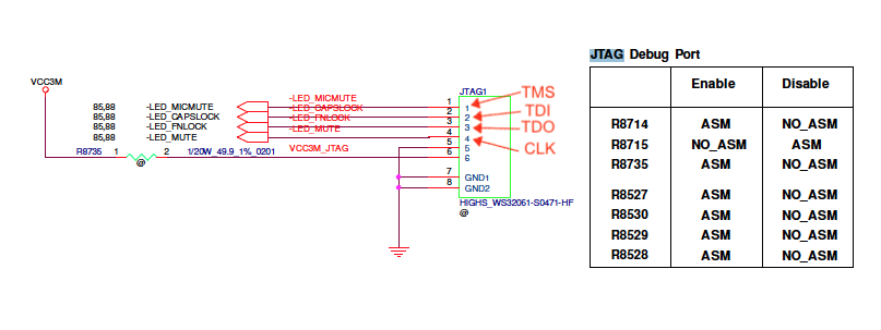

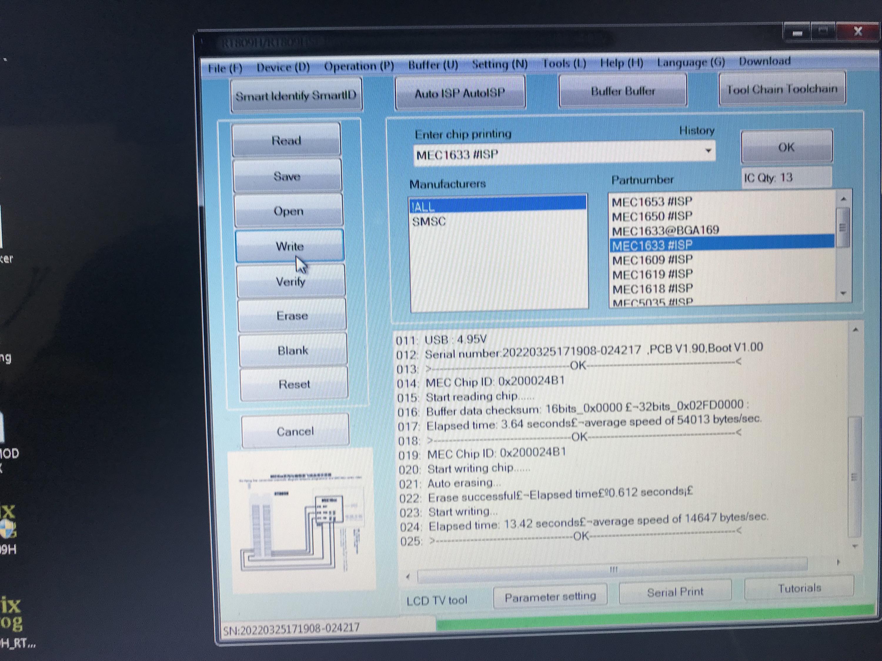

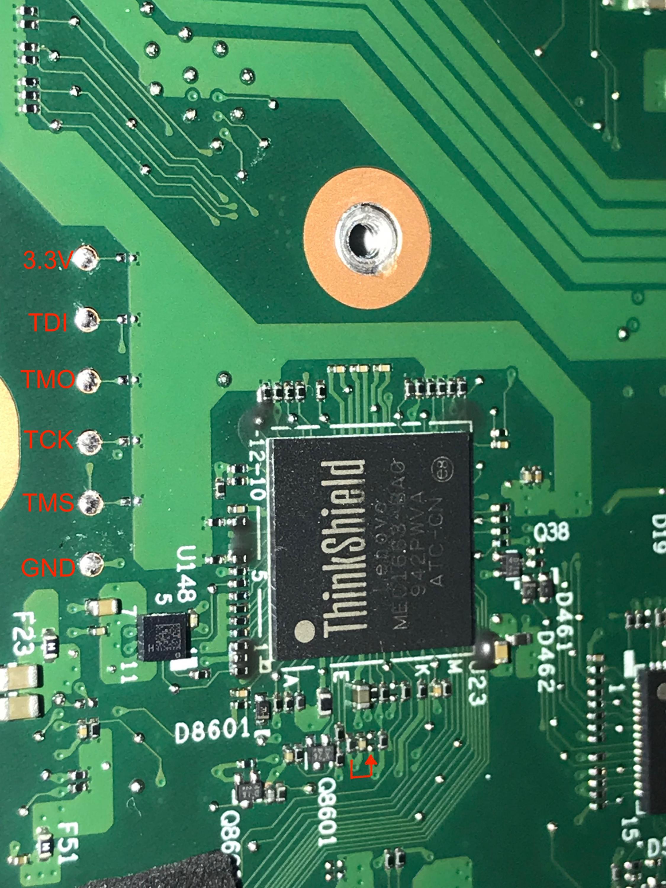

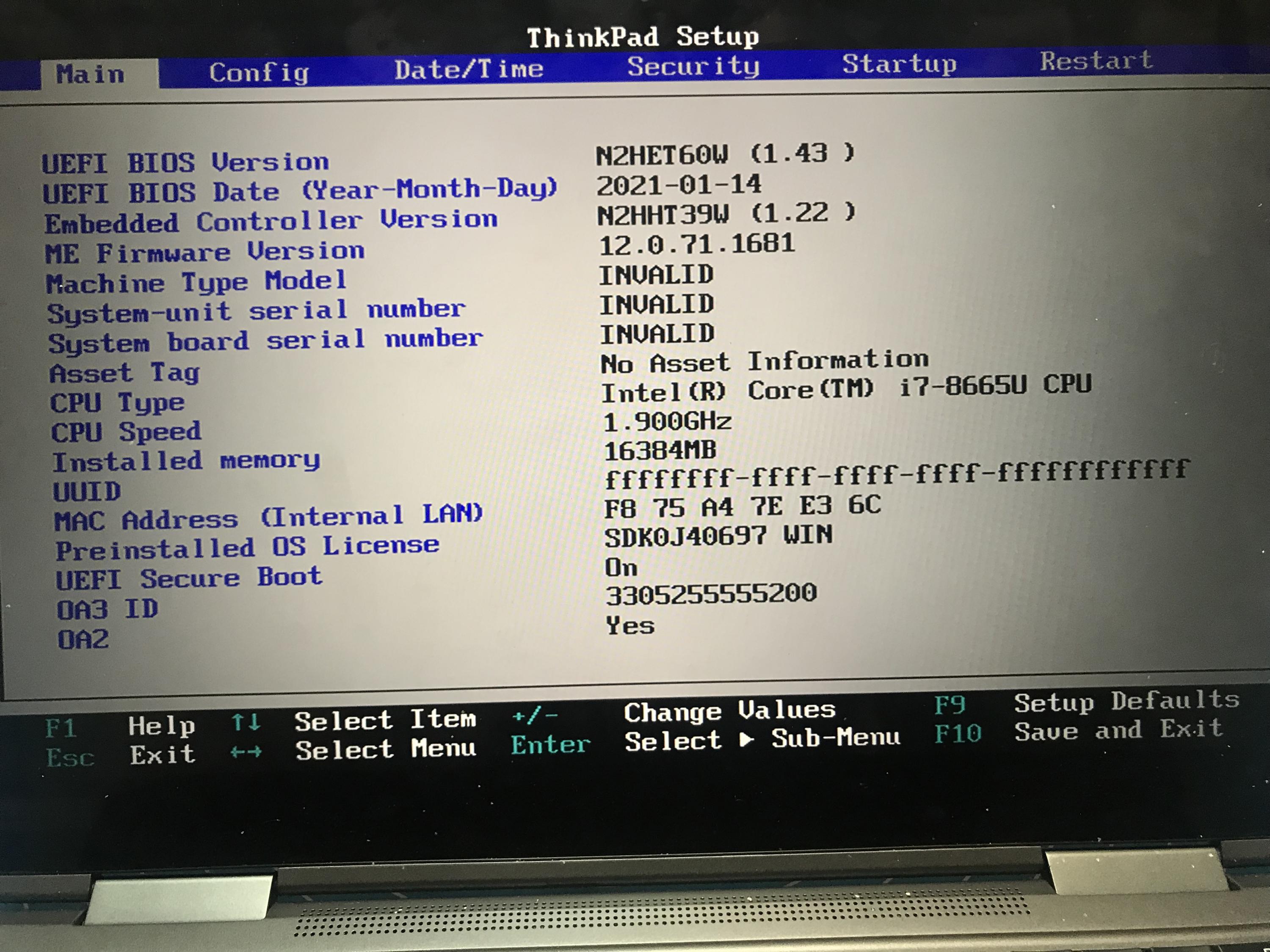

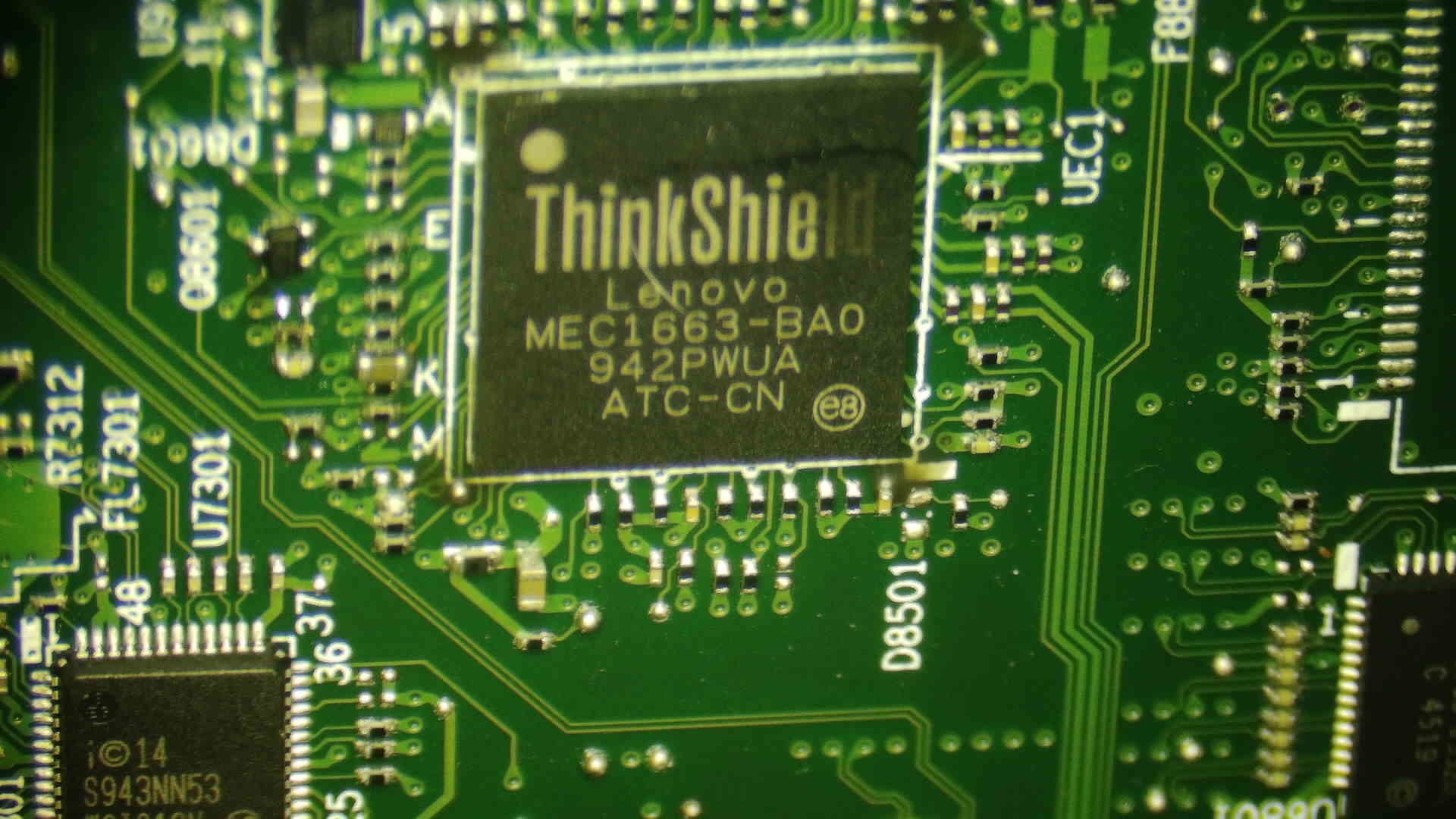

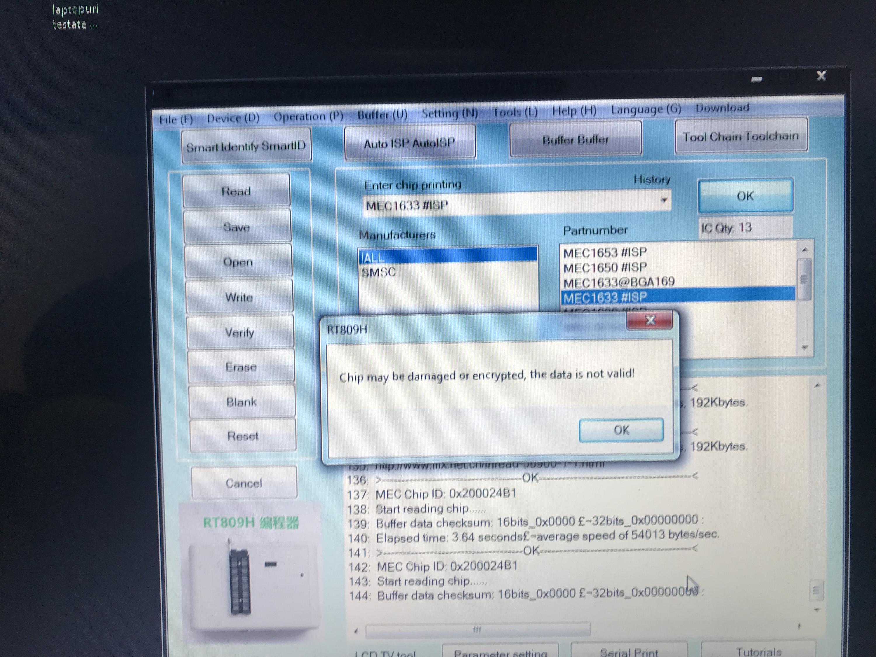

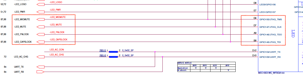

                              #234
                              I want to share my 1st experience with MEC1663 from Yoga X1 4th gen.
                              Many thanks to AAAC, RethoricalCheese, EvilBzyk, their shared knowledge helped me a lot.
                              1. Connected jtag pins as in picture, no pull up resistor needed. Moved 10k resistor from pull-down to pull-up. Chose MEC1633#ISP. power on motherboard.
                              2. Got message "Chip may be damaged or encrypted, the data is not valid" I did try other options, MEC1653#ISP, MEC1633_256k, same result.
                              3. I hit "Erase" and laptop stops working, no power on/charge led lit.
                              4. I took EC file from bios update and trim 32bytes, the same version it was in bios (I took a photo of info in bios before pulling off the motherboard) wrote the file into EC then power off motherboard. Waited few minutes an power on motherboard, power on/charge led lit. Moved the 10k resistor to pull down.
                              5. schematics IS WRONG! TP1 IS REVERSED WITH TP5.

                                don't use flashing port, use info from posts #46 and #31. don't wire #RST, just move 10k as in photo. You have to power on the motherboard to have 3.3V to feed EC.
                                • myjunaid
                                  • Nov 2019
                                  • 32
                                  • Spain
                                  #236
                                  you mean 10k resister on pin 7 line as in pictures
                                  also where can i get the 10k from the mainboard to do the job once done i can move back is that ok
                                  you can tell me the resistor number i have boardview i will find it

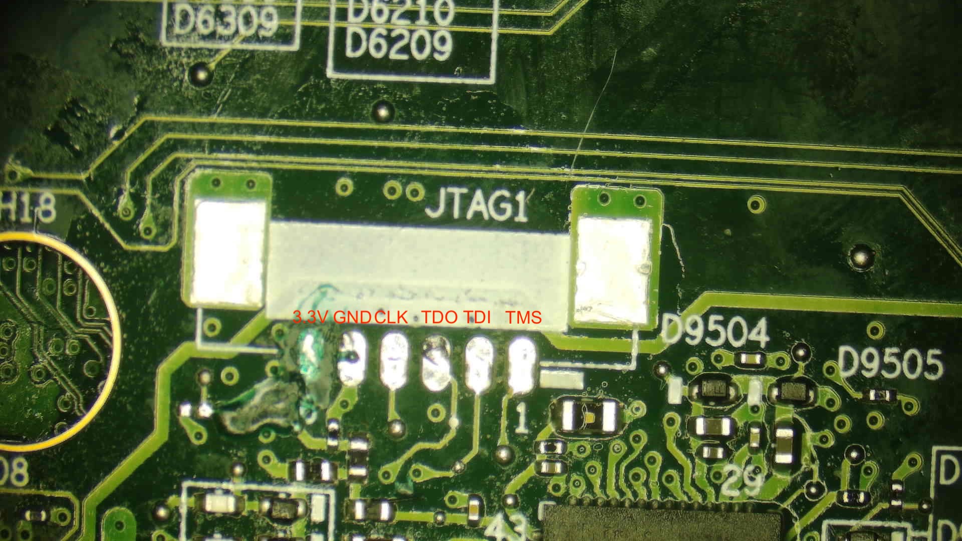

                                  • volinakis
                                    • Jan 2021
                                    • 2871
                                    • N/A
                                    #237
                                    No, RST resistor for MEC16xx as shown in picture of post #31. Don't wire "pin 7 line" #RST of programmer. Read previous posts of the topic you'll find all informations there. i don't know your laptop model you didn't specify, pic from post #31 is self explanatory.

                                      i have done exactly how you asked me to but i am getting ID Verification error MEC Chip ID: 0xFFFFFFFF
                                      also disconnected rst still nothing
                                      my cables are also less than 10cm
                                      • volinakis
                                        • Jan 2021
                                        • 2871
                                        • N/A
                                        #239
                                        @myjunaid
                                        I hope you'll understand now.
