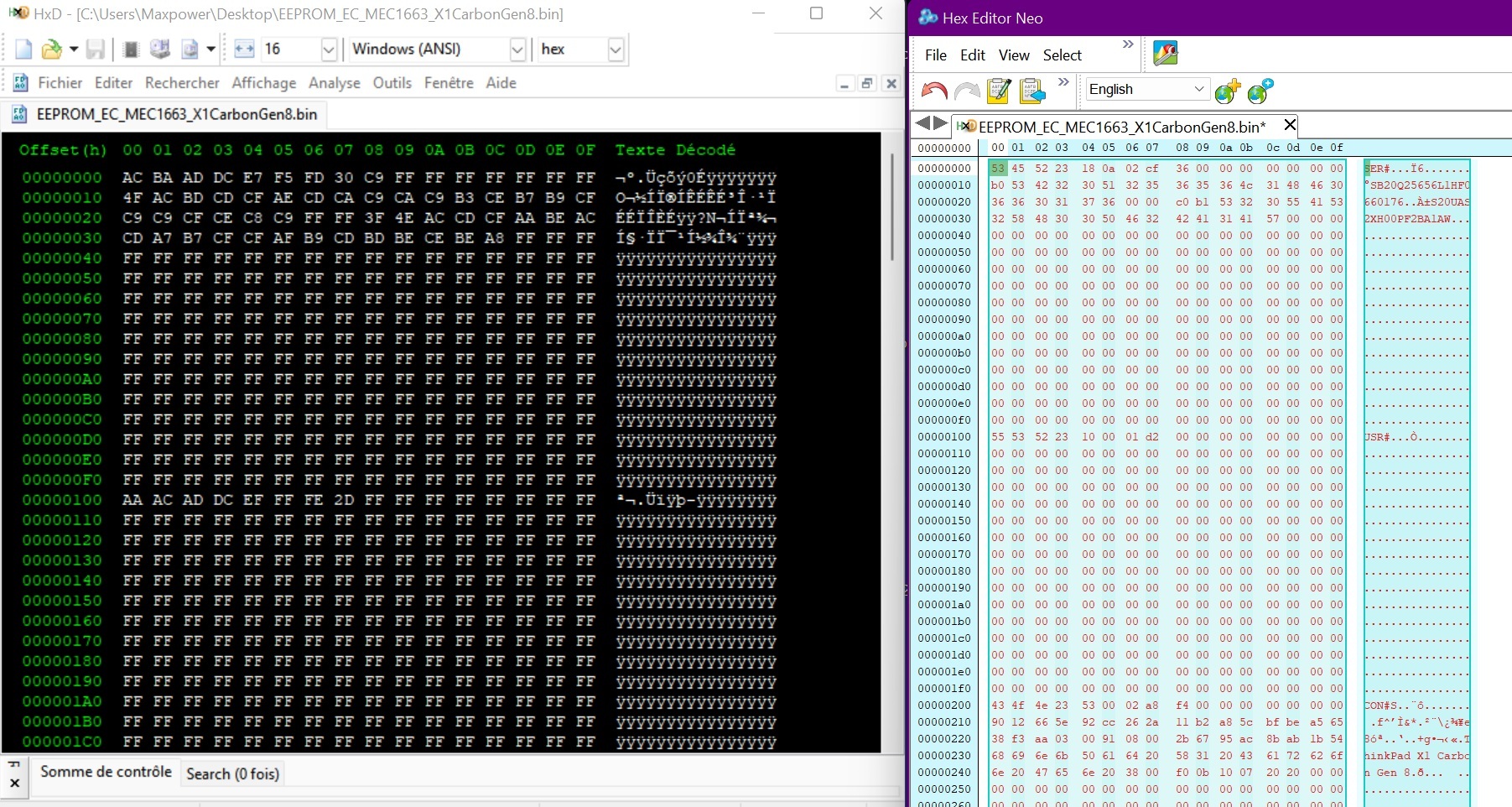

            I have read the EEPROM area of MEC1663.
            Where and how should I edit the BIN file to remove only the BIOS password?"
            Thank you in advance.

            #386
            X1 Carbon Gen8 20UA
            try

            #387
            Mec16 translated
            Click image for larger version  Name:	386453902_1041202147221888_1671781784116666234_n.jpg Views:	5 Size:	746.3 KB ID:	3162076

            #388
            Mec16 translated
            Amazing, how you pls translate this hex?
            • AAAC
              AAAC commented
              Editing a comment
              Just XOR the original file with FF(h), use an Hex editor that perform that operation.
              What's the value that repeats most? It's FF, so that's the value we use for the XOR operation.

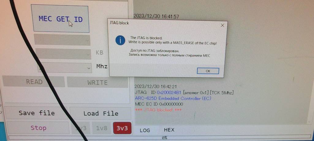

            #389
            Attempting to read MEC1663 blocks JTAG and prevents the read operation.
            s there a way to unblock JTAG and continue reading?
            Programmer:SUCCESSOR BASE2
            X1 Carbon Gen8
            20UA
            PF-1SJ5XP
            Click image for larger version  Name:	MEC1663.jpg Views:	0 Size:	52.1 KB ID:	3170421

              #390
              When tested with RT809H, all read data was zero.
              What is the difference between MEC1663 devices that are unlocked and those that are locked, even if they are the same model?

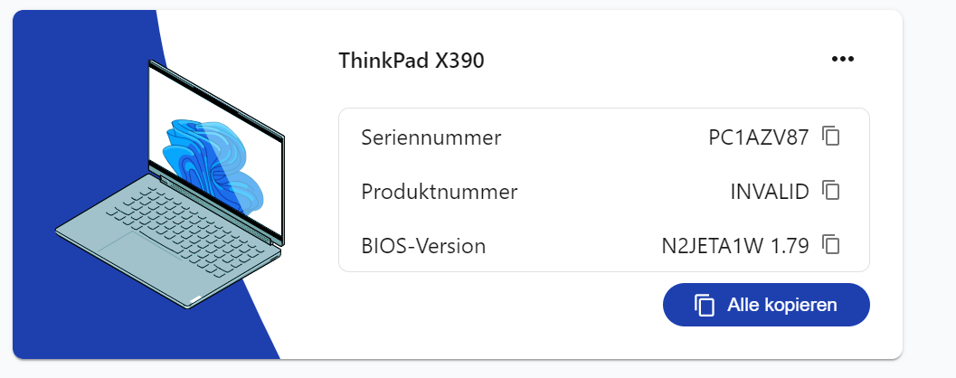

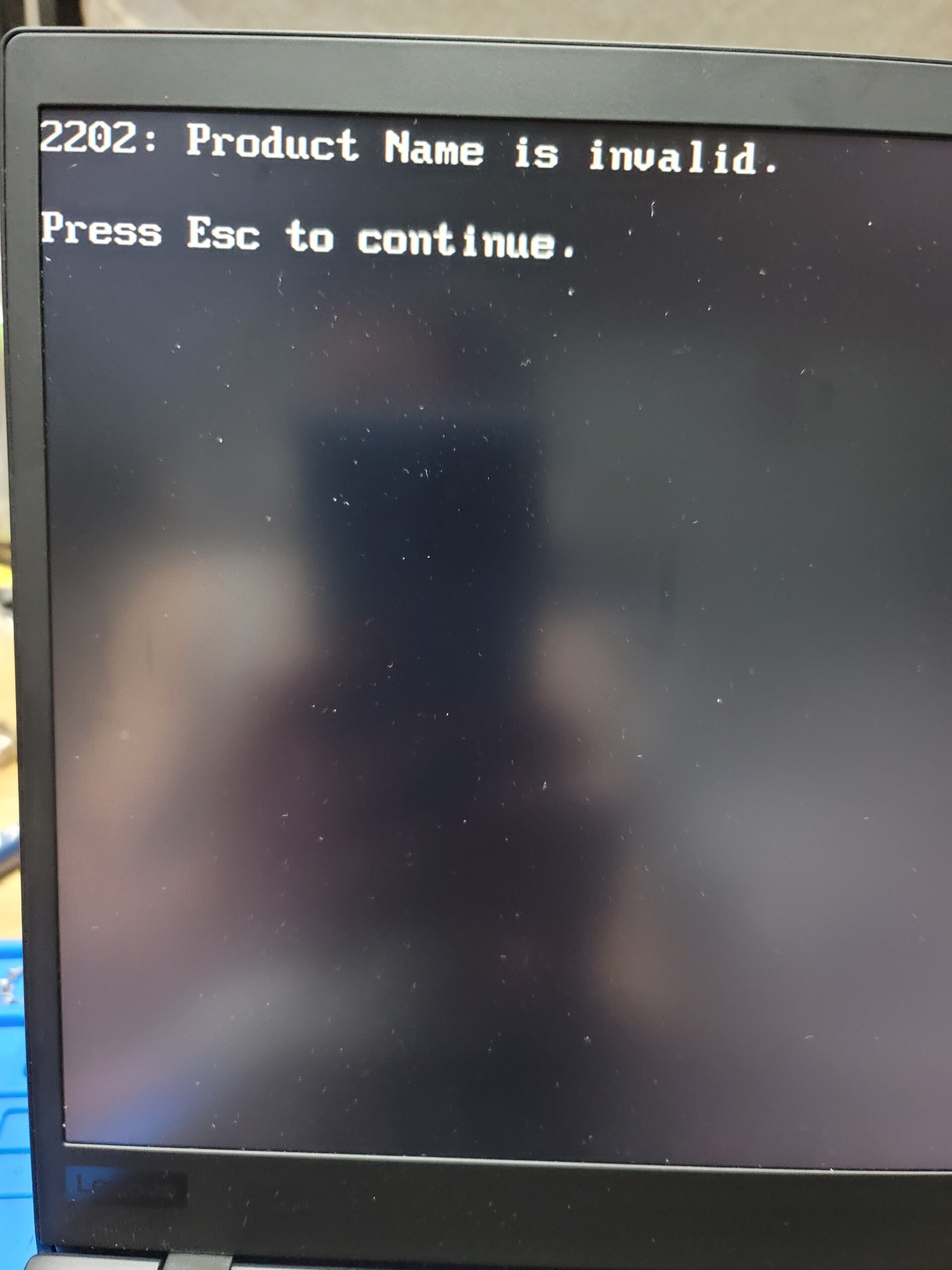

                #391
                Hello everybody, i successfully flashed the mec1663 chip of a lenovo thinkpad x390 (20Q1 Model) after the notebook wasn't turning on at all.
                So far all good but i realised that the product number is missing(is showing invalid).
                i was able to get bios DMI information back via Lenovo Maintenance Utility v1.10 . However product number on windows or Lenovo Vantage is invalid.
                Had someone the same problem and how can i resolve it ?
                Thank you.

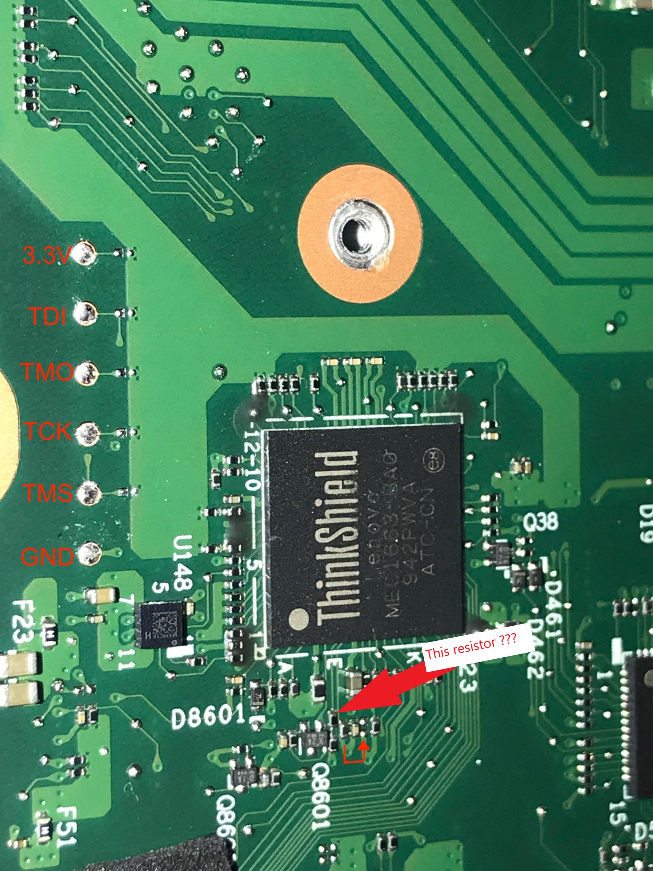

                  #393
                  Hey there,
                  While attempting to relocate the 10k resistor in order to enable jtag, I lost the resisor.
                  Does anyone know the specifications of the resistor so that I can order a new one?
                  Also do I have any other options instead of adding the resistor?
                  I have read somewhere that you can enable jtag by adding a certain amount of voltage so a specific part of the board.
                  Any ideas about how to do this?
                  Many thanks in advance, PT.

                      #395
                      Re: mec 16xx dump with info block
                      I want to share my 1st experience with MEC1663 from Yoga X1 4th gen.
                      Many thanks to AAAC, RethoricalCheese, EvilBzyk, their shared knowledge helped me a lot.
                      1. Connected jtag pins as in picture, no pull up resistor needed. Moved 10k resistor from pull-down to pull-up. Chose MEC1633#ISP. power on motherboard.
                      2. Got message "Chip may be damaged or encrypted, the data is not valid" I did try other options, MEC1653#ISP, MEC1633_256k, same result.
                      3. I hit "Erase" and laptop stops working, no power on/charge led lit.
                      4. I took EC file from bios update and trim 32bytes, the same version it was in bios (I took a photo of info in bios before pulling off the motherboard) wrote the file into EC then power off motherboard. Waited few minutes an power on motherboard, power on/charge led lit. Moved the 10k resistor to pull down.
                      5. schematics IS WRONG! TP1 IS REVERSED WITH TP5.
                      I did it your way. For Thinkpad X1 Carbon Gen 7th "FX90 NM-B861 Rev: 1.0". I can read the EC dump but it's only 192 Kb
                      Unluckily, I blew out this resistor. I re-soldered it but the laptop couldn't boot up.
                      Does anyone know the value of this resistor?
                      Thank you​

                        #396
                        R86151 1/20W_0_5%_0201 schematic and boardview:
                        https://www.badcaps.net/forum/troubl...32#post1680232
                        Chose MEC1633_256k if you have RT809H
                        • vuquanghoanh
                          • Feb 2023
                          • 45
                          • US
                          #397
                          Thank you so much. I have successfully removed the password

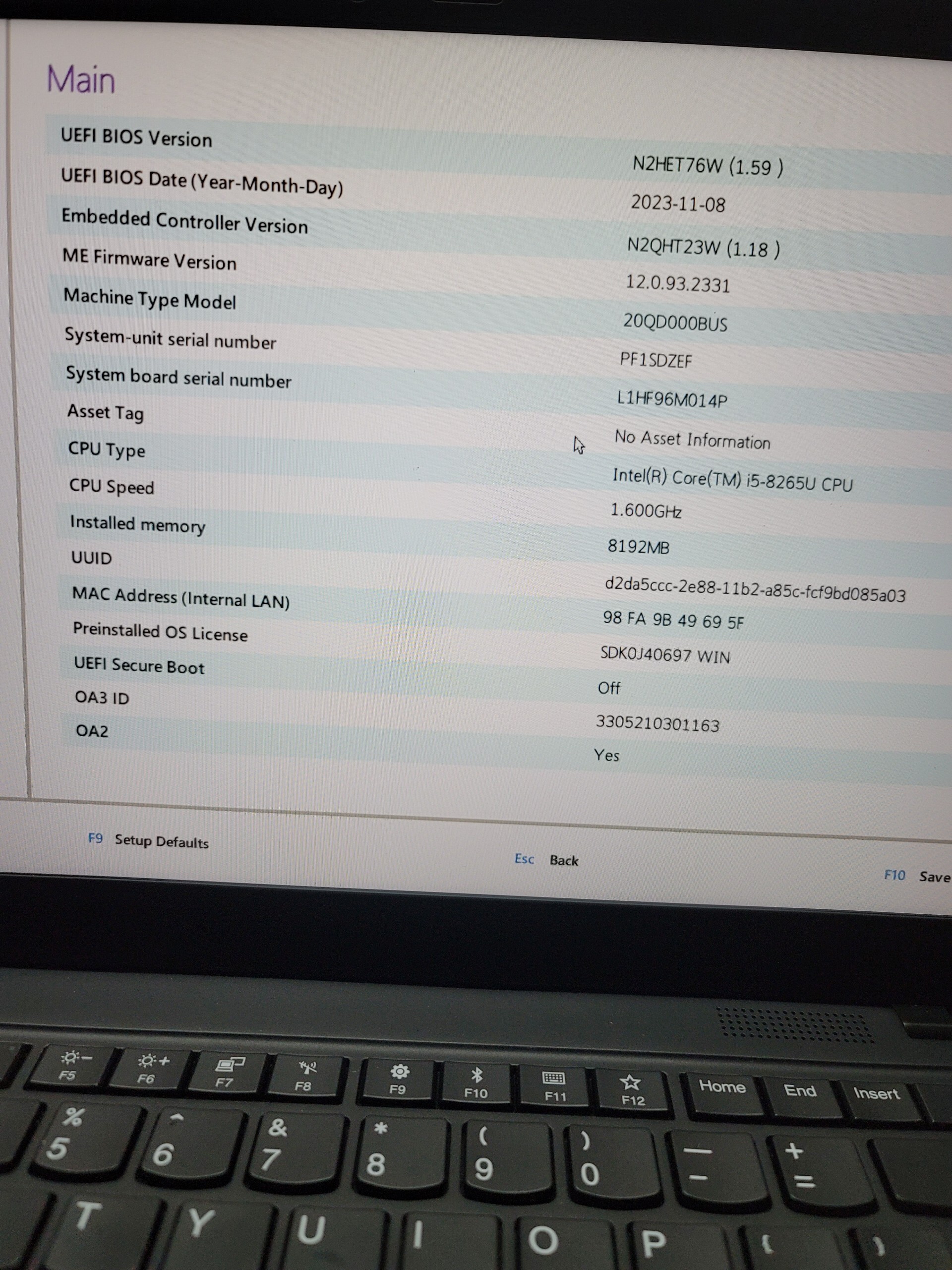

                              #399
                              I have successfully removed EC password. The system has received complete information. But when starting the laptop there is still message 2202: Product name is invalid.
                              I used the Gold key to re-enter the information but the problem was not resolved.
                              Has anyone solved this problem yet?​

                                #400
                                Thanks,
                                did you update the product brand to thinkpad T**?
