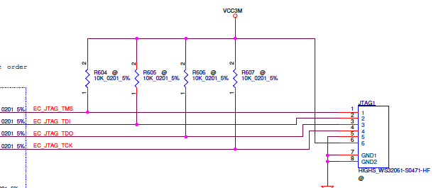

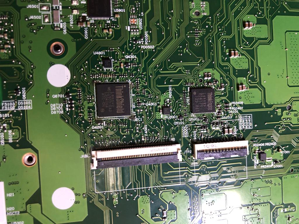

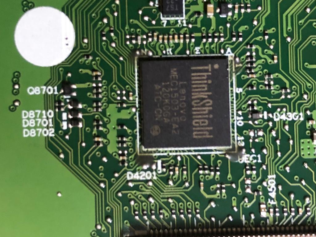

      I want to share my 1st experience with MEC1663 from Yoga X1 4th gen.
      Many thanks to AAAC, RethoricalCheese, EvilBzyk, their shared knowledge helped me a lot.
      1. Connected jtag pins as in picture, no pull up resistor needed. Moved 10k resistor from pull-down to pull-up. Chose MEC1633#ISP. power on motherboard.
      2. Got message "Chip may be damaged or encrypted, the data is not valid" I did try other options, MEC1653#ISP, MEC1633_256k, same result.
      3. I hit "Erase" and laptop stops working, no power on/charge led lit.
      4. I took EC file from bios update and trim 32bytes, the same version it was in bios (I took a photo of info in bios before pulling off the motherboard) wrote the file into EC then power off motherboard. Waited few minutes an power on motherboard, power on/charge led lit. Moved the 10k resistor to pull down.
      5. schematics IS WRONG! TP1 IS REVERSED WITH TP5.
      Maybe I am also in your case. How can i separate ec from bios update. Thanks for your help.
        what's your S/N? to identify your laptop and extract EC from bios update.
        or you can look at this post and do it yourself.
        https://www.badcaps.net/forum/showpo...&postcount=342
          My SN: YZ9Z01N6. Many thanks if you can extract the EC file for me. I'm learning how to do it but I need it sooner
            according to your serial your laptop is X1 Carbon 7th Gen - (Type 20QD, 20QE) and there are 2 EC files. I extracted both, if you took a picture of bios before trying to unlock you'll know what file to use, otherwise try both.
              Everything is perfect. Thanks so much for your help.

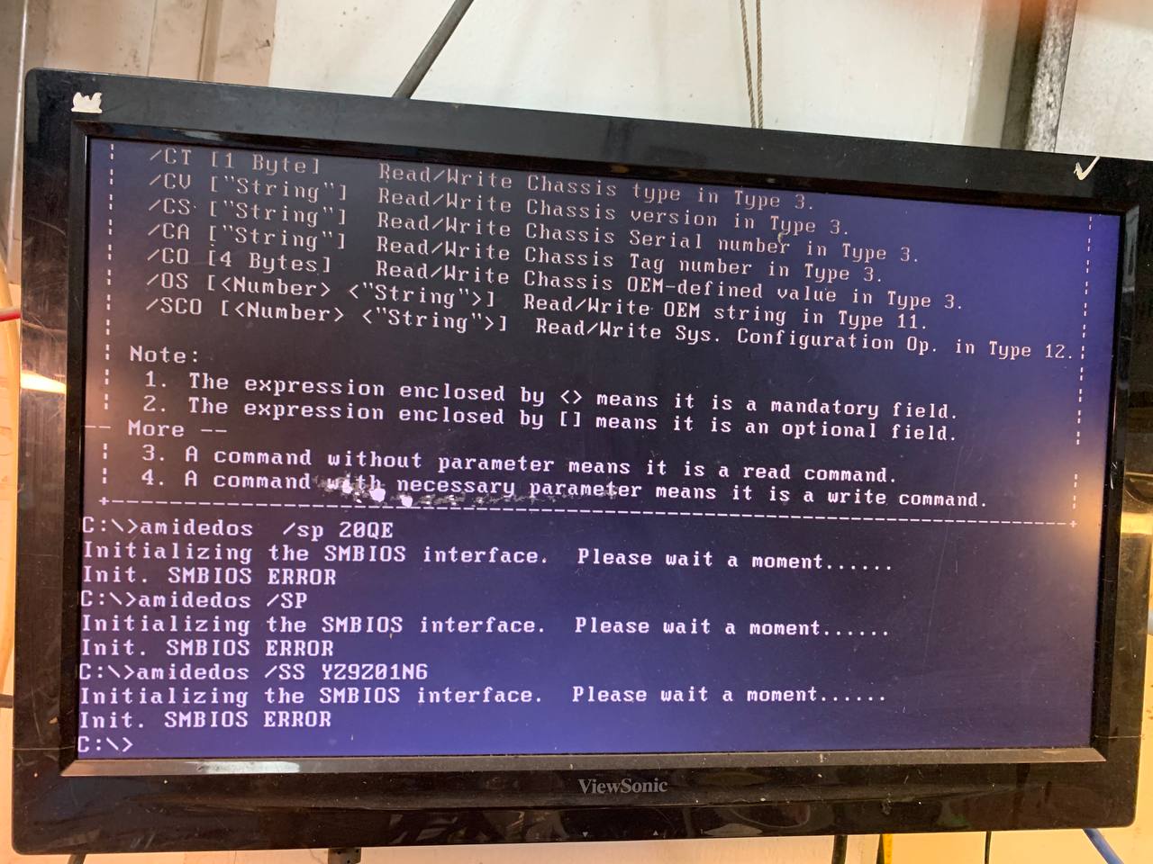

                I have successfully unlocked SVP Lenovo X1 Carbon gen 7. My problem now is that I can't update its DMI information. Tools I used: Uone, i7tm38us, amidedos tool

                  @jacobk1508
                  Try using a more recent utility like: n1ctm07w.
                  www.badcaps.net/forum/showpost.php?p=1040704
