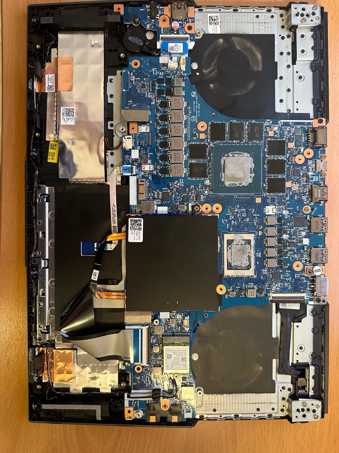

      Thanks for the reply – and yes, I made a mistake with the 25Q16JWSIQ chip.
      I thought it was the BIOS and accidentally erased it, but I had made a backup first and reflashed it right after.
      I’ve attached that 2MB backup here, in case it’s helpful.
      I also took a clear photo of the motherboard (attached), but I really don’t see any second SPI flash chip – no 32MB chip anywhere visible.
      Only the 25Q16JWSIQ and a small 25X05CL.
      Graphic Card is 3070ti
      If you spot anything in the photo I missed, I’d really appreciate a hint.
      Thanks again!

        your photo looks like is made with Nokia 1000
        Take a look ... and post serial number and full model, as in rules of this forum.

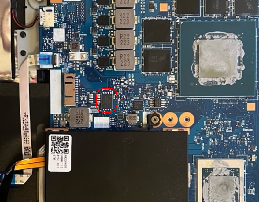

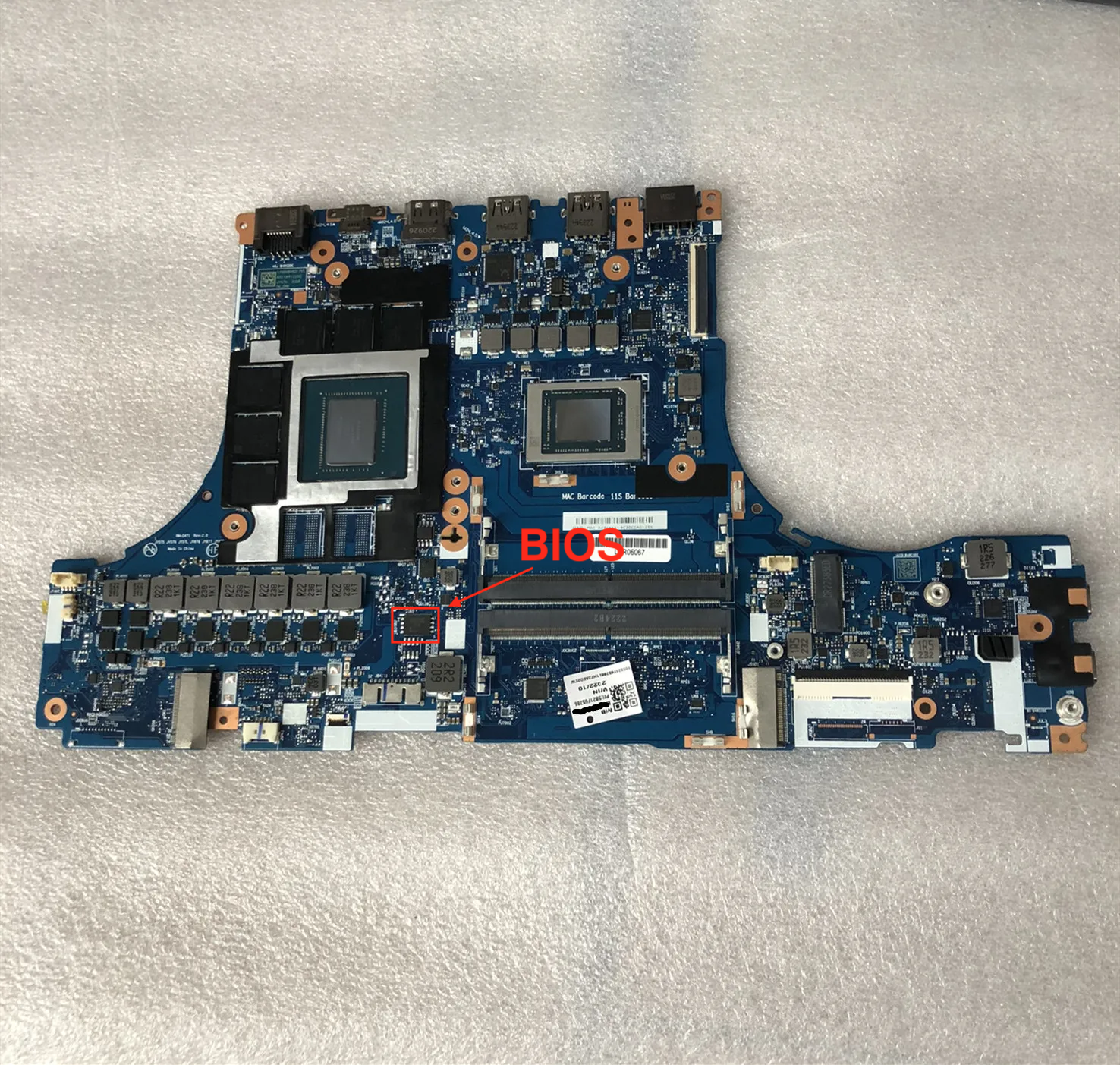

          Found chips:
          • Winbond 25Q16JWSIQ (1.8V)
          • 25X05CL (very small EC chip)
          • and recently: XMC 25RU256CXIQ
            (possibly the real BIOS chip – 256Mbit, 1.8V)
          I’ll upload a proper dump from the XMC chip once I get stable contact using the 1.8V adapter.
          Thanks for your time.
          • hardware1
            • Sep 2021
            • 2949
            • N/A
            This could be your BIOS chip, we need a close image for it.

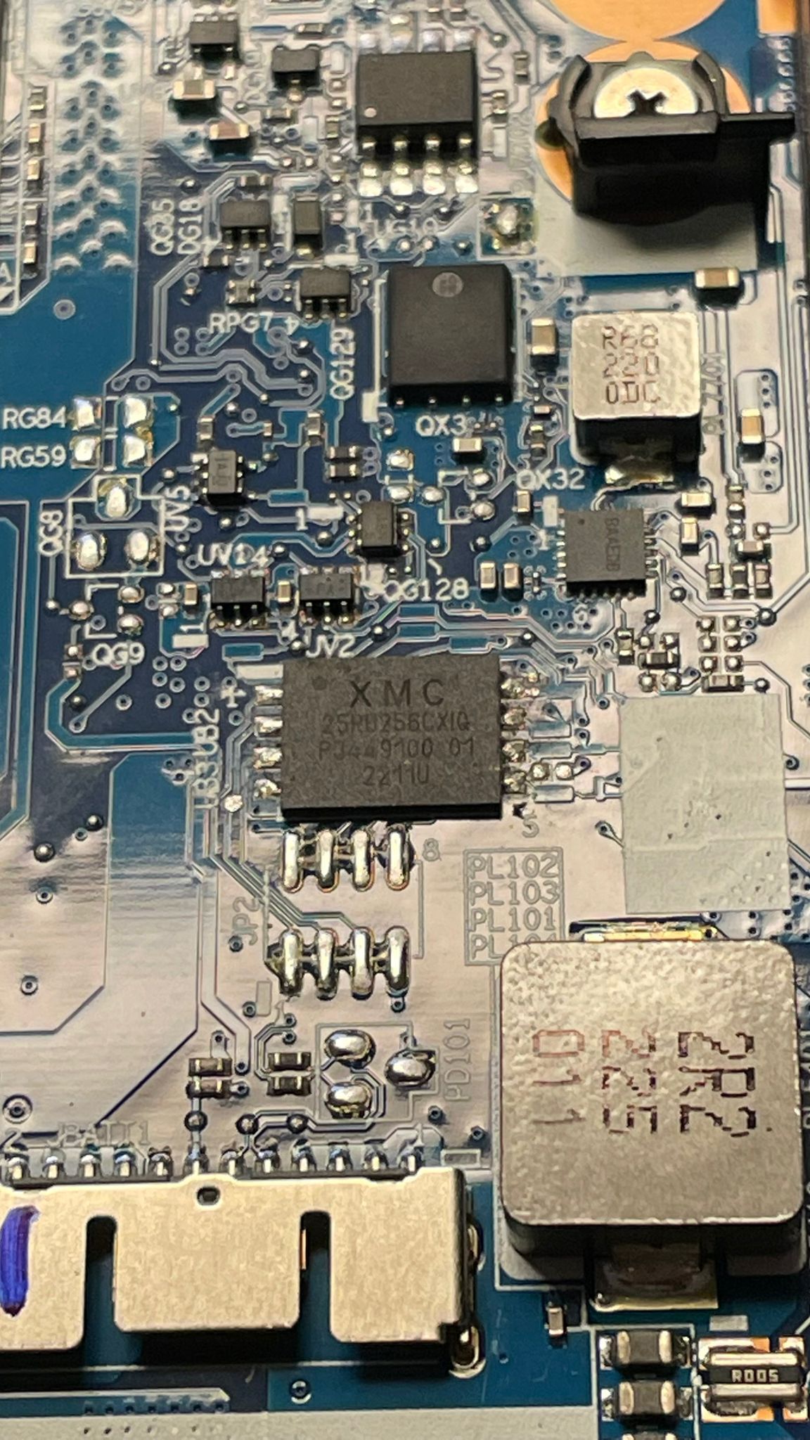

                  You didn't tell us your device issue yet! We don't know why do you want to flash the BIOS?
                  Thanks for the tip.
                  I agree – it was probably a contact issue with the clip.
                  I’ve now taken a better photo of the XMC 25RU256CXIQ chip (attached here).
                  It’s extremely flat and hard to get stable contact with the clip.
                  I’ll try again using better pressure and double-check pin 1 orientation.
                  Once I manage to get a clean read (same data 2–3 times), I’ll upload the dump here.
                  The reason I’m trying to flash the BIOS:
                  The laptop shows no display at all, no Lenovo logo – just fans spinning and keyboard lighting briefly.
                  Even the BIOS recovery via USB stick didn’t work, so I suspect the BIOS may be corrupted (possibly from a previous freeze/crash).
                  That’s why I want to dump and reflash it externally.
                  Thanks again for your help and time.

                    It's WSON8 8*6 chip, SOIC8 clip will not work. So you have to use a special adapter for it, or Pogo-pins but I don't prefer that.
                    You're welcome.
                    all donations are welcome,
                    • volinakis
                      • Jan 2021
                      • 2875
                      • N/A
                      You're welcome.
                      or he can solder wires to JP2.

                        you have to use 1.8V adapter, 25RU256CXIQ is powered with 1.8V, as well as 25Q16JW
                        • hardware1
                          • Sep 2021
                          • 2949
                          • N/A
                          Correct.
