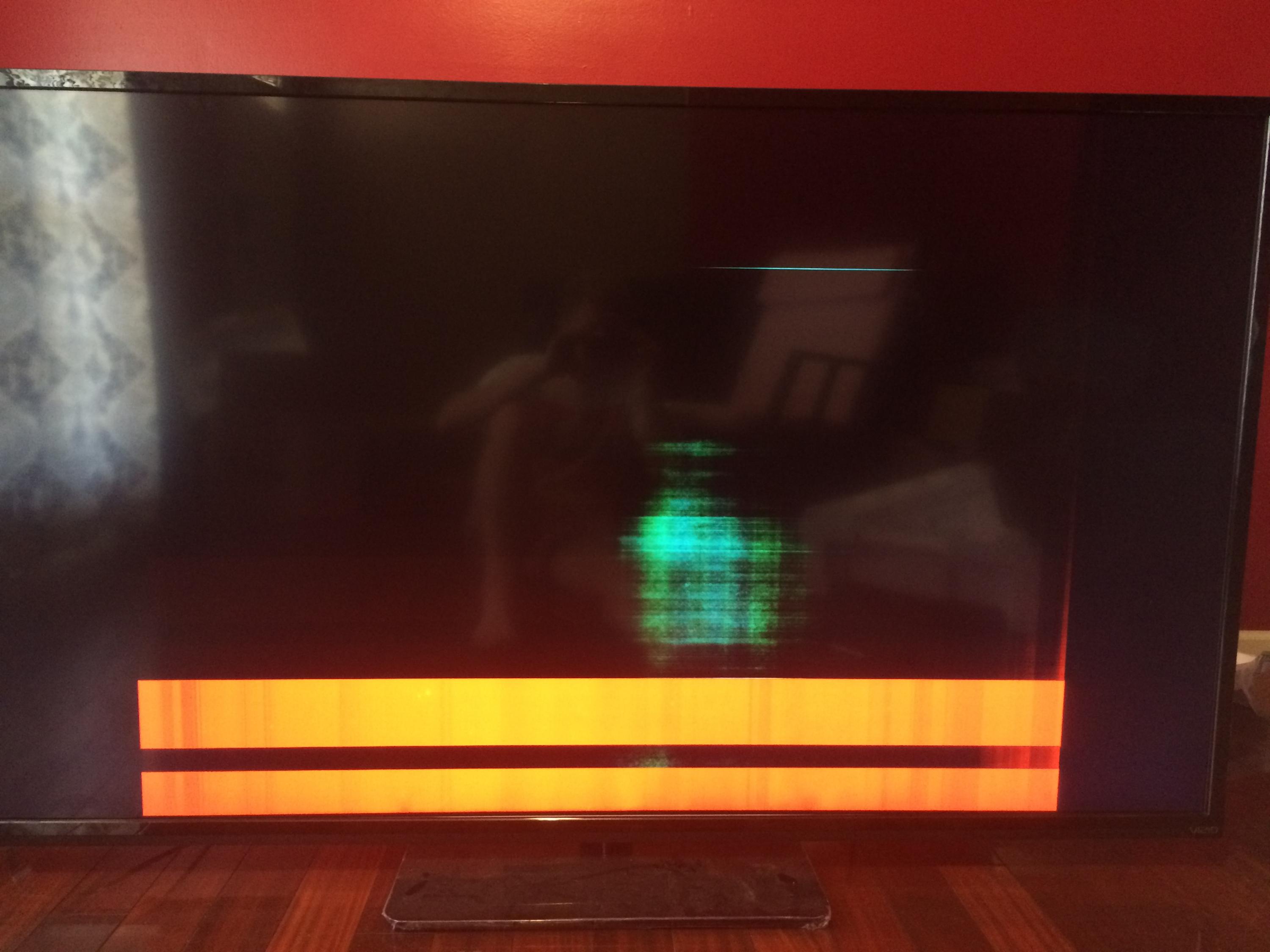

      So, I also have this Vizio that is doing the exact same thing and have read through this entire thread. Before I bought anything I just opened it up and tried to omh the transistor in question on the T-Con board and it did not responde as suggested on the meter. So, most likely it was already bad.
      With nothing else to loose I disconnected the right side (viewing from front) drivers and didn't notice a change after powering it on. Then I re-connected the right side drivers and disconnected the left side (viewing from front). I didn't notice any change on the screen but immediately saw a wisp of smoke come from the transistor in question on the T-con board. I powered it off. Figuring at this point the transistor was definitely toast I powered it on again and it smoked again and I even saw the transistor burn on the top. After that it didn't smoke anymore :-)
      So, figuring that since the right side drivers are the ones that made the transistor burn up completely I figured they are probably the bad ones and I disconnected those and re-connected the left side drivers and ordered a new T-con board.
      I got my new T-con board put in and with the right side drivers still disconnected I at least got something on the screen. So, I guess at this point I should attempt to remove the right side drivers from the LCD panel like described and hope I get a clear picture?
      Attached is a picture of what it looks like right now with a DVD playing and I can hear the sound.
        Re: e701i-a3 no picture but backlights
        with your pretty "thorough" testing (burned up fet).... and now you got something and no burning fet.... I think you are on ther right track... or should I say "right side"... :-)
        The reason that you are not getting much of a picture is that the tab drivers that are bad are causing issues with the drivers on the other side and they are not able to overcome the problem. Once the bad tabs are all removed from the bad side, it is very likely that you will have a good picture again... and most likely a smile on your face... :-)

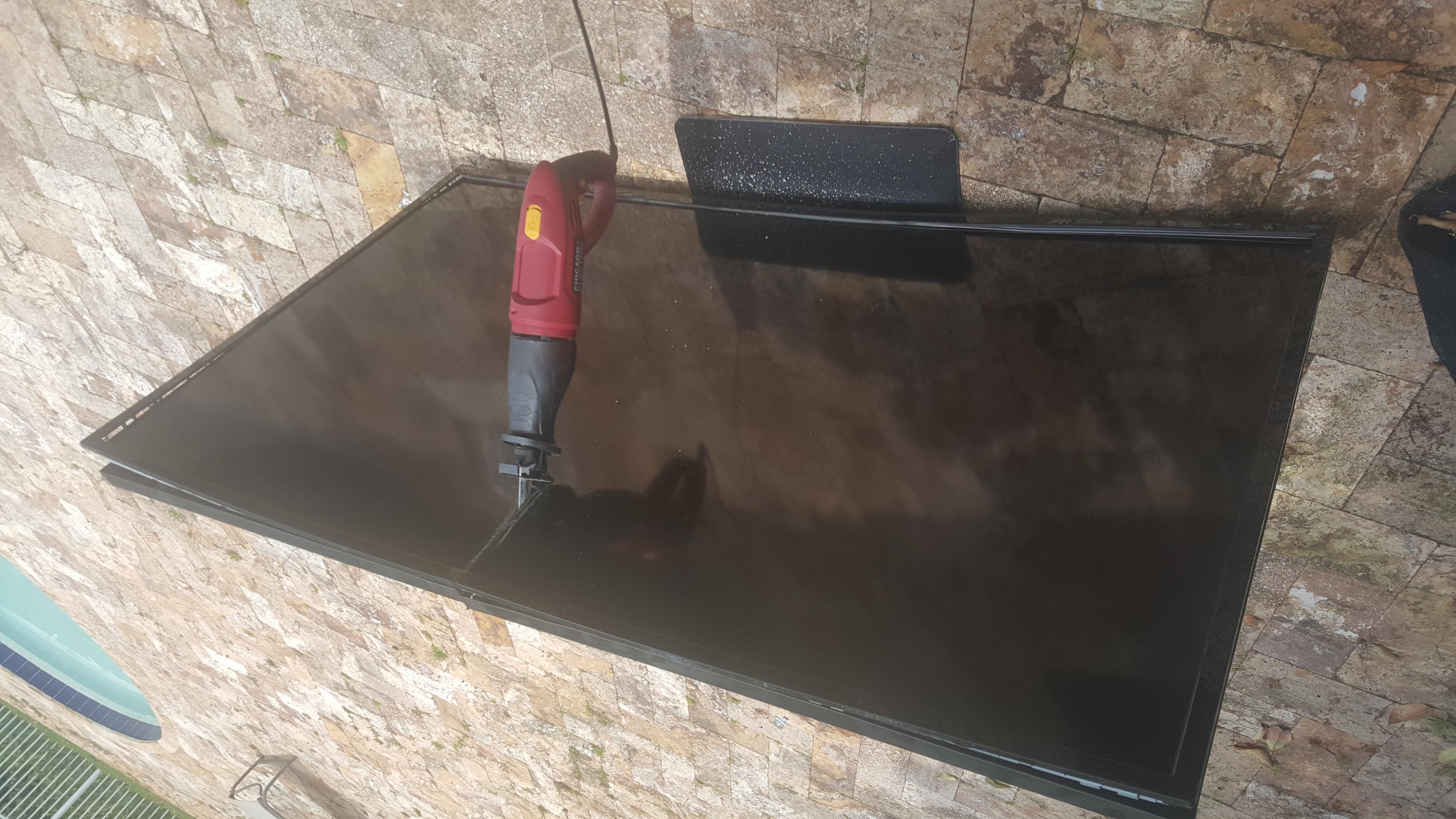

            Removed the right drivers but chipped the glass, still no picture. After throwing and it still didn't want to be cut. Free tv to good home lol
