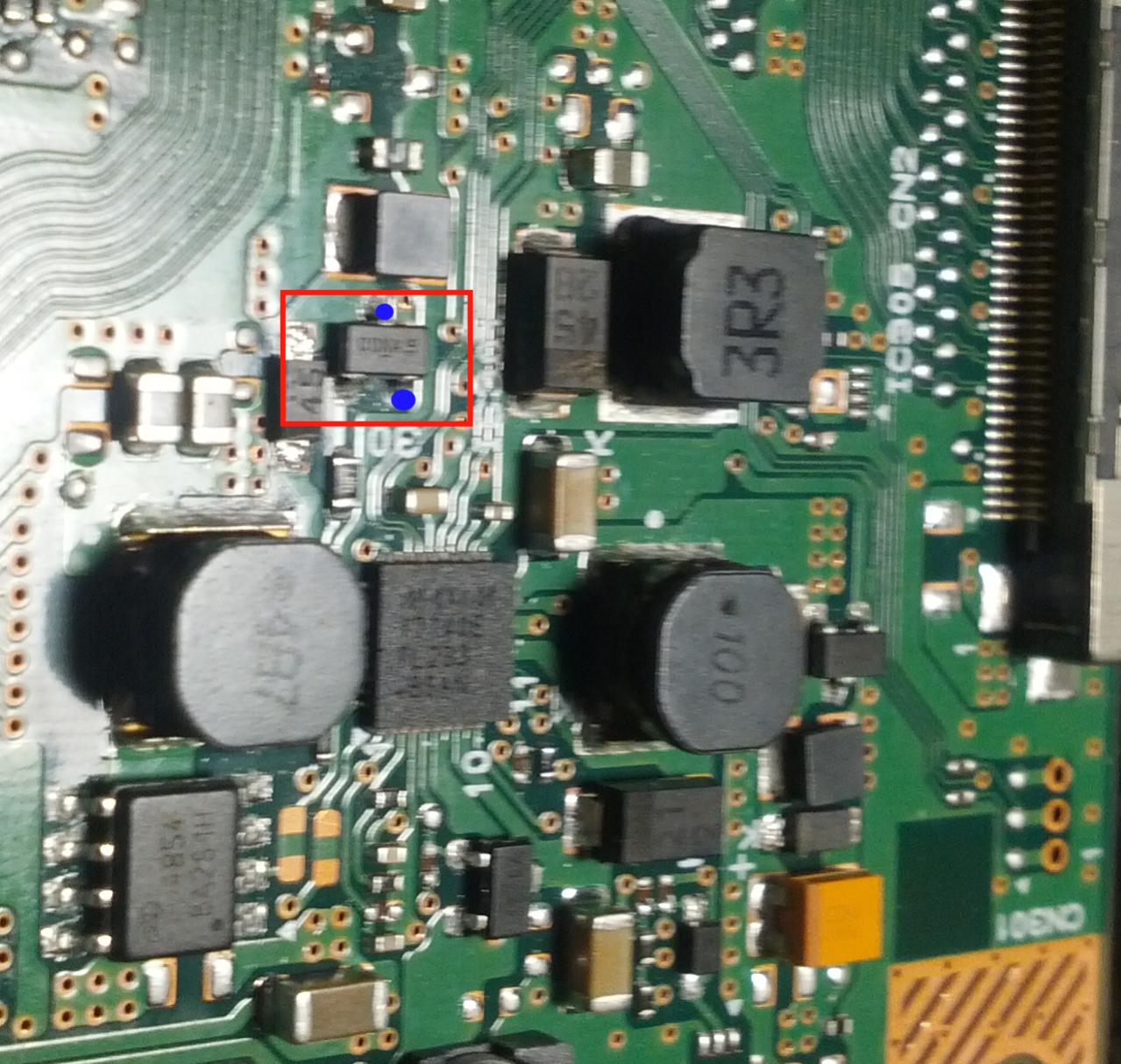

                The replacement you need is a RTR020N05 2a 45v n channel SOT-23 style mosfet. This mosfet will be replacing the COXA. It's much more robust than the original and can take abuse.
                Yes. That 001 reading means it's shorted
                I think tjmethod still has some if you cant locate online.

                  Just so that we are on the same page this is what needs to be replaced? You sent me a link bout a month back and I have some. Should be interesting, I can solder caps day and night but this, this is out of my comfort zone. Should be fun. Also I noticed there are like 2 more of these in the area of the one that needs replaced. Are they the same and do they need to be tested?

                    Just an update... It took me awhile and to be honest I am still in shock but the new mosfet has successfully been put on the tcon board. I am not a fan of this particular task but it was a good experience for me to learn so I am glad it happened. It is now in the tv and the lower right tab has been removed and now when I power on the tv I am back to where I was, picture on left and black on the right. We now know that horizontal lines dont have to be present for this issue AND this tcon will fry in 4 seconds, yes I counted out loud. So for future reference lets not do this again cause I am sure not a fan. It is safe to say those right tabs need to come out and possibly burned in a blaze of fire! Just want to say thank you freakaftr8 for all your help in this, it is much appreciated. I will continue onto phase 2 tomorrow, I have had enough TV drama for one night.

                      Good to hear you're board as backup and functioning. So now we know that yes there is an inherent short on the right hand side

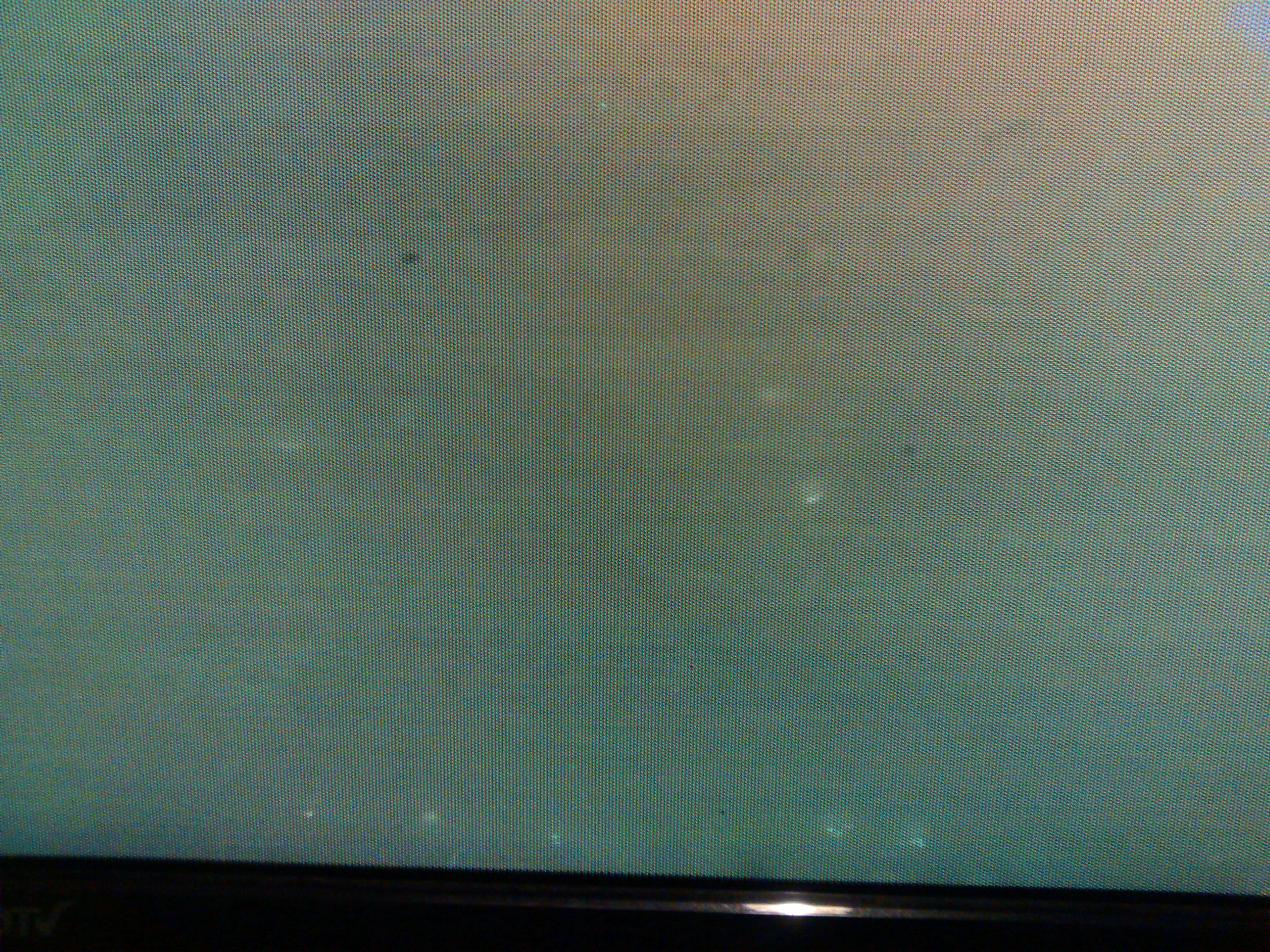

                                  Those white specks are an inherent design flaw in the polarizer sheet behind the LCD panel. Mine has the same problems and a lot of others I have seen do this also including the demo units that are still at Target and Walmart. It seems to happen more with more frequent use. I believe it is heat related. Those. You'll just have to live with unfortunately..
                                  If you look at the consumer report on this model you will see a lot of people having that problem
                                  • bleed4me
                                    • Nov 2015
                                    • 122
