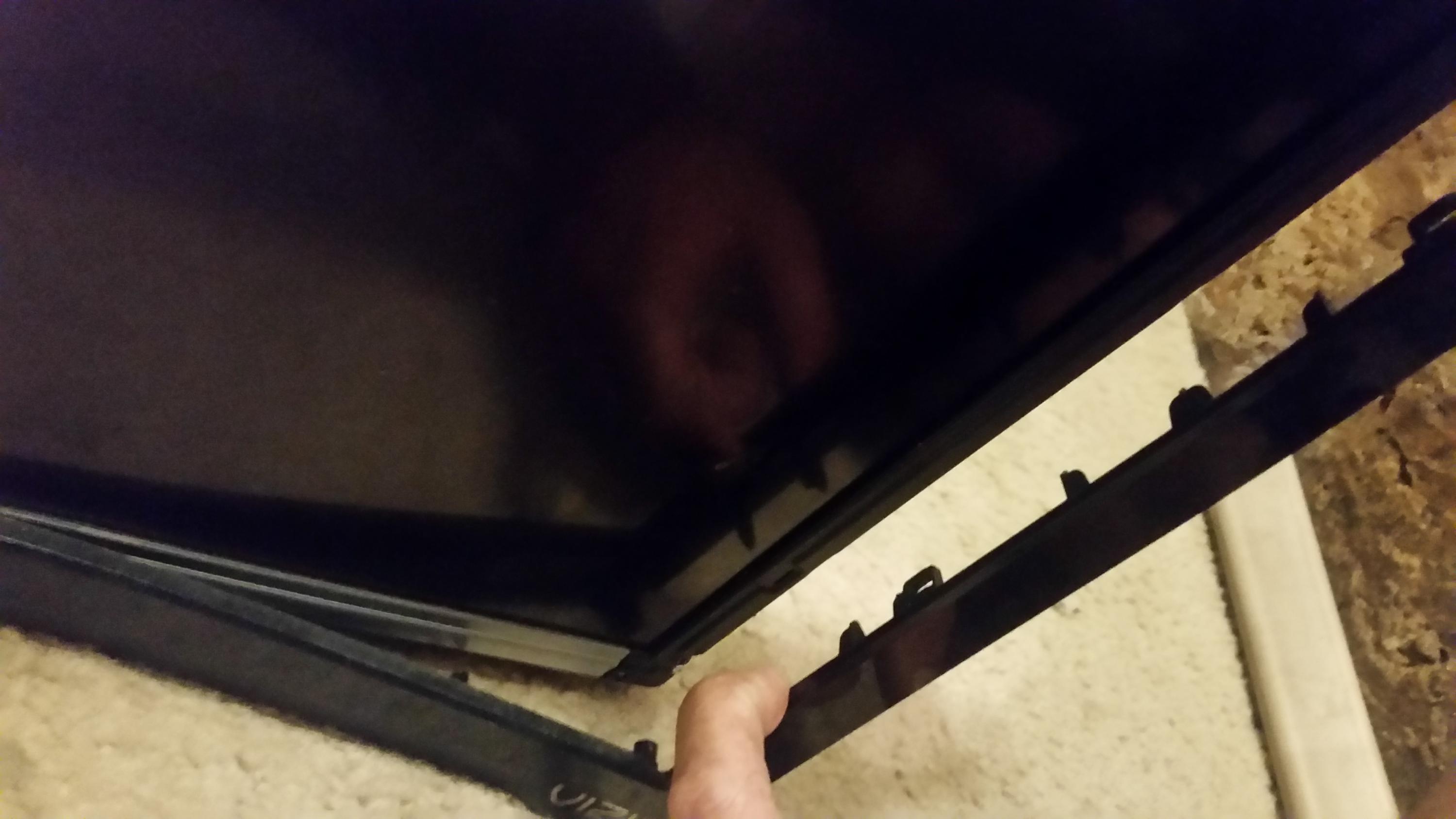

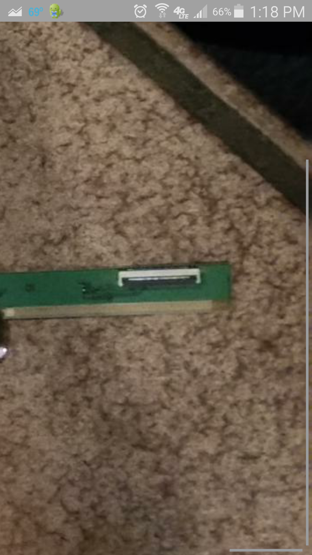

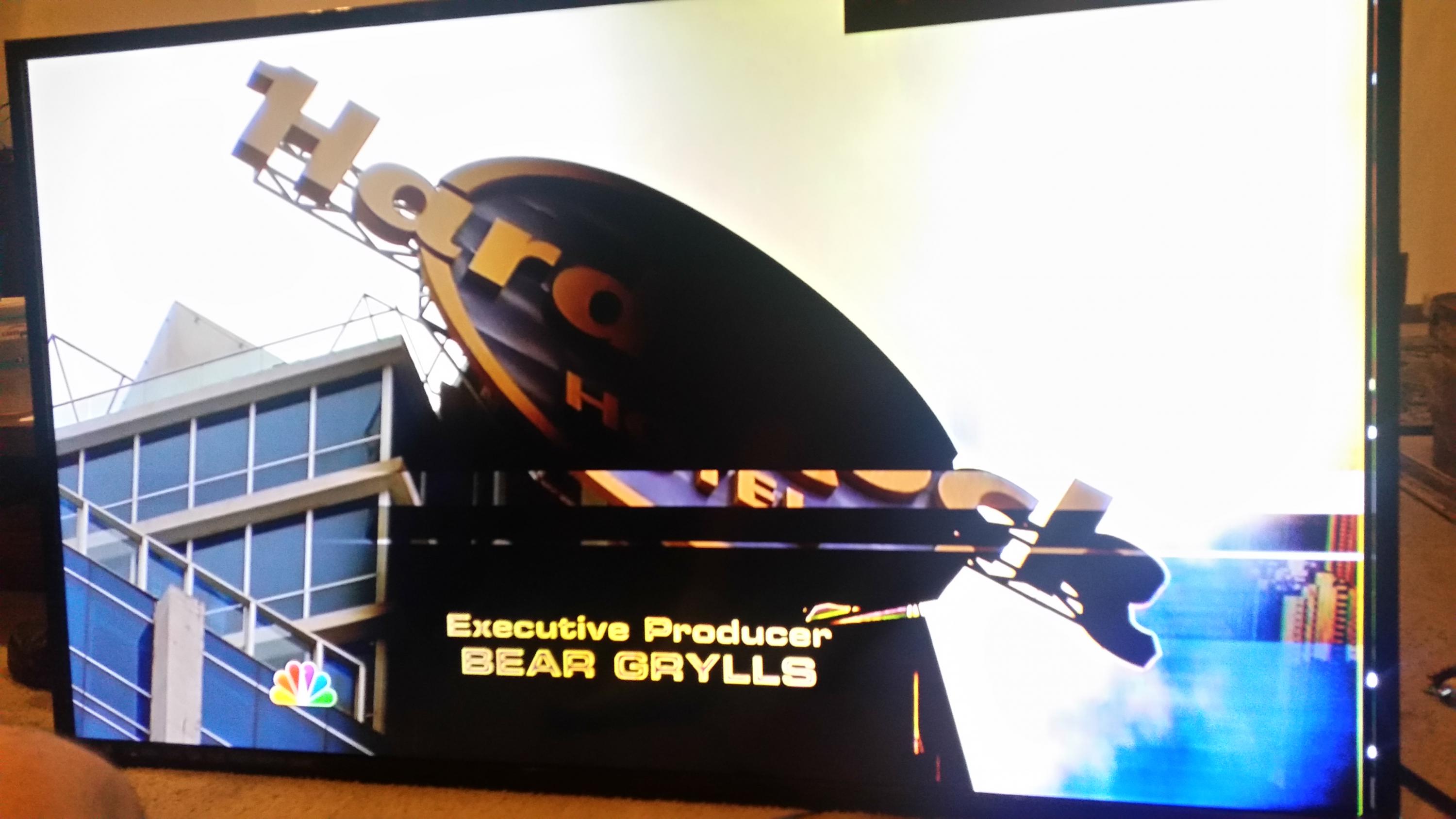

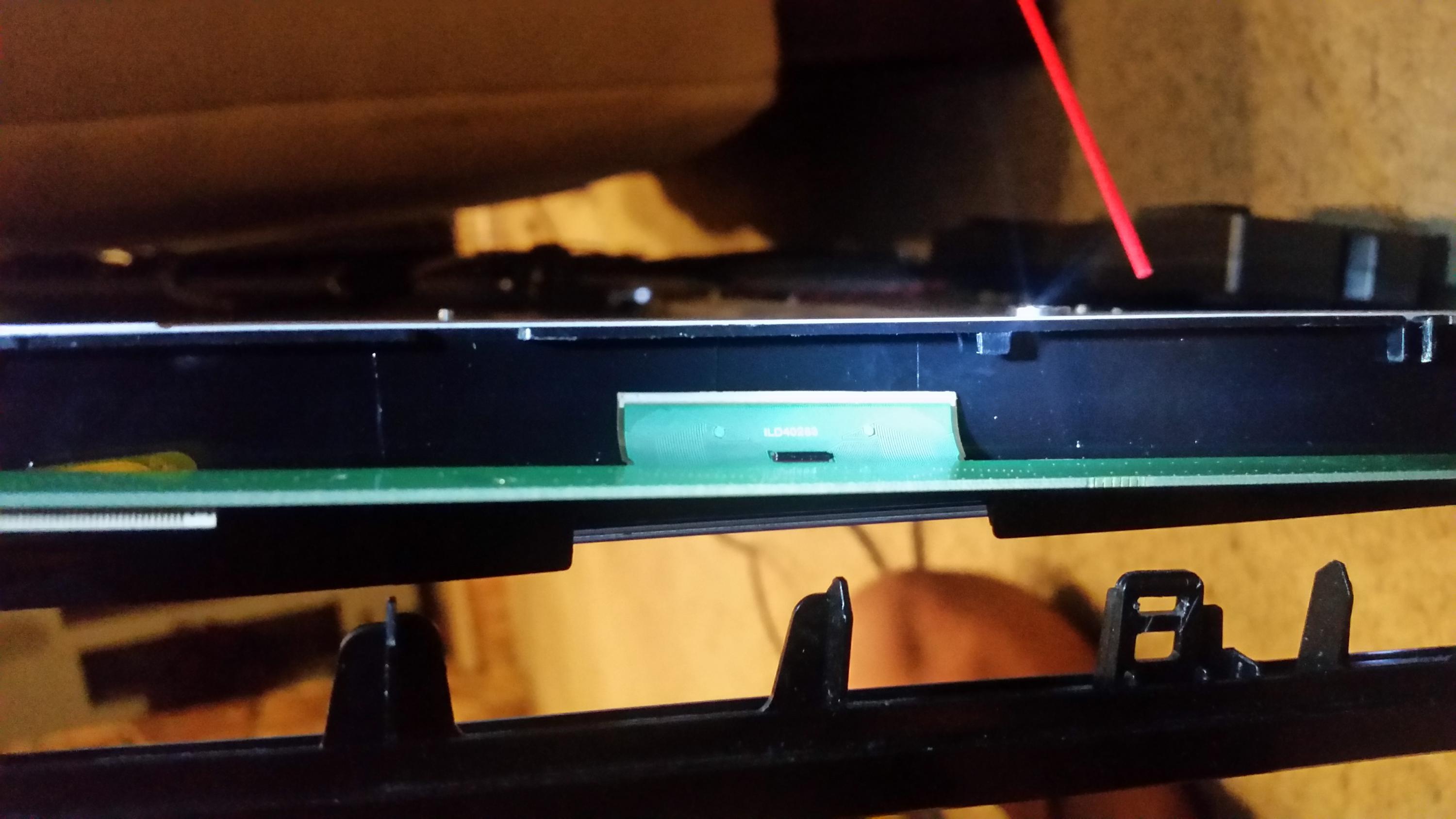

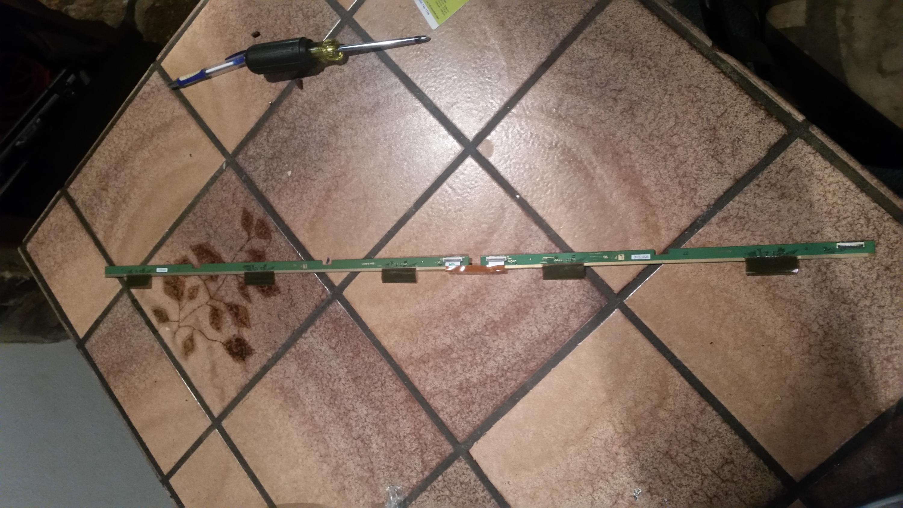

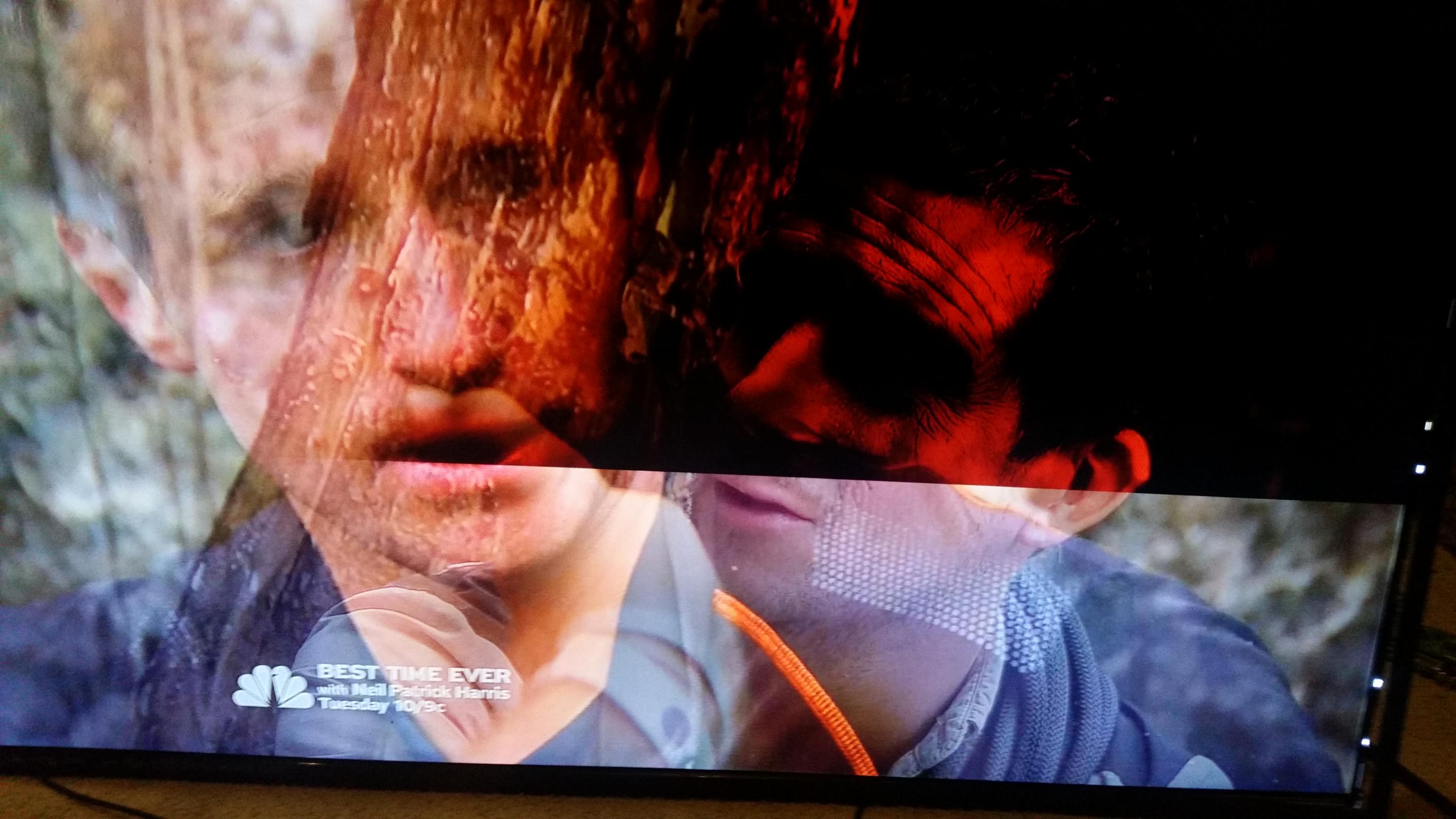

      Ok here's some pictures ranging from the beginning to the end result. The only picture I do not have is disconnecting the flat white ribbon cable from the side boards that connect to the bottom boards of the panel. But if you have the back off and you're looking at the side of the screen at the bottom sandwiched between the metal frame you will see where the white ribbon cable connects to the bottom of the side drivers.
      The first picture shows you what the screen look like after I disconnected the flat white ribbon cable.
      The second picture shows you pulling away the frame to access the side tab driver boards.
      The third picture is showing those driver boards with the tabs pulled off the panel.
      The 4th picture shows you a close up of one of the tabs pulled from the panel but the board still connected to the panel.
      The fifth picture shows you the screenshot of what you're seeing after you remove those defective tab drivers.
      The sixth picture shows you another screenshot of just the fifth driver download from the panel.
      The seventh picture shows you the original problem.

                  Make sure you disconnect this first. This is a picture of the sideboard connected to the panel on the right side of the screen. Make sure you disconnect the flat white ribbon cable that connects the bottom board to the sideboard before you attempt to power up the TV. This flat ribbon cable is only about three quarters of an inch wide. It is located on the bottom of the right side of the panel. & I would like to note that when I say right side that is looking at the TV front if you're behind the TV it is the left side on the lower side of the tv. Near the vizio emblem..

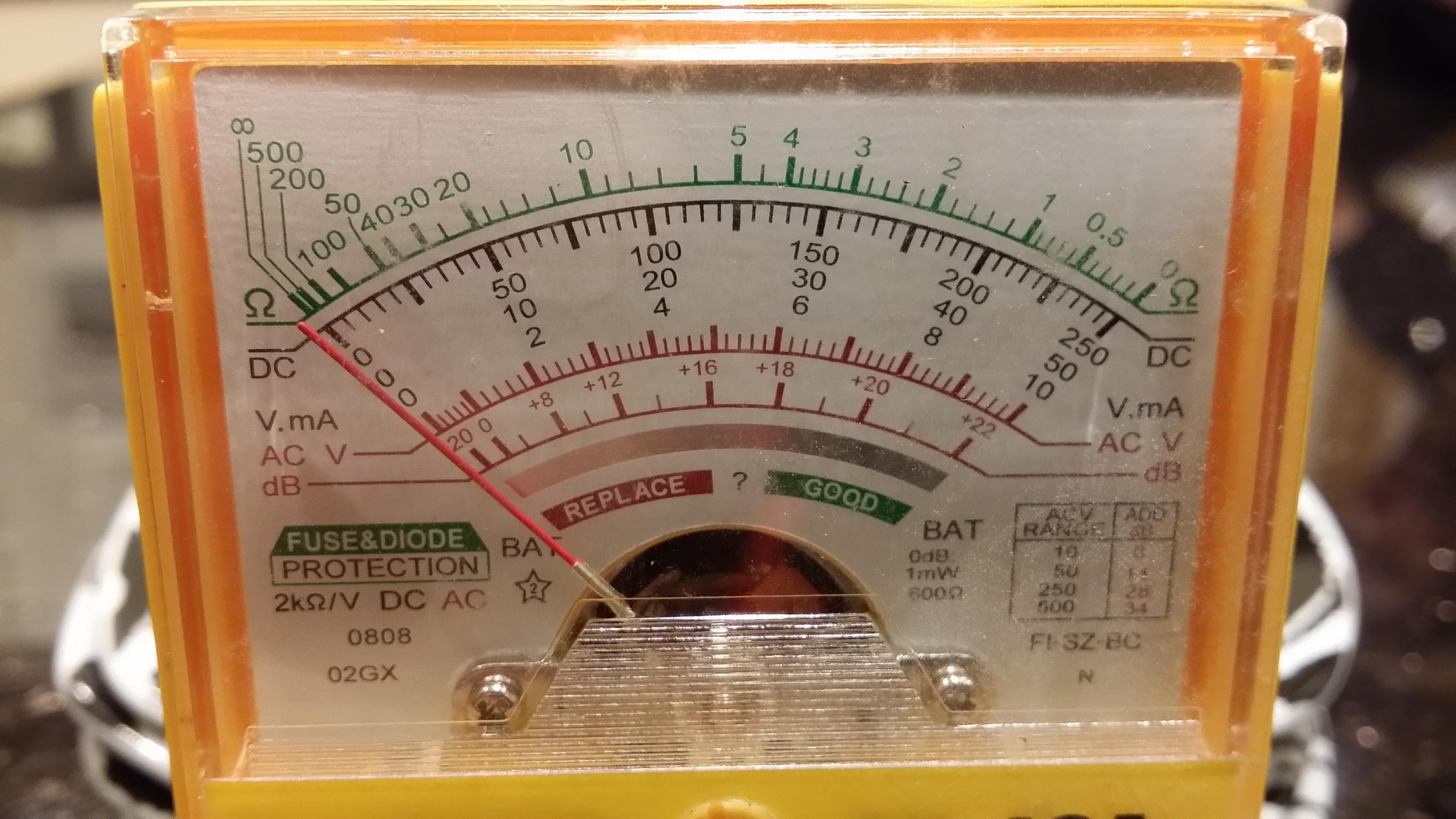

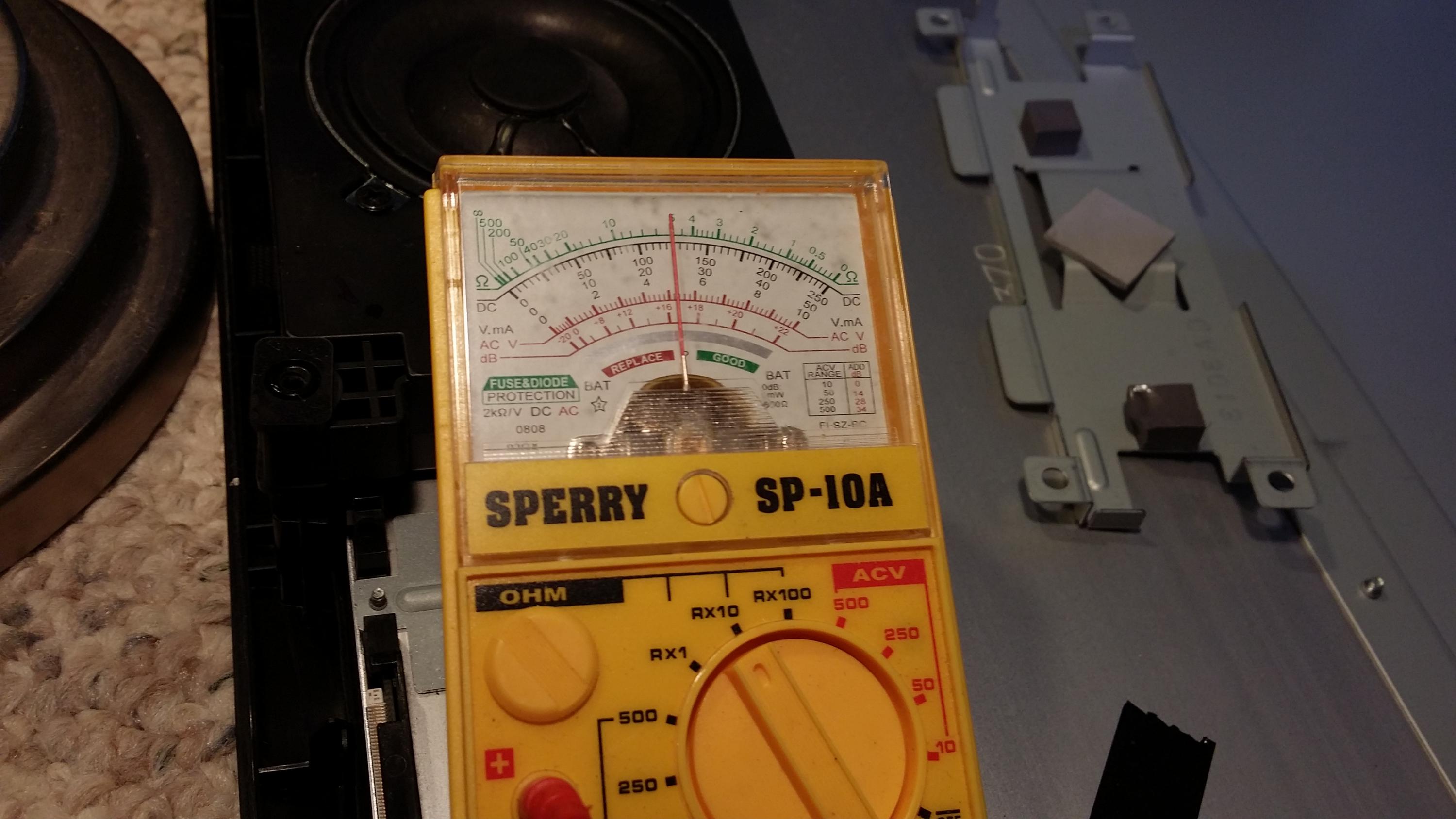

                                      Hi thanks for your instructions freak I retested each ribbon cables to no avail- blacklights but no ‘V' or menu. I then proceeded to test the t-con board. Looking at the back of the set, the t-con is mounted upside down. I put the black probe on the left middle COXA leg which barely had enough room for the probe to fit between the COXA and the module directly to the left in fact I accidentally ripped most of the black cover off that module trying to hold the probe directly on the leg. I put the red probe on the right lower leg. The first picture is a clear shot of the meter display since the pics of the readings weren't all that clear. The 2nd is RX-1, the 3rd is RX-10 and the 4th is RX-100, I did put the red probe on the top leg of the transistor which pinned the needle all the way to the right that I didn't get a picture of. While holding the probe down on the legs, they slid off the legs a few times and I then must have used to much pressure holding probes down and right after I got the reading on righthand top leg, I ended up pushing the COXA off it's solder spots all while the set was on. Now I was fit to be tied. I then used a soldering iron with a tip as sharp as a pencil tip and a fixed magnifying glass then was able to melt the legs back on their solder spots. After plugging it back in- no readings and I wasn't surprised. I plugged in the original t-con board and tested it with the set on also with no readings. The 5th picture is of the t-con board after the molestation. I don't know if the original t-con was bad since I got readings from it unless something else was bad on the board. I might have messed up something else on another board. Anyway, if you have any advice on where to go from here after getting a new t-con of course
                                      Thanks again-
                                        Re: e701i-a3 no picture but backlights
                                        Correction I didn't test the original t-con before testing the new one- only after
