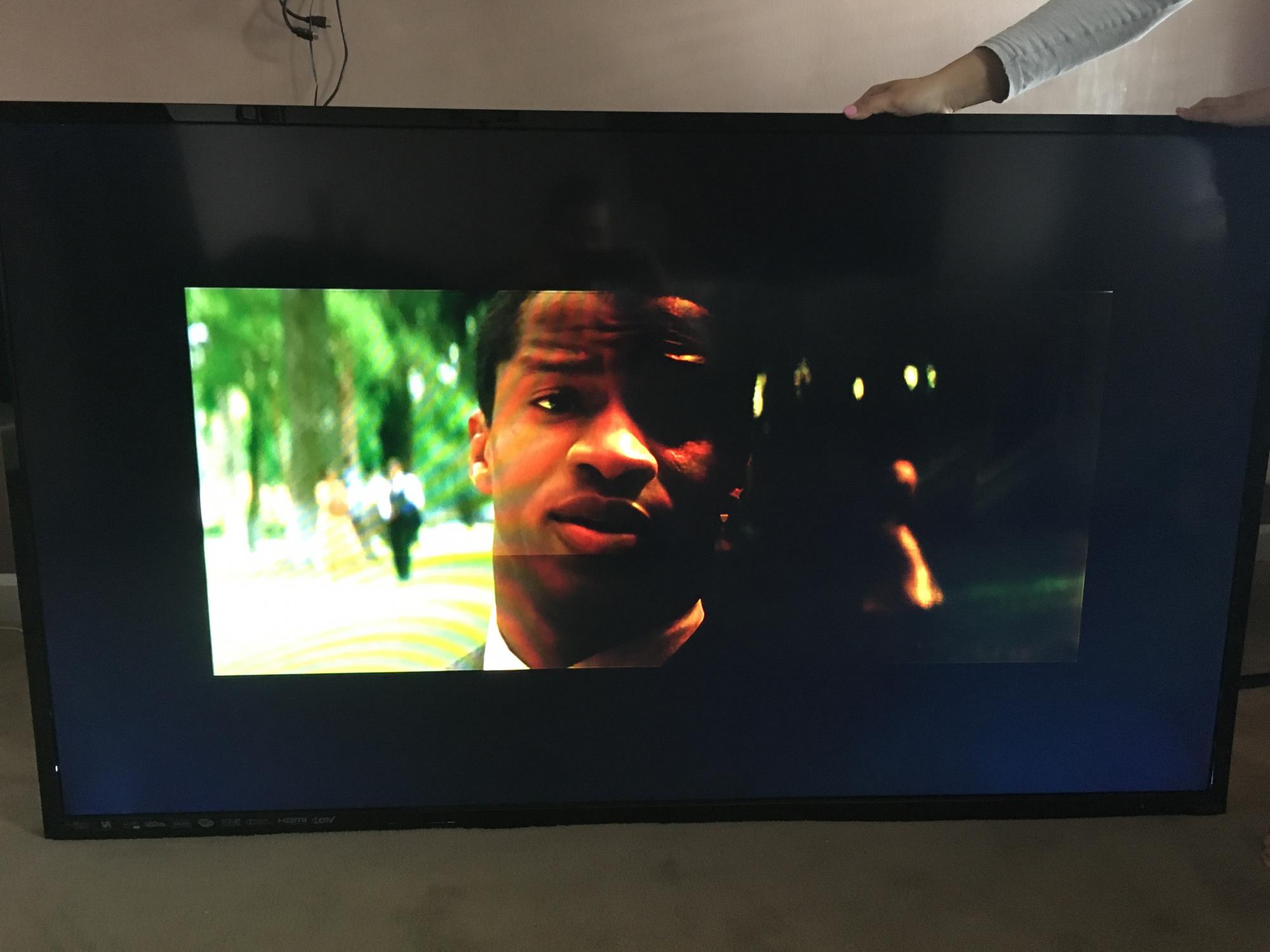

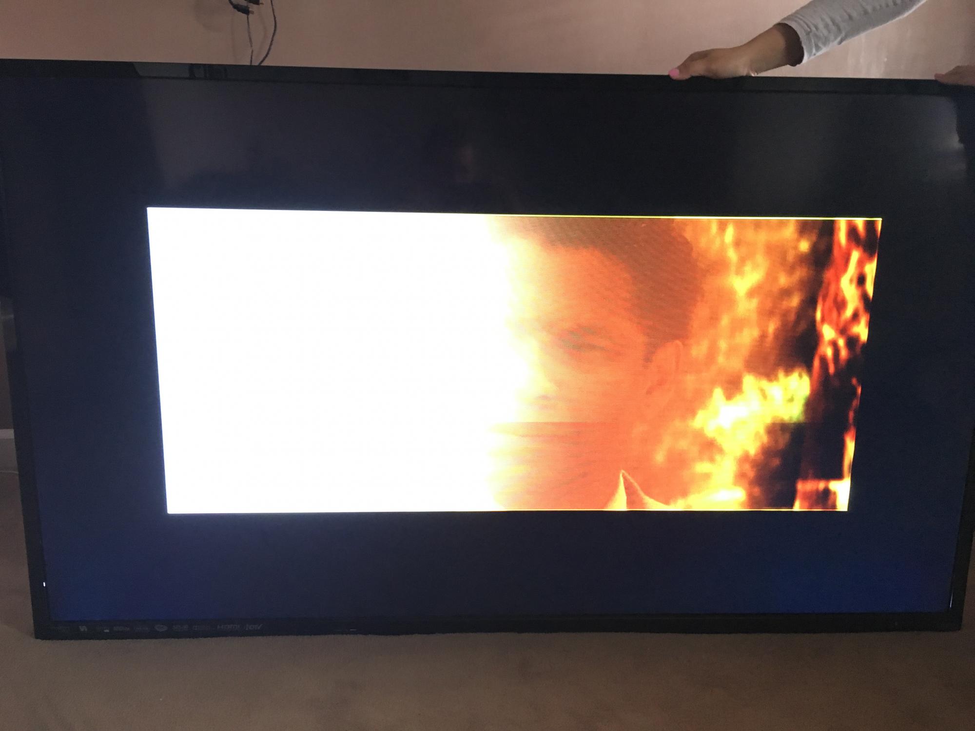

                        Hello this is my first time posting. I read the forum on this topic. I'm not sure it'll let me post pictures since I am new on here. I went ahead and removed the plastic bezel from the tv and removed both aluminum covers that cover the side drivers. If you're looking at the tv I disconnected the bottom cable of the right side. Powered it up and had a dvd playing it now works but I have my right side dark and my left side looks clear. Does this mean that I have to pull the drivers on the right side? I just want to make sure because I know you guys mentioned that it's irreversible. Also quick note before I did this my back light would come on I just had no picture. Let me know. An kudos on this thread 😎👍💪

                            post a picture that will help (read up on "attachments"). Since your tcon doesn't appear to be "gone" (usual problem with the fail), odds are high that you have guessed right. Depending on your skill and luck, you could try do the "reverse" with the other side.... but NOTE, during this "test", it is possible that because now you would be running with only the "potentially bad" side connected, it could take out your tcon which then you would have to fix as outlined in this thread by others. Not a real problem as others have readily repaired their tcon and moved forward again.

                              Ok this is what I got. Btw thanks for getting back to me I appreciate it. Also a side note I do have sound.

                                I'm not sure how to post multiple pics I'm sorry

                                  #476
                                  Re: e701i-a3 no picture but backlights
                                  This is the last pic I took

                                      hmmm.... not sure. The second picture is confusing and the third appears to have some horizontal lines which I would have expected to come from the "bad side".
                                      Can you find a "known color bar" source (ie. dvd test pattern or equivalent).... that way, you will posting something that is a known pattern that will provide a better view of any "details" of the failure.
