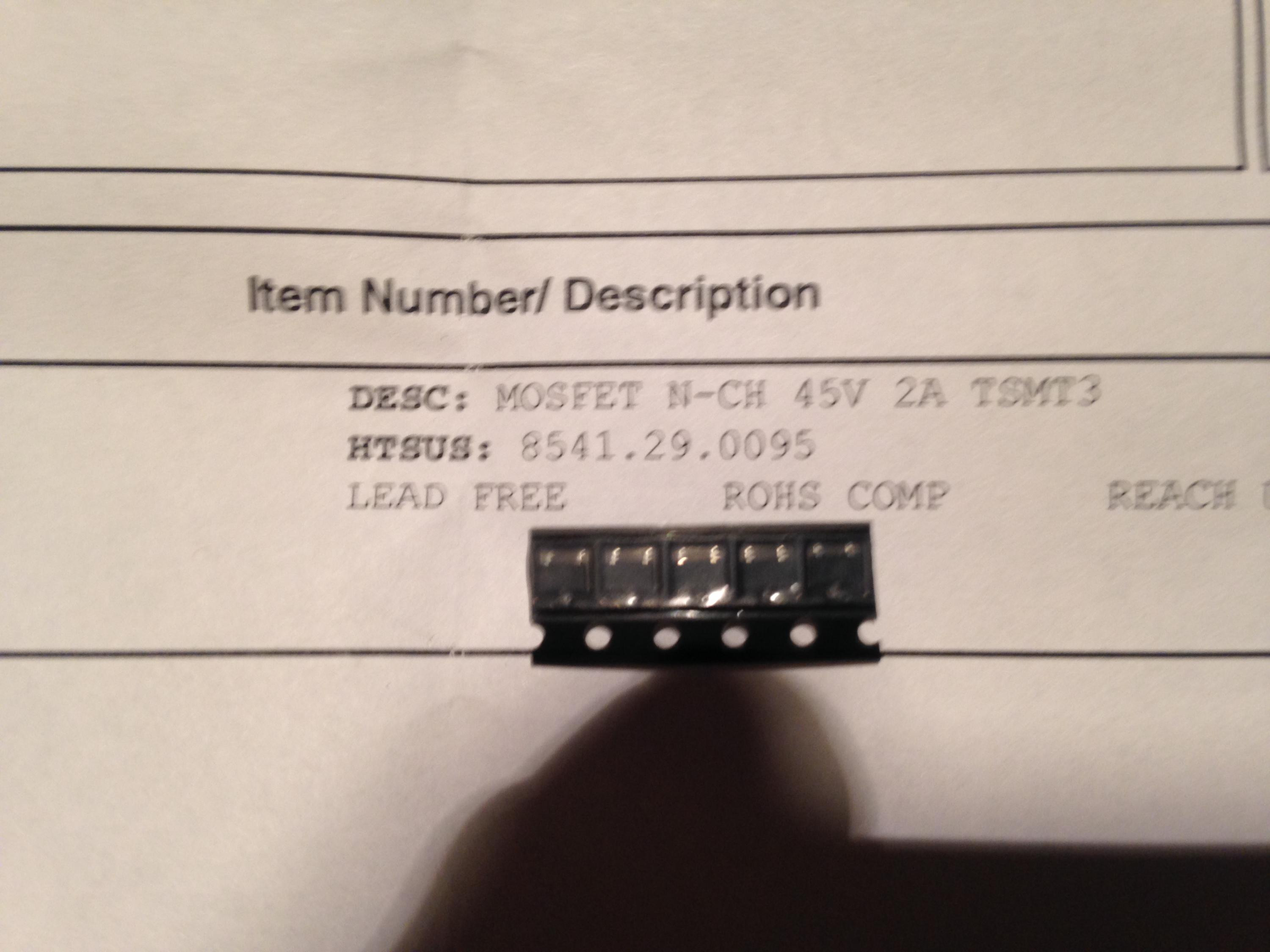

    I thought I may need bifocals soon. Now I know I do!!! I got the new mosfet for the T-con and was working on it tonight. Now that I'm cross eyed I will take it to the shop at work tomorrow and use the big magnifiers to finish loading lol!!

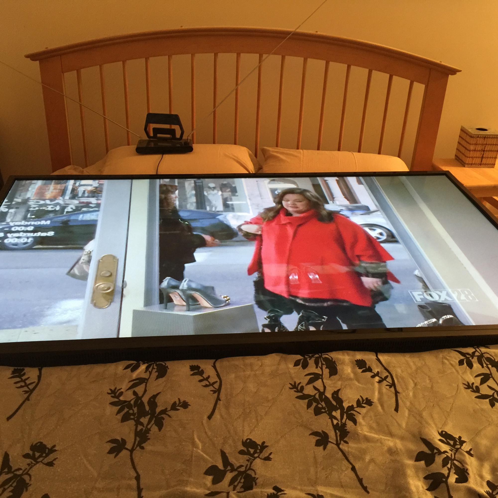

          Thanks to freak, budwich et al I have a functioning 70le650u for $100 ! Since this is mostly a hobby for me any money I do make generally goes into buying more tools and more junk to repair but this one I'm keeping. My wife has decided she wants it in the bedroom. Who am I to argue ? Cheers!
          • mmartell
            • Oct 2013
            • 3189
            #345
            Re: e701i-a3 no picture but backlights
            Oh and two more things, maybe three...
            My failed driver was the lowest driver on the right side facing the back of the tv.
            Now is there a concensus on what actually stresses these driver ic's ? Is it refresh rate or some types of picture content or something else ? Would only make sense to try not to push things too far already missing half the drivers. I've dialed back the refresh rate to 60hz because like Paul I'm not interested in movies looking like soap operas.
            Thirdly there were some preferred setting mentioned somewhere in this thread. Can someone point me to the post or reiterate ?

              #346
              Up and running!! Looks great. Mine was burnt out on the right side as well.

                Mosfets have been in for days now from Digi-key. I finally opened the box and man was I surprised. Maybe should have looked when I got them. I finally have a couple days off to work on TV. They are so small idk if I can do this. Will get tcon out of tv tonight. Hoping I got right ones.
                    Part was too small for me to do so had my coisin do it for me. Only difference is with right tab unplugged when powering up that half of screen comes on for brief sec then back to just backlights. his solder job looks great but after inspecting the old mosfet it looks like a piece of the board came off with it on both two prongs side of mosfet with single side clean. powered set up several times trying different things and this is only difference. no menu or actual image and what bothers me most is faint vertical lines just before going back to just back lights. Probably need tcon board now.

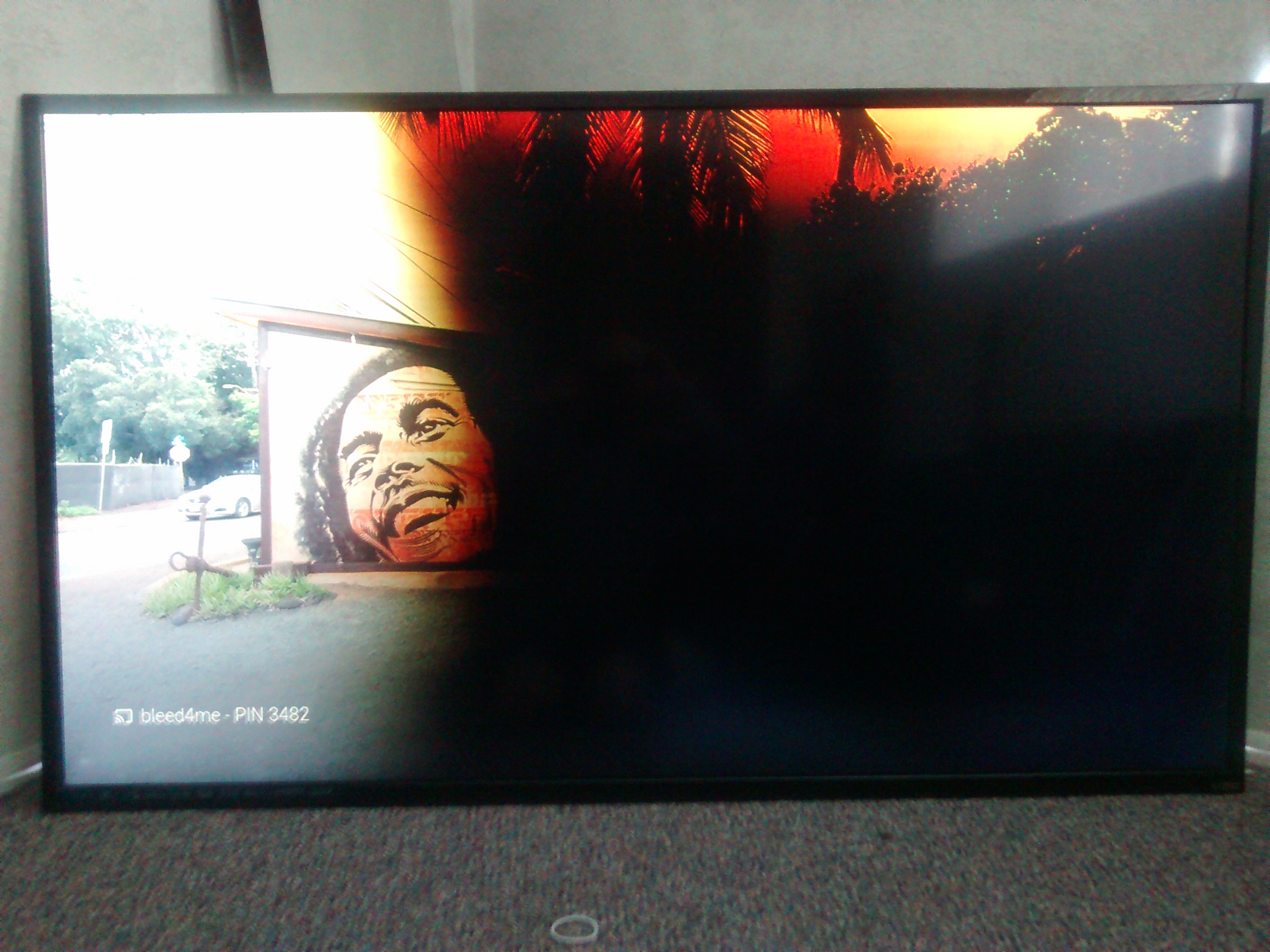

                      Hello there everyone, so I got my paws on a Vizio E701i-A3 that is showing the same symptoms as every one else. As it stands the back cover is off and the lower right tab is disconnected and I now have a brandy new tcon board that needs to be installed. freakaftr8 I do have a question for you, in your video you were stating disconnecting the white cables on the tcon board to find out which side is the problem child. Once you figure that out then you disconnect the lower small cable. Am I understanding that correctly? Just wondering if I missed that step, I just disconnected the lower left small tab.

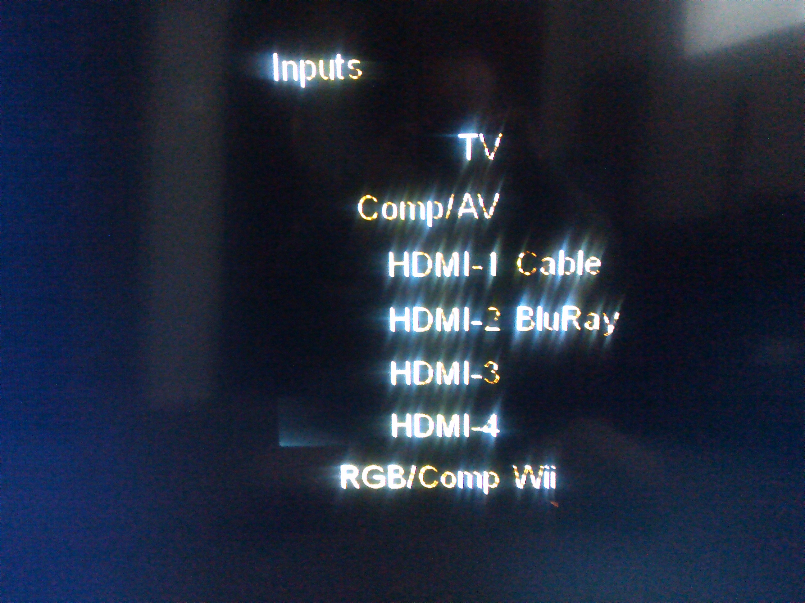

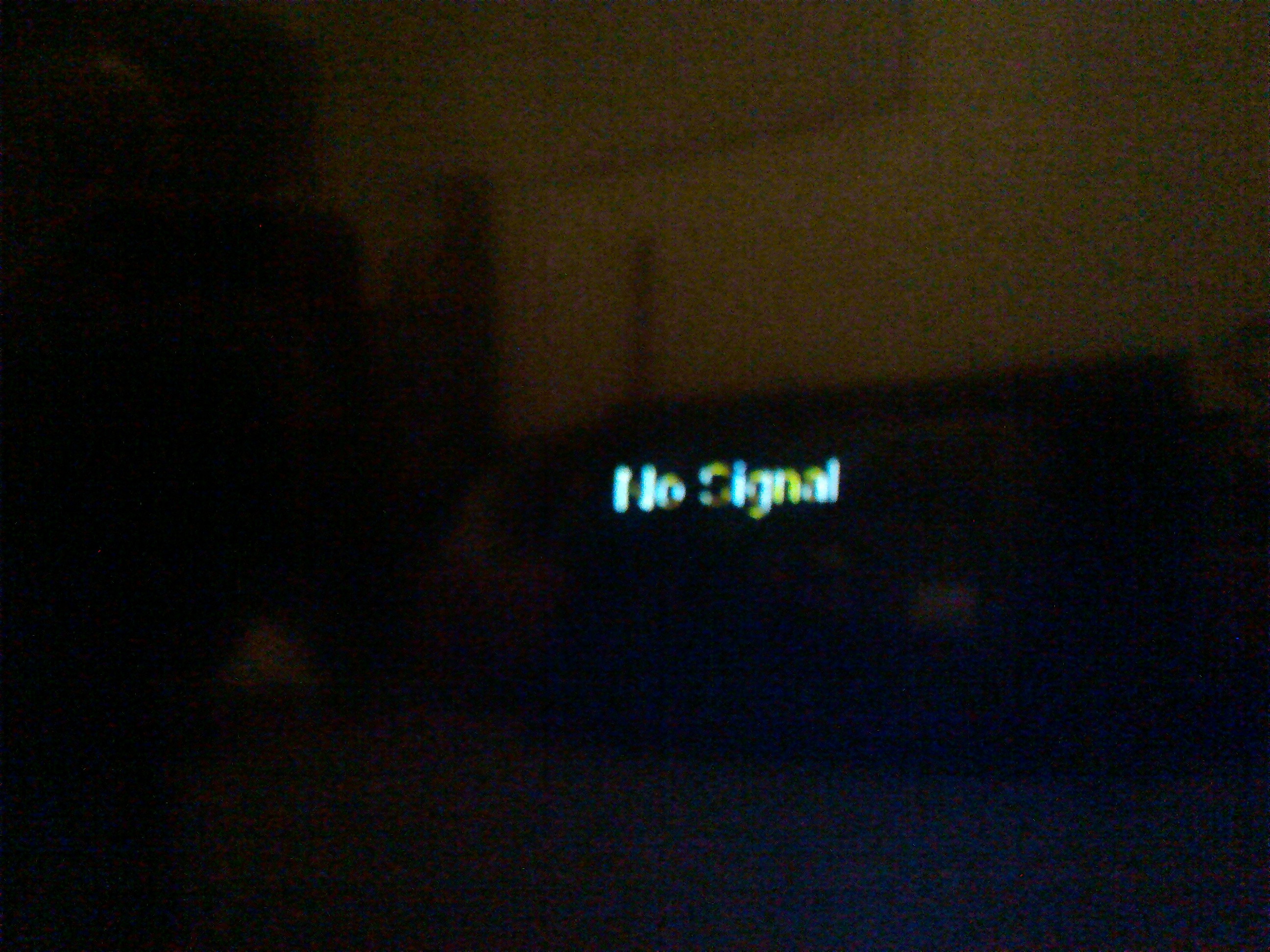

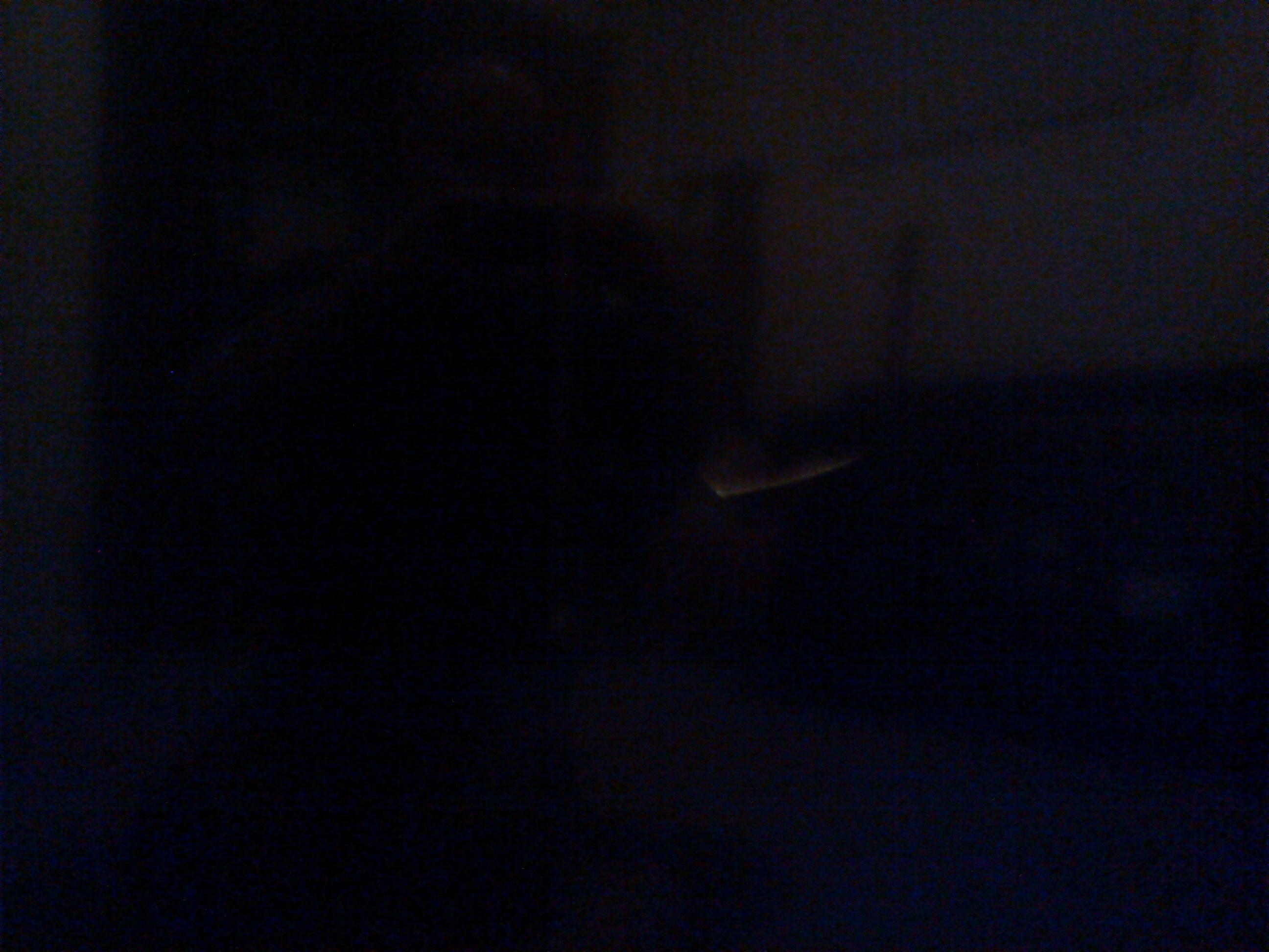

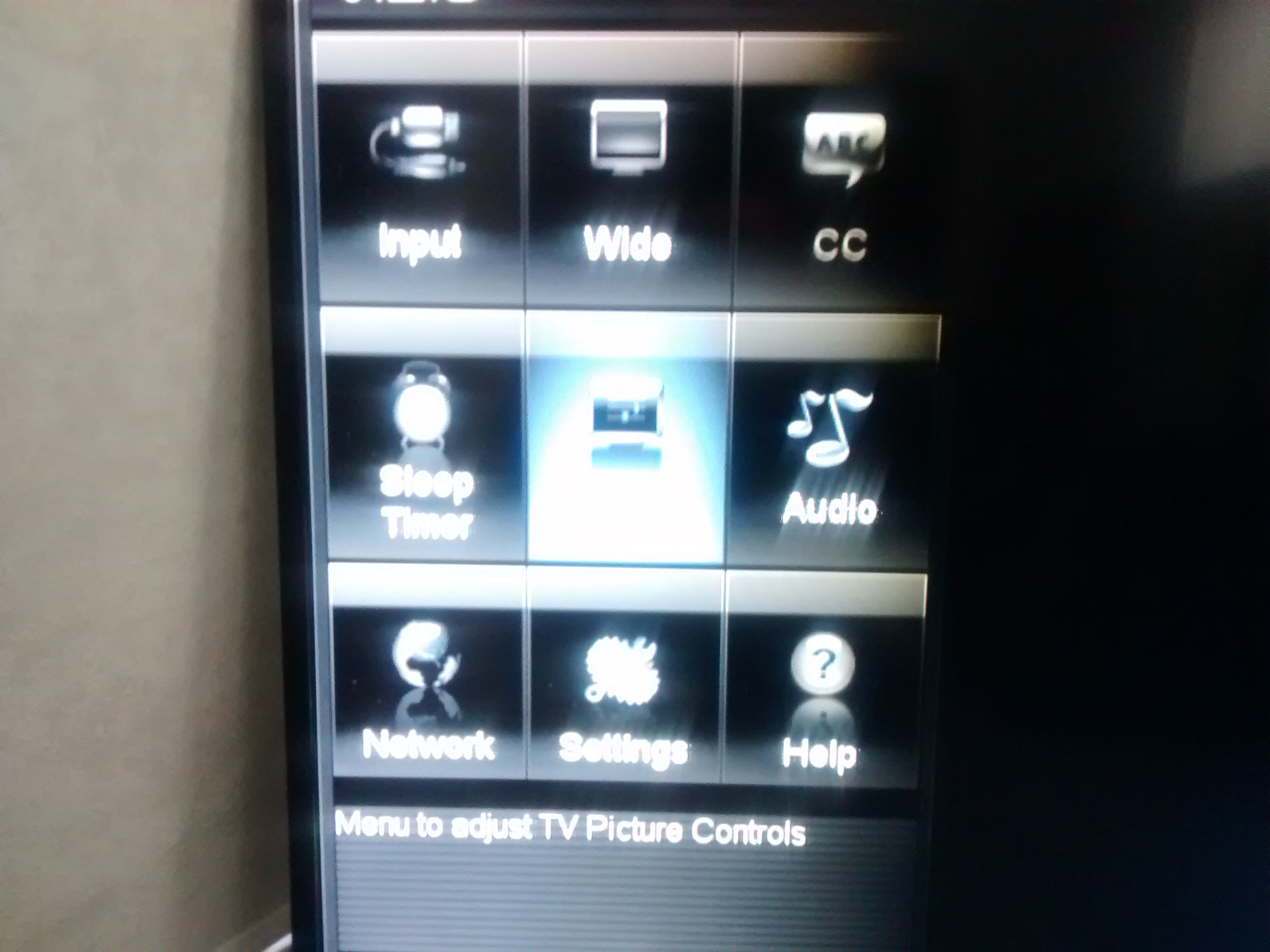

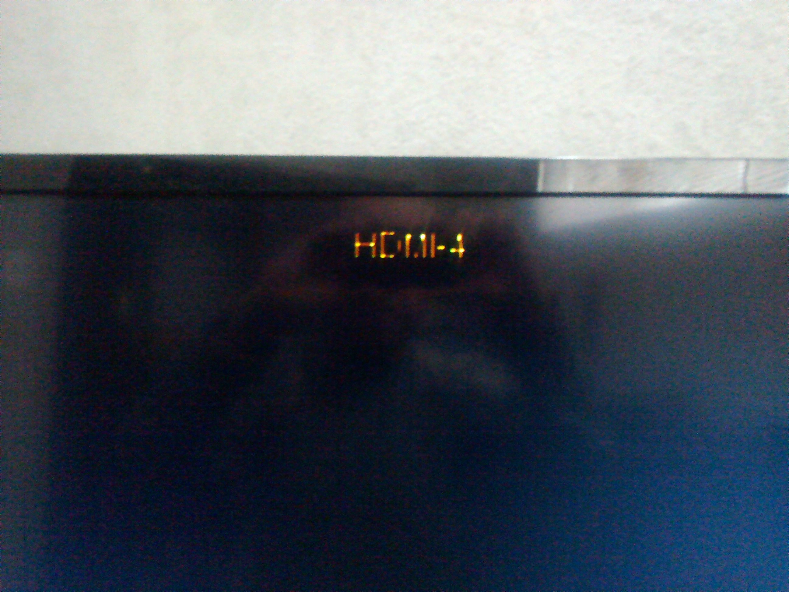

                                      #358
                                      Oh look at that I can post pictures...fantastic. So these are the results so far. A new t-con board has been installed and the bottom two ribbon cables are connected to it. ( looking at the tv from the front ) I have removed the lower right hand small ribbon cable. Now for the pictures
                                      1. Is the faint bottom portion of the "v" in the middle of the screen upon turning on the tv
                                      2. No Signal in the middle of the screen.
                                      3. Input on the upper right portion of the screen
                                      4. Input selection in the middle of the screen
                                      5. Menu selection of the left side of screen
                                      6. Is what the screen looks like with a chomecast connected.
                                      Not a single horizontal line to be found, Should I be concerned about this?
                                      • freakaftr8
                                        • Oct 2012
                                        • 3743
                                        #359
                                        I don't know man that's a real crap shoot. It almost looks as if there's nothing really wrong with the drivers the right side of course will be black because the right side is not being driven by the bottom cable. If I were you I would temporarily connect the right side power it up give it a couple seconds and immediately unplug it if nothing shows up on the screen. There is always a slight possibility that you just had a bad tcon board.
