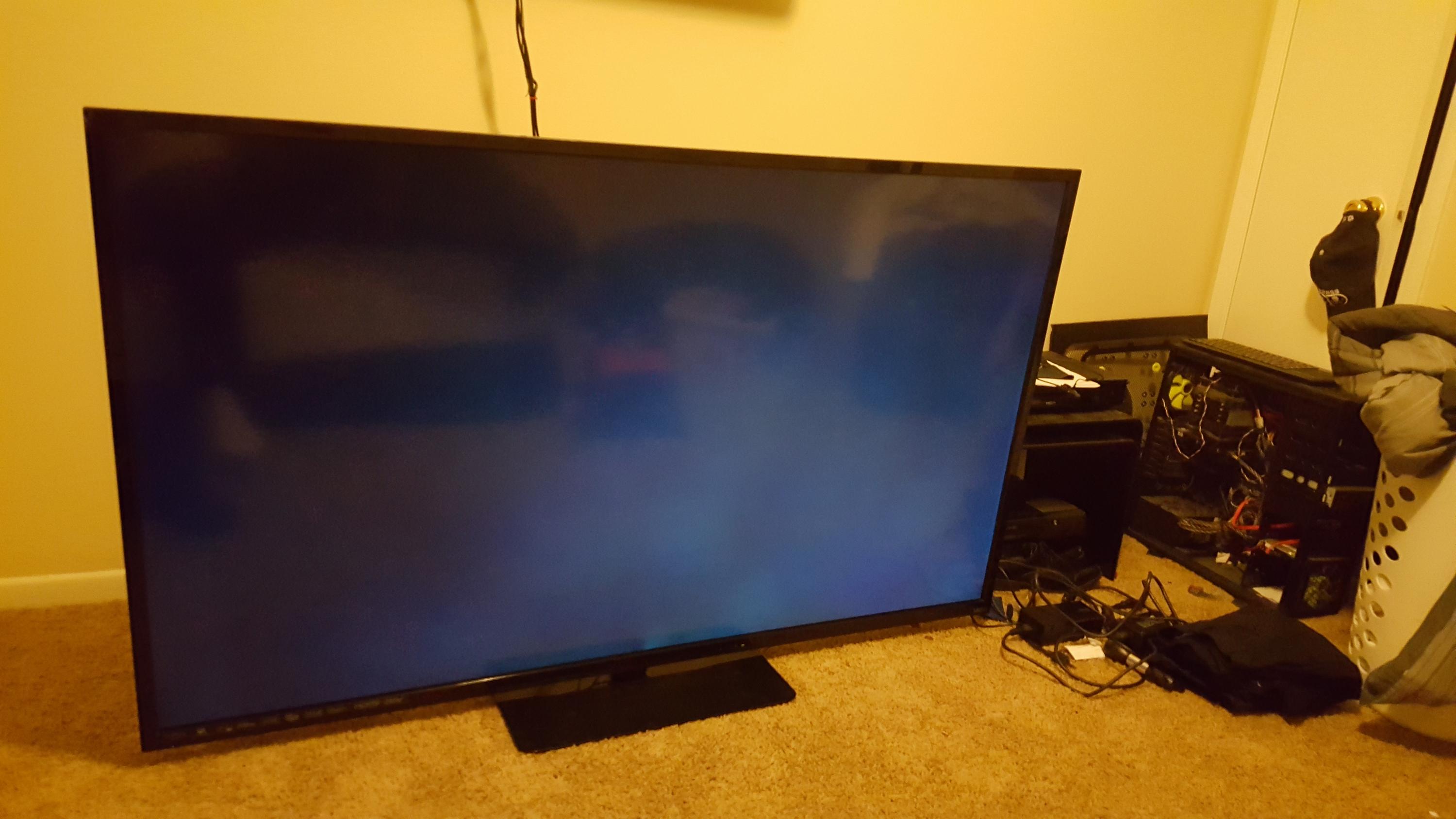

          • Lynk783
            • Apr 2016
            • 23
            #505
            Re: e701i-a3 no picture but backlights
            Ok so what's the suggestion to solve my problem? I have the vizio 70in. I removed the strips from the right side of the tv. It worked for a month and it went back to no picture only audio. If the chip doesn't apply to my case do I just buy another tcon board? Thanks
            • Lynk783
              • Apr 2016
              • 23
              #506
              Anyone????

                • T3xasa22a22in
                  • May 2016
                  • 11
                  • Usa
                  #508
                  What can any of you tell me about this picture attached? Recently purchased a new tcon board marked the original ZH. And this is the end result. Want to get my tv fixed any way i can.
                  • ReeceyBurger123
                    Never Give Up !
                    • May 2014
                    • 7325
                    • Britain
                    #509
                    Read the thread ?

                                • T3xasa22a22in
                                  • May 2016
                                  • 11
                                  • Usa
                                  #516
                                  Ok, now that im off work, i replaced the tcon board and it still had no affect on the tv. But the screen did get brighter. Just no picture.
                                  If i understand this correctly, i need to access the drivers, amd disconnect them one side at a time? Or should i access them and inspect the ribbons and drivers themselves to see if theres any indication of burns etc? If theres no indication, should i just disconnect them ine side at a time, as well as disconnect them going TO the panel? Thats where im a bit confused.
                                  And i need to do this with the tcon board installed? I dont have a volt meter (with me) on hand, so im working with a fixed set of tools.

                                    • budwich
                                      • Jul 2015
                                      • 3097
                                      #518
                                      the driver board ISN'T the problem. The problem is caused by the TAB DRIVER CHIP "embedded" in the panel tab cables.
