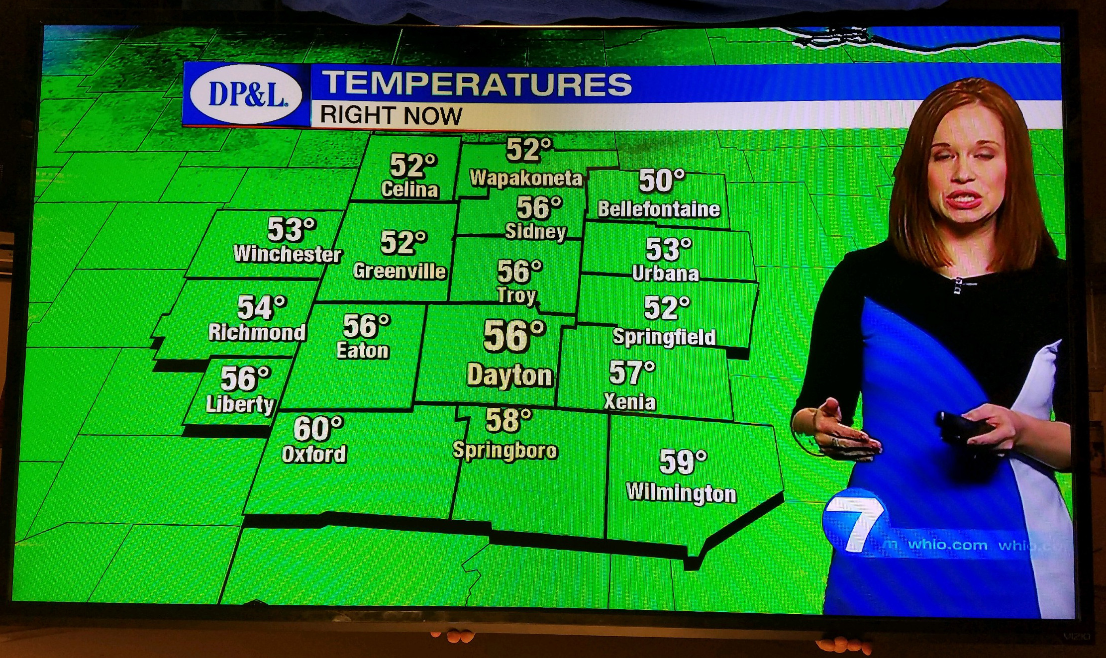

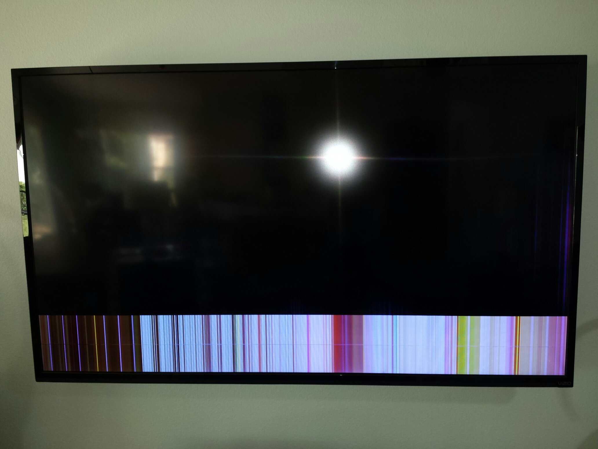

            Re: e701i-a3 no picture but backlights
            Ok, baby steps.. so I plugged in the left cable from the output on the tconn board, and I disconnected the connector at 2R and I have what you see here:
            I didn't try the reverse because that's what killed my tconn before (just want to be 100% sure it's the right side before I pull em off still).
            Then I pulled off both 2R and 2L and I get this (just leaving vertical driver boards connected) and connected both outputs from tconn and I get this:
            This is the screen it's supposed to be:
            Is this on the right track or are my vertical drivers f#@cked? Just don't have the balls to try the right side to not blow another tconn..
                        Yes it would appear your right side is toast. The top picture shows your left side works. Leave those alone.

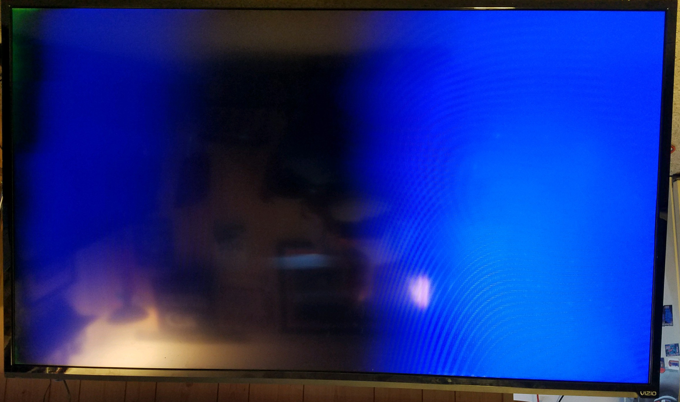

                                  Got the cable disconnected (for others it is right behind the control panel on the side). Picture is fine on the right side, but the left is darker and redder. It seems to be the worst at the middle and gets a little better as it gets near the left edge for some colors like green. Red washes out most of the left side.
                                  There are no lines that I can see.

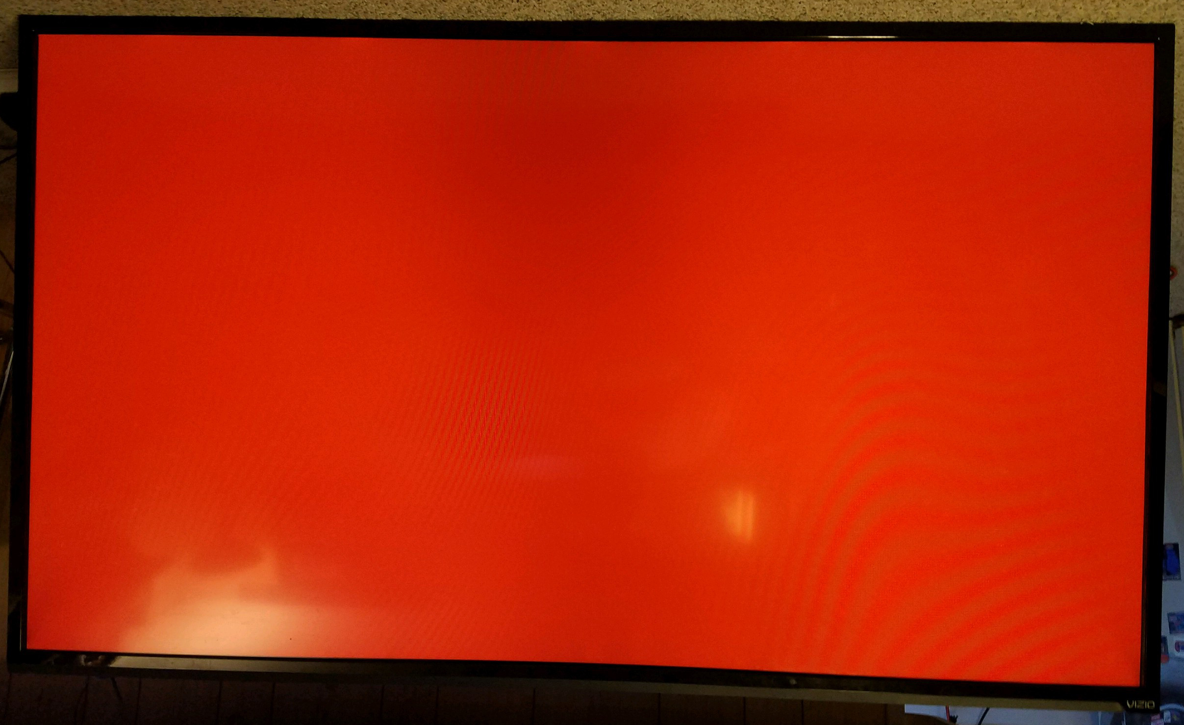

                                      Here are some Test Patterns: SMPTE, Indian Head, Solid Red, Solid Green, Solid Blue. The waves in the solid colors, are not on the TV. The Yellow /white in the
                                      Solid colors I think are from the Flash or light glare, since they are not on the TV.
                                      When the Video goes from Red to Green to Blue it takes a little over 1 sec for the color to fill in on the left edge. See RedGreen and GreenBlue image.

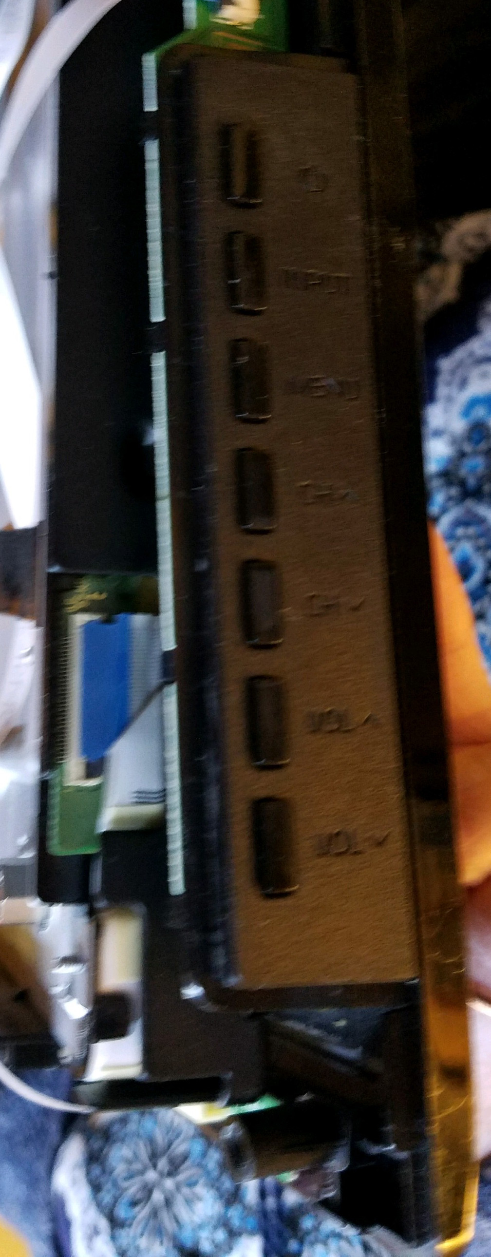

                                      The Control Panel (power, volume, channel) on the lower left side behind that is the white ribbon cable I removed from it's connector. The blue end is laying in front of the connector. That white ribbon cable goes under the TV and connects to board on the bottom.

                                        good stuff. hmmm.... certainly doesn't appear to be a "normal tab driver" issue... although depending on where and how the driver is compromised, it can have lots of different impacts (based on others that have been posted). You might want to look at the tab drivers / ribbons along that side to see if any are looking "not so good".
                                        I am somewhat "leery" that you have a side issue. Some on other sets have had problems with the seating of the corner cables. Once properly seated, there "problems" disappeared. I guess the question is... do you more replacement FET's that you could replace if you connect the cables all back up with the risk of taking out the FET again?
                                        I guess the picture with the red / green smear is probably an indication of a tab problem. Question: the disconnected corner cable... is it disconnected at the bottom board or at the side board? IF its at the side, meaning its still connected to the bottom... maybe its an issue... ensure that it is disconnected at the both boards.

                                          I disconnected the ribbon cable from the side board only, the ribbon cable is still connected to the bottom board. It was easier to disconnect the cable on the side than on the bottom. Question / clarification: You want the other end of the cable disconnected NOT a cable going to the bottom board?
