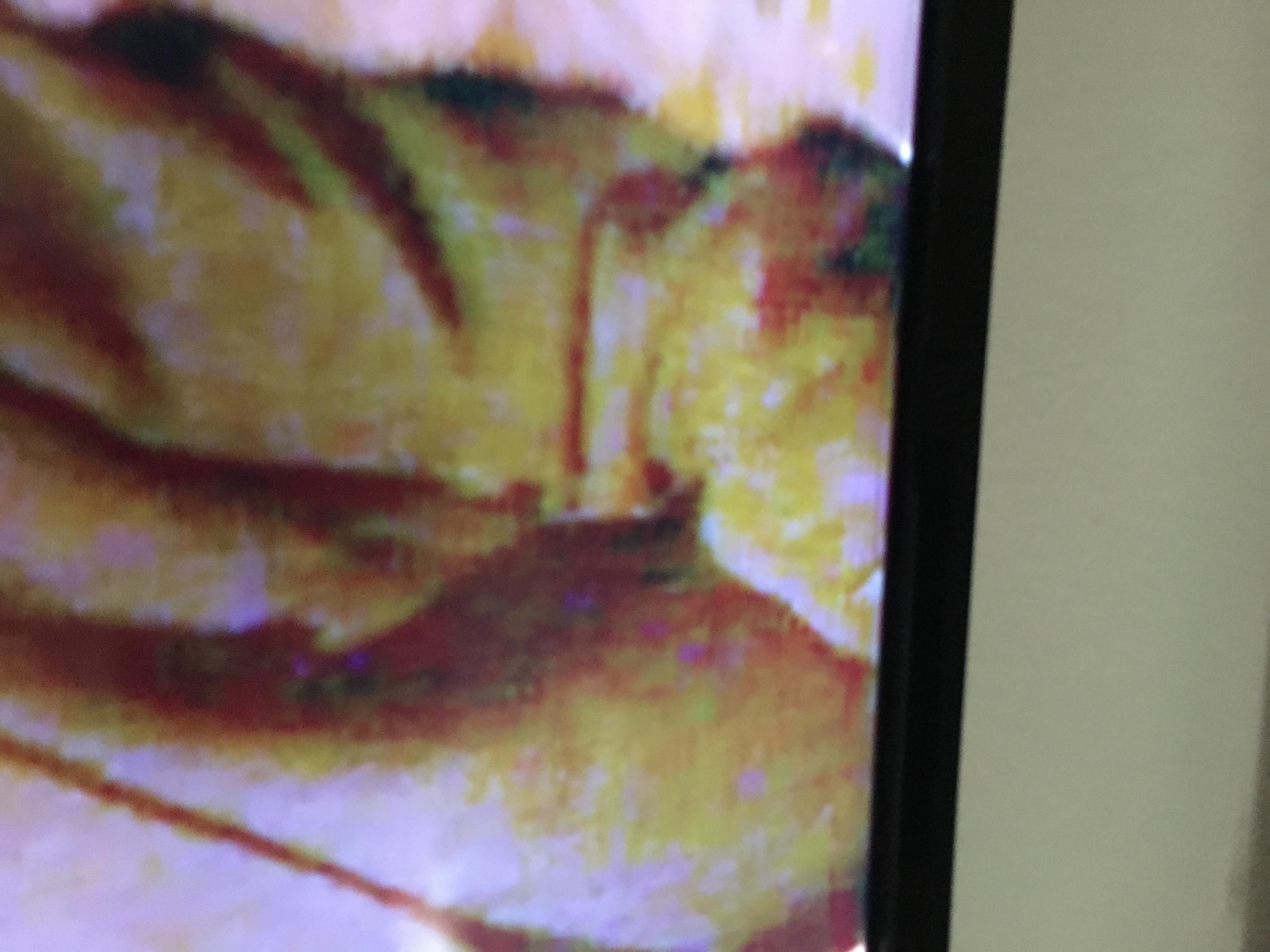

        Re: e701i-a3 no picture but backlights
        I am not sure if this is a problem with the vizio but watching direc tv I get a lot of what looks like macro blocking on dark scenes. It also has sort of a bluish look to it. I replaced my 70 inch rear projection tv with the vizio. I am going to swap hdmi cables and try a blu ray to see if it is still present. But it was bad enough for my wife to comment on how bad it looked. She wanted me to put the other tv back.

              #566
              Also could it be a t-con board issue perhaps? Before I had swapped out the one mosfet on the original board I had ordered a "new" spare from EBay which should be here today.
              • splatee
                • Jul 2016
                • 95
                #567
                Here is a pic

                    #569
                    Tried different HDMI ports and also component and still same issue. Almost like the shadow have a greenish sort of tinge and a lot of noise to them.

                      #570
                      Just hooked up PS3 and put the Dark Knight on and was same thing. If I set the black detail to high and gamma all the way up it lessens the noise but still noticeable. I will see if the replacement t-con will fix it. Oh and also I have a few of those small white pin dots on the screen.

                        #571
                        Macroblocking is most likely a problem with the main board. I suppose it could be a t-con board but have you tried resetting all the cables? Also the white pin spots. There's nothing you can do about that is a defect in the polarizer is behind the LCD panel I noticed this model as they age gets worse and worse. That was a sharp failure

                          #572
                          Thanks for the info. I had ordered a spare t-con just in case the original I could not fix. I will swap it out and see. As for cables I reseated all of them. I wonder if the LVDS cables may cause this as well? I ran across another post about on some vizios there was issues with green tinge in the blacks that was due to bad LVDS cables.

                            #573
                            Could be lvds cable. They seem to affect black areas more than lighter shades but I'm more suspecting main board or tcon. I'm leaning more towards tcon.

                                #575
                                Swapped out the t-con with the spare I got from eBay. Still same issue with the shadow/dark area of the picture with the noise. I did a factory reset from the service menu and went through the setup process.
                                If I set the gamma to 2.4 and black level to high I can clear it up a bit but I do not like the overall image. Also noticed that where the noise is it has a bluish tinge to it. If I go into the color correction and adjust I can clear it up some as well. I am wondering if this is a panel problem now?

                                  #576
                                  Here are a few more pics. Also I just noticed one thing. The replacement board is labeled ZH and original is a ZG in the part #. It almost seems like the replacement is worse with the noise.

                                      #578
                                      Originally posted by euroryde
                                      So I thought I would try and fix another 70" as I had success the first time but I have ran into a problem, quick version. after removing tabs, new t-con tv is now working again but the screen quality isn't very good real pixelated / gassy looking pictures attached. I have tried cleaning all cables changed setting but nothing seems to be helping. Thnaks
                                      Going through the thread again I came across this posting at #397.
                                      This is exactly what I have going on. He tried a replacement mainboard and still no change.

                                        #579
                                        That's odd the only other thing I could possibly think of is dry cleaning the contacts of the lvds cable with denatured rubbing alcohol

                                          #580
                                          That was going to be my next step. I was also going to check the side panel driver ribbon cable also.
