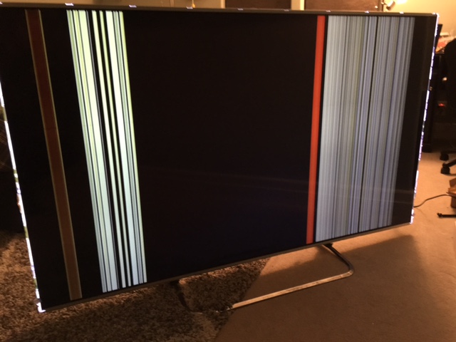

    So I thought I would try and fix another 70" as I had success the first time but I have ran into a problem, quick version. after removing tabs, new t-con tv is now working again but the screen quality isn't very good real pixelated / gassy looking pictures attached. I have tried cleaning all cables changed setting but nothing seems to be helping. Thnaks

      You notice how everything looks nice and clean and perfect on the right side of your screen but the left side is dark you got some lines going through it where the lines ascending horizontally are keeping up with the right side of the screen which is still connected to the Tcon. This is because the left drivers are shorted out just remove them off the screen completely
      Thanks freakaftr8, I'm ready to pull the left drivers off tonight. But what about my TCON? Is it possible to get the image I am getting with a blown FET? I'm going to replace the FET on one of my tcon's today but am still worried I could be replacing the wrong FET as my board is different. When I power on after pulling the drivers, is there a possibility for more damage if I power on with a bad TCON? Or will I notice some image artifacts of some sort?
      Right now I am planning on leaving the same TCON in (with a suspected blown FET) I have used in all of my tests for when I power up after removing the left drivers. If I see something unusual, I will power off and switch to the tcon with the replaced FET and hope that eliminates any issues.

        No I'm confident your tcon is good. You would have other symptoms.

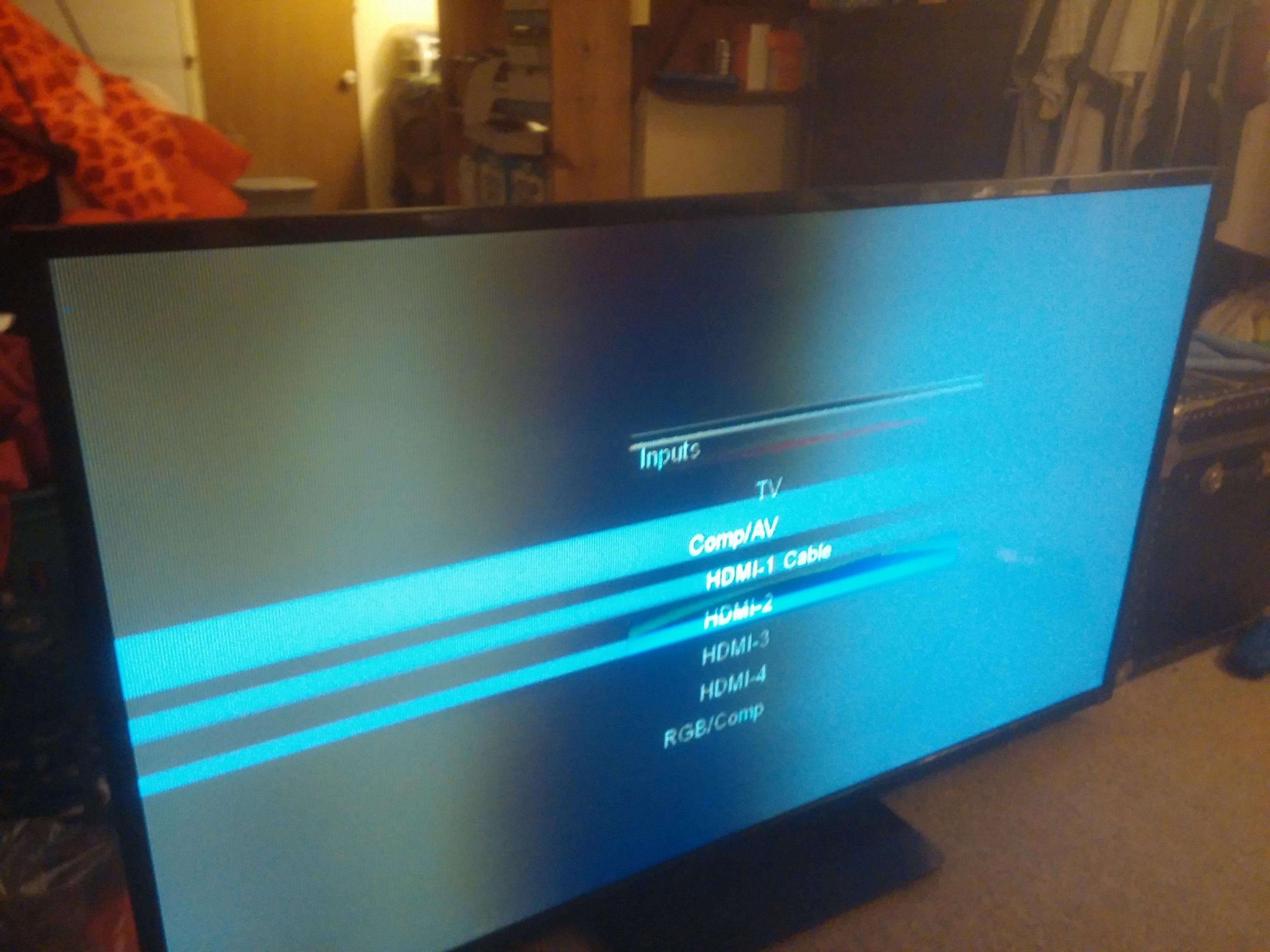

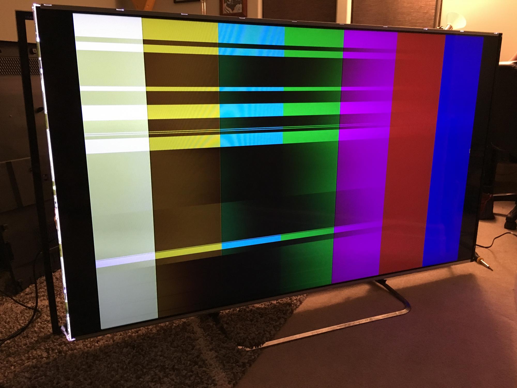

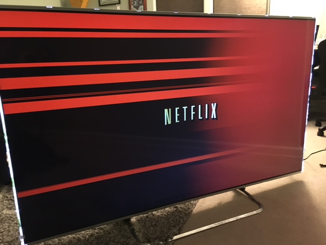

          Ya the picture posted is after cleaning the cables with a alcohol resea ting them. Same pixalation issue with just the menu, Netflix, hdmi and reseting. Will order up a main board and give that a shot. Thanks

            hmmmm... thanks for the interesting picture. As Freakaftr8 indicated, I don't think you have a tcon issue (or at least, a bad fet is not likely). Related to the "cable disconnection", not sure if I now know where things lie, so maybe a recap if you don't mind. The picture you posted is with one corner flex cable removed... correct? If you disconnected (ie switch sides) the other side, you get no picture... correct? Although, I understand you don't want to do that for too long as it could take out the tcon.
            IF the above statements are still true, I would still say you have at the very least a panel issue. Things to note from my limited experience and readings, that the failure of a tab driver is NOT uniform and can provide a broad range of "visual sypmtoms". BUT the disconnection of the corner cables is usually a pretty reliable "mode" for determining that the panel is the problem especially after checking / changing other items out.

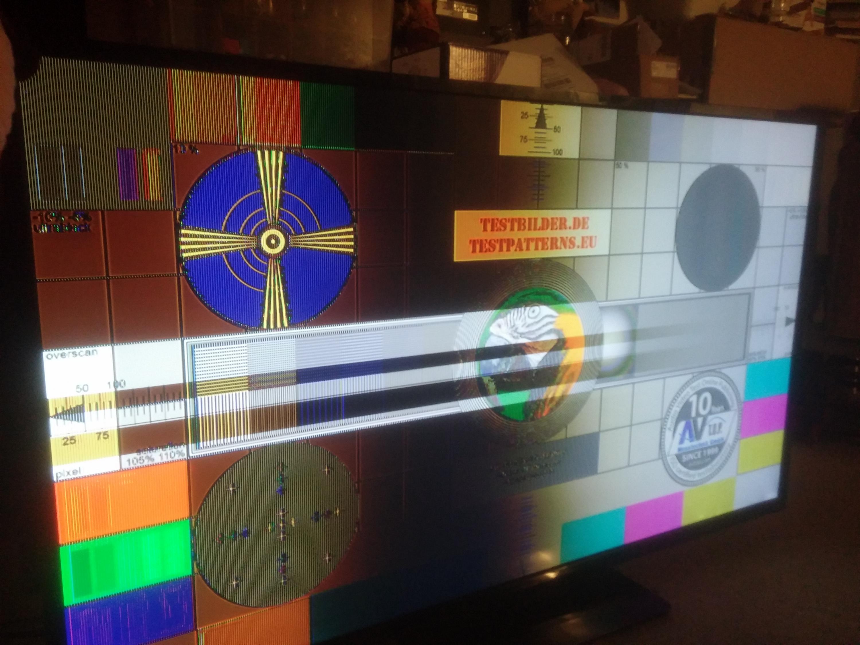

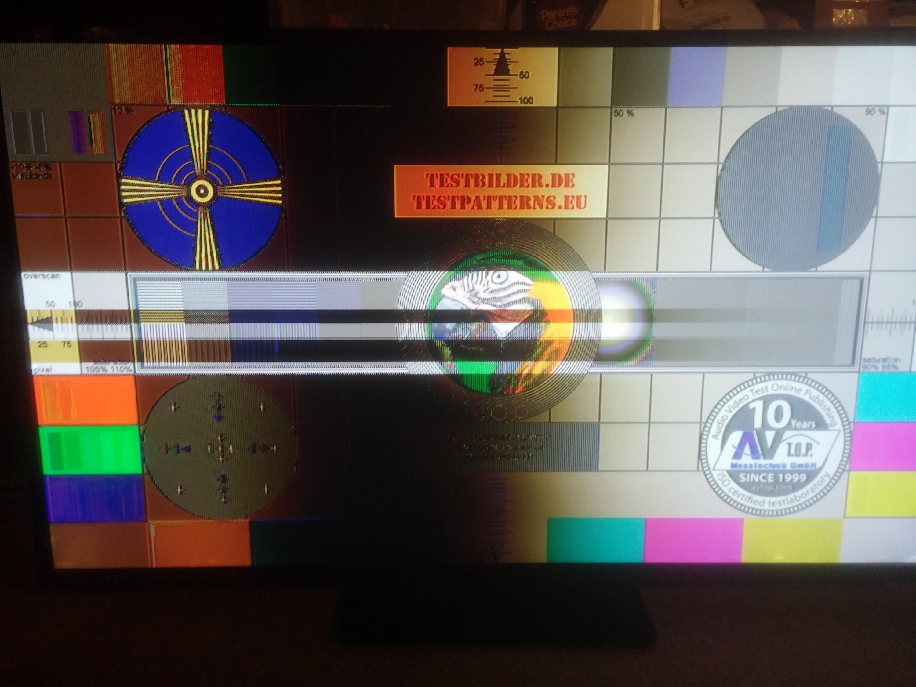

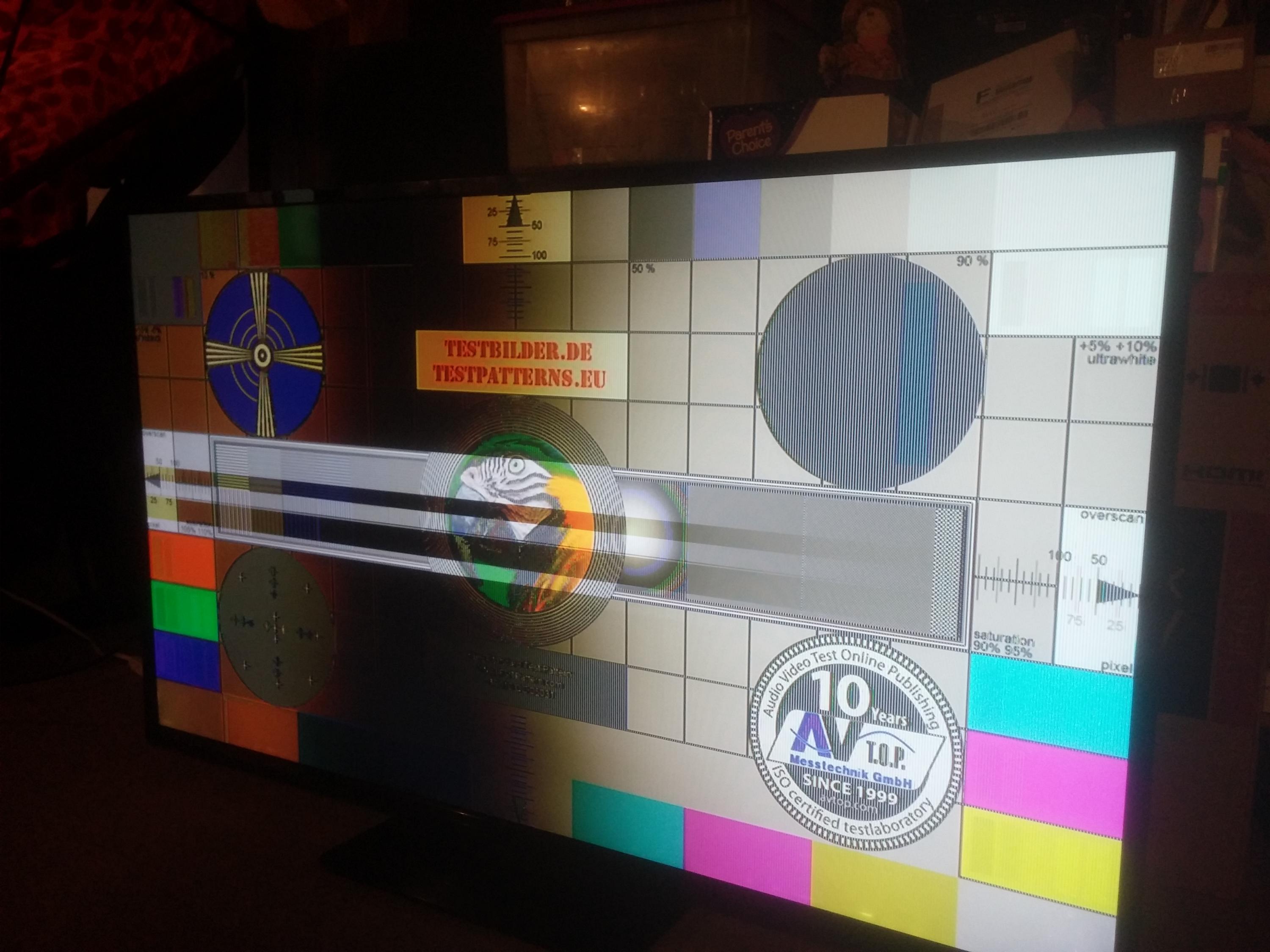

                I re-seated all of the cables and I swapped the main board with another one that came with the tv. Figured why not. The following pictures are with the left side looking at the display (right side when looking at the tcon) ribbon cable disconnected from the driver boards. I only got the menu up, I do not have any nearby sources, but if it is really needed, I can get one to the tv.
                When I took these pictures, I had no problems whatsoever besides the lines. The TV stayed on and I was able to bring up the menu and such.
                I do have a New tcon that arrived yesterday. I did not want to put that one in until I was fairly confident it would not get fried. The tcon in place for these pictures is my repaired one.
                The last picture is a mostly clear view of the repair.
                Whats my next step?

                  Thanks again for the feedback. I have re-seated all ribbon cables multiple times and cleaned the cables and connectors with IPA. Still same results. The first picture is the result with the LEFT side corner ribbon cable removed. The second picture is the image with BOTH side corner ribbon cables removed. I am hesitant to plug in only the left corner cable as that is certainly the offending side and I don't want to smoke a TCON. The third image is the result with BOTH side corner ribbon cables INSTALLED. As you can see from the picture, I get the same results when I have only the RIGHT corner ribbon installed as when I have BOTH corner ribbons installed.
                  The side drivers on the left side aren't obviously smoked/heat damaged/etc. but two tabs do look a tiny bit discolored around the middle of the tab near what I think is the IC people have referred to. However, when I lightly press on the side tabs some rows of pixels come back to life then disappear when I release pressure.
                  I am now very convinced the LEFT side drivers are bad. Might take the chance and pull them off now. Thanks for your help again and let me know if anyone has another hypothesis other than the left side drivers.

                    Jim1590 give me a picture with something playing on the screen but you definitely have a bad driver
                    gormanrider8. Go for it. That's your problem

                          Wooooooo! Removed the left side driver tabs and perfect picture! THANK YOU all so much I definitely couldn't have done it without freakaftr8. Thanks for being so responsive and helpful. I have it fully set up and looking great with cable through HDMI.

                              Lower left cable is disconnected as we are looking at the TV display.

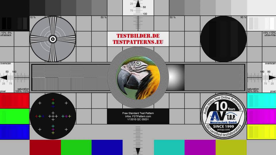

                              The test signal is actually a video I was running via plex that I downloaded from here:
                              https://vimeo.com/41414940

                                The first three pictures "appear" to confirm that side driver(s) have an issue. The confusing one is the last one, it looks pretty good.... what's up?
                                Never mind... you were just provide a "screen shot" of the test pattern software... :-)

                                  Yes Jim that left side is bad. Telltale sign is the nice bright working bar in the middle. Remove the left side drivers and boars off the side of the panel on the left side. This is the left side as you are facing the front of the TV watching it. Watch my video for instruction on how to do so.

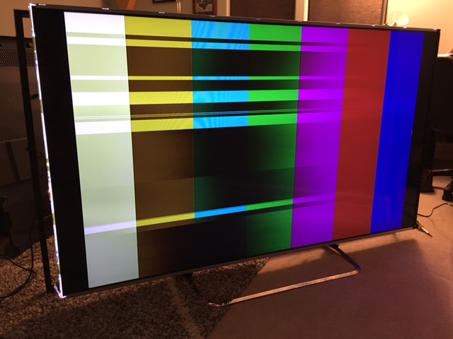

                                      And it is DONE! Removed the left side drivers by the control buttons and have a great picture.
                                      Swapped my repaired board for the new one I got and the tv would not display a picture. V for a few seconds then black. Repeated several times. Hmmm.... put the repaired board back in and enjoyed watching tv on it. Board going back.
                                      This is the first time using this TV, or anything this big. Picture is not as sharp as I was expecting. Not as clear so to speak. Probably the settings or my input.

                                        So got in another main board today tried it out and still the same bad pixelation, wondering now if something could be up with the t-con board. :/
                                          Re: e701i-a3 no picture but backlights
                                          could be ... but as suggested to others, post pictures of a known test pattern. That way people will know a bit better what to expect and may have suggestion on what they see.
