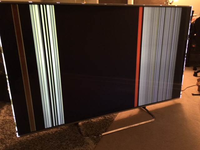

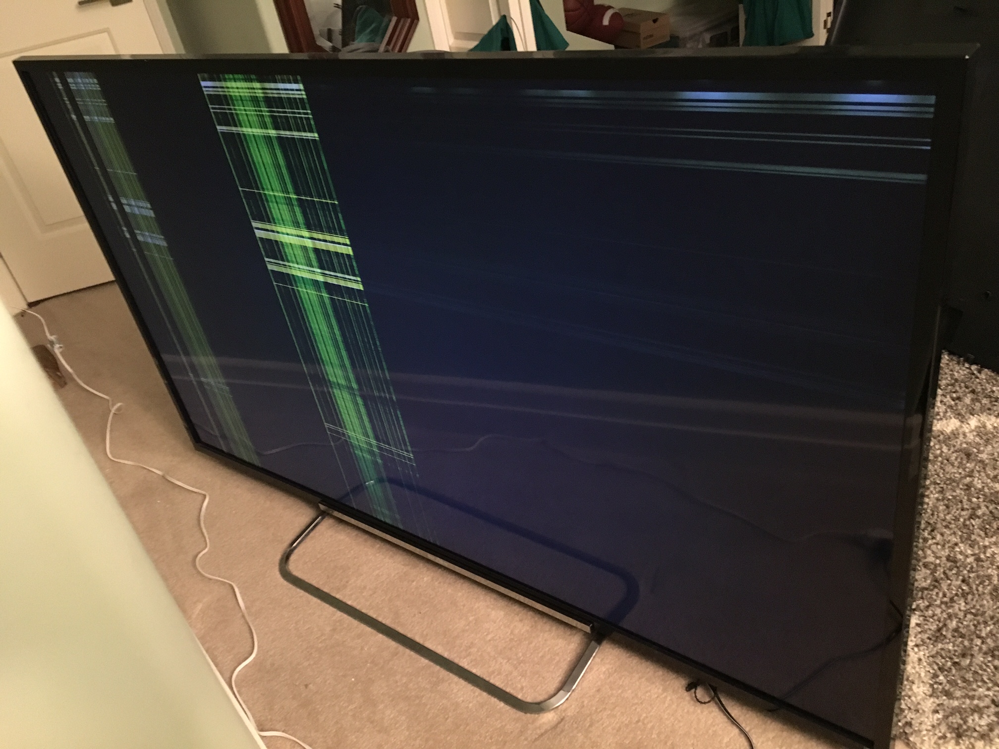

              #386
              Re: e701i-a3 no picture but backlights
              Hi All,
              I have a Sony KDL-70R550A which so nicely uses the Sharp display for their 70". I have been troubleshooting it based on other threads and freakaftr8's help and I finally stumbled upon this thread.
              I have attached 3 images to this post. The first image is the result when I removed the left TCON ribbon cable and leaving in the right TCON ribbon cable. The second picture is when I removed the right TCON ribbon cable and left in the left cable. This led me to believe there was a problem with the right cable/connector/panel.
              After some investigating, a tiny piece of the TCON ribbon cable connector/header (on the bottom/LCD side of ribbon cable) was broken on the corner so i removed it and reseeded the ribbon cable. The third picture then shows a picture of my current and best results yet.
              Now, I am unsure what family of problems I have from what I read in this forum: bad connection/seeding, bad drivers, or both. Before reading any forums I replaced the TCON board and powered on. Woops. So after measuring, both TCON boards have the transistor shorted (replacements are on their way). Do I need to go ahead and perform the tab driver removal? Or am I having a purely connection related problem? Or perhaps simply replacing the transistor will do? Thank you for your help. Especially freakaftr8
              - Tyler

                    #389
                    gormanrider, what ribbon cables are you removing? For diagnosing, we are leaving the 4 ribbons into the tcon alone and unplugging the ribbon cable on the side of the tv where it is plugged into the side boards. Look at the lower corner of the tv on both sides, not the lower corner of the tcon. You have to remove a shroud to get to them.
                    Are you getting those pictures with a bad mosfet??

                      #390
                      That looks.like you have a short or multiple shorts on the left driver side bank. As the right 1/4 half of the screen looks good. When you say you had a broken ribbon cable are you talking about the L Shaped cable that goes from the bottom drivers to the side drivers on the left bottom corner of the panel?
                      Also that is really odd that the transistor shorted on a Sony before the mainboard caught the failure and shut down the TV. But I guess accidents do happen and nothing's perfect. I would definitely say the left driver side Bank is bad and I would try to remove it. But this is of course your discretion. Normally the transistor shorts if there is a short in the panel and it definitely looks that way.
                      You of course can always pull the black bezel shroud off in physically inspect those chip on film driver IC on the left side and see if any of them look burned or darkened around the center From there I'm pretty sure you'll find your answer

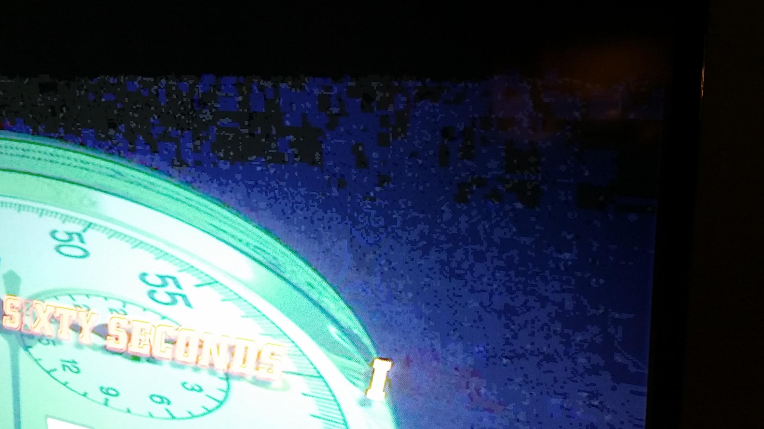

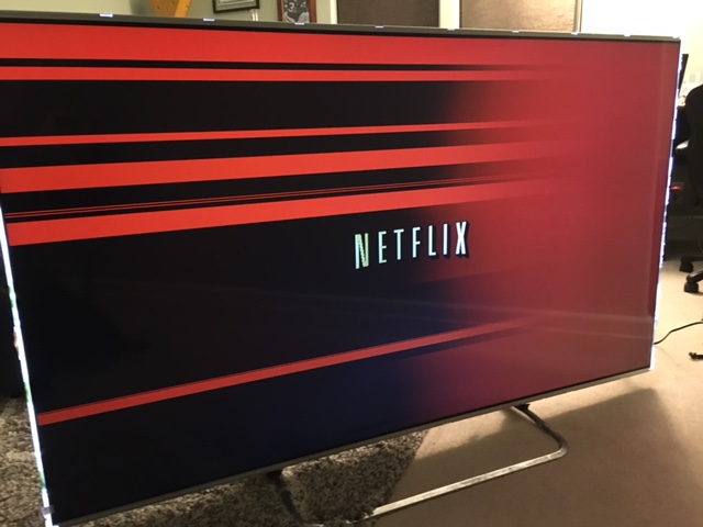

                                #395
                                Thanks everyone for your input. Sorry for the ambiguity of which ribbon cables I removed in my previous post.
                                --I repeated the test with the TCON board fully connected and only the LEFT bottom corner 90deg ribbon cable removed (as seen in the first picture).
                                --The results of that is the second picture.
                                --Still a good image on the right side but looked identical as when I had all ribbon cables connected (see image 3).
                                --The 4th picture is the results when I didn't have either of the corner 90deg ribbon cables attached.
                                As far the side driver tabs on the left, none of them look smoked or bad or hot to the touch when powered. The left side of the screen does come in and out of picture when I apply pressure. This leads me to want to go ahead and take them out.
                                And for the TCON transistor, my PCB is different than the one freakaftr8 posted in the first page. So I may be probing the wrong transistor on my 2 TCON boards, but the same transistor on both boards are shorted. This could be by design and maybe I'm probing the wrong FET.
                                Thanks for all your help again. I'm really hoping I can bring this TV to life.

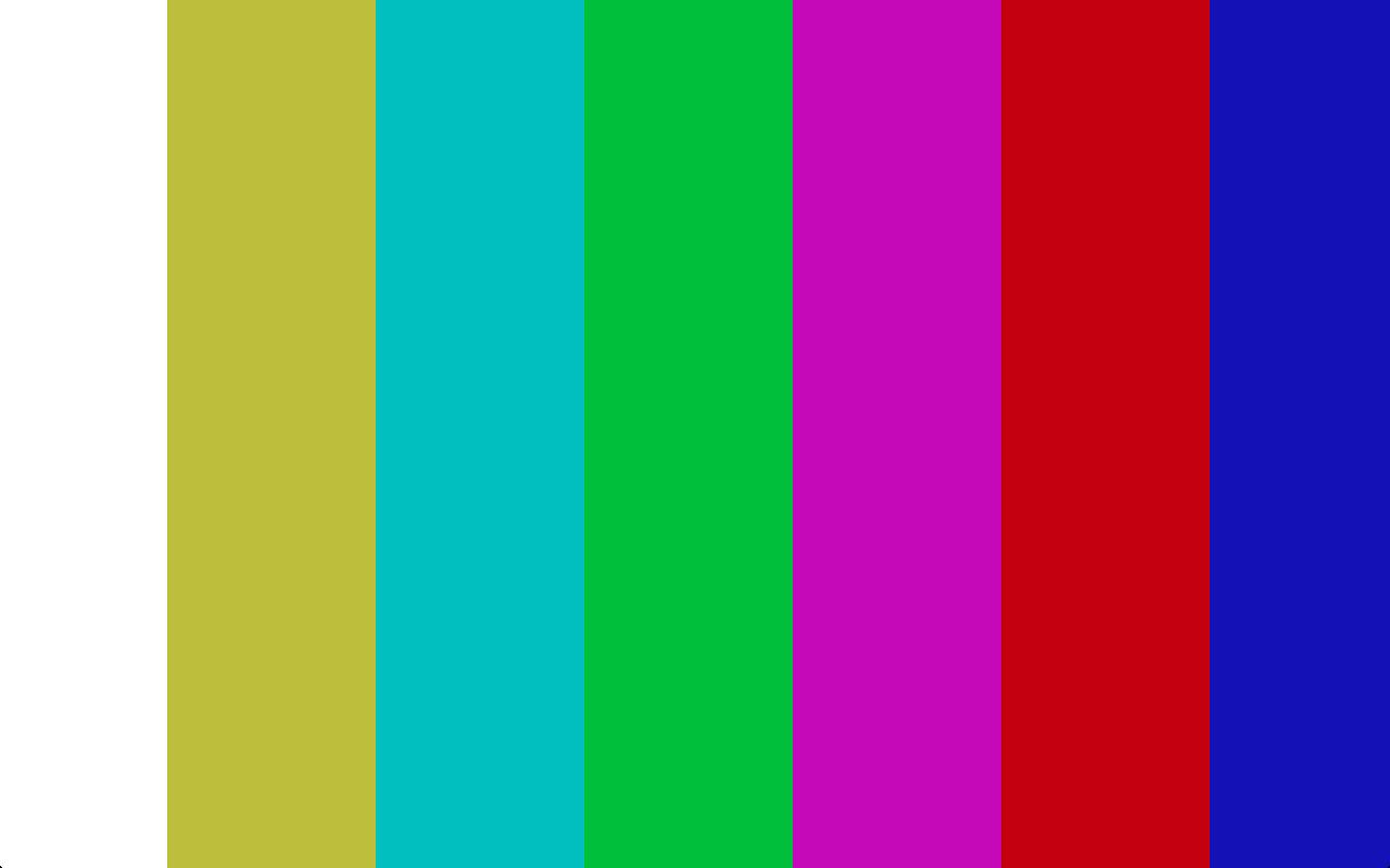

                                  #396
                                  You might help yourself out (and the forum) by inputting a known test pattern that can be found on a number of dvd's, useful one is the color bar test pattern. That makes it a lot easier to see / understand what you are looking at as opposed to a "random picture" that people may or may not know or see clearly.
                                  You are likely on the right track as removing a corner cable and getting a reasonably good picture means that side has got something bad about it.

                                      #398
                                      Good call Budwich thanks for the idea it made things more obvious. I repeated the test with the test pattern displayed and the left 90deg ribbon cable removed. The first picture is the test pattern I used. The second picture is the TV picture with the test pattern displayed. I used my laptop and HDMI to display the test pattern so the black regions on each edge of the TV are due to the different aspect ratios. I'm very convinced now it has bad left side drivers and I'm very tempted to pull them out.
                                      However, I'm still not sure if I am probing the correct transistor/FET on my TCON board, which differs from the TCON used in the other models. On both of my TCONs, the FET near the power supplies has the same two pins shorted but there is another transistor on the backside that isn't shorted. I bought replacements (N-channel, 45V, 2A) and am ready to bring them into work and make the replacement but I am worried the FET is different on my TCON. Would it be possible to see the picture I am getting with a blown FET?

                                        • freakaftr8
                                          • Oct 2012
                                          • 3743
                                          #400
                                          You notice how everything looks nice and clean and perfect on the right side of your screen but the left side is dark you got some lines going through it where the lines ascending horizontally are keeping up with the right side of the screen which is still connected to the Tcon. This is because the left drivers are shorted out just remove them off the screen completely
