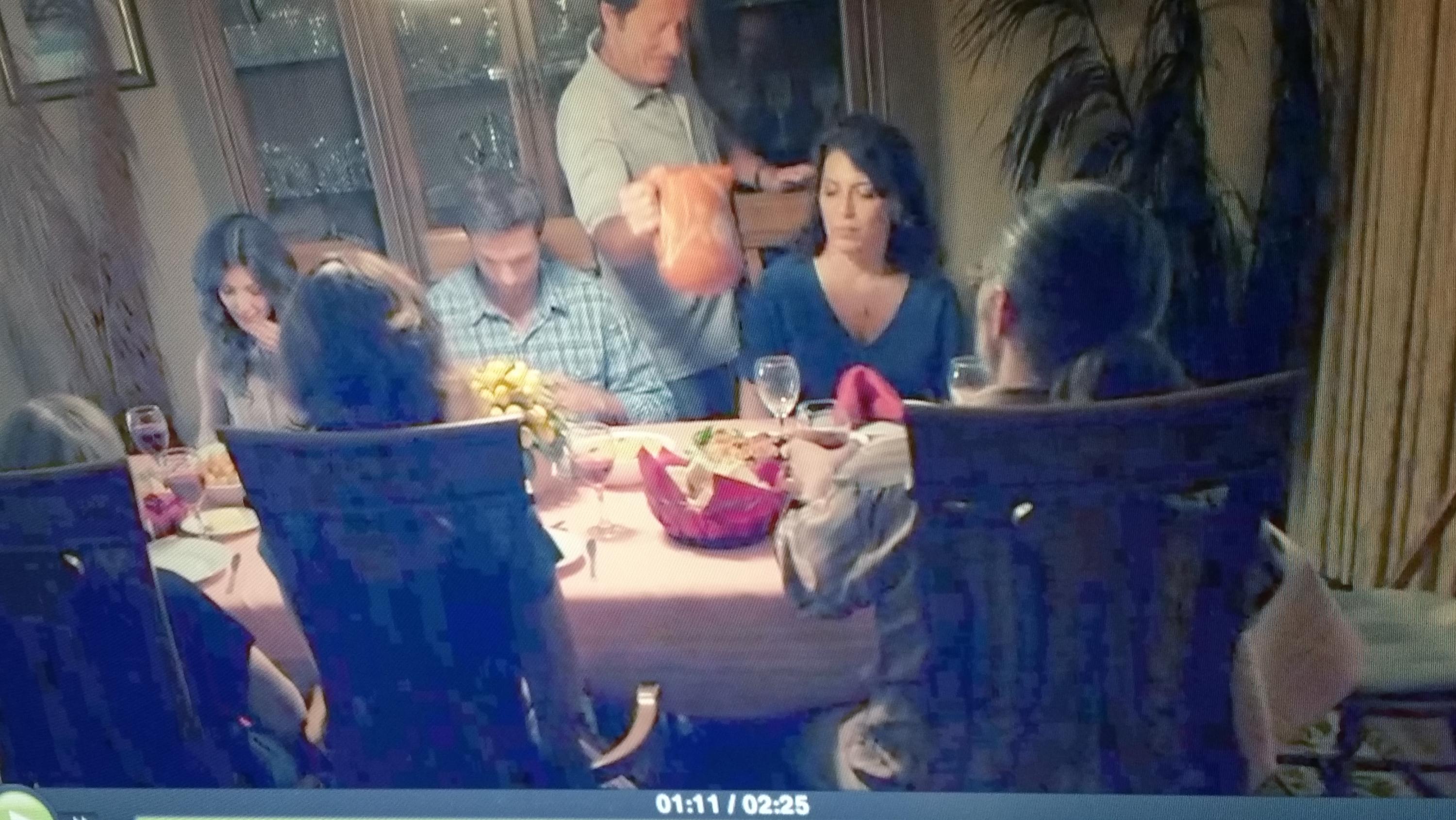

    ok will look for a test pattern, here is another picture with different main board but same thing more viable in the darker areas.
      #422
      Re: e701i-a3 no picture but backlights
      Looks just like low bitrate content. Blocking and banding is common on that type of content. Try a Bluray or other source.
        I get the same picture breakdown when I am streaming something from my home server with a file coded more towards small size vs higher quality. Even on my new 55" 4k LG.
        If you are in fact streaming from your computer, NAS, whatever, then put a video test pattern onto it that you can play. A picture test pattern works as well.

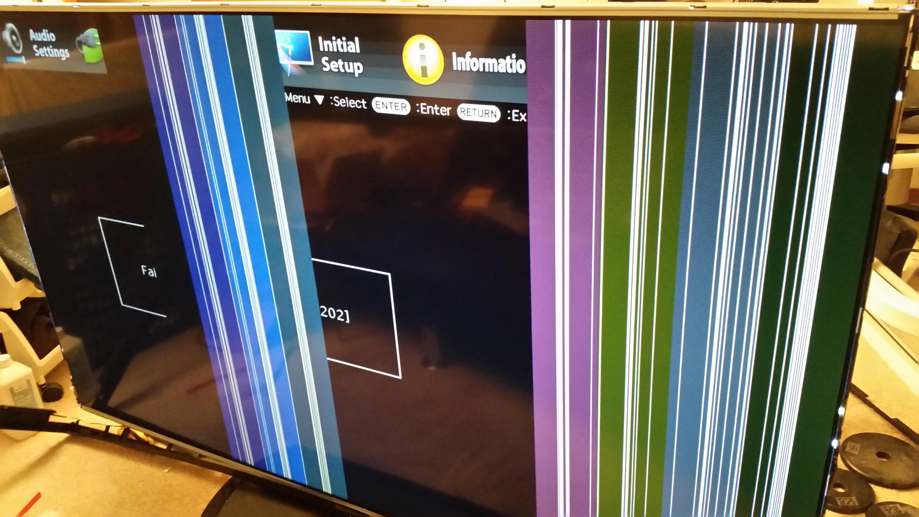

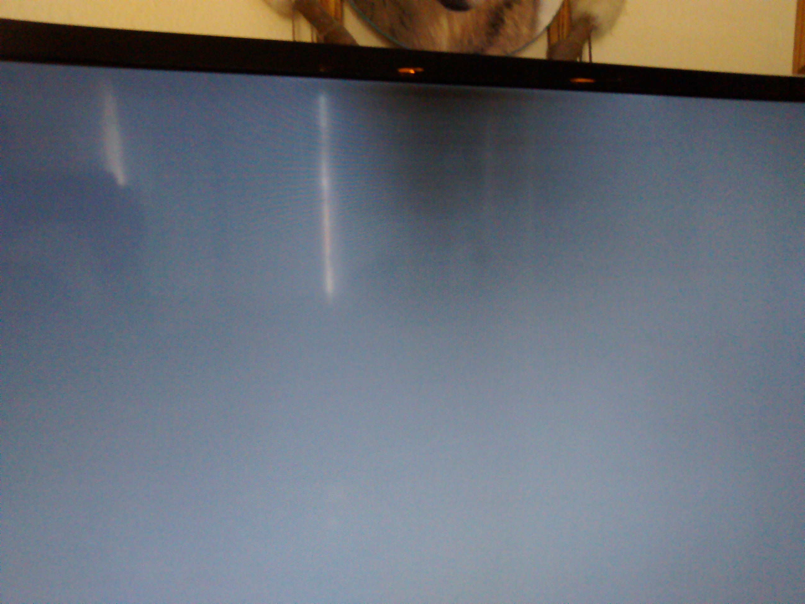

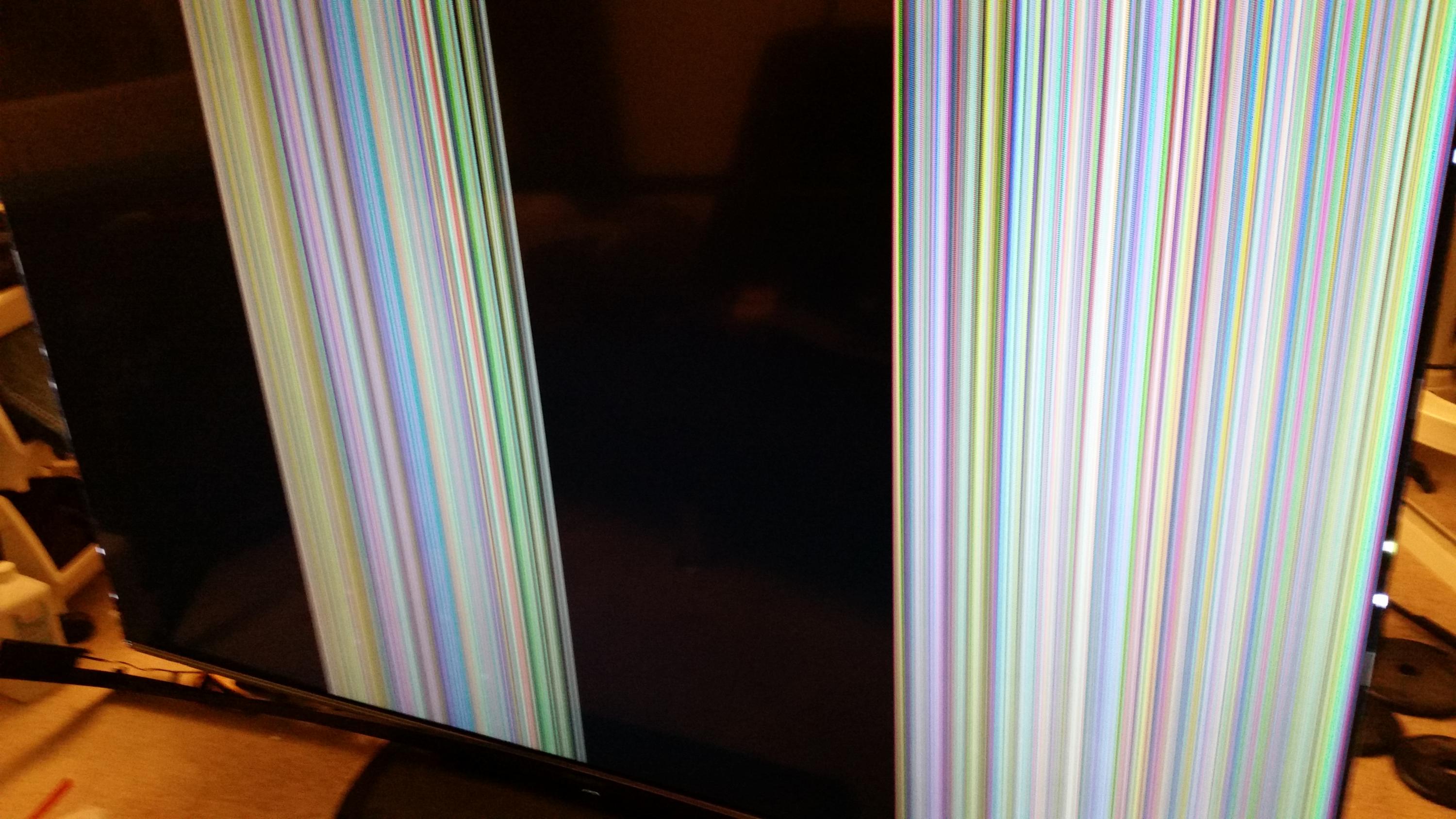

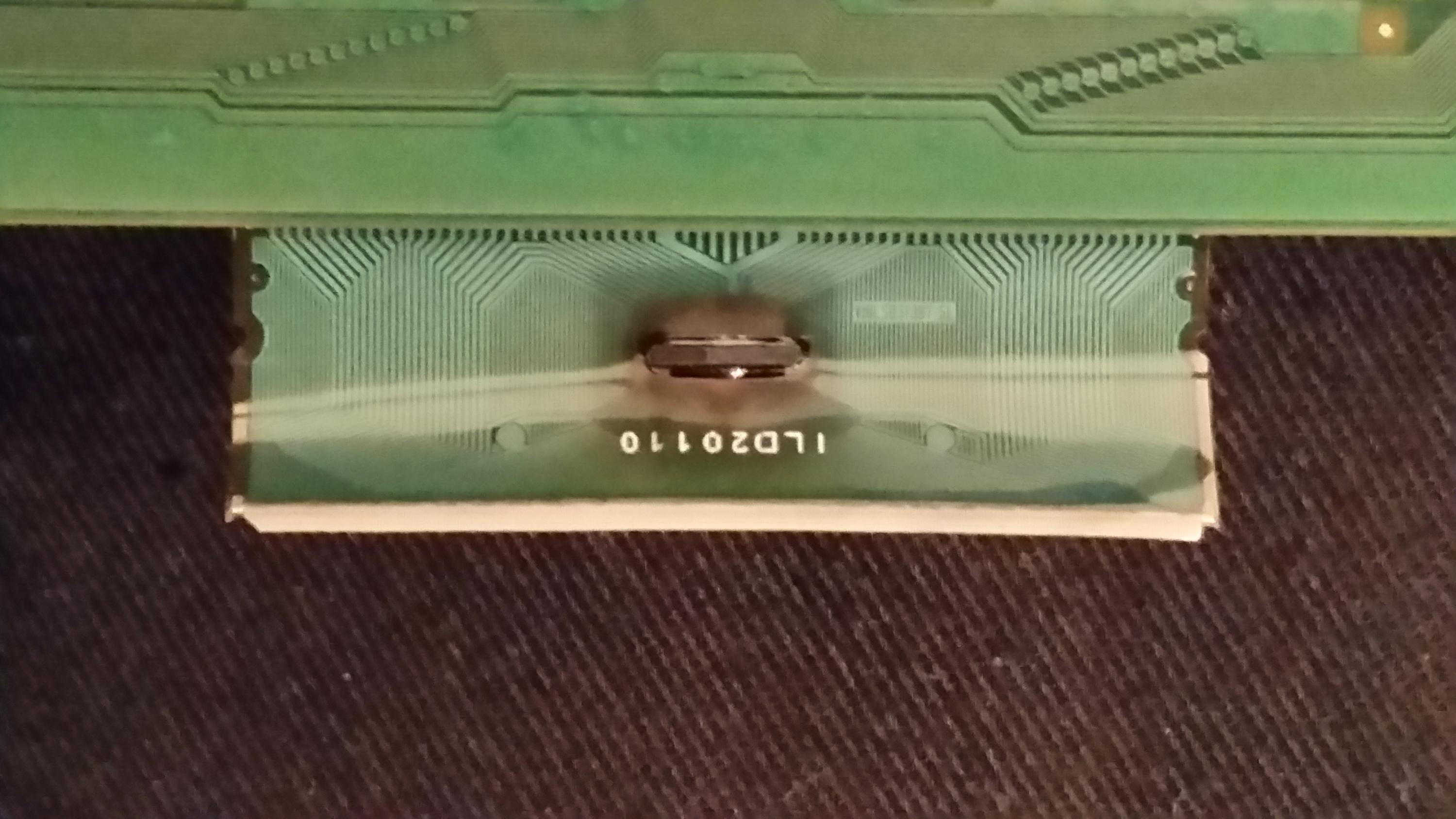

              Hello, Glad to see this still up as I have been following this and re-read it so many time.....I have a LC-70LE650U that I have been trying to bring back to life due to a bad panel fault and thanks to this post I was hoping it could be fixed/saved, but I'm not sure if it can be fixed now....as I have multi color vertical lines towards the middle and far Right side. I have brought a T-con board(Ebay) posted as removed from a cracked TV, but when I put that T-con board in after the removal of the side driver boards I dont get a pic/image of anything just the vertical lines. But when I put the original T-con board in I get the Sharp logo and menu, but with a kind of different thickness in the vertical lines. So my question is do I need a new T-con or is this just a vertical panel problem that can NOT be saved
              Things I have done:
              I have located the bad side which is the Left side while facing the front of TV
              I have identified the bad/burned driver board on that side
              I have disconnected the lower Left side cable(Right side still remains connected)
              I have went ahead and removed the whole Left side driver boards from the panel(All 5)
              Pic 1 = is the driver boards removed from the Left side when facing the TV from the front
              Pic 2 = is the bad/burned driver board that was on the Left side when facing the front of TV
              Pic 3 = is with the new T-con board with no image just vertical lines
              Pic 4 = is with original T-con with a image,but vertical lines

                #427
                My "gut" is telling me you have a cabling problem ... probably after playing with the tcon cables... :-) have you got your glasses on when you re-connect the cables.... :-)
                I think there are drivers in the bottom boards... have you carefully check those for issues... the bad news if they are a problem, there is no save. :-(
                I think there are "coupler cables" between the bottom boards (ie. two boards per side)... what happens if you disconnect the "coupler cables" on one side? It doesn't look good but I am still thinking a cabling issue to the tcon... check / clean cabling closely.

                  #428
                  I haven't Checked the bottom cables at all. The picture cleared up once I removed the Left side drivers. I will check and recheck all cables when I get home from work here in a few. Thank you for the input Budwick

                      #430
                      switch the cables around and see if the problem follows.

                        #431
                        Nope no dice, same issue no change. grrr not sure if it's a T-con issue or cables to the T-con...but it's probably just a dead panel :-(

                              #434
                              When I disconnect the Left cable from T-con(facing the back of TV).......but left side has those vertical lines towards the middle left but produced a NEW set of vertical lines at the far left of screen as well(facing front of TV)
                              When I removed the Right cable from T-con(facing the back of TV) there was no change same vertical line on the far right of screen(facing front of TV)
                              Hope this is not confusing you, if so I'm sorry
