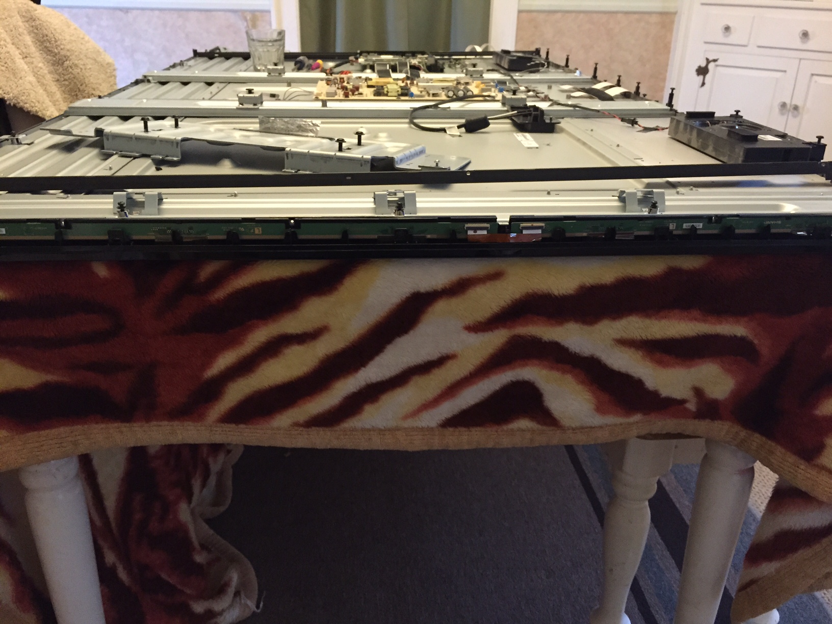

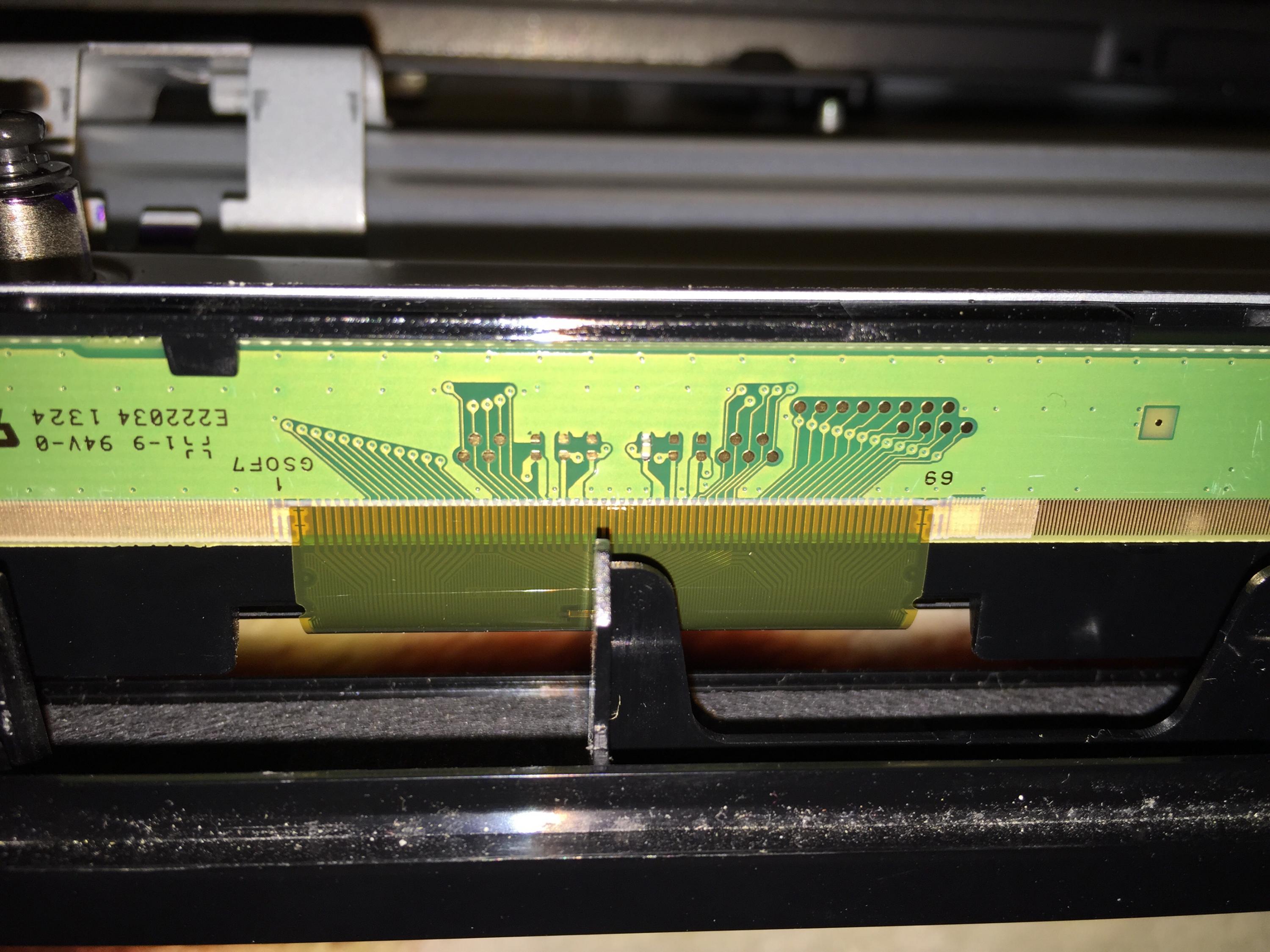

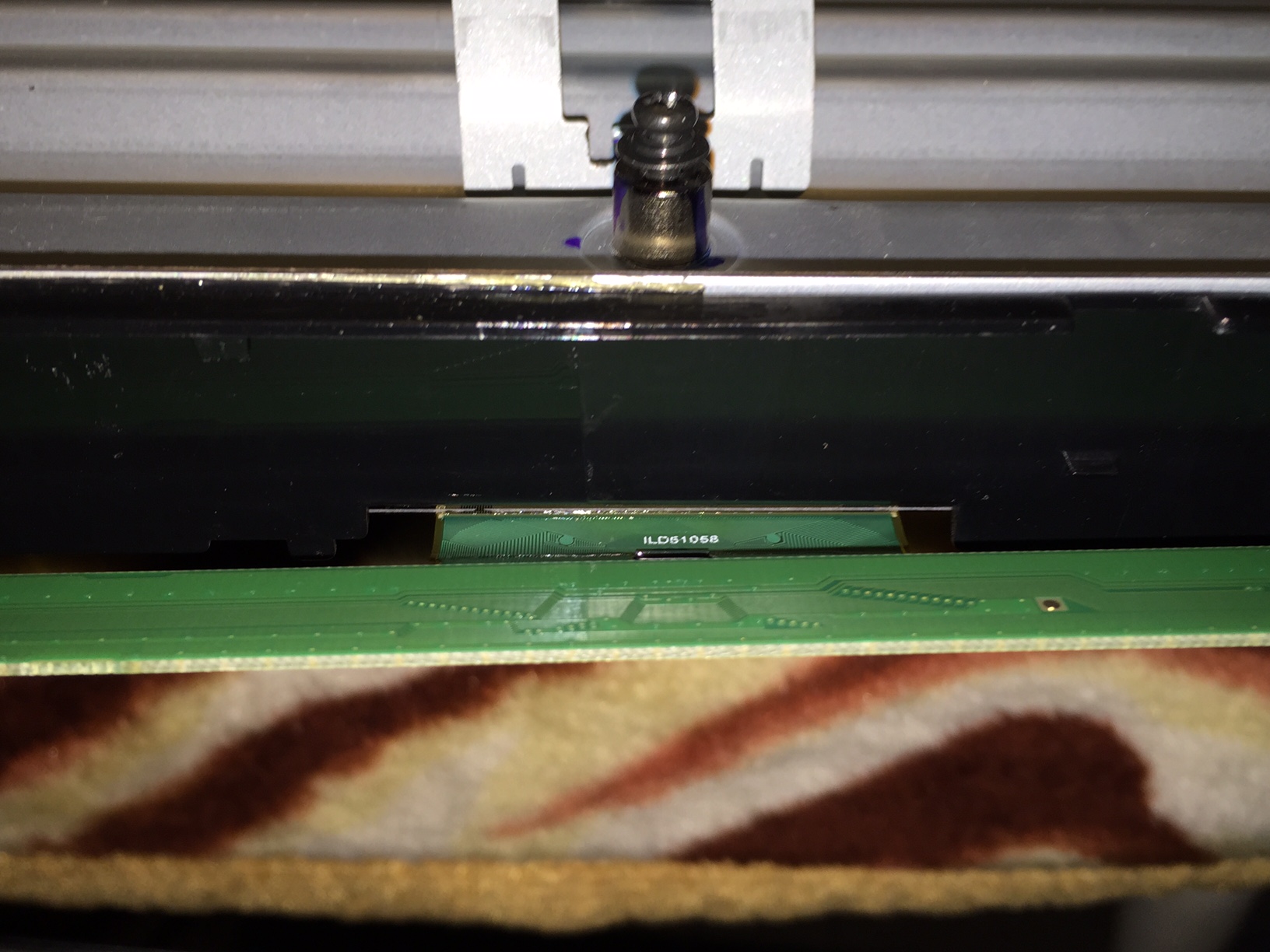

    Here are the pics:
    1)1st one is with both tags attached.
    2)2nd pic only with lower right ribbon tab disconnected.
    3)3rd pic only with lower left ribbon tab disconnected.
    Thanks for your help.

      Re: e701i-a3 no picture but backlights
      It isn't clear what you are referring to as "tags"... are you referring to cables from the tcon to the panel? If so, those are only part of the "investigation". The more important flex cables are at the lower corner of the panel. Please clarify.

        sorry, typo. The 1st pic is the original state, with both ribbon cables attached on both corners. The 2nd pic only with lower right flat white ribbon cable disconnected from the right side board. The 3rd pic only with lower left flat white ribbon cable disconnected from the left side board. Thanks.

          I don't think your problem is similar to the problems identified as the basis for this thread (ie. bad tab drivers). Why? because, the related problems identified herein typically take out the tcon in some form resulting in no picture including no "V". I think you need to check / measure all voltages "printed" at the power board to see if it is delivering what it is supposed to.

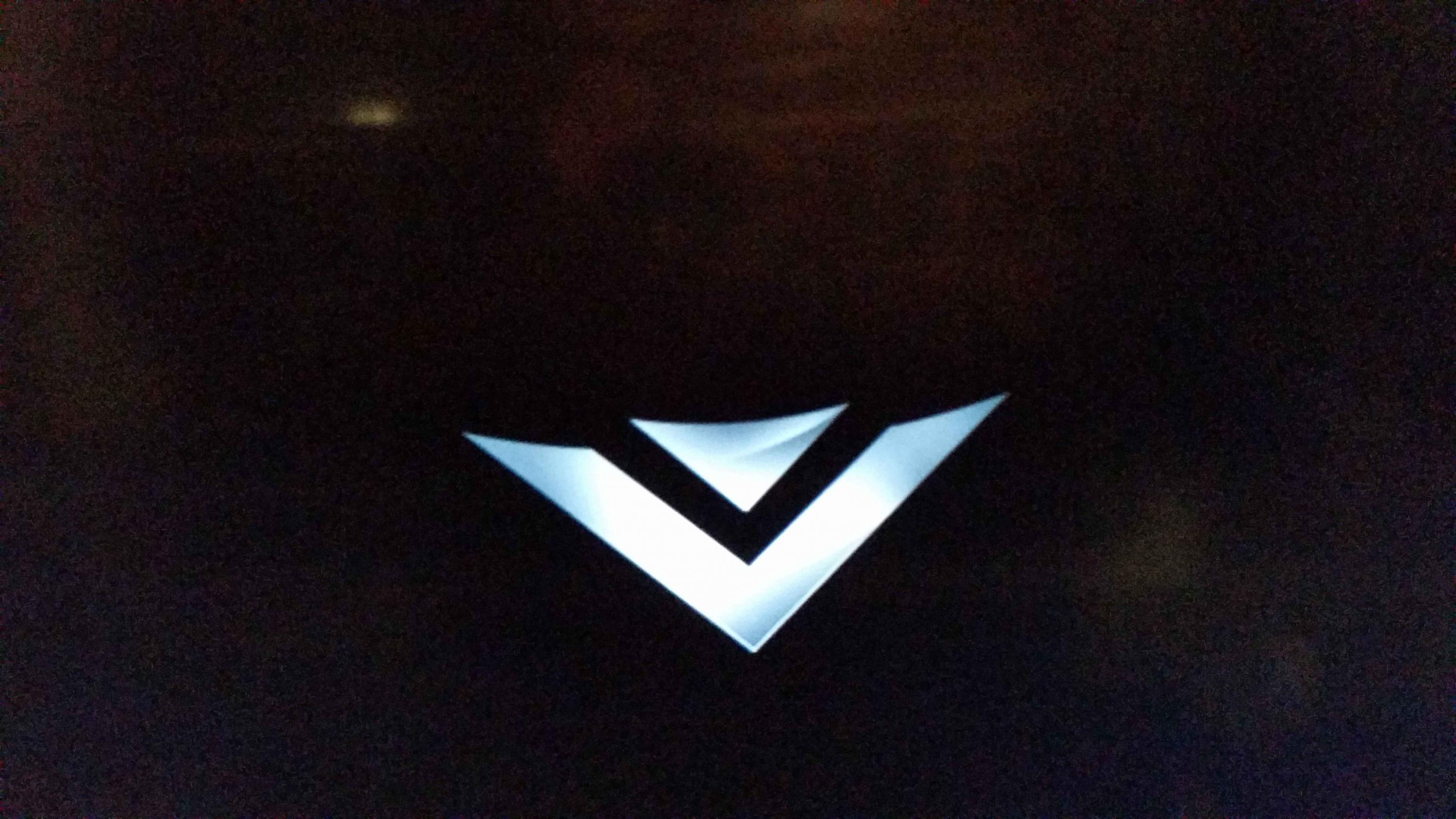

                                      First picture is the other side of the driver board
                                      D/Ced left side first and then right side. Both times I came up with LED backlight on but no picture. First time I unplugged very quickly, second time I said screw it and snapped a photo.

                                        hmmm... ok. Well, it is likely you have to go to the next step and check voltages on the power supply board.
                                        As for the picture of the "driver board", you don't need to look at the board itself, the tab driver IC is "embedded" / bonded to the actual cable about in the middle of the cable. When it is bad, the area around the ic gets a bit discolored from the extra heat.... can't really see the ic in the picture but don't see much of the cable.
                                        Anyways, I think you are moving slowly in the right direction. See if you can carefully measure some of voltages associated with the power supply and go from there.
