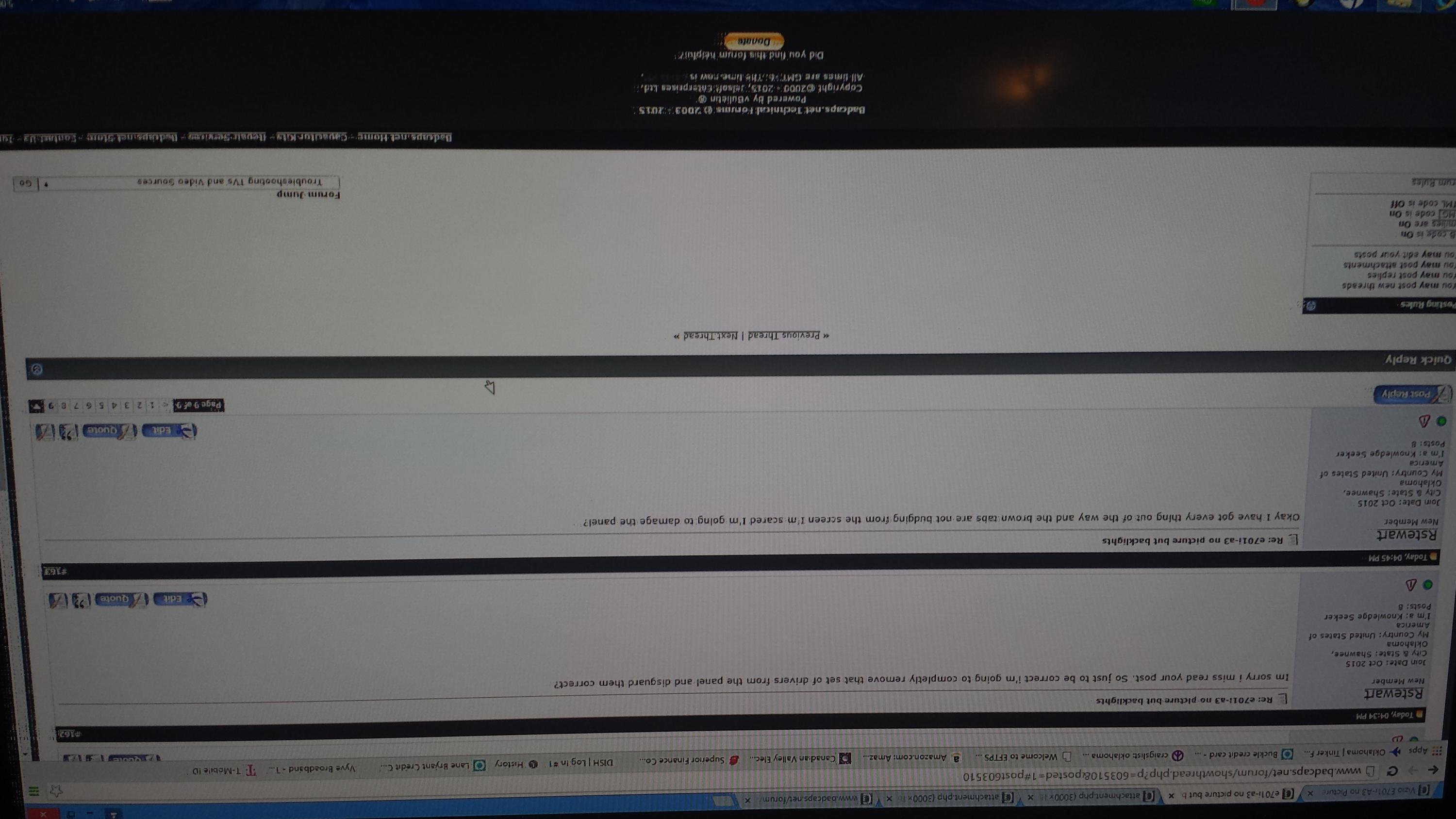

      Im sorry i miss read your post. So just to be correct i'm going to completly remove that set of drivers from the panel and disguard them correct?
        Re: e701i-a3 no picture but backlights

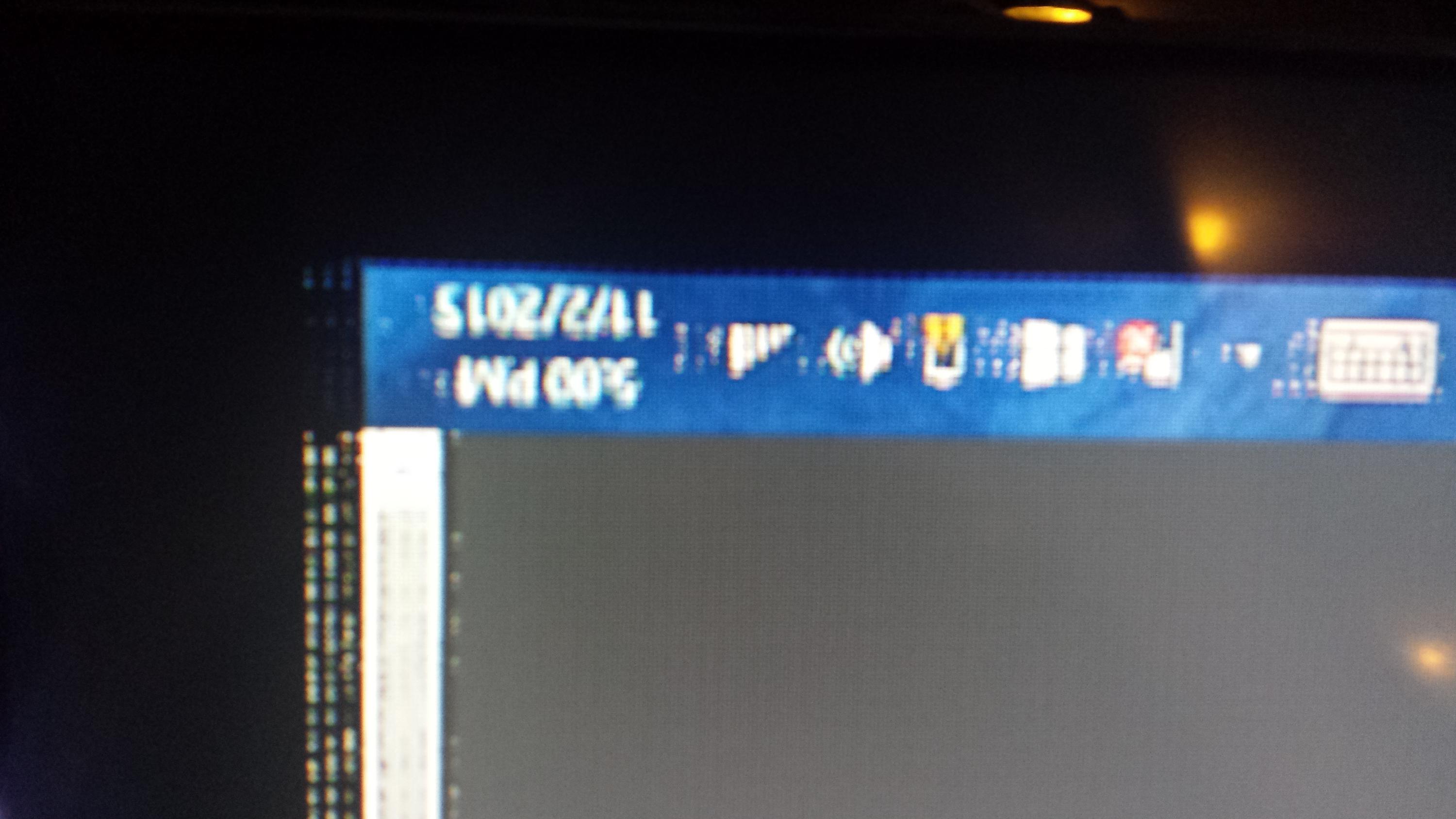

        Okay I have got every thing out of the way and the brown tabs are not budging from the screen I'm scared I'm going to damage the panel?
          I would first power the set up and make sure you know which tab you are removing.
          Then turn it off, and gently peel upwards. They are only glued on so only slight force is necessary.
          Do one at a time and test it each time. Bars should slowly come back.

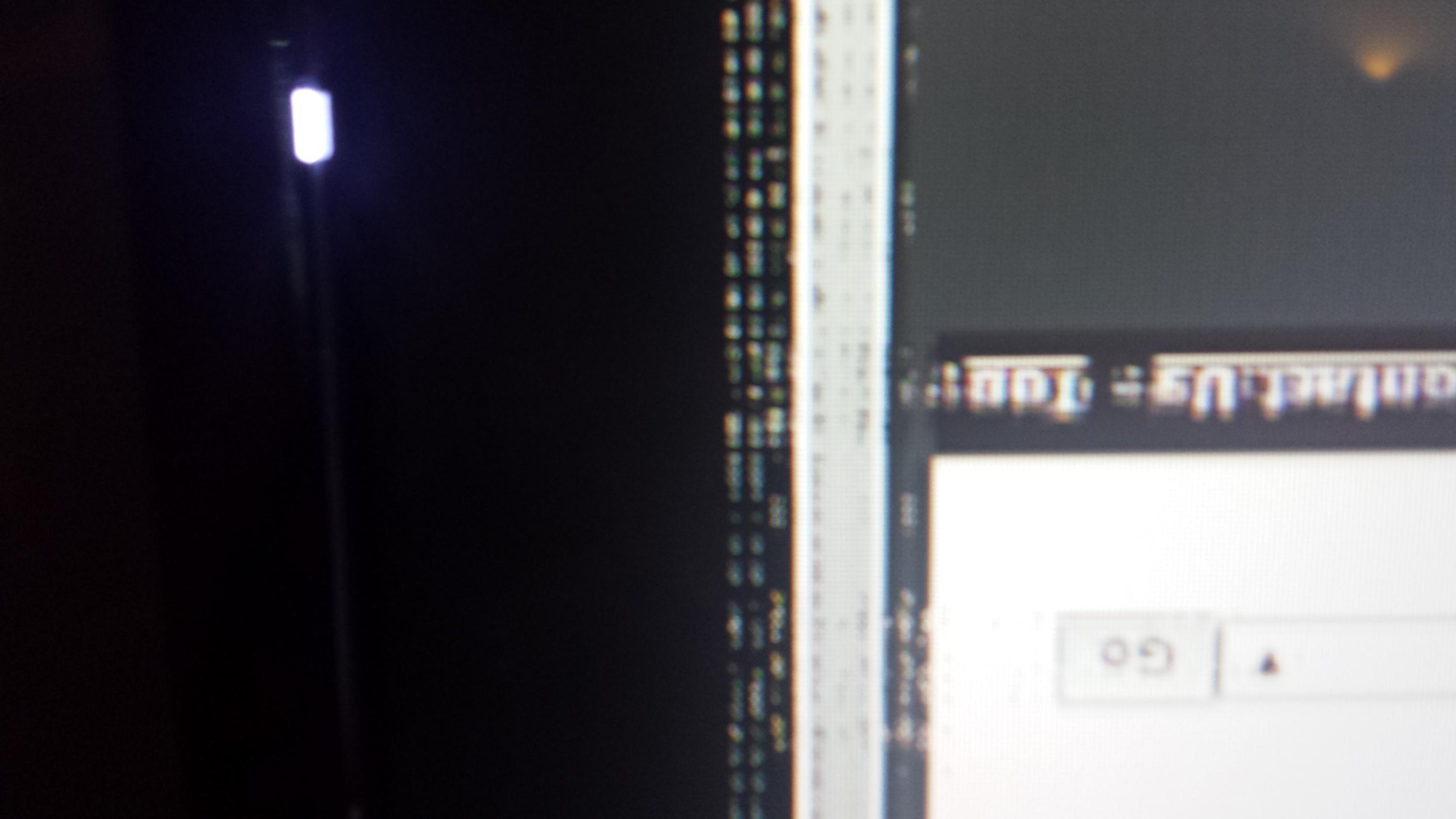

            Okay got them removed much better picture but still have some vertical lines? Maybe need to clean cables again?
              Let's try this again
                Sorry I misunderstood I removed the whole side?
                  Those vertical lines may be a bad connection on one of the white ribbon cables going from the T CON try to reseat them agai. Also you could try cleaning those cables with some rubbing alcohol on the connections and also try a little rubbing alcohol along where you removed the driver tabs from the side of the panel. Do not do this well its powered on and let everything dry really well before powering it back up.

                      Vertical lines look like LVDS not seated correctly to me at least.

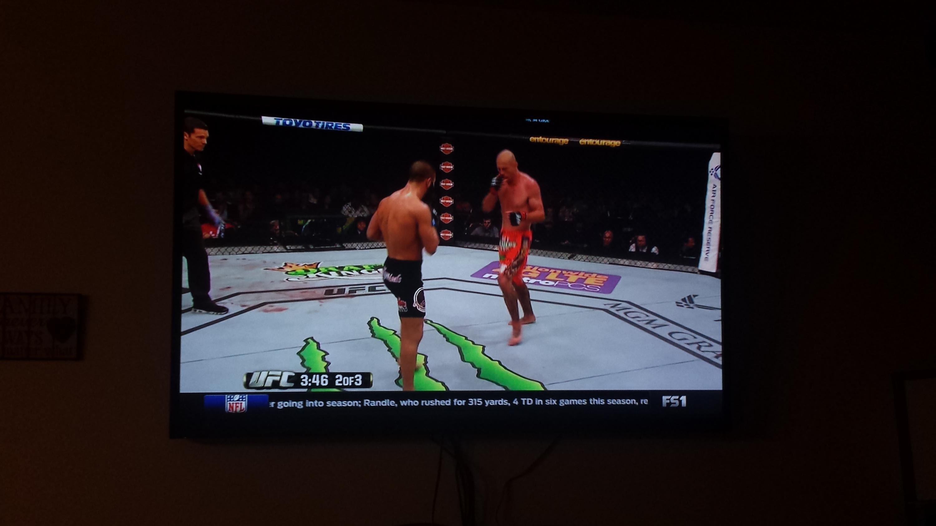

                                  Okay guys looks like I successfully fixed mine and as it stays powered up the lines are gradually going away. Anyway it's a lot better than no picture at all. I'm going to let it run for awhile before I put it back together. Thanks everybody I'm stoked!!!!

                                          Hello again guys (freakaftr8 and tom66) after getting frustrated last note I decided to leave the TV alone until today. I have great news! I removed the t-con board again and cleaned it good with alcohol, everywhere possible. I dried it good with a hair dryer and reinstalled it. Now the picture is perfect with no distorted view. I want to thank you guys again for your knowledge and your help.
