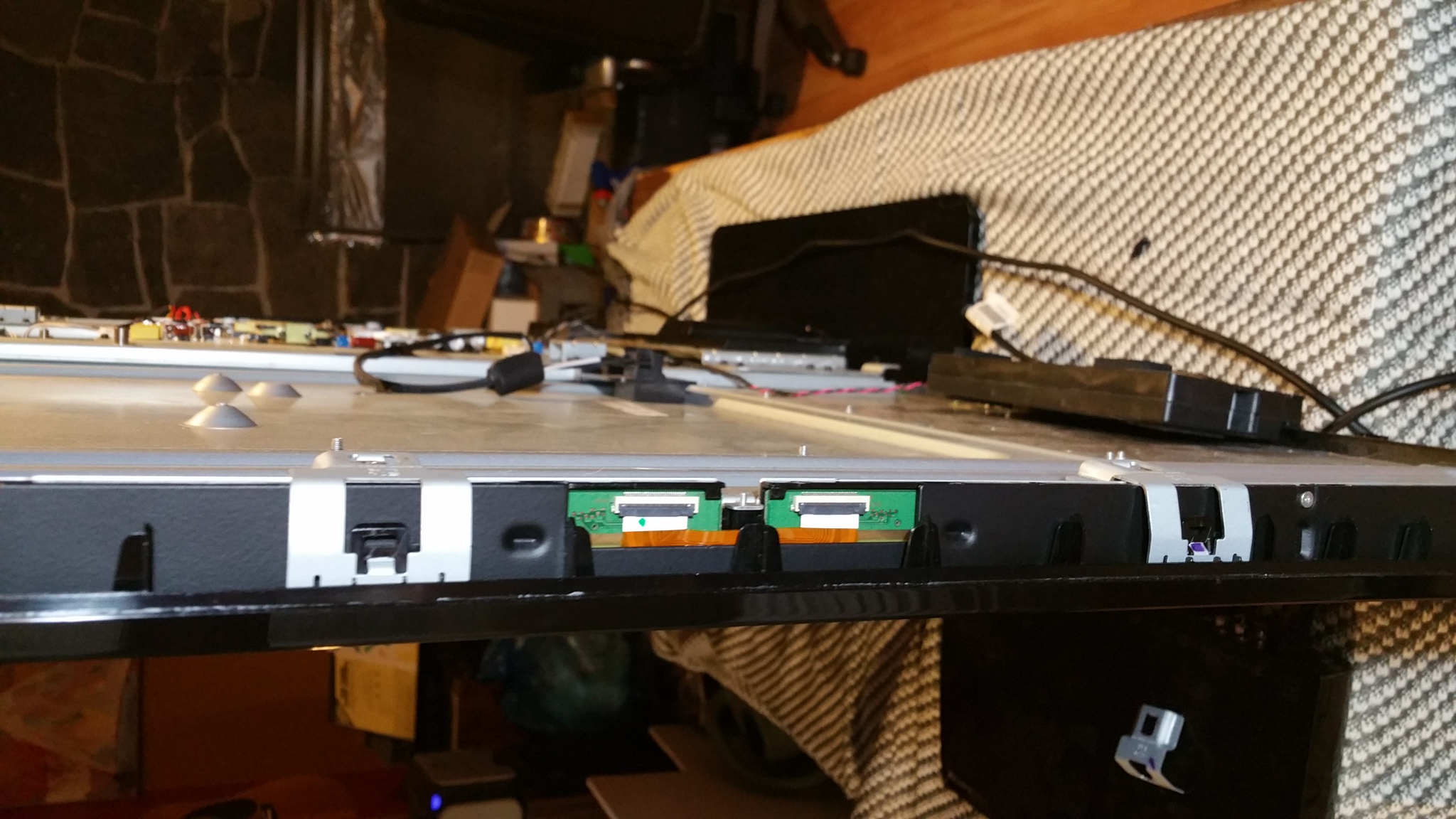

          Well I can tell you most likely have a right side tab driver failure accompanied by something else going on with these vertical lines that you are getting. I'm half tempted to say that that could have been a tcon board problem also. So you would be on the right track to remove the right hand side ribbon drivers on the side of the panel and possibly pick up another tcon board. There's always a slight possibility that with the damage panel from the other TV it may have damaged the tcon board that you were testing with

              This is only if the side drivers are shorted. Looking at your picture it doesn't look like there's a problem with them. It looks more like you have a vertical driver issue. I just find it interesting how when you put the cable back on the tcon to the panel you have no picture now. What I would try when you get your new board is connecting just the left ribbon cable from the t-con to the panel but leave the right side ribbon cable disconnected. Power up this way and see if you have a picture. If you do, then connect the right side ribbon to the tcon. But before you do this inspect that ribbon that goes from the t-con to the bottom driver board on the right side to make sure that you do not have any fractures or holes ripped in the cable. As a matter of fact you can probably look at that cable now and inspect it.
              If there is a problem with that ribbon cable going from the tcon to the panel it could have caused the tcon to short out
              You could try doing some voltage checks on the tcon board now with the two flat white ribbon cables disconnected.
              What I meant by removing the right hand ribbon is the ribbon going from the t-con to the panel. I don't think you have a side tab driver failure. That would present itself in different ways however if you feel that there could be a problem there you can always leave the bottom 3/4 inch flat white ribbon cable disconnected from that side after connecting the right side ribbon cable from the t-con to the panel. This would be just a momentary thing to see if the picture looks ok vertical wise. This will allow us to make sure that it's either a vertical or horizontal problem taking down the tcon board

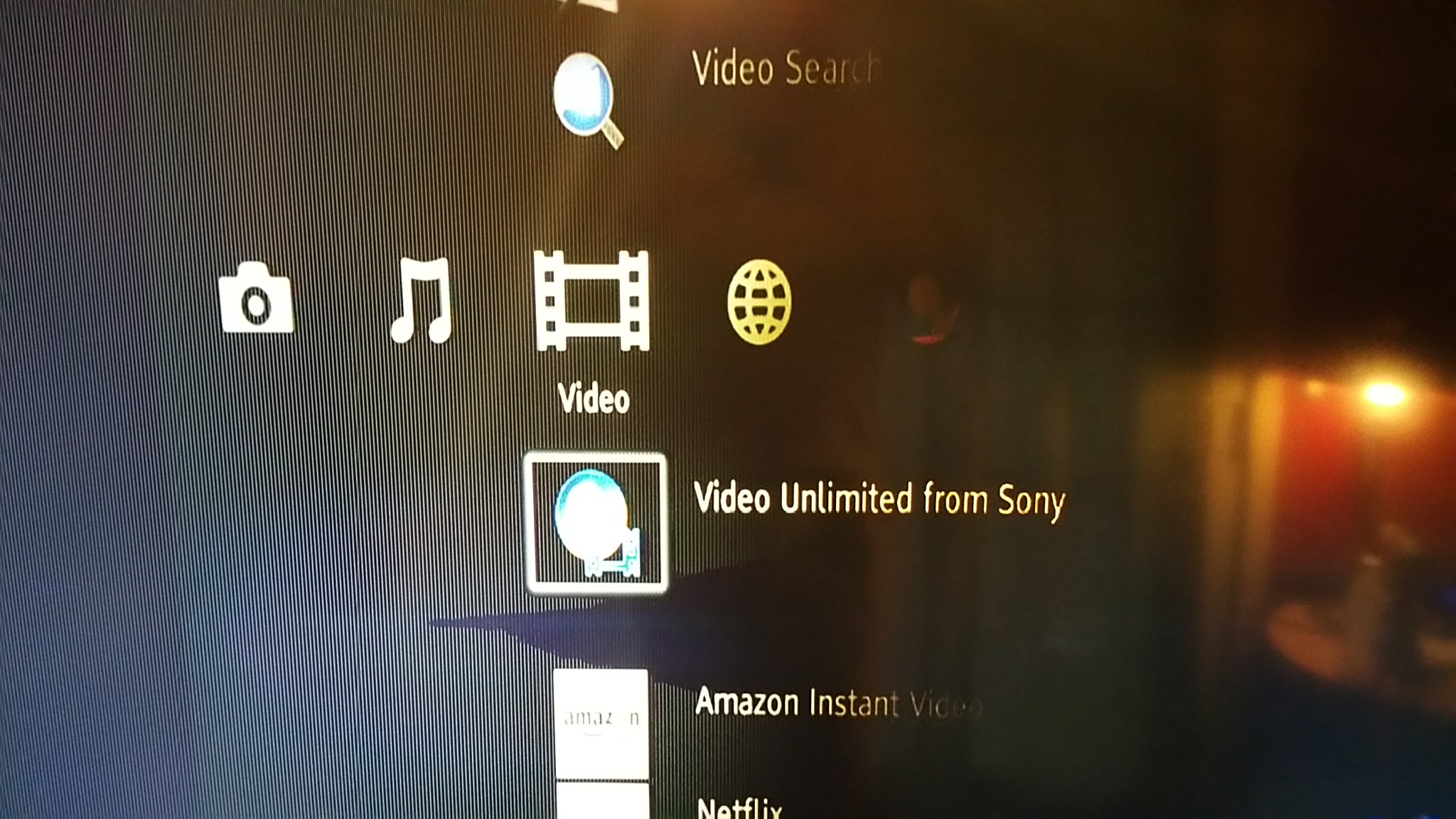

                Sucess!!!!!! Replaced the transistor on the t-con board and then reinstalled the t-con board back in the tv. Connected the blueray player to an hdmi port. Made sure the white ribbon cable on the right side of tv was disconnected.
                Fired up the tv and quickly realized that the right side video drivers were the problem. There was nothing left but the heart stopping surgery of peeling the driver tabs off the panel, I'm not gonna lie, needed a bit of liquid courage prior to the job.
                A few beers later and a complete reread of this thread, peeled those driver tabs off the tv and fired up the tv and blueray player....and it worked perfectly. Crazy.
                The last picture was me watching Wreck it Ralph movie. Looks amazing. Got the TV off of Craigslist for 300$ and a dubious look from the wife and daughter that it could be fixed. Now I'm the hero for the day...lol.
                Thanks to tjmethod for the transistors, freak and all who posted valuable suggestions for fixing this tv. Thanks so much guys.
