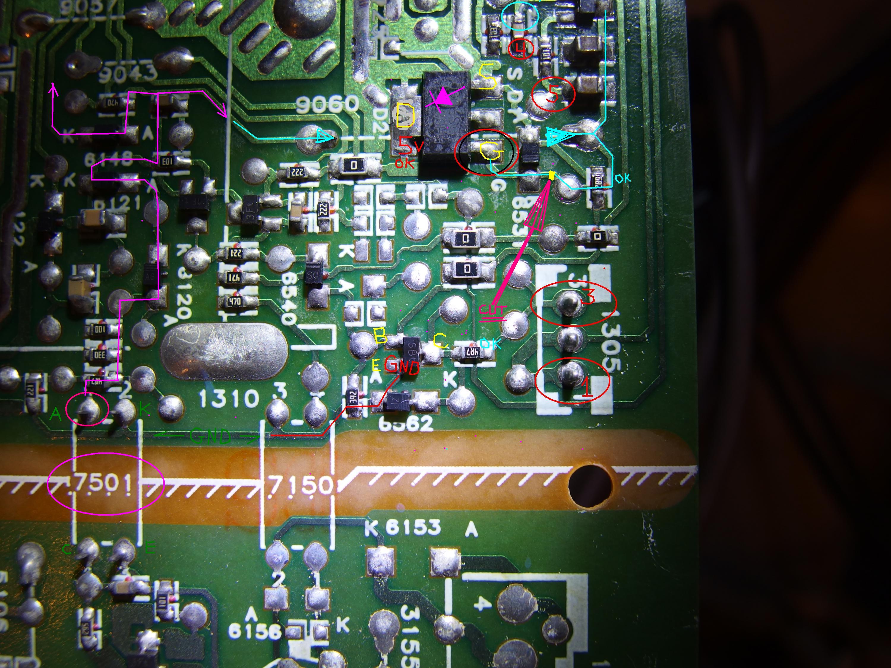

    Re: Philips 37PF7321/98 cannot turn on
    Originally posted by john_doe
    What is happening???
    I jump a ground to Gate and now the Gate is 20v and Yellow S(source) is 5v.
    And the pin 3 of 1305 is 0v.
    When I power off and on the tv, the led light on the front panel is green and stay green. Before this, the led is green and after about 2 sec will turn red.
    Just to be sure, I have remove the ground to G. And the voltage of the Gate is still 20v and the Source is still 5v.
    How is this possible?

            #145
            looks like we found part of the issue
            now if you do that with the 3 pin wire connected to the power supply, the relay might just kick on

                      #150
                      Now the TV screen is not lighted. Voltages at mosfet 7531 and 3 pin plug 1305 no change.
                      TV is unstable.
                      • bammbammfran
                        • Apr 2014
                        • 476
                        #151
                        so that 20-20 and 5 are still at the transistor even when you power it off with the power button ?
                        To me that 20volts does not sound right
                        Also do you hear the relay click off when powering it off ?

                            #153
                            unplug the 11 pin wire on the standby board, then remove the number 7 wire from the plug
                            (you have to slightly lift the clip on the side of the plug with a pointy object and pull the wire out)
                            then power up
                            now check the voltages on the board that we were checking at the transistor and 1305
                            and do a separate check on the wire and the pin that we just removed

                                  #156
                                  ok
                                  with all power off and with it sit to discharge a bit
                                  check resistance in both directions from the Drain (yellowD) to the Gate pin (Yellow G)
                                  if zero or close to it, the transistor went bad
                                  going to need to cut a trace to isolate the Gate pin on that mosfet
                                  use an exacto knife or the like and cut out the yellow section at the end of the pink arrow
                                  I am trying to see if the gate is causing the 20 volts or the board itself
                                  Picture attached if I remember this time

                                    #157
                                    Originally posted by bammbammfran
                                    ok
                                    Resistance from Drain to Gate is OL both direction.
                                    7531 is new. Is it really necessary to cut trace? I have never done this.
                                    • bammbammfran
                                      • Apr 2014
                                      • 476
                                      #158
                                      7531 is new ???
                                      when did this get changed ???
                                      yes, you have to cut it since there are no jumpers to remove.
                                      it's an easy redo

                                        #159
                                        7531 is new ???
                                        it's an easy redo
                                        It was replaced yesterday before our test. I replaced it because I wanted to test it out of circuit and since it is out, I replaced a new one.
                                        Ok, trace is cut.

                                          #160
                                          now recheck usual voltages at G D S and at 1305 and also check the pad to the right of the cut
