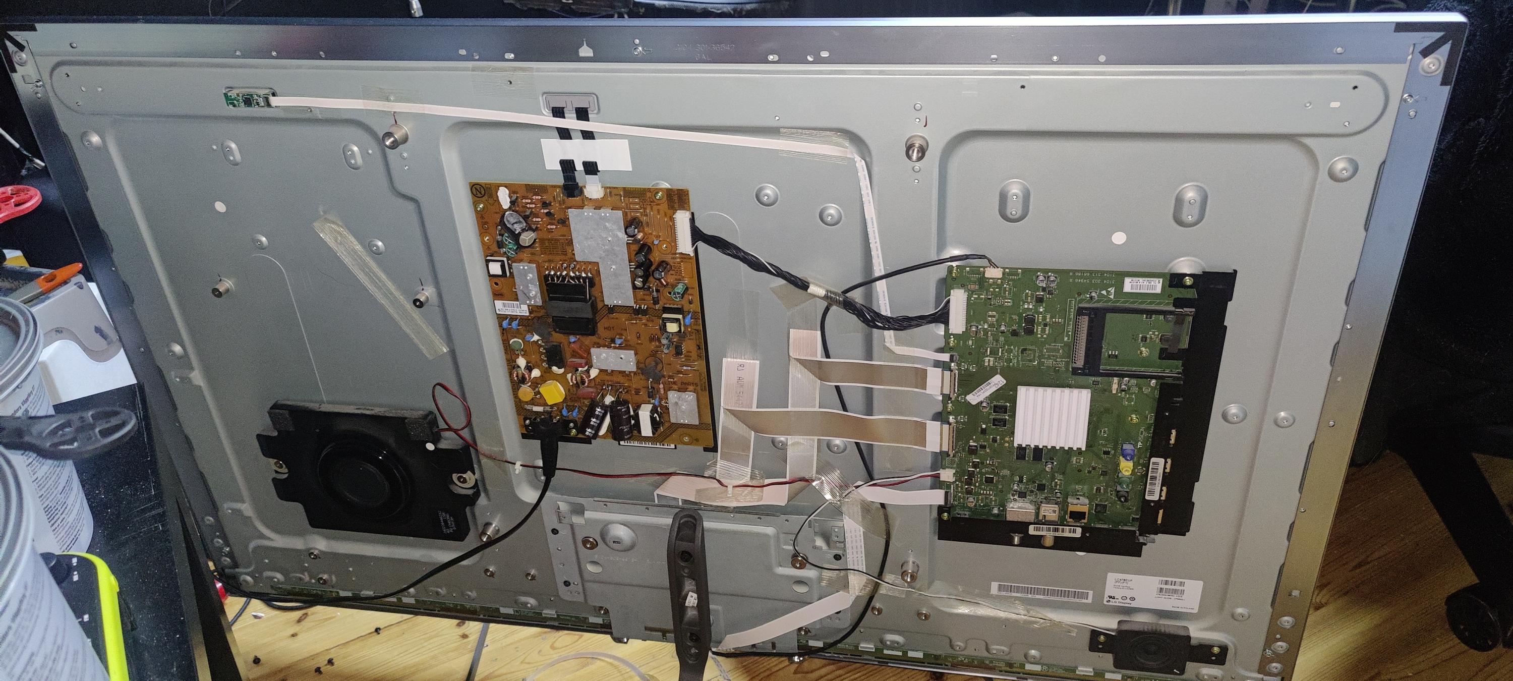

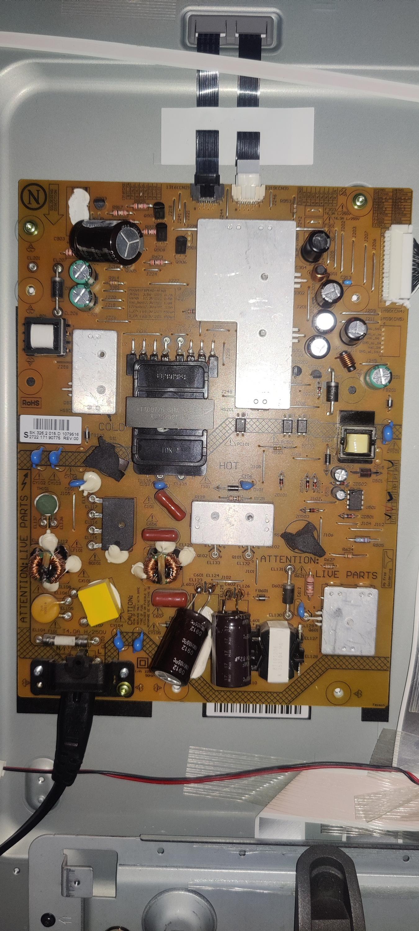

    Re: Philips 47pfl6008s wont turn on
    Can you post some good focused straight on pictures of the whole back of tv and one of each board?

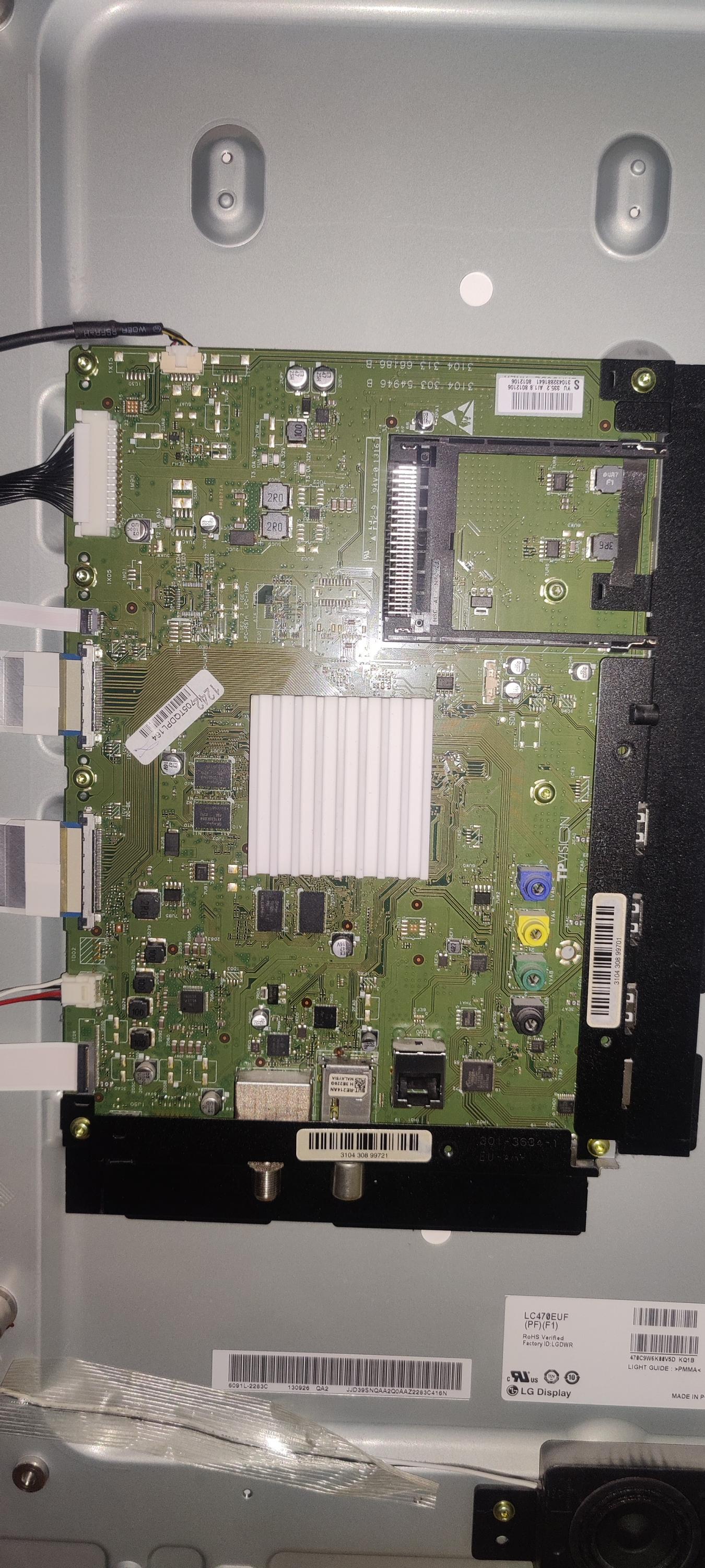

        Here's few pictures I took when I was in the middle if cap replacement, so some of the caps are still original.

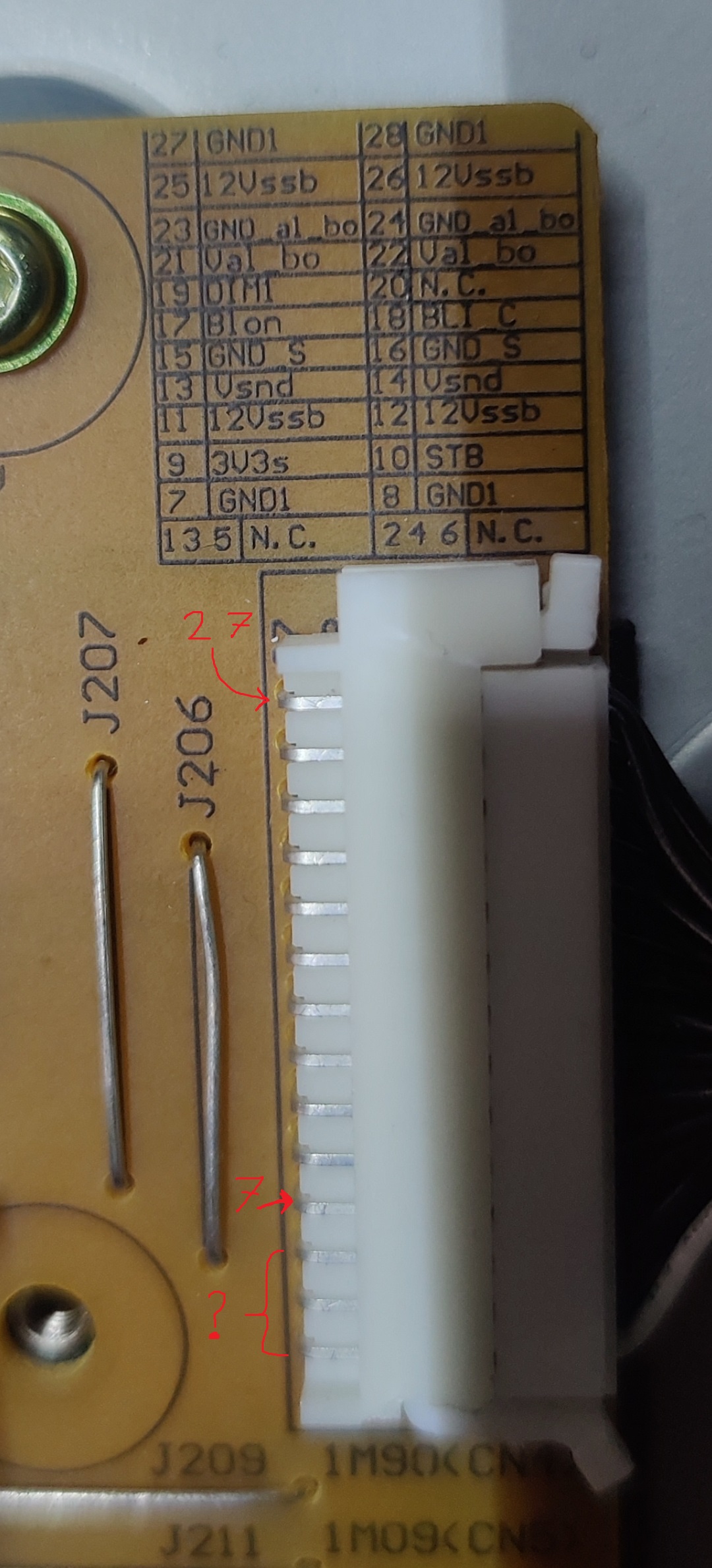

          with tv unplugged from power, unhook cable from powerboard to mainboard on powerboard side, leave it off, plug power cord back into powerboard and carefully test the connector pins, report the ones with voltage, as example pin 1-stndby-3.5 volts, check/report expected voltage and the actual voltage that you get.
          • JorKsX
            • Aug 2021
            • 13
            • Finland
            Check the attachment picture.
            Here's what I found when mobo cable disconencted.
            pin8=0 pin7= 0
            pin10 =3.4v pin9 = 3,4
            pin12= 0 pin11= 0
            pin14= 0 pin13= 0
            pin16= 0 pin15= 0
            pin18= 0 pin17= 0
            pin20= 0 pin19= 0
            pin22= 0 pin21= 0
            pin24= 0 pin23= 0
            pin26= 0 pin25= 0
            pin28= 0 pin27= 0
            And with mobo cable connected I cannot measure the other row but the one I can shows 12.2v on pin 11,13,21 and 25
              Ok, you have standby, thats good.

                  3.4v is your standby. No 5v. When did you get your 12v?
                  • R_J
                    • Jun 2012
                    • 9564
                    The standby voltage on this board is 3.5v pin9; stb (ps-on) 3.5v pins 11,12,25,26 =12vssb
                    I would say the power supply is working, however the led supply may not be, check for 69.3v going to the led's

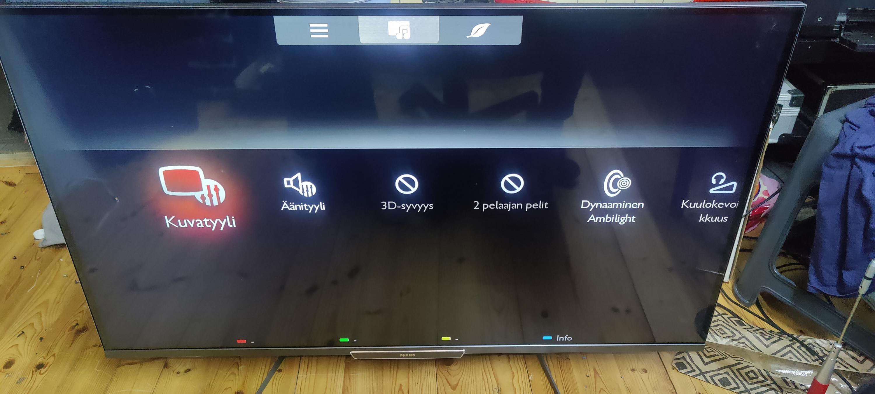

                      The mobo cable was unplugged from PSU the whole night. Now I replugged it and started measuring the LED pins.
                      At first I saw something like 39v and also found 14v. Then after 10 secconds I found the pin that was 39v is now 59.3v.
                      Looked at the TV's panel from the front and to my surprise... the TV was on. I did not press any power button. There is picture in attachments.
                      Now im scared of turning it off
                      I'll be posting here when it shuts off again
                                    I've had them deader than dead with backlight problems.
                                    Good to know.
                                    These "broken backlight" TV's are free and usually under 50€ fix.
                                    This Philips now seems to work fine. Still powering on normally and no random white noise lines.
                                    These kind of fixes I hate. Dont know what was wrong.
                                    Same with cars. I have been fixing car alot and half of them are "no idea what fixed it"
                                    Usually check engine light. read codes... clear codes and car works perfectly for years.
