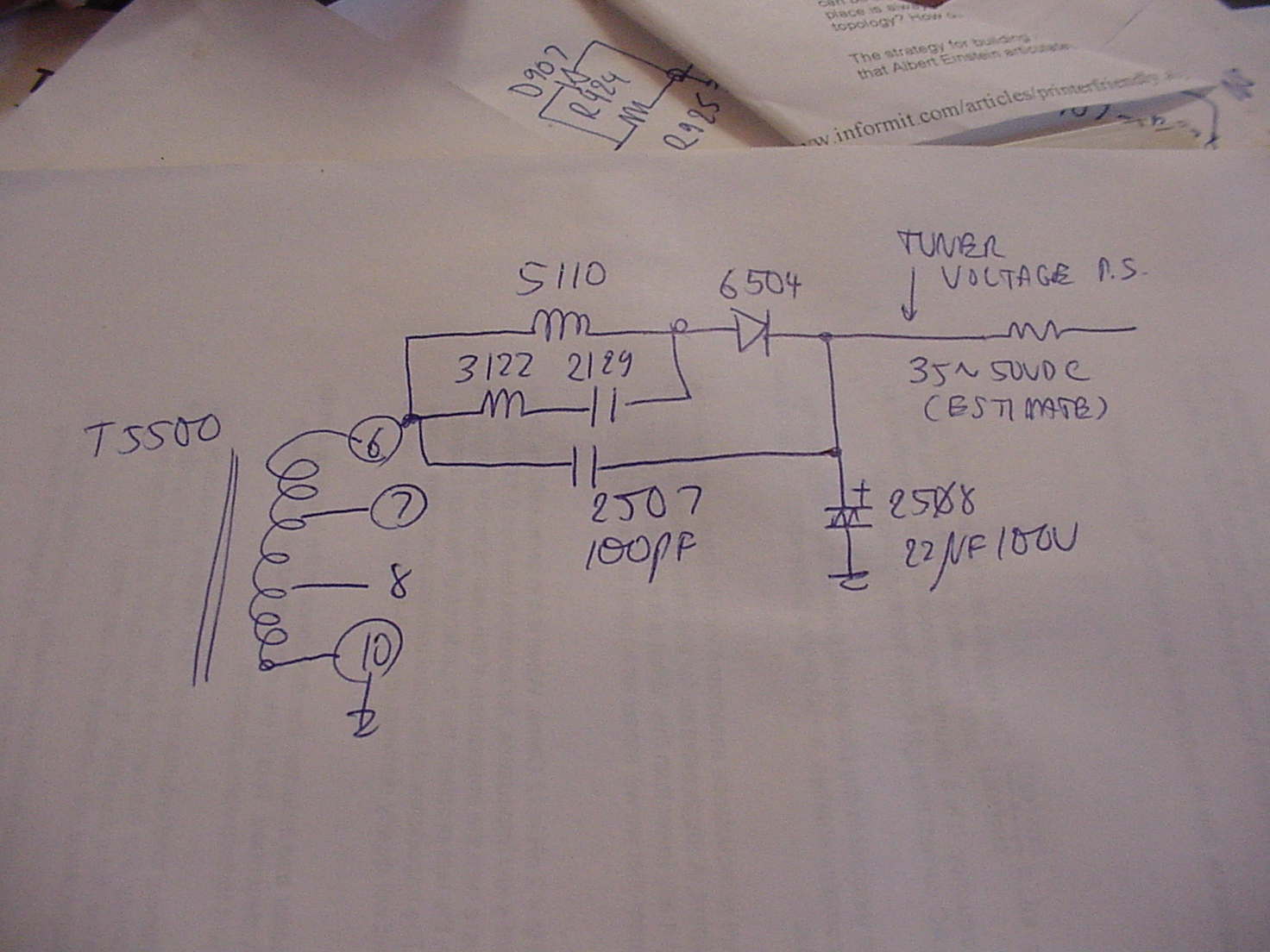

      "there seems to be a polyester 100pf 5% 1kv in line on the 12 volt line and just out of the transformer" Are you talking about C2507 (100p) connected to transformer T5500 PIN 6?
      The 11V in the SCH generated by D6140 (connected to transformer pin 7) that is showing 80V, is that the one?
            yes, that is the capacitor I mentioned
            D6140 is an SOD-57 2a 600v avalanche diode (We do not know if the 80v is there or in the other line yet) have to wait till power gets back up to check this
            I am thinking the voltage is in the other line because it looks like the D6140 circuit is running to the cathode end of a diode at 6148 ??
            PS: this is probably only the second time that I have actually had a schematic to work with, so I could be reading something wrong ??

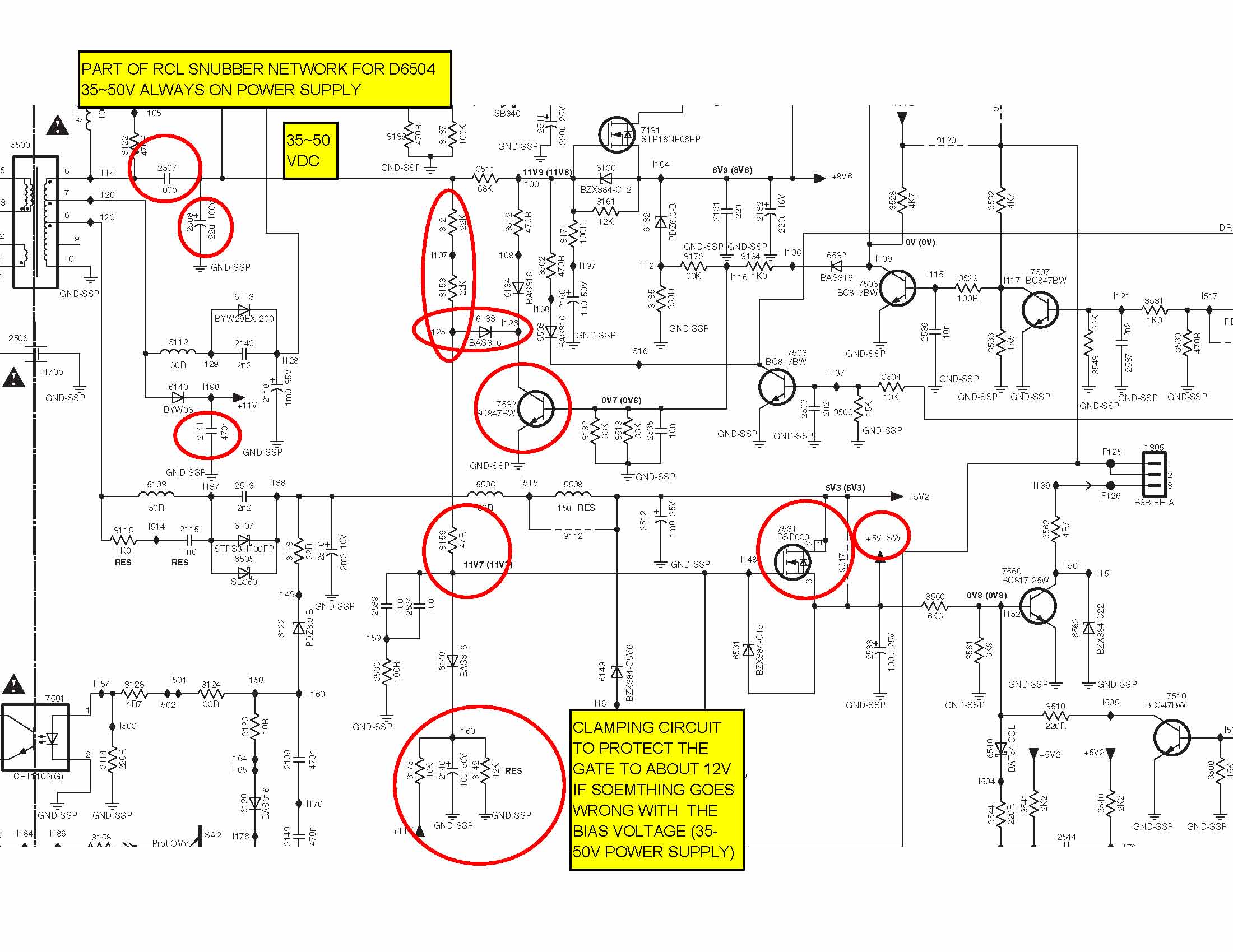

              On that 11V line right at the Cathode of D6140, it only has 470nF filter so it will be very high frequency pulsing DC, it is not filter to steady DC unil it passes through 10K R3175 and filtered with C2140 10uF, so his meter will not show correct reading at the Cathode when he tries to measure that point.
              Q7531 +5_SW MOSFET is turn on and off by Q7532 whis is part or the PS_ON/OFF circuit Q7506, Q7507.
              Q7532 is normally on (it is OFF when TV is ON) when TV is OFF which will route the bias voltage through resistor R3121, 3153 for Q7531 through ground through D6133.
              THE 100PF 1KV cap is part of the RCL snubber network for D6504 which is for 35~50VDC (I do not exact value) which is used for Tuner.
                #207
                Re: Philips 37PF7321/98 cannot turn on
                If you redraw the circuit, then you will see the function of that C2507 100p 1KV cap, it is part of the snubber circuit.

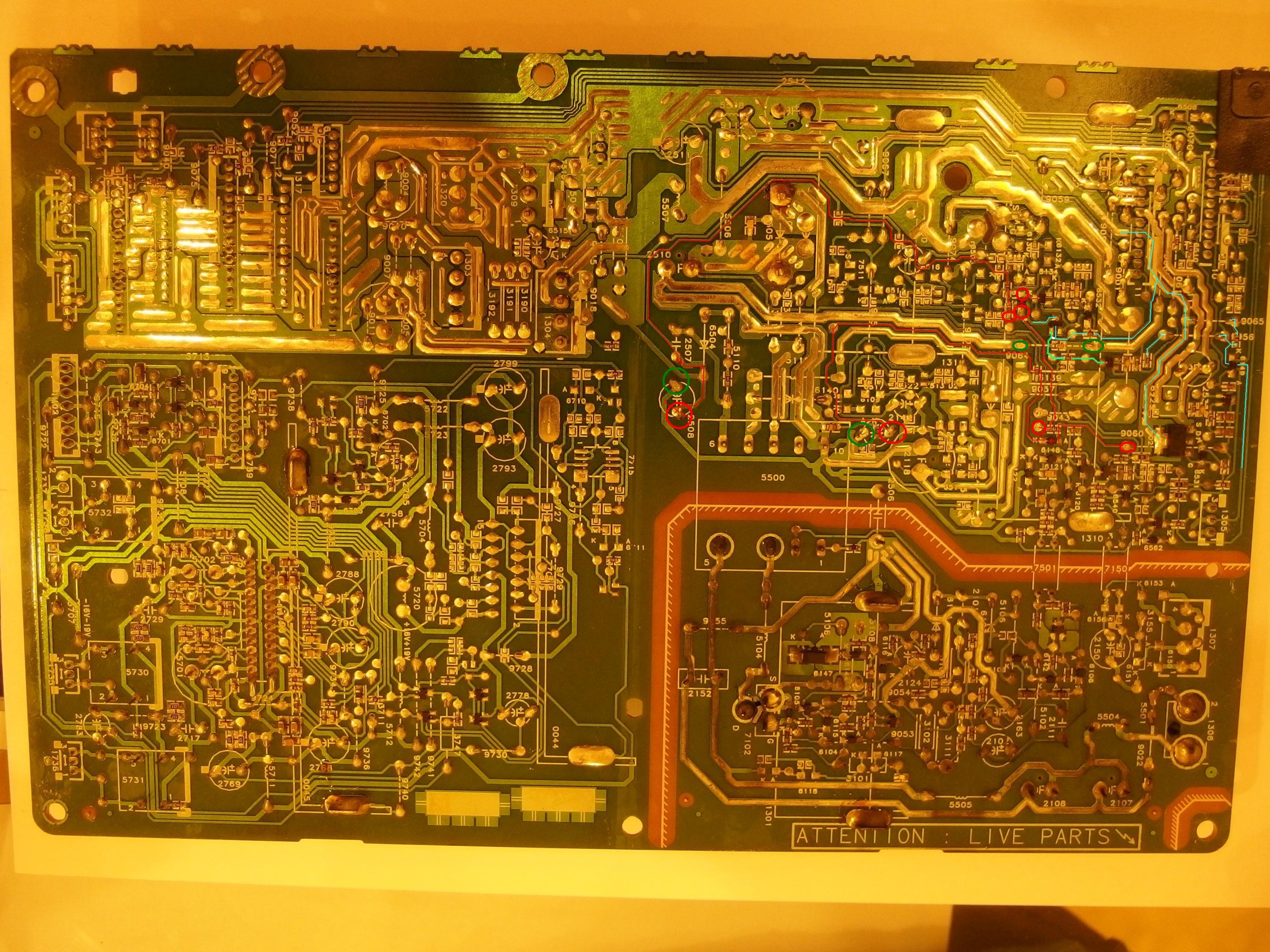

                                  on the 96v !
                                  Start checking red circles for voltage
                                  greens are ground

                                    All red circles are 95v except one 125v.
                                    I have replaced a new 7531. Pin 1 is 6v, pin 2 is 5v and pin 3 is 5v. Same as old 7531.
