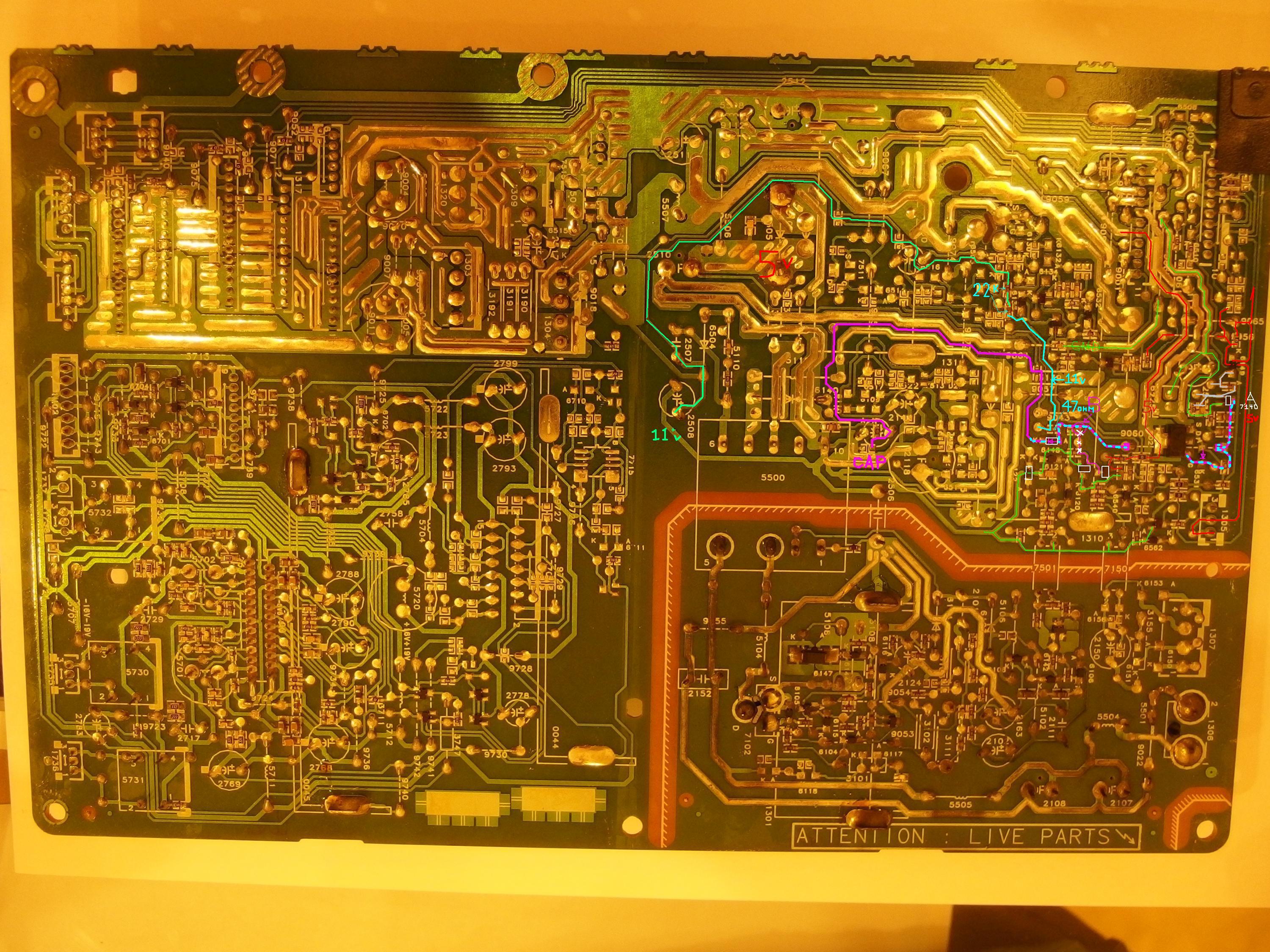

          ok on the thin pink which means there ia a direct line from the capacitor by the main transformer all the way to the gate. only thing in the way is a diode that should be blocking that voltage. so that diode need to be check to see if it only allows resistance in one direction
          so , at the transistor that I marked with the white A the trace that goes under that transistor is from the single pin side up to the 471 resistors right side ?
          If that is the case, then we have to figure out where the top left pin of that transistor goes. the 253x white numbers cover the traces
          FYI: At the diode at 6149- the top K pin goes to 5 volts at the 9065 jumper
          and the jumper below that goes to the 0 resistor and also gets 5 volts and that feeds 5 volts to the 1 and 2 pins at the 1305 plug
          There are 2 caps 2140 and 2508 by the main transformer. What cap and which diode?
          471 resistor right side goes to the top left pin of transistor.

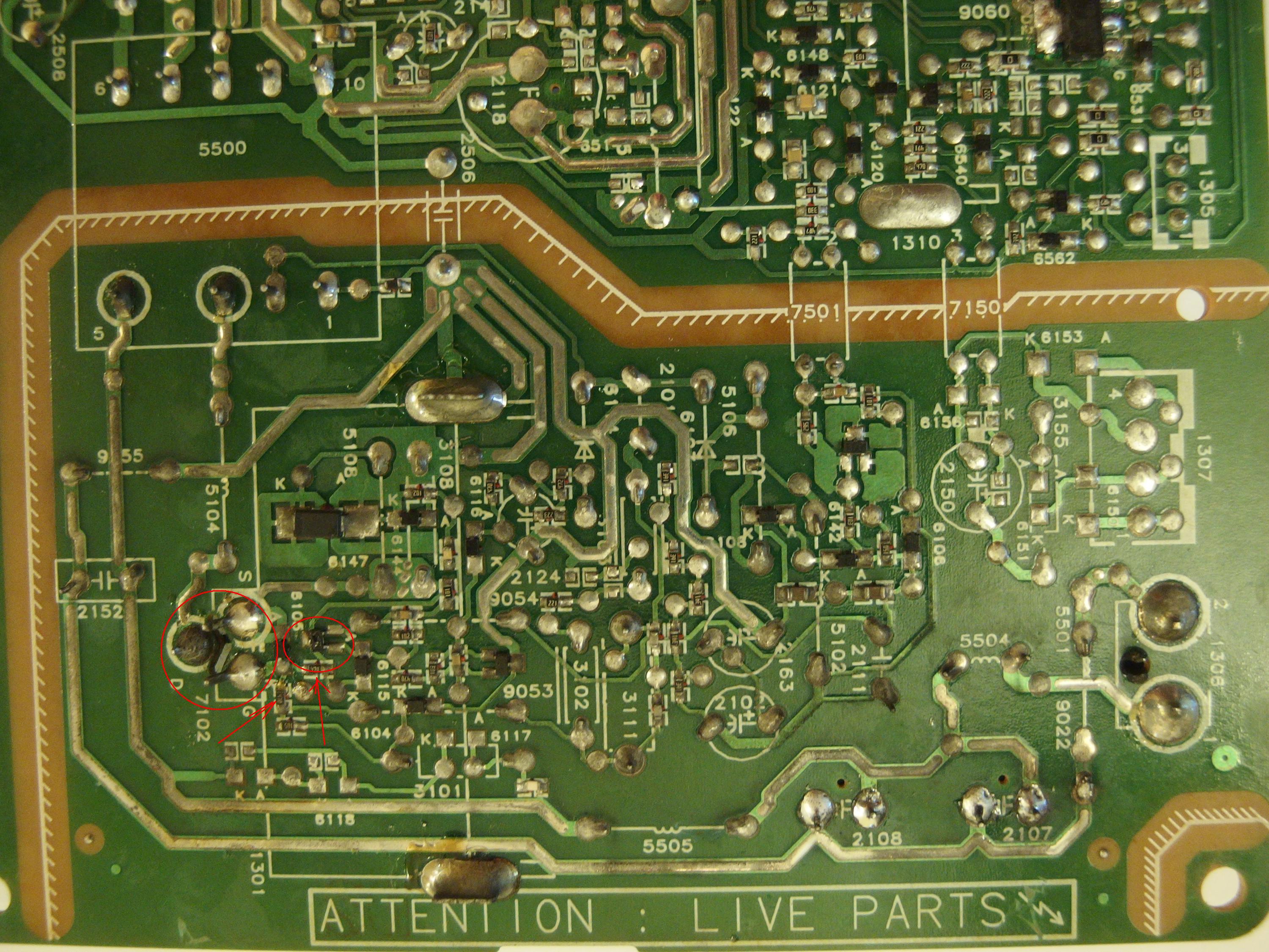

            Re: Philips 37PF7321/98 cannot turn on
            parts that blew up are in the red circles
            once removed the two resistors at the red arrows need to be checked
              never mind the caps
              I found that info
              FYI: From what I can see so far this morning- that 85 volts to the gate should probably be 11 volts, so grounding it to turn it on is incorrect
              • john_doe
                  Have to remove the resistors to check? Or can check in-circuit?
                    Since they both are shot, you should remove them first or they may give you a false reading somewhere else

                              once we get power back then we can try to figure out why the 11v line is putting out 80+ volts
                              I originally thought that this standby only did the 5 volts
                              I wasn't expecting 12 volts since the power supply was doing that too !
                              New tracing attached
                              might be one of the 22k resistor or the 47ohm one creating an issue ?
                              I think that the transistor that I had marked with a white A is in line for some sort of overload protection since it doesn't appear to go anywhere else except to ground
                              I still haven't figured out what turns that 11 volts on and off to activate the 7531 transistor ??
                                  Originally posted by budm
                                  "once we get power back then we can try to figure out why the 11v line is putting out 80+ volts" is there a filter cap on the 11VDC line? It sounds like using the wrong ground ref point being used. There should be filter cap for that 11V if you truely have 80+V, the cap would have blown by now.
                                  he has been reading the other voltages correctly, so I am pretty sure this one is right
                                  The 11 is actually 11.7 (or that is what it should be)
                                  there seems to be a polyester 100pf 5% 1kv in line on the 12 volt line and just out of the transformer , so that should have held up ? Not sure if grounding the 12 volt side could have caused that to get damaged and start pumping higher voltage ?
                                  and a 22uf and 10uf 50v radial electrolytic from 12 to ground further down the circuit
                                  what is odd, is that this 11.7 feeds a transistor gate and it had no voltage till it was grounded, then it jumped to 20 volts and cooked the transistor.
                                  after the transistor was taken out of the circuit ,it shows 80+ ??

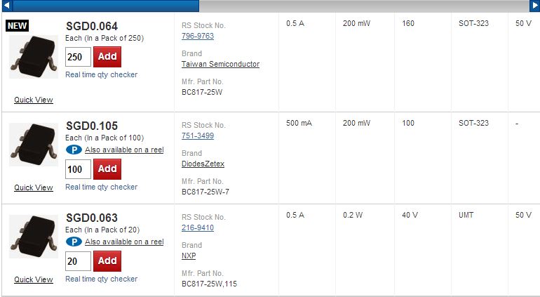

                                      I figured that
                                      If cheap enough, get a couple of each (My rule of thumb)
                                      Is BC817-25W,115 the same as BC817-25W? For BC817-25W,115 the minimum order is 20pcs whereas BC817-25W it is 250pcs!
                                      The package type is UMT vs SOT-323.
                                        the npx version is also a sot-323
