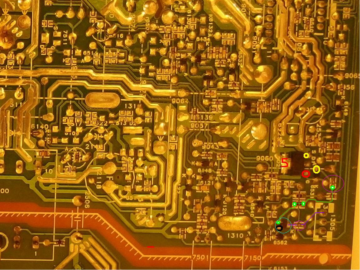

                                  Re: Philips 37PF7321/98 cannot turn on
                                  back to the 7531 area which is tough to follow traces between the lettering and resistors
                                  check black circle to see if it is grounded
                                  what are the part numbers on the two pink circled chips and what do you get resistance wise on each
                                  I am trying to follow the green path from the lower pink circle, but I loose it at the top pink circle.
                                  using your ohm meter, see if it looks like it goes to the red circle or to the larger yellow circle and are the two yellow circles showing zero resistance?

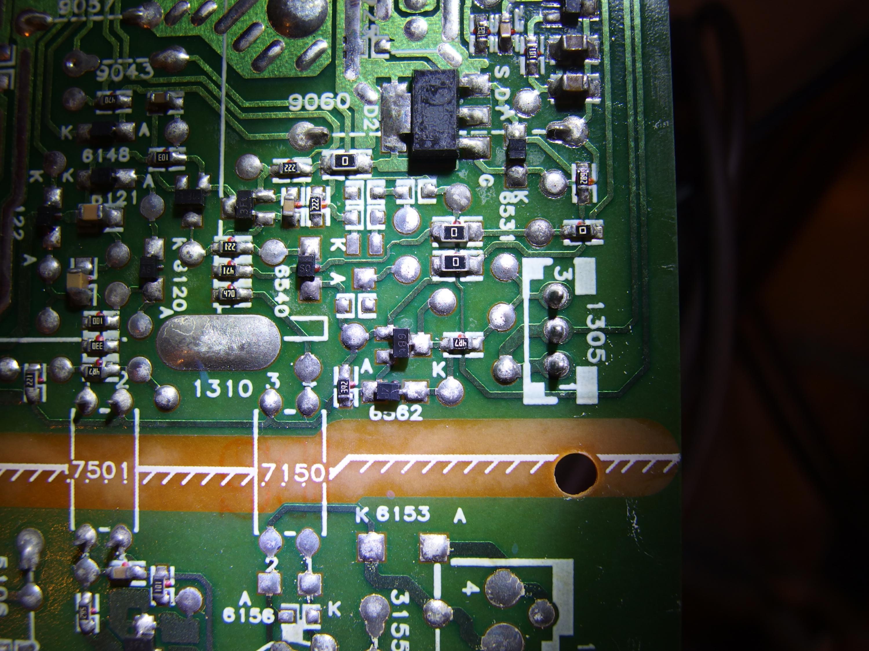

                                        Yes, the black circle is ground. The lower pink circle is 4P.7 and resistance is 5ohm. The top pink circle is 682 and resistance is 7 Kohm.
                                        Top pink circle goes to small yellow circle(pin 3 of 7531). Two yellow circles have zero resistance.
                                        I attach a close up of the standby board back near 7531. I hope it helps in your tracing.
