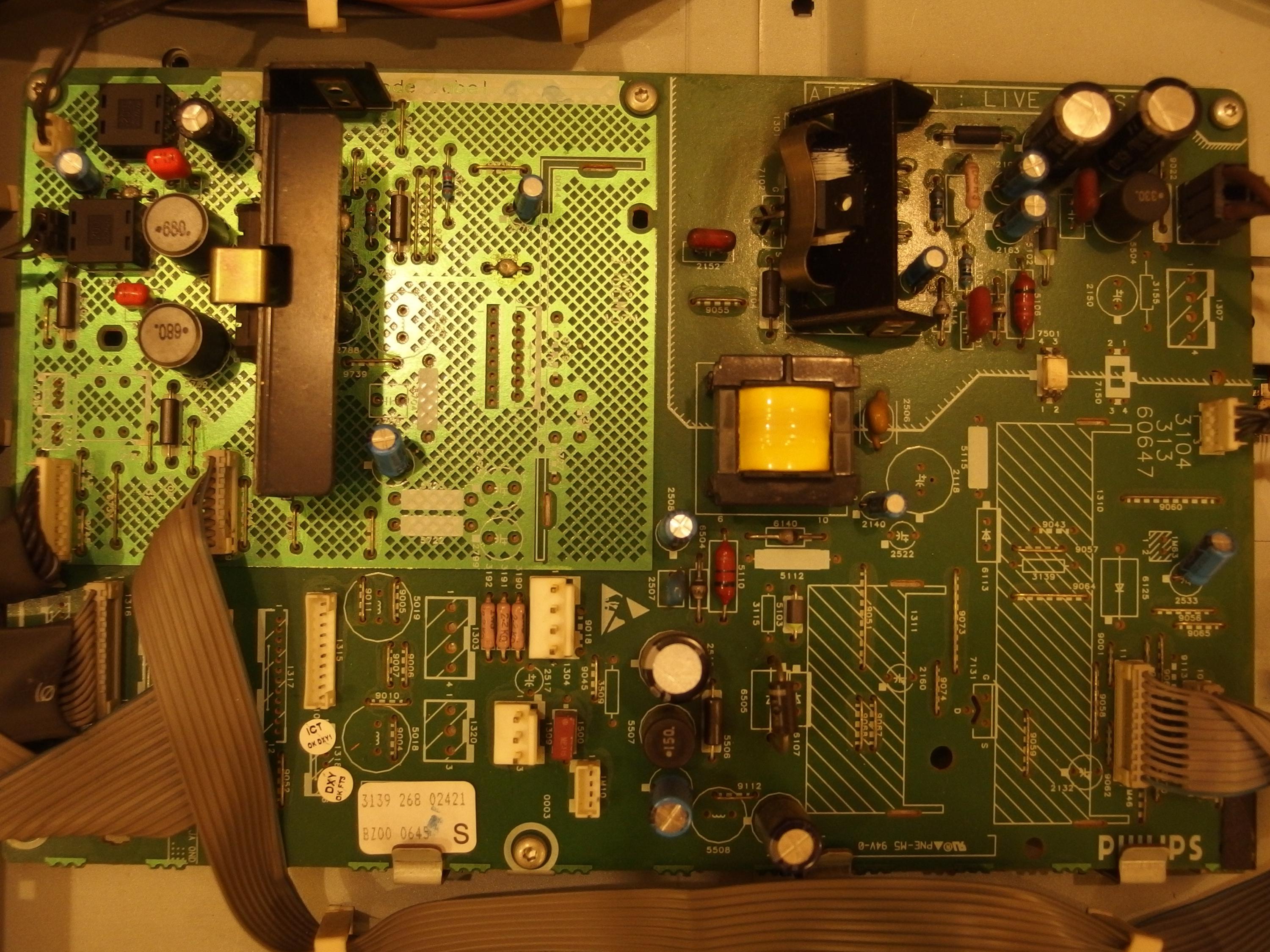

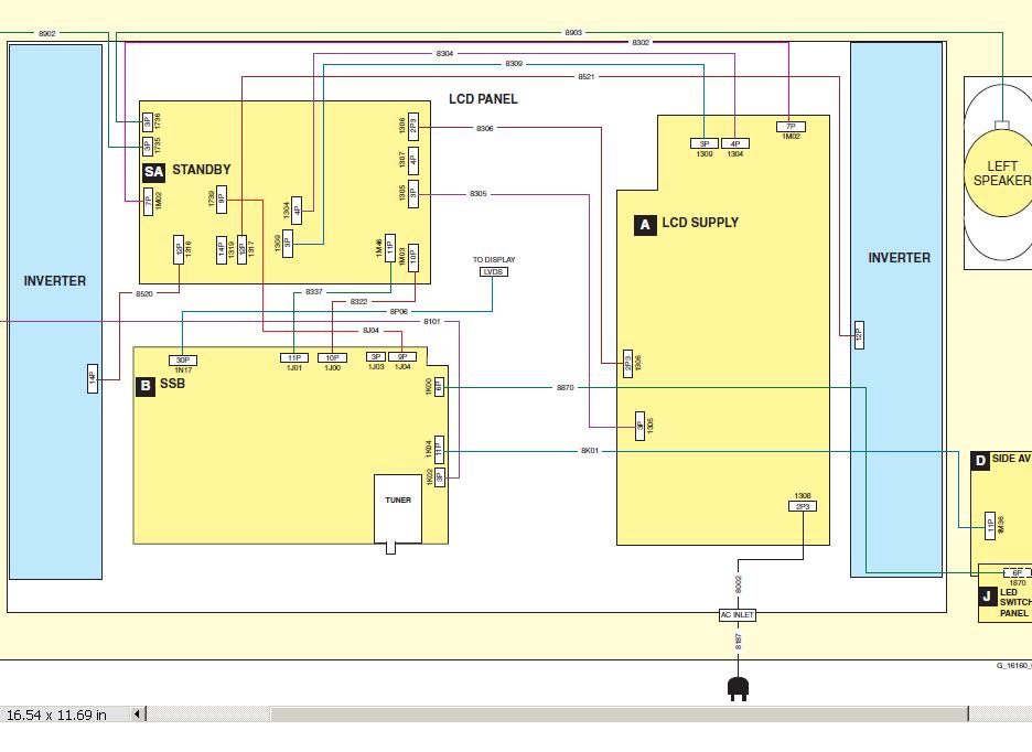

        Just thought Id post a pic of the wiring from the manual Its easier thn keep looking it up on the pdf.
        Think we need a sharp picture of the Standby board and the hitherto unseen
        SSB Board.

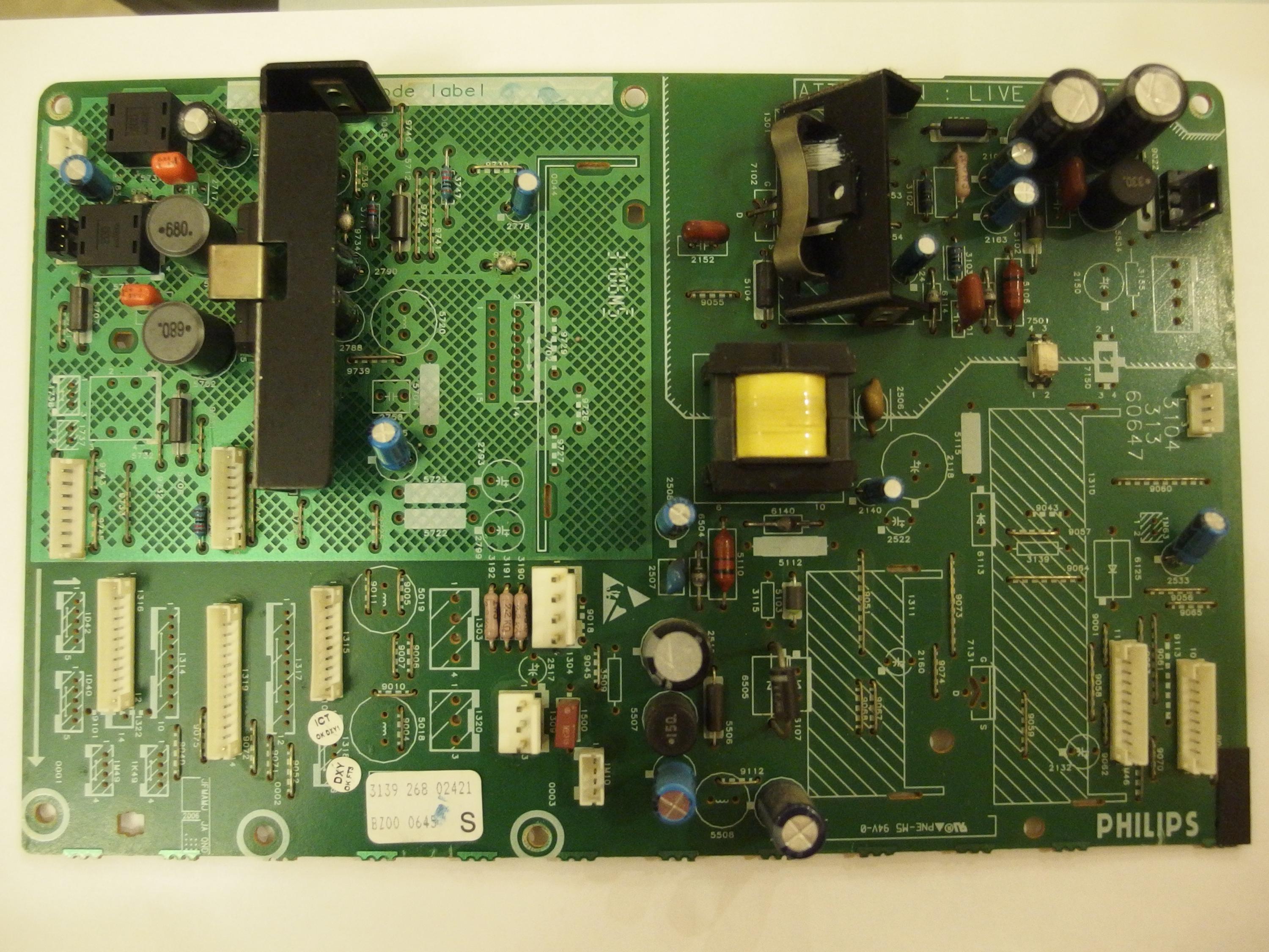

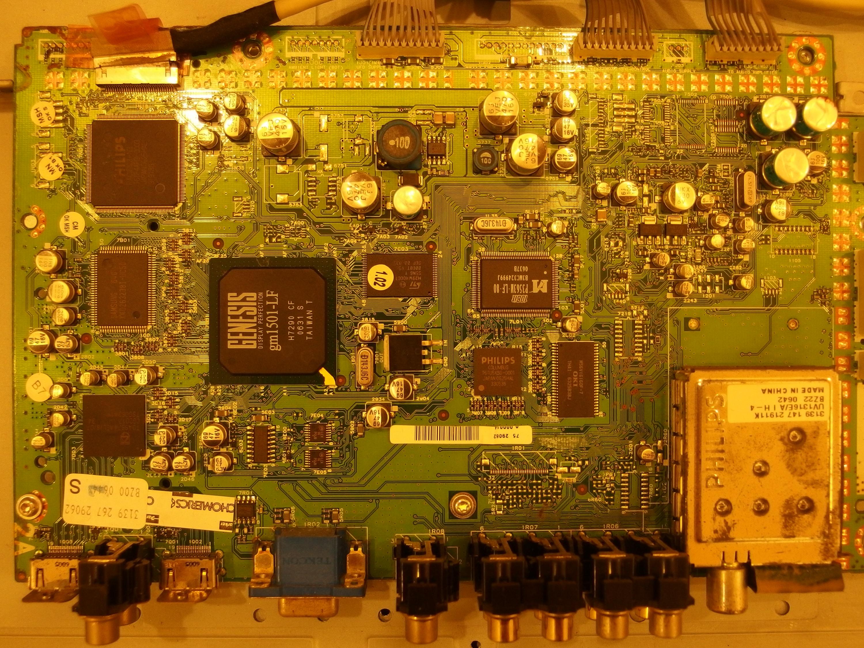

                    Standby and SSB boards.

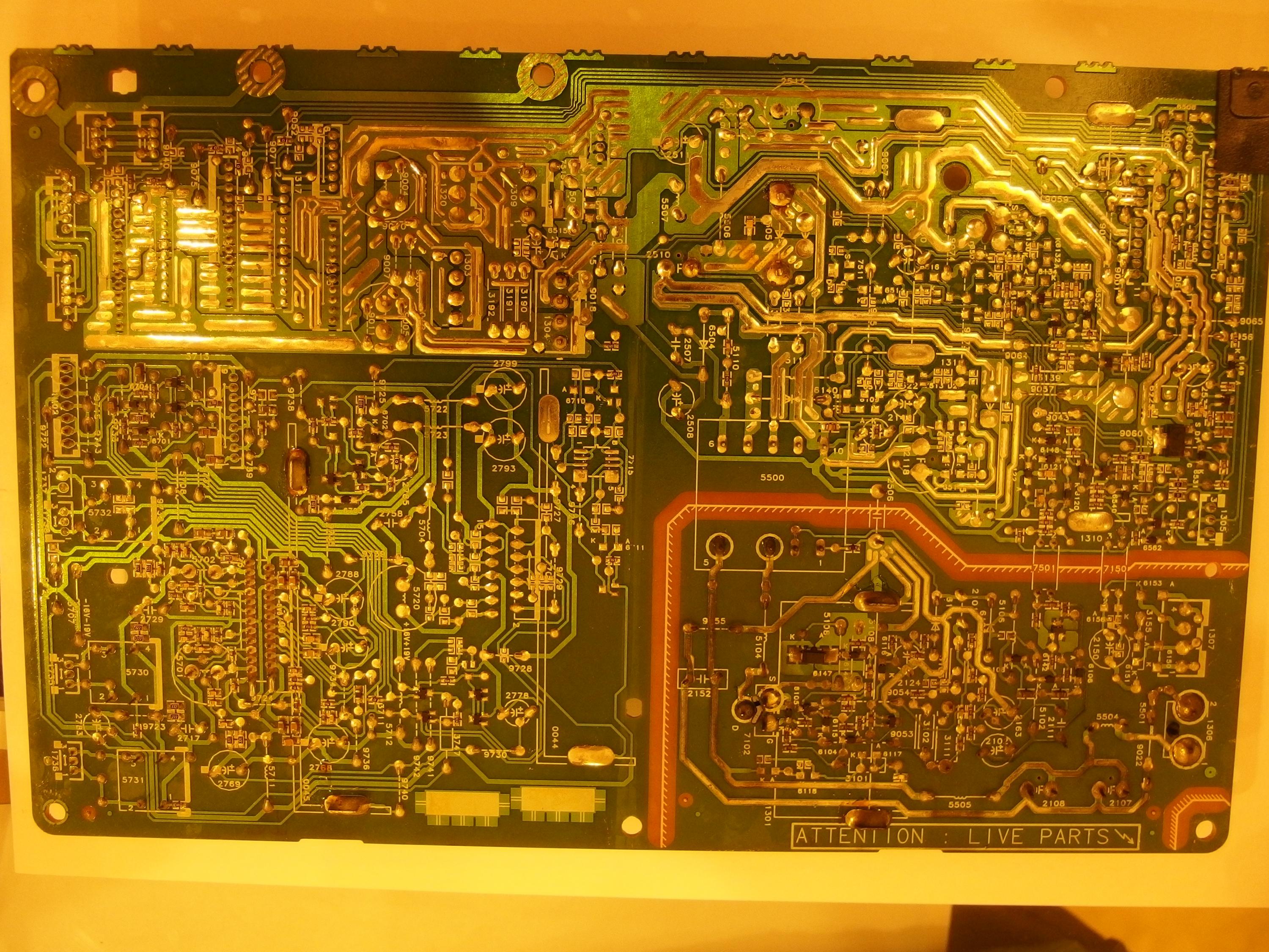

                      #50
                      Re: Philips 37PF7321/98 cannot turn on
                      Standby board without wire and back view.

                            We are going to need a pic of the bottom of the standby/audio board according to the schematic there are some transistors on there that have to do with the 5v
                            The picture of the standby/audio board is in message #50

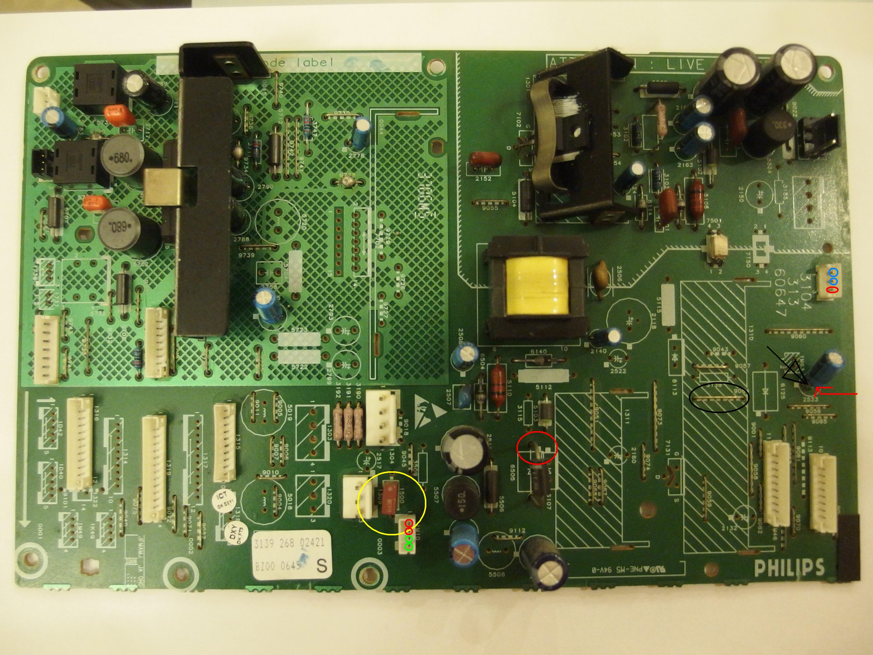

                                  #56
                                  Ok
                                  this may take a while
                                  with power supply hooked up with just the two smaller plugs that we have been dealing with from the power supply to this board connected
                                  Let start with checking to see if the high power side of this board is putting out low power dc
                                  check for voltage at the diode with the red circle.
                                  You can use the jumper wire in the black circle or the negative side or the capacitor pointed to by the black arrow for the ground.
                                  If voltage is there, let me know what it is. then check the capacitor pos side of the cap that has the black arrow.
                                  and also check the pins at the small 4 pin connector next to the orange fuse in the yellow circle 2 reds should be + and 2 greens should be -
                                  then--
                                  With this board disconnected from the power supply:
                                  switch your tester to ohms and compare resistance from the 3 pin plug that should be powering on the relay of the power board
                                  check resistance from the blue pins to one of the black grounds and also the resistance from the red pin to ground

                                    There is 5vDC at the diode 6505. 0v at the cap 2533. 0v at the small connector 1M10.
                                    I will test the resistance later. Got called for some urgent work.
                                    • bammbammfran
                                      • Apr 2014
                                      • 476
                                      #58
                                      good
                                      5 volts is what I was hoping for on the diode
                                      and 0 on the small connector (I think that small connector will show voltage only when the 12 and 24 volt 4 pin connector is connected from the power supply)
                                      next to the 5volt diode is a similar size black part at 5506
                                      can you see any markings on it ?
                                      I believe it is a inductor or a fuse
                                      and it should have 5 volts at both ends. let me know on this one
