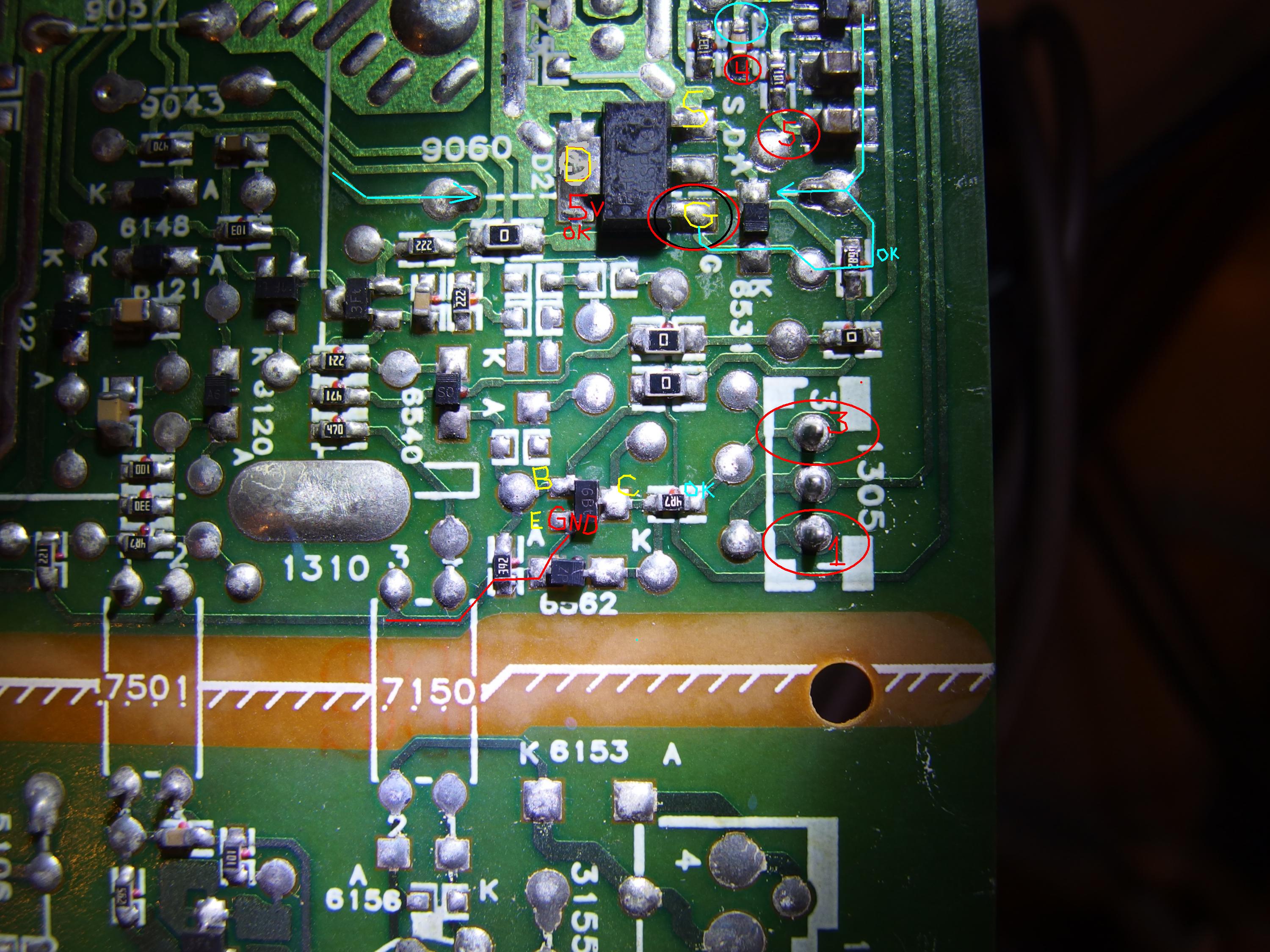

              more to check on this non switching issue
              we know red Gnd is ok ground
              can you check the other 5 red circle for ground or not ground
              recheck 5v ok at the transistor yellow D
              and double check to make sure 5v is still not on the yellow S pin
              also check for possible voltage to the yellow G pin and yellow B pin at the smaller transistor and small blue circle at the top of the picture

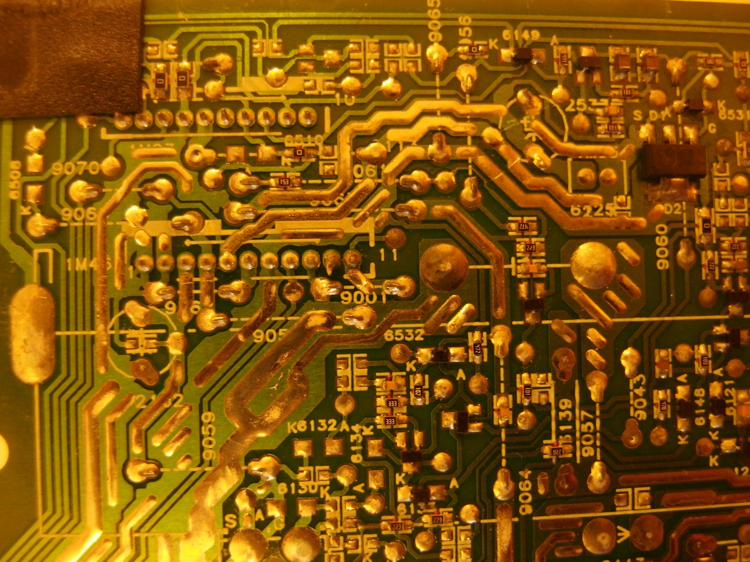

              and , if I could get another pretty picture like this from the top of this area to and including the 11 and 10 pin connectors, that may become useful
                Re: Philips 37PF7321/98 cannot turn on
                ^^^^^^ Picture to go with this?^^^^^^^^
                  What, no x-ray vision !!??

                    Red circle 1 and 3 are 5v
                    Pin 2 of 1305 is 5v, all3 pins of 1305 are 5v
                    Red circle 4 and 5 are 0v
                    Yellow D is 5v. Yellow S is 0v. Yellow G is 0v. Yellow B and E are 0v. Yellow C is 5v. Blue small circle is 0v.
                      all 3 pins on 1305 is 5 volts !!
                      Well that doesn't right
                      we should have a 5v and a ground
                      do you have the 3 pin wire to the power supply connected ?
                      I also need to know if any of the zero voltage ones grounded
                      turn off power
                      and check them with the ohm setting

                        Yes, 3 pin wire 1305 is connected to the power supply board.
                        Red circle 4 and yellow E are ground.

                          disconnect the 3 pin wire and recheck those 3 pins for dc and ground
                            None is ground.
                            When I power up with 1305 disconnected, all 3 pins are still 5v.

                                        he means the wires from the power supply to the inverter board that lights the bulbs of the screen.
                                        That board is still buried in your first pictures.
                                        What I think we need is power to get to the Gate (yellow G) of the larger transistor
                                        At this point, if it were my board, I would jump a ground line to that Gate and see what happens to the source (Yellow S) voltage wise and if nothing, I would then jump voltage to that pin
                                        then IF the source activated, it should activate the smaller transistor and cause the number 3 pin to ground and if it does that then the relay should turn on
                                        that is providing both transistors are good
                                        and nothing goes POOF !!
                                          What is happening???
                                          I jump a ground to Gate and now the Gate is 20v and Yellow S(source) is 5v.
                                          And the pin 3 of 1305 is 0v.
                                          When I power off and on the tv, the led light on the front panel is green and stay green. Before this, the led is green and after about 2 sec will turn red.
