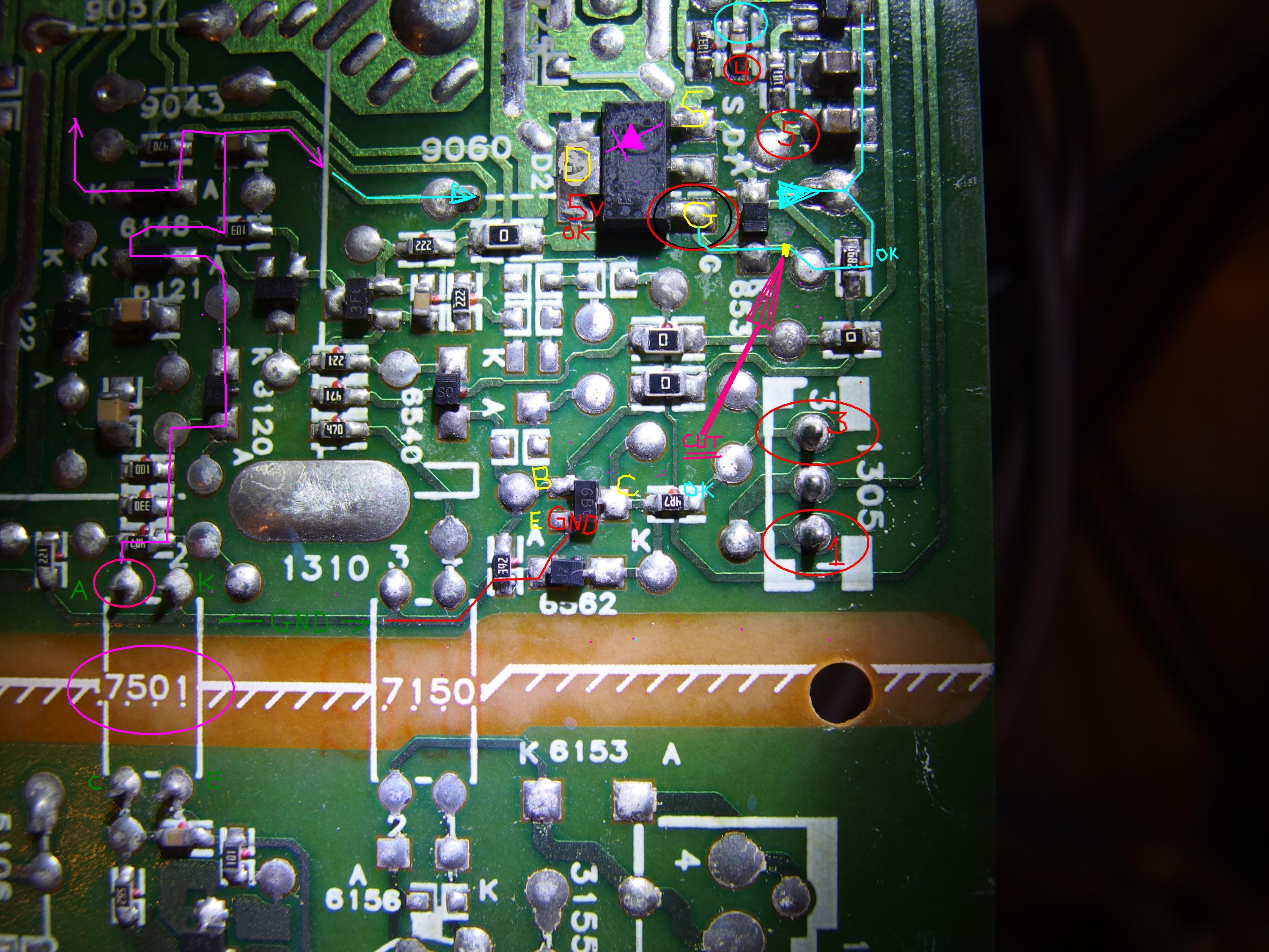

    Originally posted by bammbammfran View Post
    now recheck usual voltages at G D S and at 1305 and also check the pad to the right of the cut
    Gate is 9v
    Drain is 5v
    Source is 5v
    Pad to right of cut is 85v

          Re: Philips 37PF7321/98 cannot turn on
          Old transistor on board.
          With pin 7 out from 11 pin plug and trace cut, the voltage of Gate is about 6v, Source and Drain are 5v. All 3 pins of 1305 are 5v.
          Pad to right of cut is still 85v.
          When I jump ground to Gate, the relay clicks and the TV screen lights up. That means I can turn on and off the screen by touching ground to Gate.
            now we need to try to find out where the hell 85 volts is coming from.
            may be leaking from high power side ?
            start with checking the pins on the optocoupler at 7501
            also mark anything that is showing over 14v on that quarter of the board
            basically back track from that 85v pin
            you'll see in my picture that I started tracing, but there is a couple parts like where the pin traces T-off that I am not sure if it goes that way
            if you run into a component where it changes voltages, make a not

                        "Back track from that 85v pin" means I should trace from the pink or blue line of your pic?
                          the 85 volts is showing right now at the solder pad to the right of the yellow cutout trace which starts as a light blue line and goes in two directions.
                          It can partly be traced with an ohm meter, but I think it would be easier to track it with the 85volts active
                          so without a fuse, that won't be doable
                          the orange rectangular fuse at 1500 on the standby could have been stolen for temporary use but it is probably not rated high enough in amps ???

                                I started retracing from a different part of the board and it looks like the last picture that I posted is incorrect at the pink T
                                this one should be more correct
                                Still tough to see some stuff and I am not 100% sure if the T in the pink line At the pink circle marked with a pink B is correct
                                green is ground
                                red is 5volt
                                pink appears to go to or from the transistor gate
                                I lose track on the right side at that one diode at white A

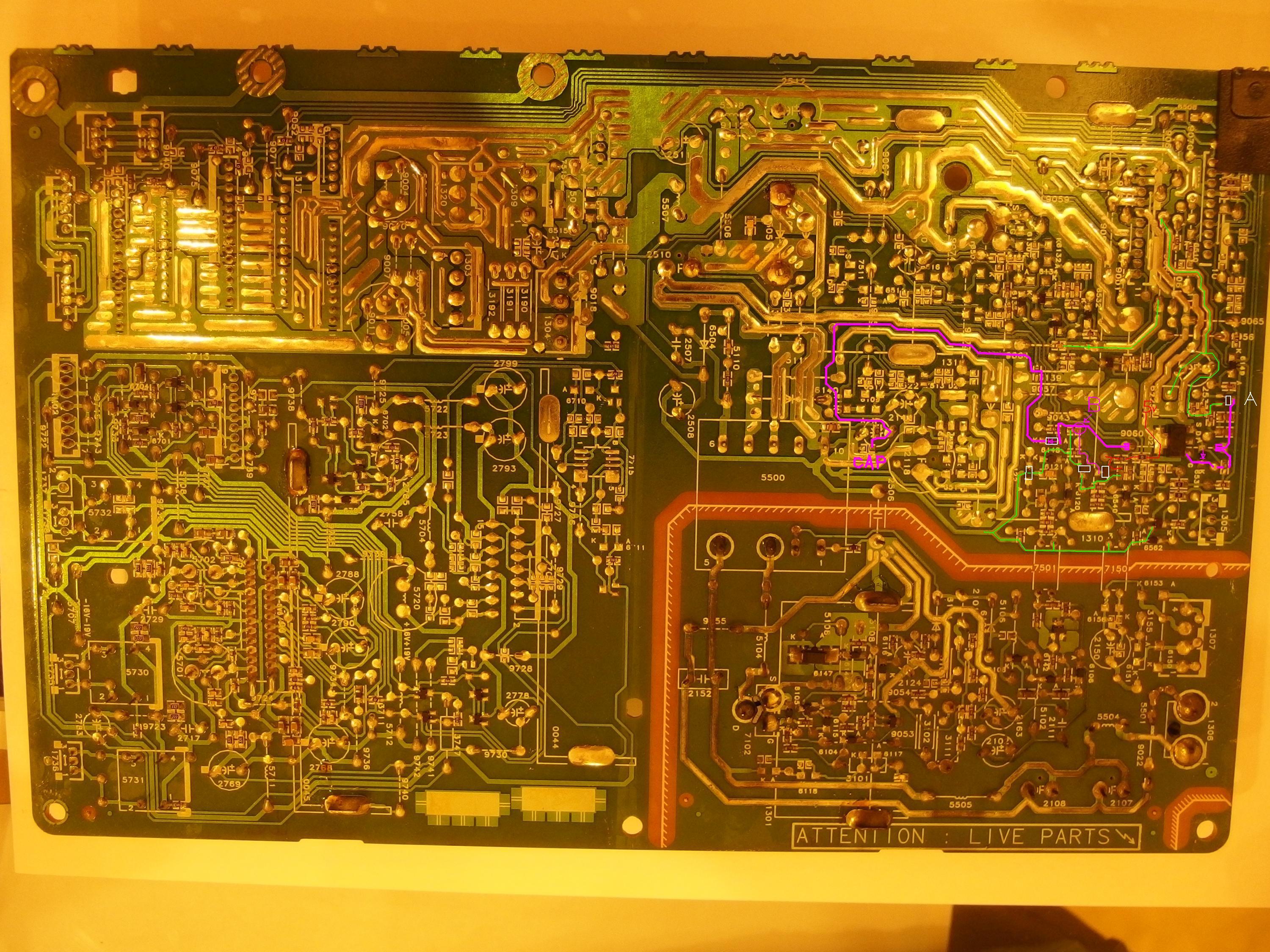

                                  green is ground
                                  red is 5volt
                                  I added some tracing at white A.
                                  The thinner pink line at the pink circle is not touching the thicker pink line.

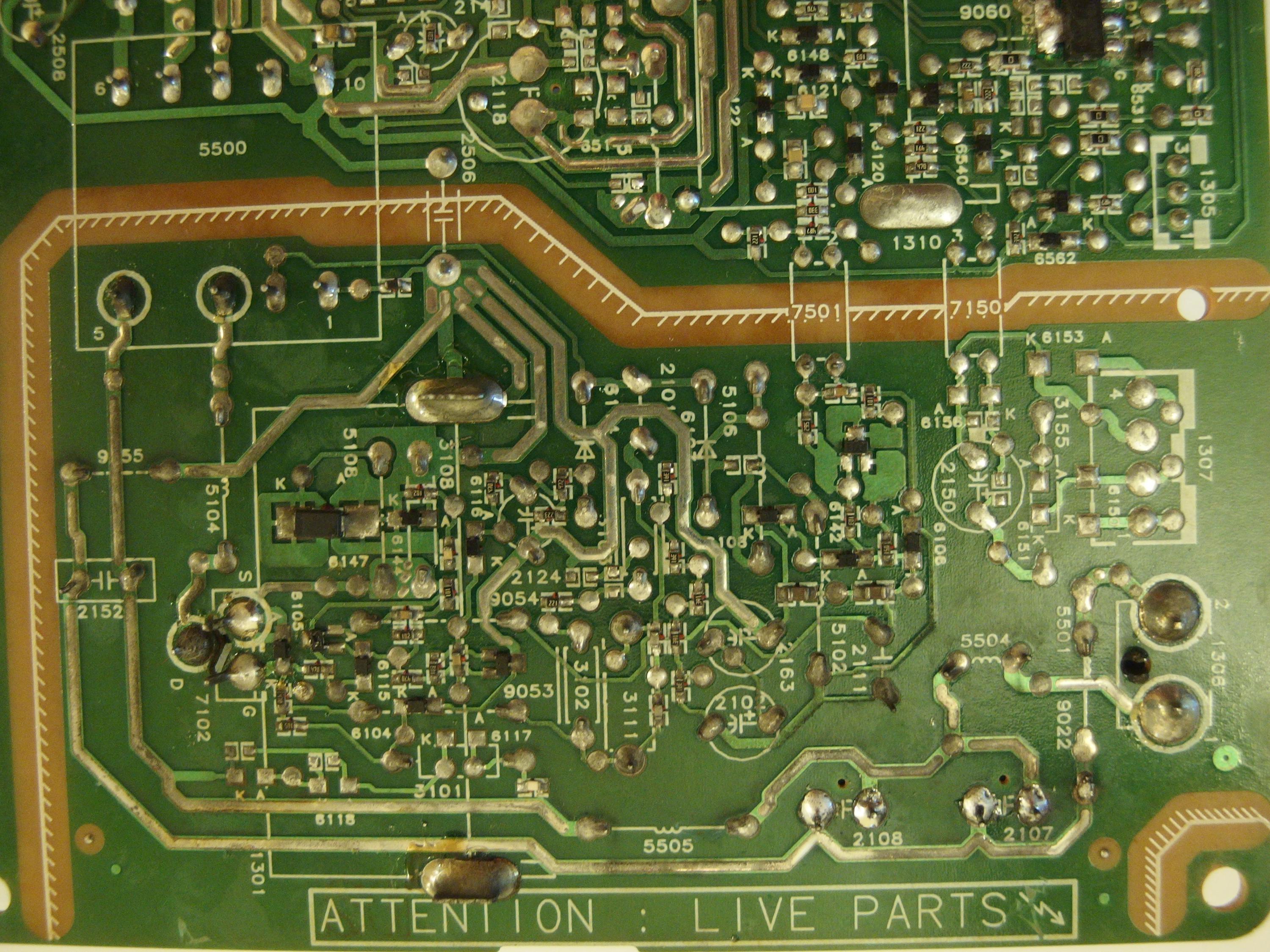

                                    Put in new fuse at 1315 and switch on main power from wall. Fuse blown sky high.
                                    Check the hot section of the standby board and found it has shorted.
                                    There is continuity from pin 1 and pin 2 of 1306. Also from pin 1 of 1306 to as far as all pins on hot side of transformer. Even the transistor 7102 has continuity to 1306.
                                    Is the board fried?
                                      take out one end of 5104 and recheck 1806 power plug pins
                                      then check resistance at all 3 pins to each other on 7102
                                        ok on the thin pink which means there ia a direct line from the capacitor by the main transformer all the way to the gate. only thing in the way is a diode that should be blocking that voltage. so that diode need to be check to see if it only allows resistance in one direction
                                        so , at the transistor that I marked with the white A the trace that goes under that transistor is from the single pin side up to the 471 resistors right side ?
                                        If that is the case, then we have to figure out where the top left pin of that transistor goes. the 253x white numbers cover the traces
                                        FYI: At the diode at 6149- the top K pin goes to 5 volts at the 9065 jumper
                                        and the jumper below that goes to the 0 resistor and also gets 5 volts and that feeds 5 volts to the 1 and 2 pins at the 1305 plug
                                          is 8105 cooked by the 7106
