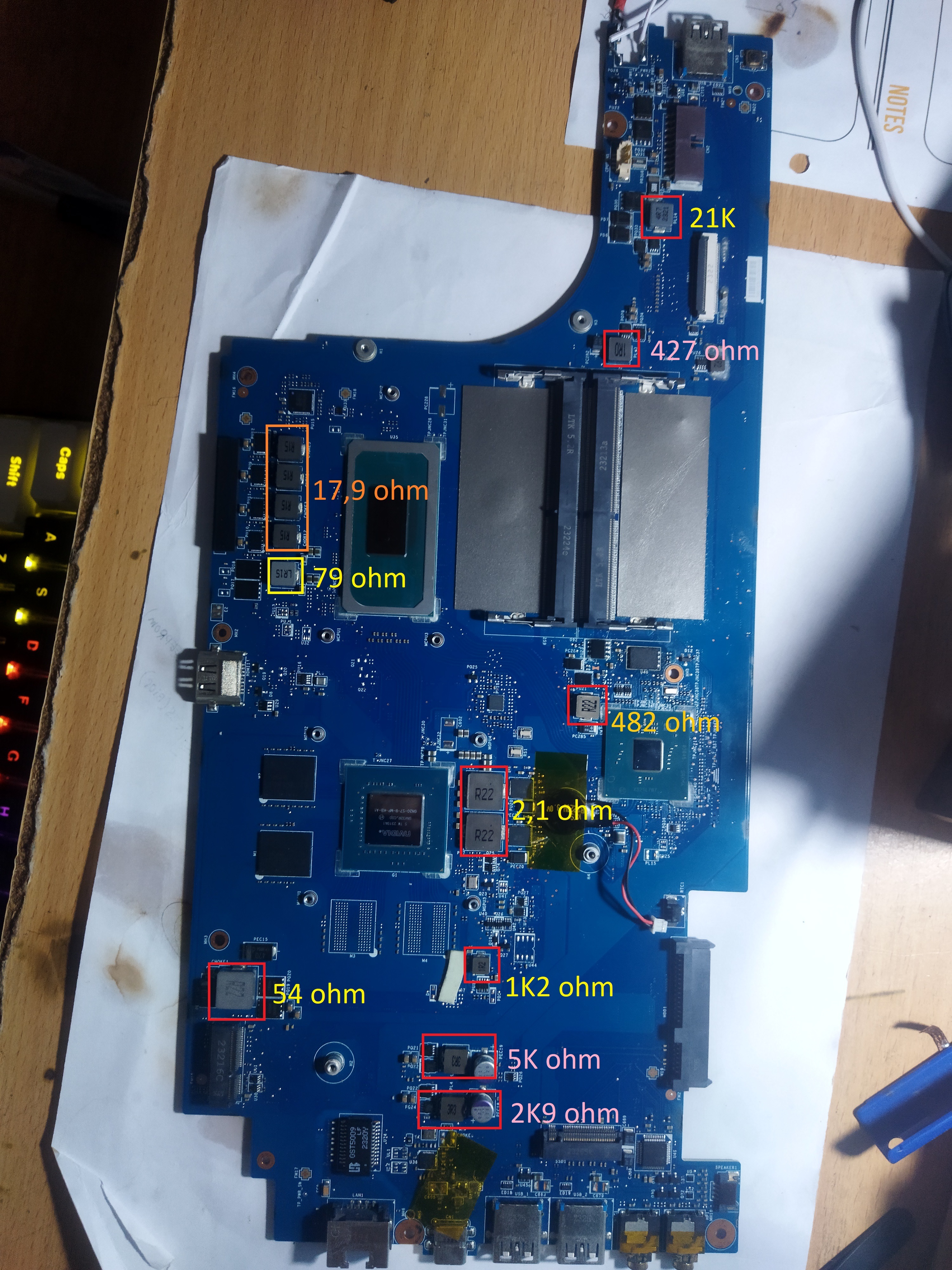

            Hi, I have finished checking all the inductors, I will attach the measurement results below.
            does that indicate a short circuit?

              Well, next time better do one picture ( or two, if there are coils also on the other side of the board ), and write measured values on the picture ( like for example here, in my thread ). What is more important, don't use diode mode, but switch to resistance measurement. You also forgot to mention the board number.
              Btw, do you have any programmer for flashing bios?
                oh I see, I apologize..I forgot to tell you the board number I have.
                Board number: MS-16R61 VER 2.2
                I measured the incoming voltage around 20v then the voltage of 5 and 3 volts also appeared, but when I checked using a power supply at 20v, the ampere value did not move at all aka 0 ampere. for measurements using resistance how do you know if something is shorted?
                oh yes for the bios flashing tool I have a ch341a programmer, coincidentally I have flashed my laptop bios too, but it still won't turn on.
                maybe I attached a photo of the board that I have below..oh yeah I'm also really confused because this msi does not have a schematic.

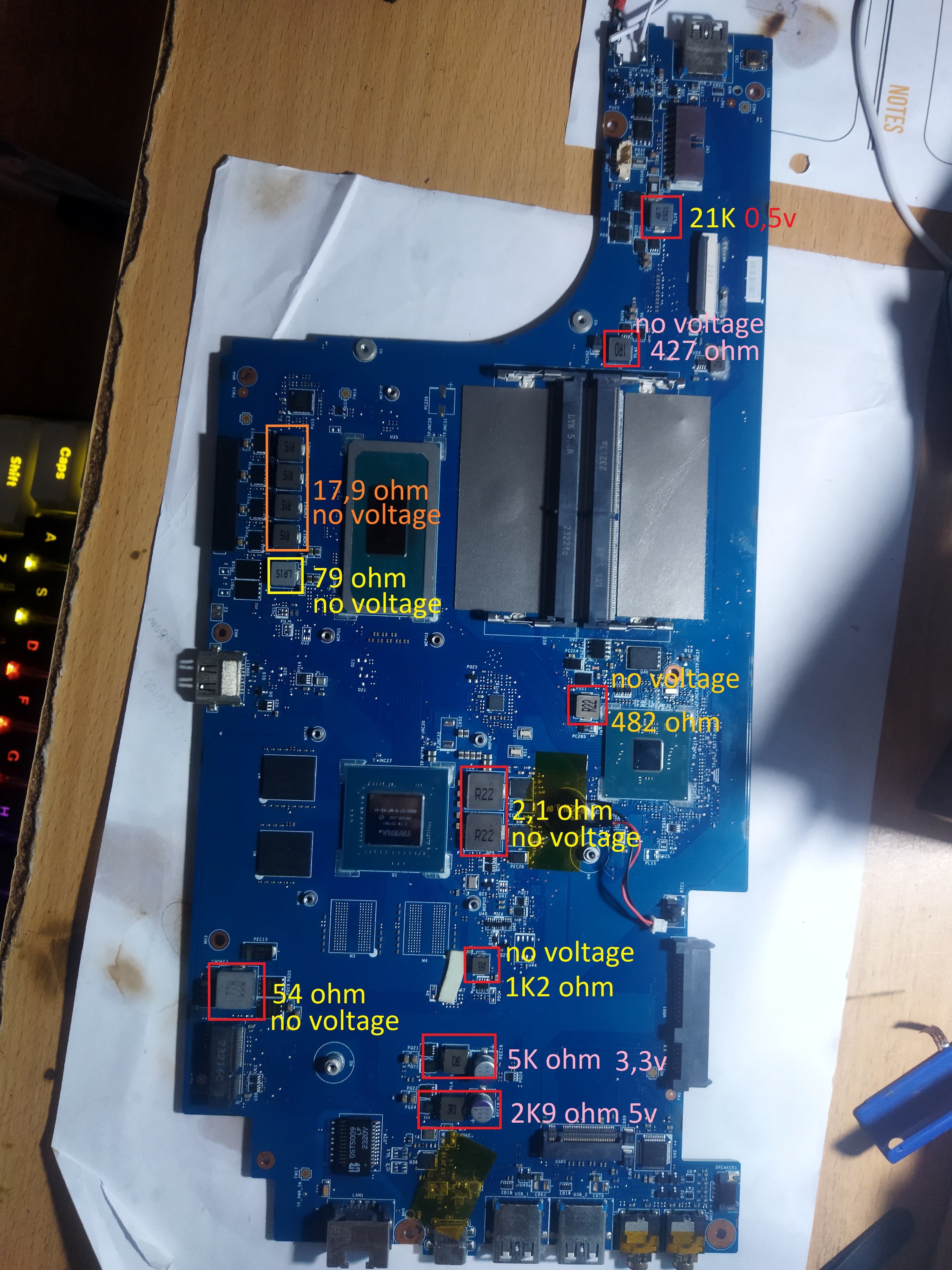

                            Indeed, the resistance measurements looking somewhat okay. But for some reason i missed the voltage measurements listed. Are they somewhere?
                            The EC is per 99% not the problem after succesfully releasing the Enables for the 3V and 5V ALW rails

                              I'm sorry, if I may ask...where should I measure the voltage? is it on the coil? or on the mosfet around the coil? I'm really a beginner here. I will attach a photo of the results of measuring the voltage on the coil.
                              for EC it looks like you are right there is no problem because when i install the battery and then plug in the charger then the charging indicator appears. it's just that it doesn't respond when i press the power button.

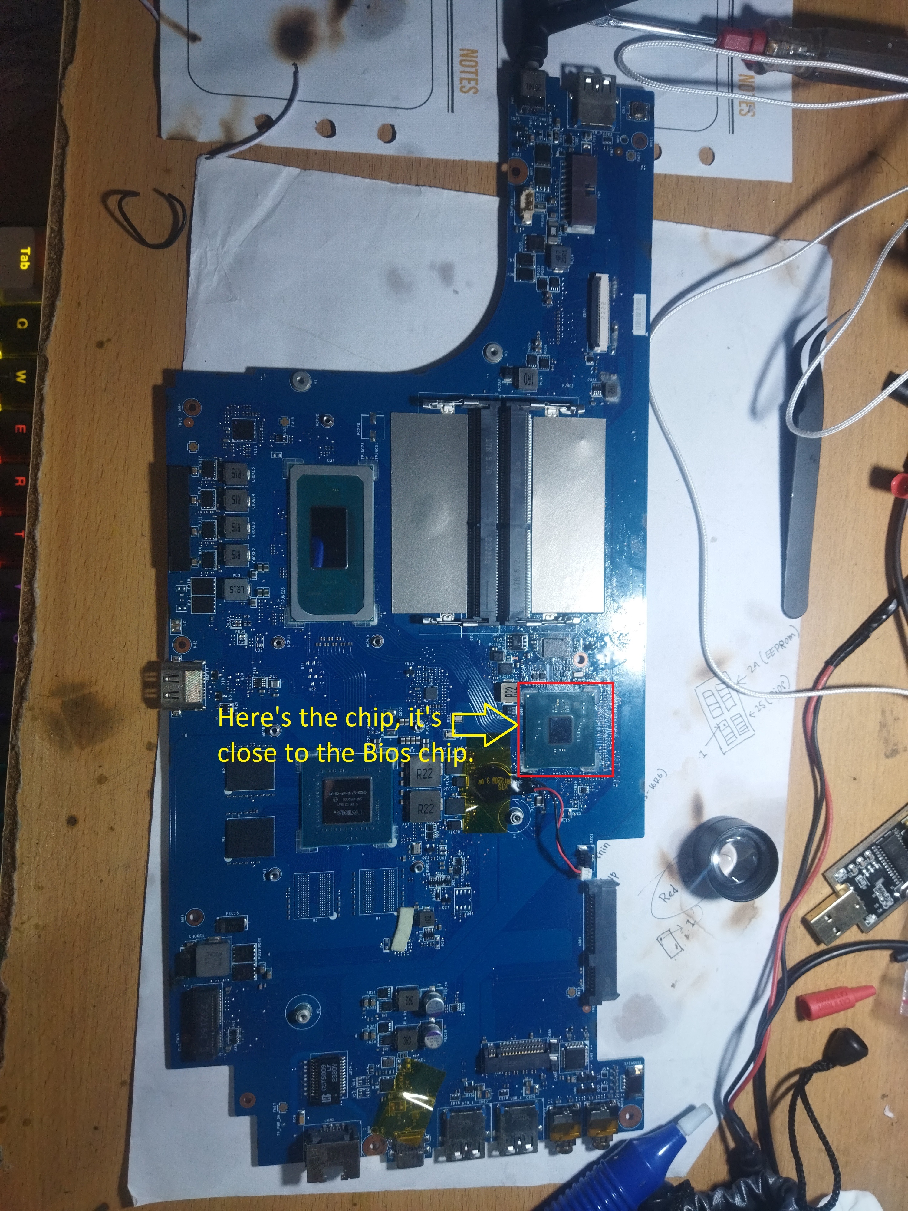

                                Oh yes, when I plug in the charger cable, I feel this chip is a little warm but not hot (I checked with an infrared thermometer around 35 degrees), is this normal?
                                I have attached a picture of the chip because I don't know what kind of chip it is.
