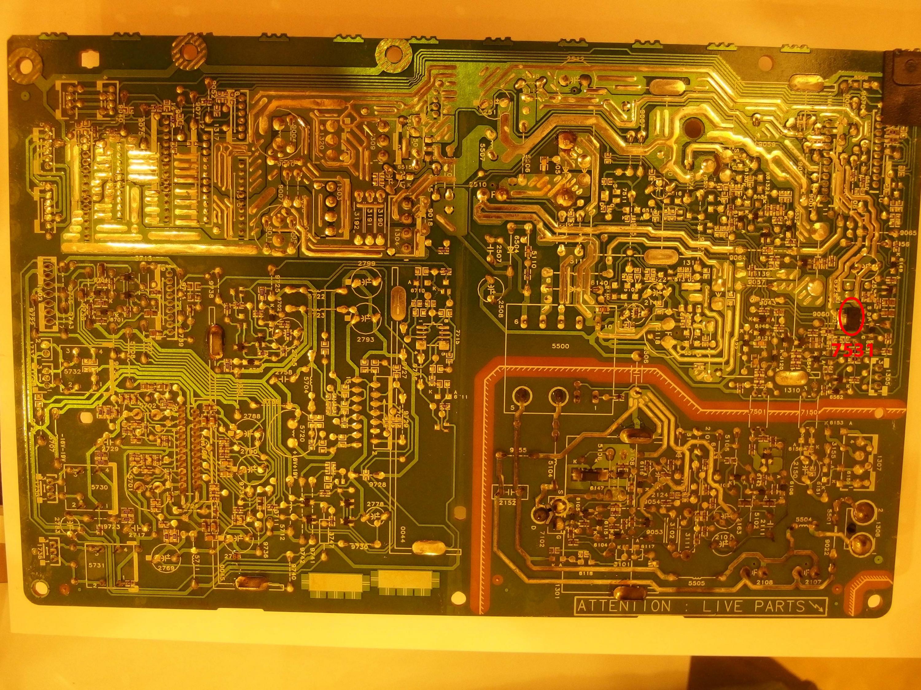

                  There is a mosfet at 7531
                  and quite afew switching transistors bc817-25w and bc847bw
                  How can I test this mosfet 7531?
                    #89
                    Re: Philips 37PF7321/98 cannot turn on
                    where the heck is 7531 ?

                          It is on the reverse side of the standby board. It is very hard to see, I just found it too.
                                          OK
                                          again, when using external 5 volts to the relay, make sure the 3 pin wire is disconnected
                                          Those pins go to that 7531
