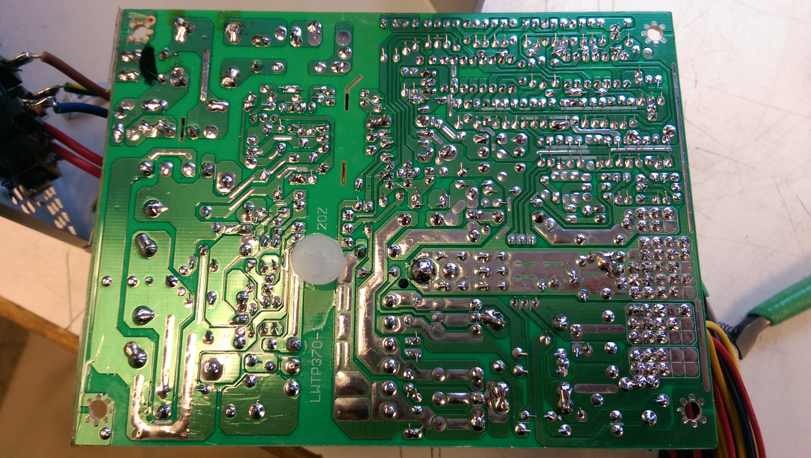

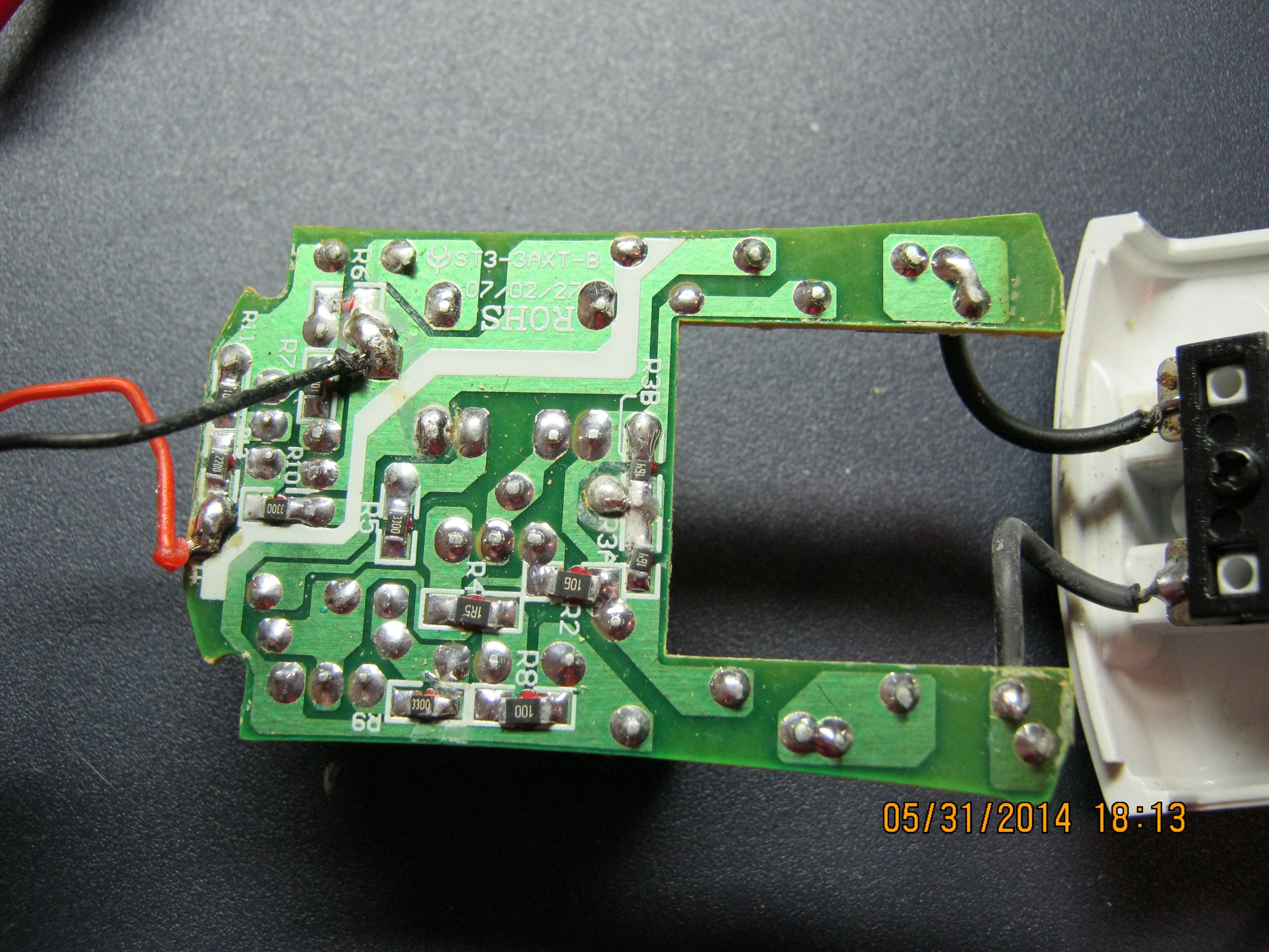

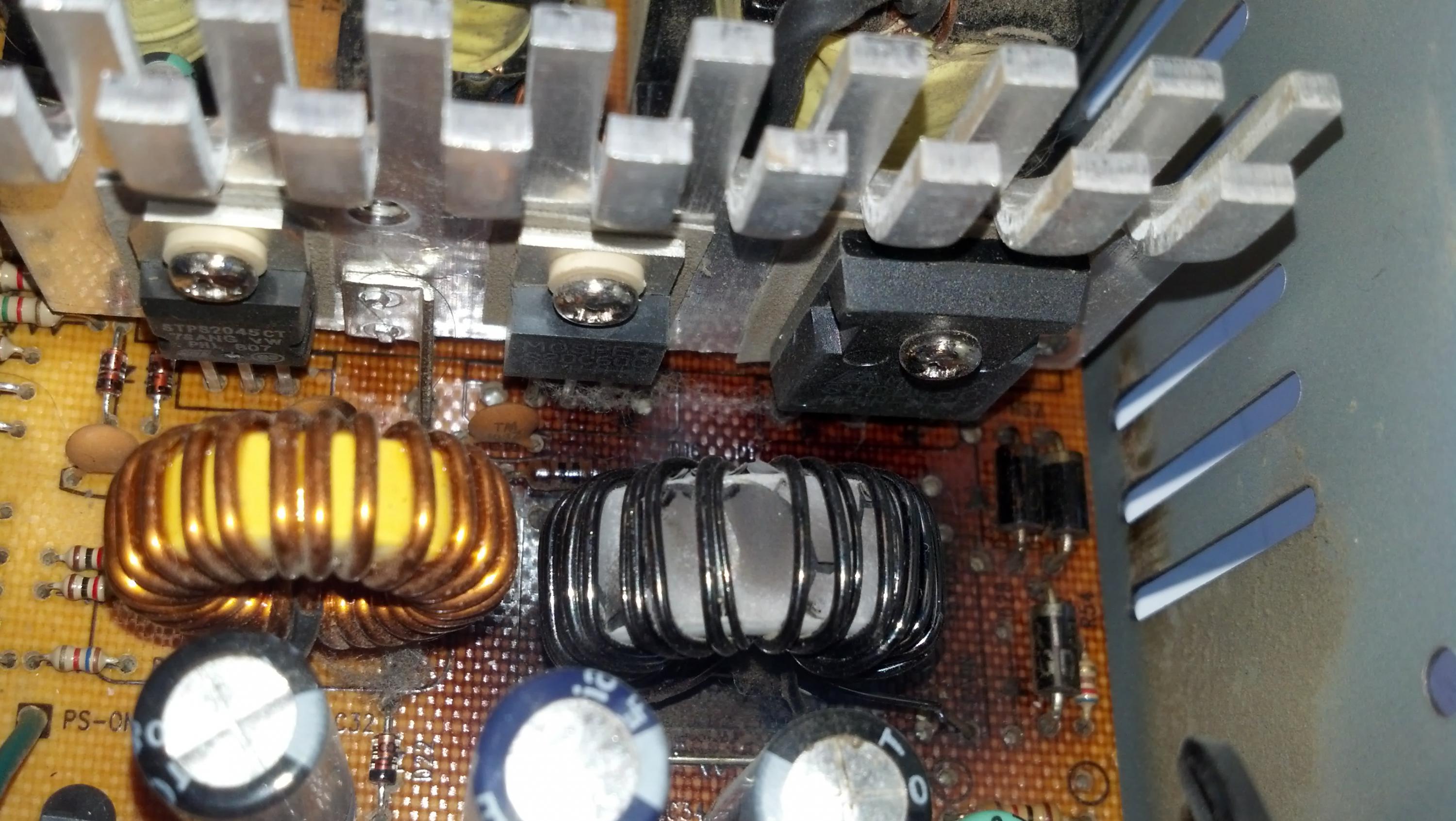

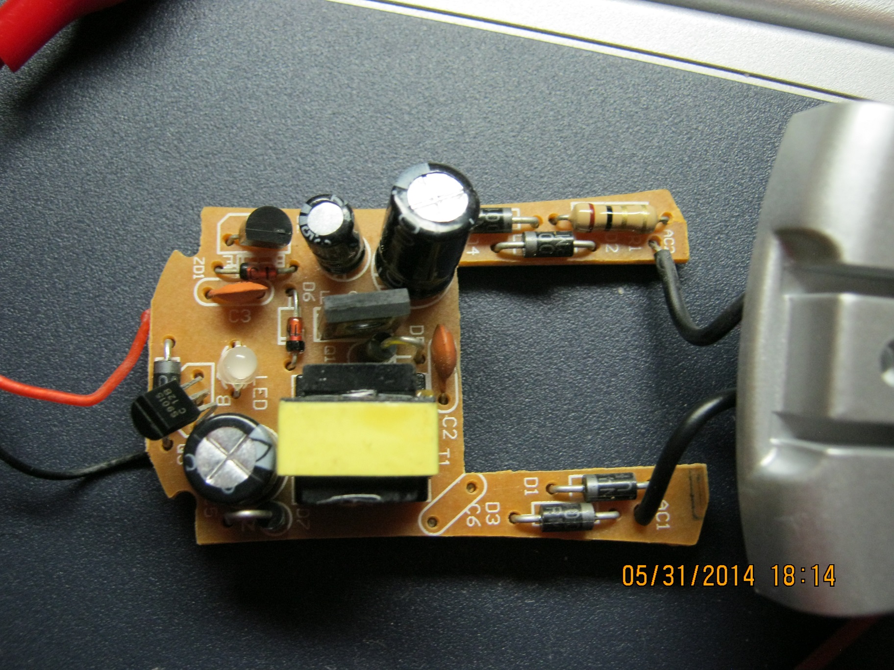

      Re: the gutless, bloated, and fried power supply hall of shame
      Just Wireless 04111
      I have posted about this charger before, but I know slightly more now. Also, I figured out how to take usable pictures with my horrible camera since then.
      It uses the two-transistor oscillator circuit with 13003 and C945 transistors. The secondary rectifier is a 1N5819, and the filter cap is 470uF 16V That seems acceptable for a simple 2.5W power supply.
      However, the primary and secondary ground are connected directly together. The output ground wire is connected directly to the negative lead of the primary filter cap. Only the bridge rectifier separates the output from the 120VAC input. That doesn't seem okay to me.
      Whether that is safe or not, this is a piece of junk. There is no feedback, and the output voltage drops significantly as the load increases. Yes, I actually plugged it in. The output with no load is 5.95V. The output drops to 4.7V with a 300mA load and 3.6V with a 500mA load. When the load is removed, the voltage increases to 6.1V. The output cable drops 0.3V with the 500mA load.
      The current sensing circuit used to light the yellow charging indicator LED just measures the voltage drop across a 1N400x diode that is connected in series with the output. This adds an extra voltage drop and an extra source of heat. This diode runs hotter than anything else in this piece of crap, and it seems to drop 0.8V instead of 0.6V like a normal diode should.

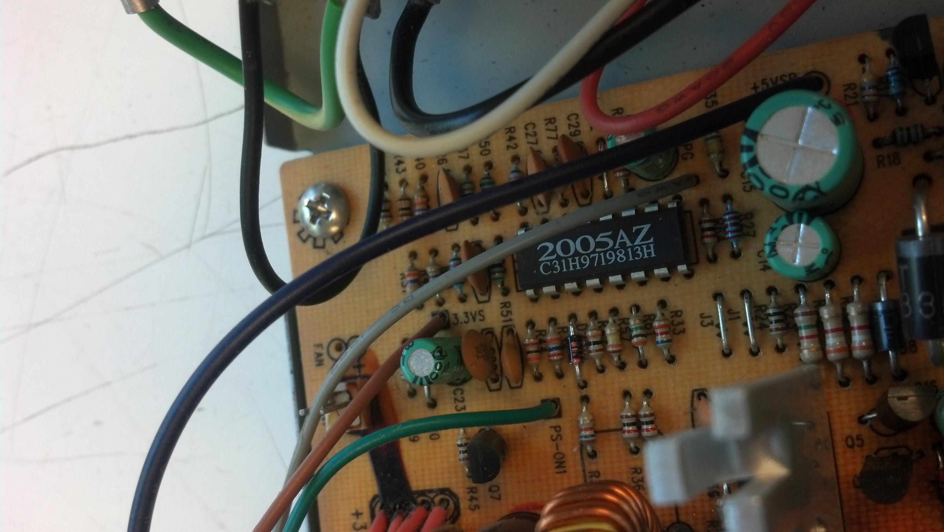

        #983

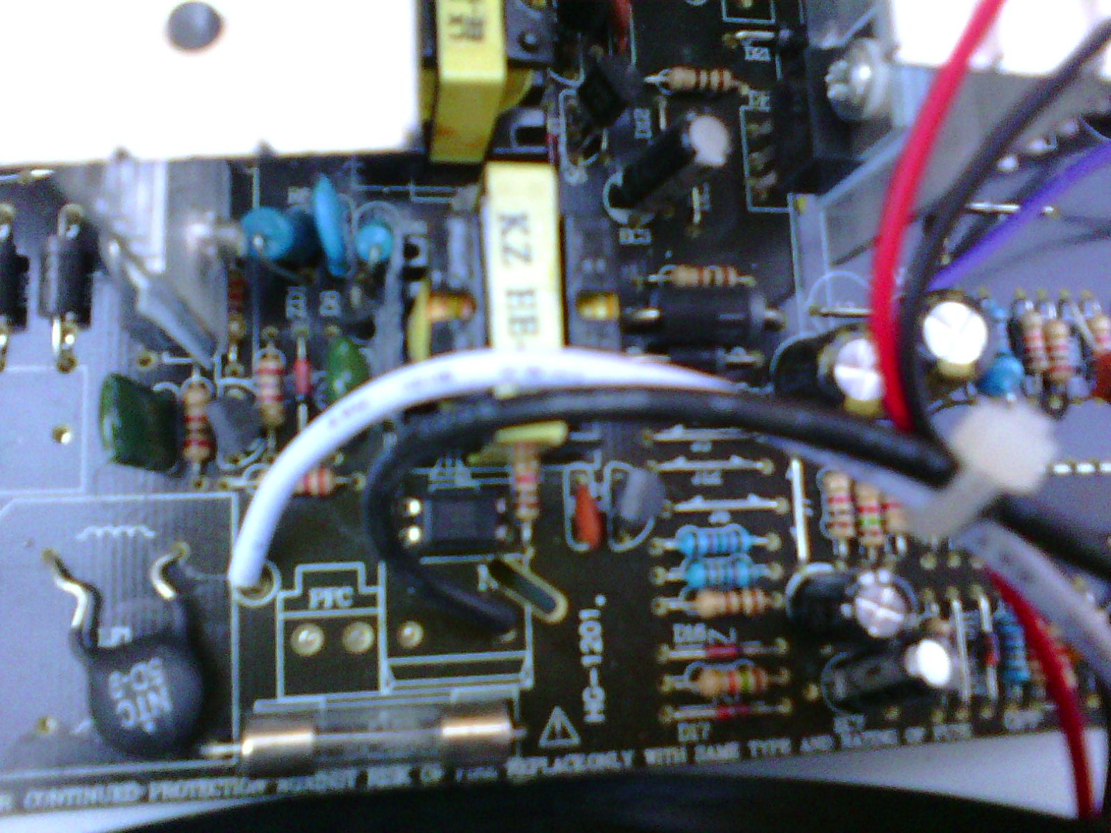

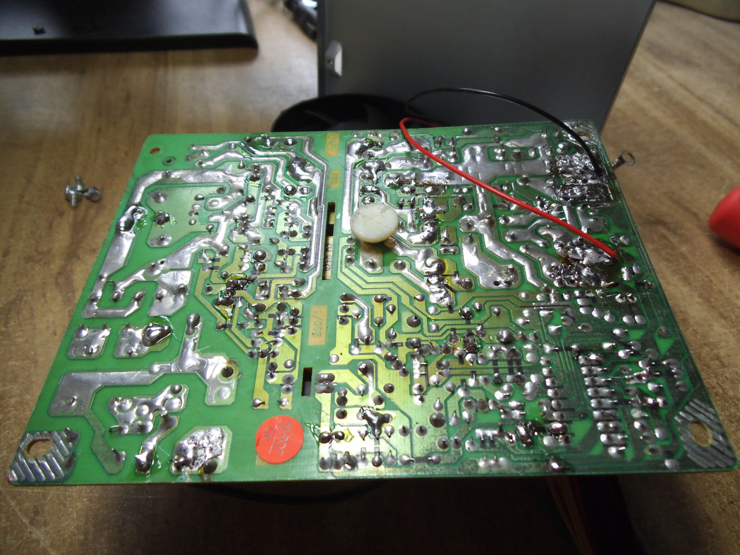

        Nift lc-8500btx
        The fan failed on it, and so it overheated. It smells absolutely terrible, and so does the case even after replacing the PSU and dusting it. Surprisingly, all the hardware is okay. The Panny caps on the mobo could handle all the extra ripple surprised the hard drive is okay though. These things have high ripple brand new, let alone with failed caps! Also, this is the first time I've seen a "2005AZ" chip

            #985
            Re: Nift lc-8500btx
            Probably the 'lead-free' version - Or pretending to be...? A lot of manufactures seem to use a Z suffix code for lead free.
            -David VanHorn
              • 30948
              #986
              "Or pretending to be...?" ??
              why pretend, lead costs more than tin.
              and tin costs more than nothing - there is a chinese source selling TI chips with bare pins.
              they are getting them after resin-stage and before the tinning - probably via the fire-exit!

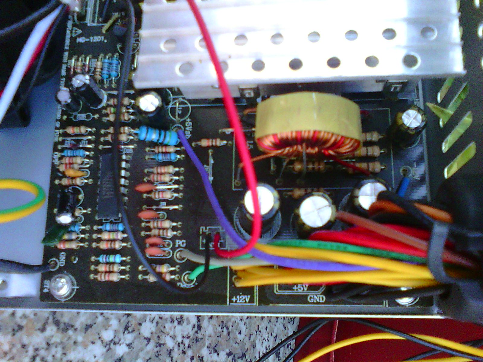

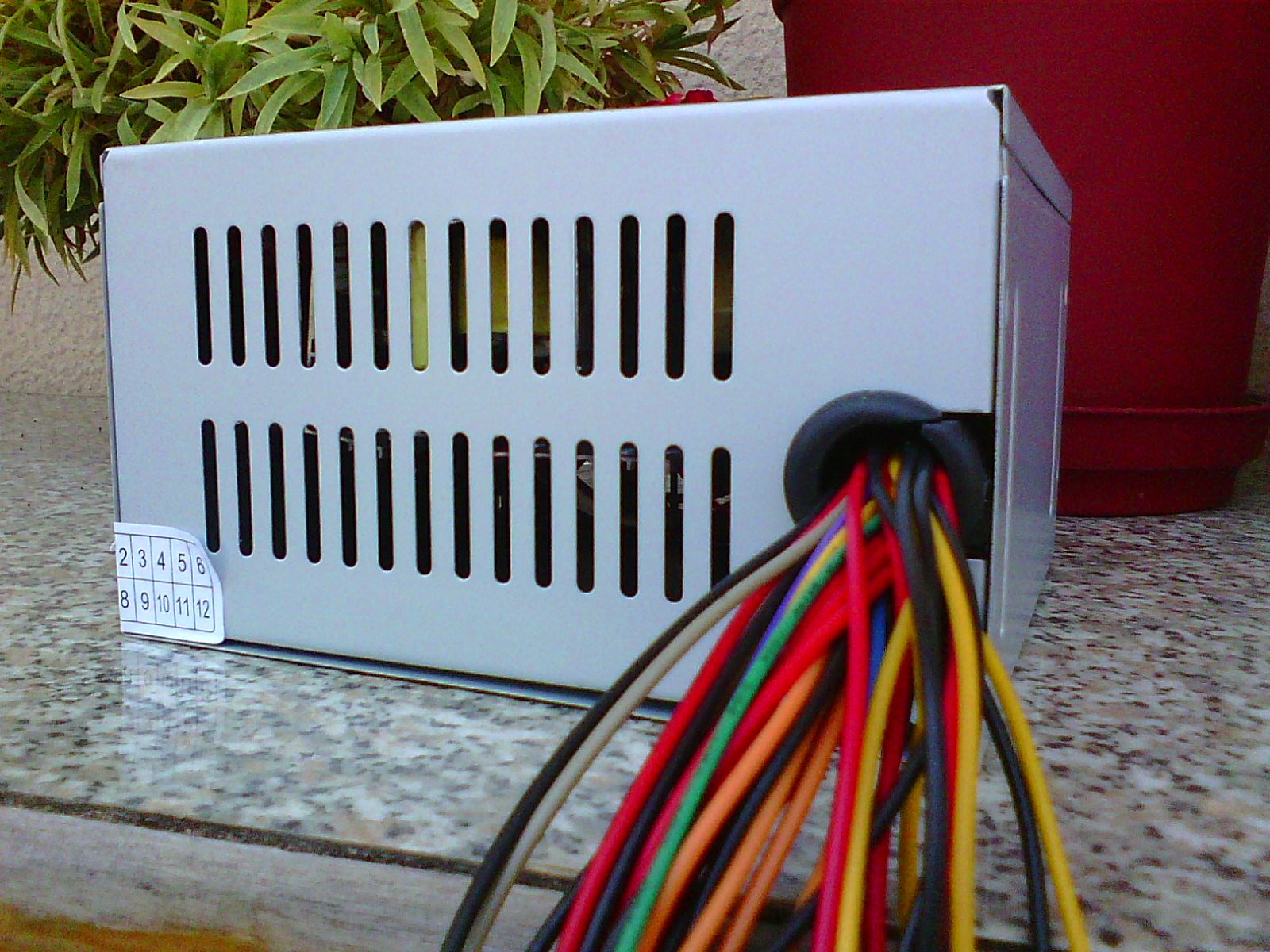

              • goodpsusearch
                • Oct 2009
                • 2850
                • Greece

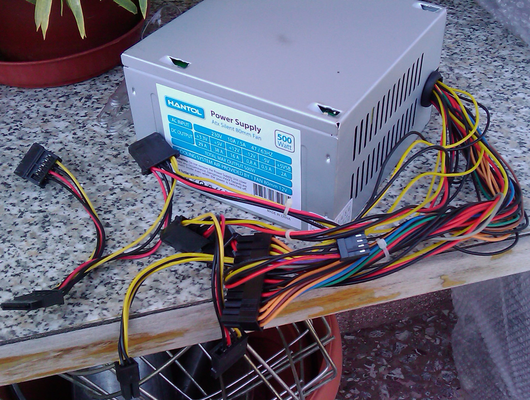

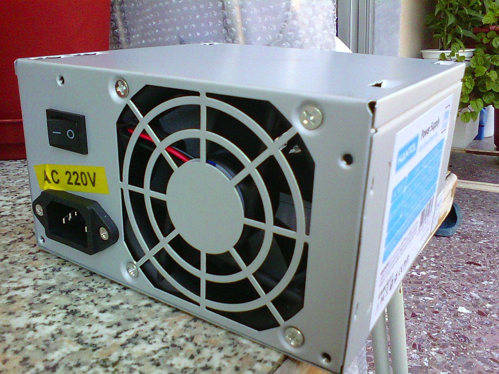

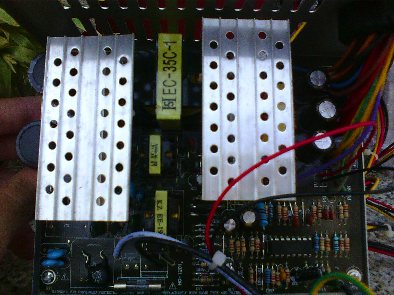

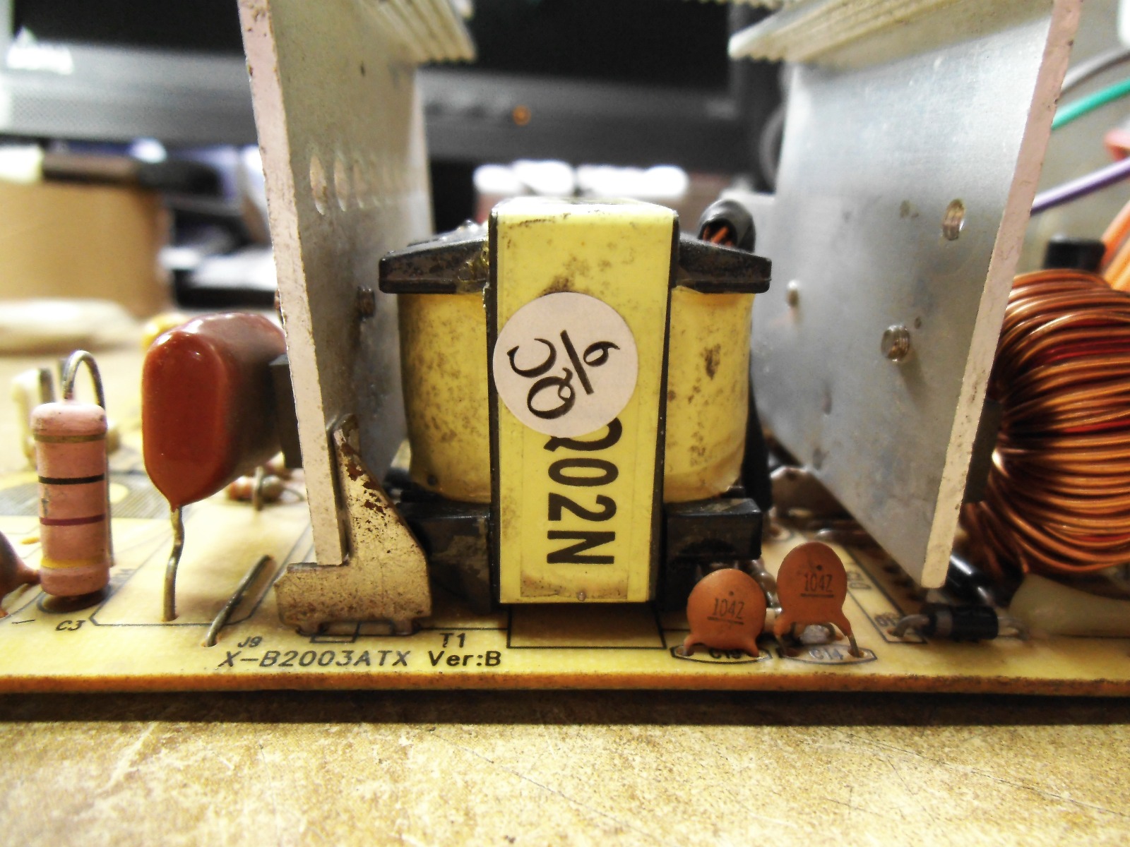

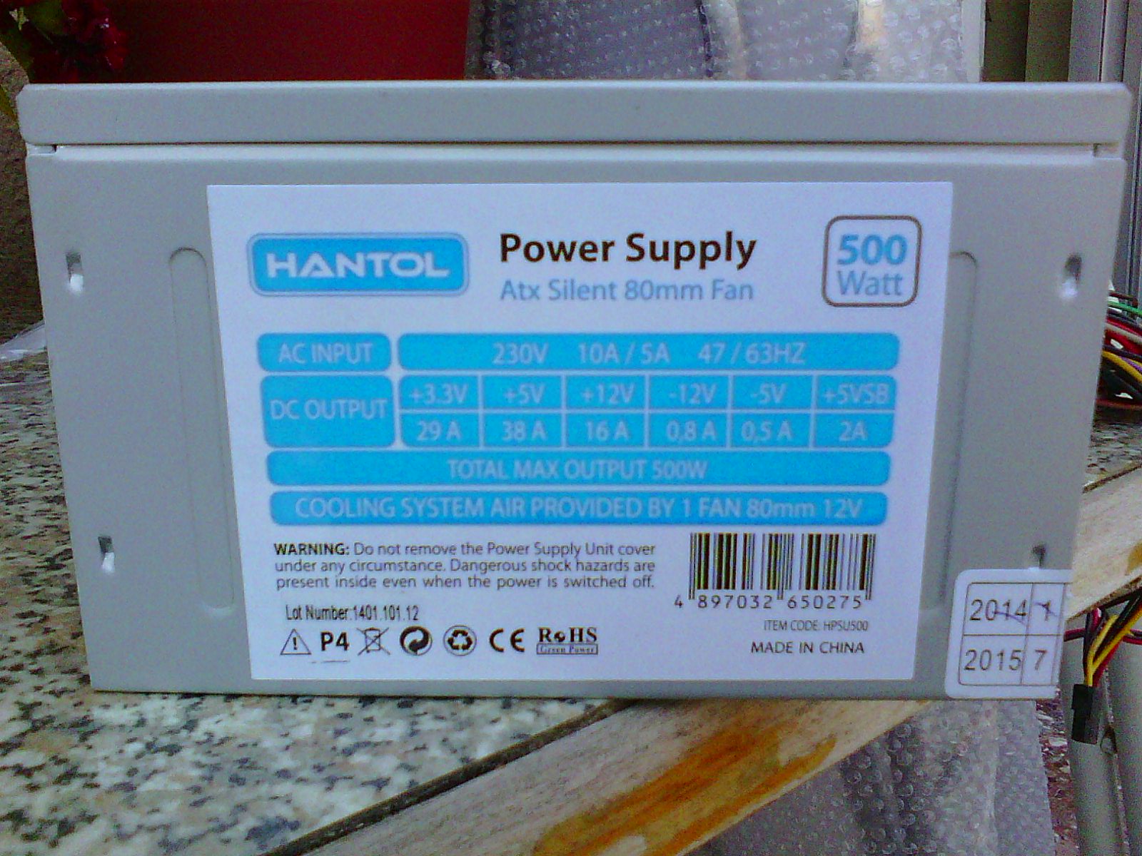

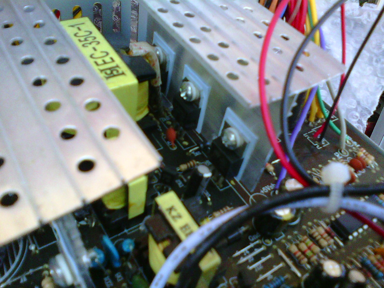

                #987
                Hantol HPSU500
                Yet, another terrible power supply. This time there is no fake PPFC because there is no PFC at all! The output torroid coil is used for 5V, 3V and 12V.
                I didn't take the photos.

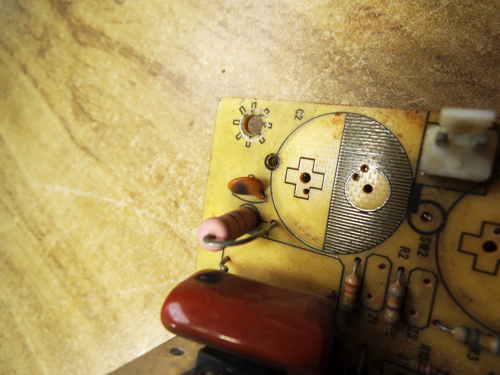

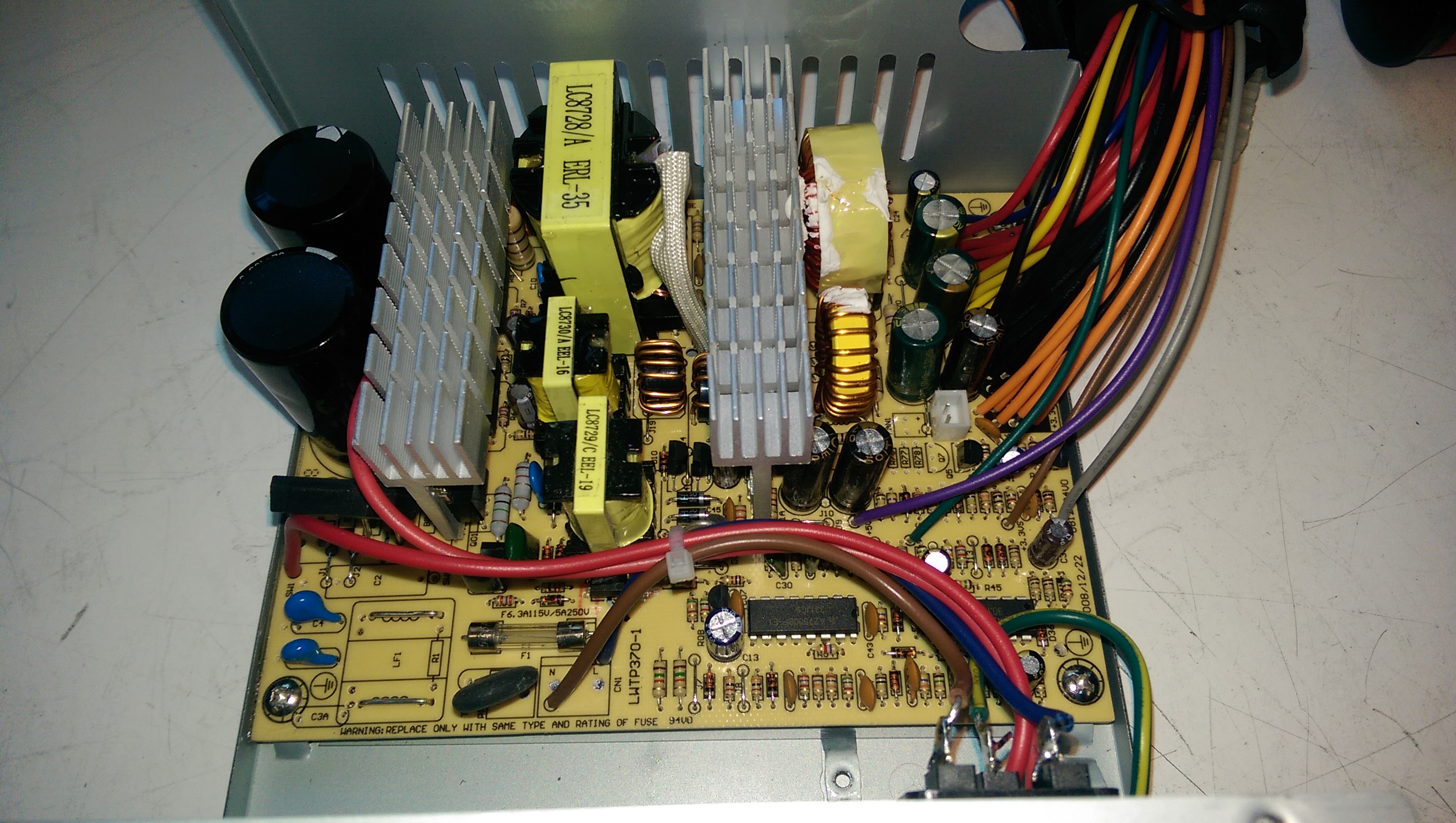

                                #995

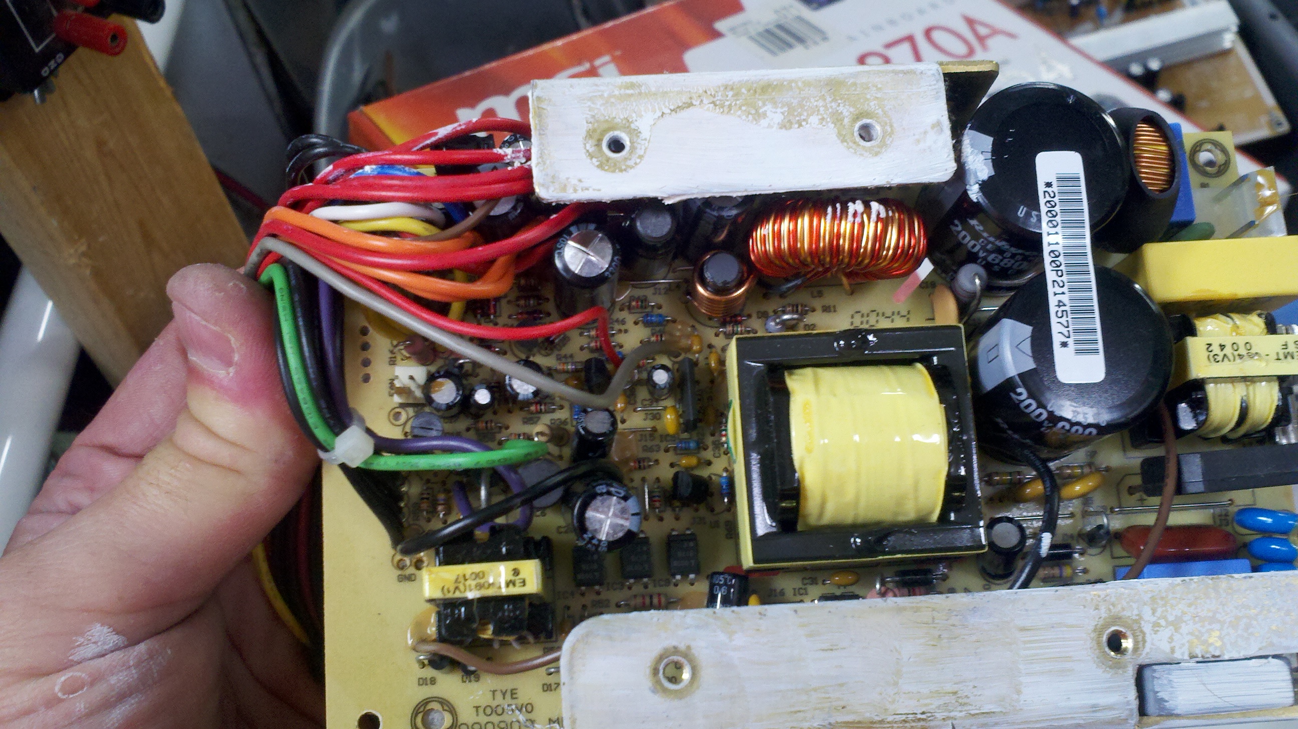

                                had an emacs itx unit i got new 5 years ago pop a cap.
                                it was run about 15 minutes for a test and stored.
                                last week someone brought in a thoroughly roasted one.i new these had lousy caps so i figured i would recap it before modding it to run the tool grinder it was headed for.
                                dammed if it didnt have a badly popped cap!
                                now this did not happen while i ran the original test!
                                i would have heard it.
                                it either popped during the assembly line test or while it was sitting!
                                • PeteS in CA
                                  • Aug 2005
                                  • 3578
                                  • USA, Unsure of Planet
                                  #996
                                  Those two smaller transformers have what looks like date codes of "0017" and "0042". If so, that thing's more than 13 years old (or at least the transformers are).
                                  PeteS in CA

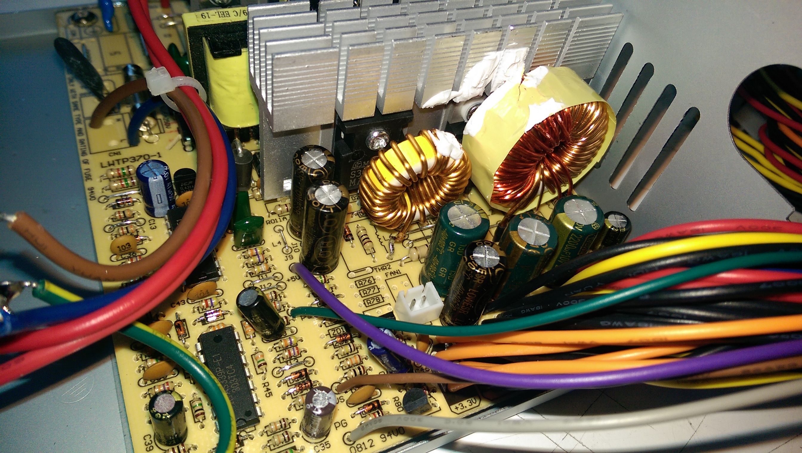

                                  • Pentium4
                                    CapXon Be Gone
                                    • Sep 2011
                                    • 3741

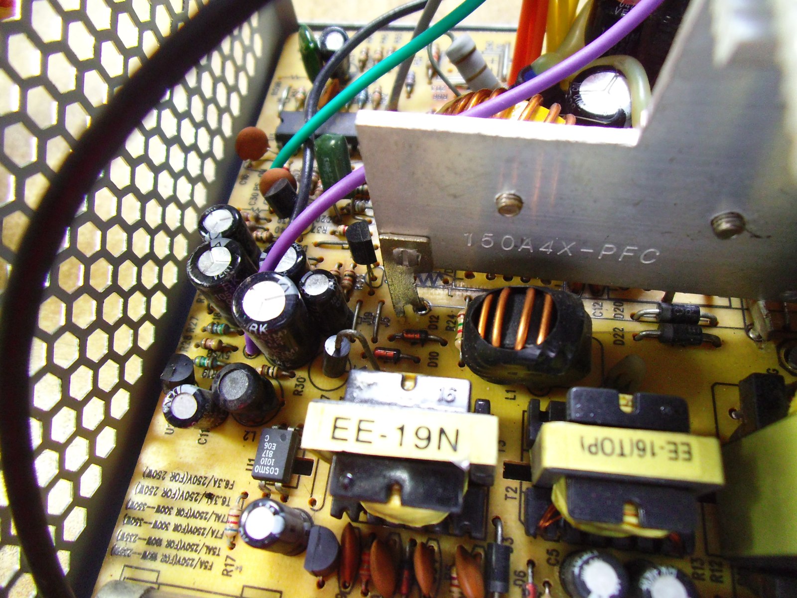

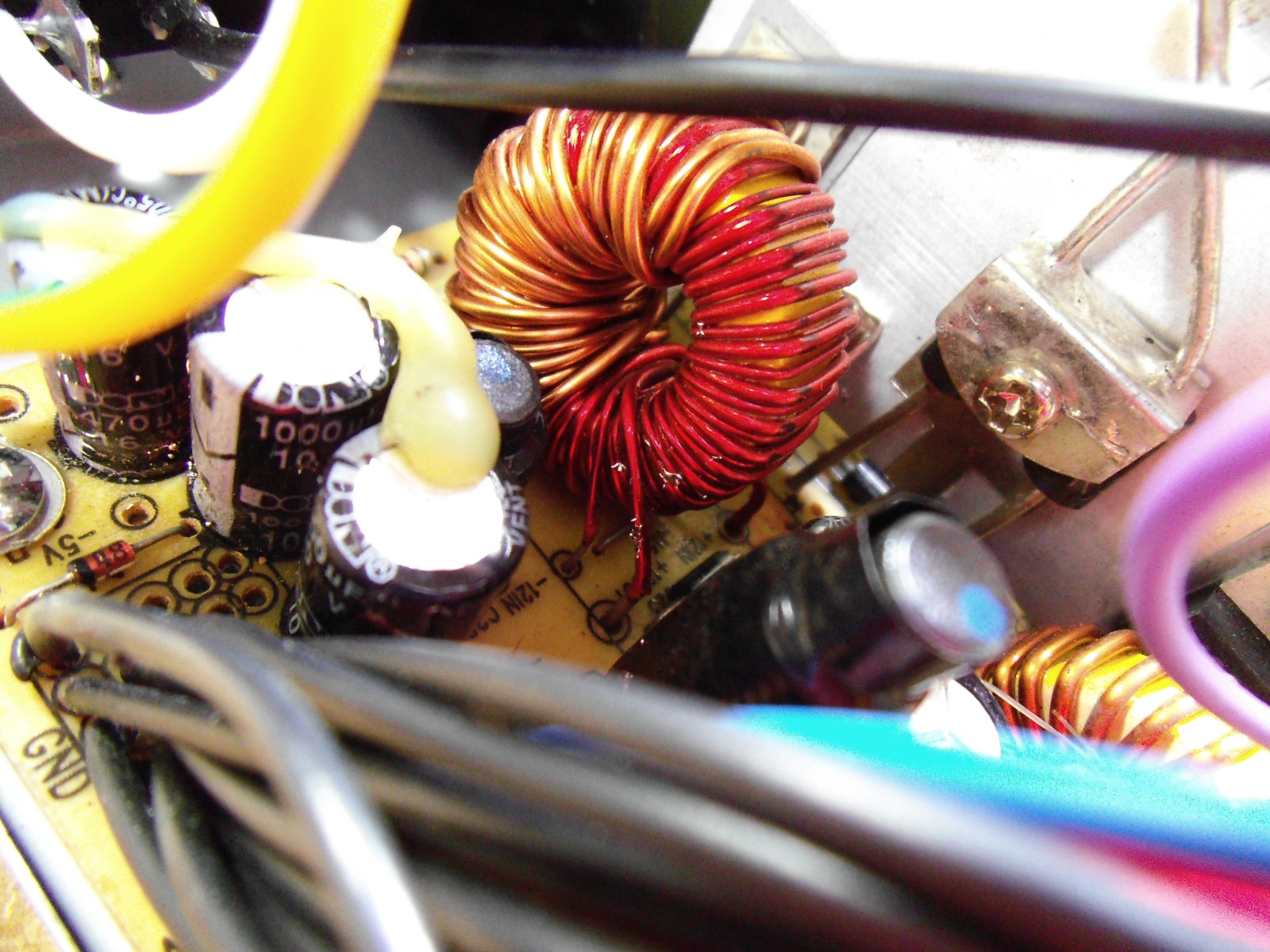

                                    #997

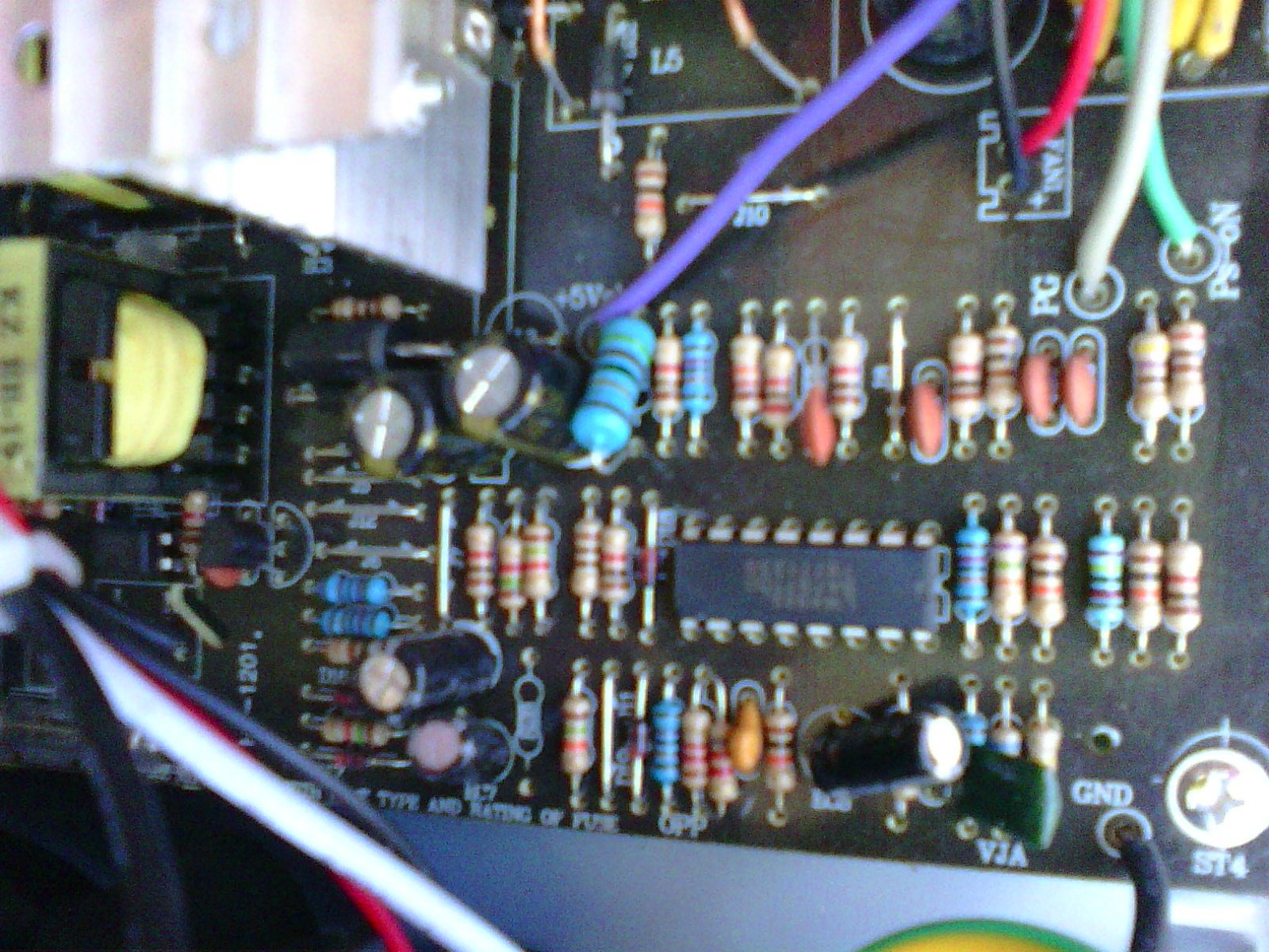

                                    Oh boy, what a shame with this one. It had potential! Almost no input filter, those Y caps actually have safety markings on them though (I'm as surprised as you are!) 4A bridge, 560uF "ZHIFA" input caps, uses TO-247 13009's, and the heatsink is actually very strong. Transformer is okay size, but my main gripe is probably easy to guess...the output filtering! Where is it? one 1000uF cap for 12V, one 2200uF cap for 5V, a 2200uF + 1000uF on the 3.3V, and only two 1000uF caps for the 5VSB. First time I have ever seen a 5VSB filter not have a coil! All the caps for filtering are either ChengX or H.Q. (which does not stand for High Quality ) The 5V is rectified by a 30A schottky, 12V uses a 20A ultra fast, and 3.3V uses a 30A schottky. Looking at the solder side, it looks pretty darn good.
                                    Silly question: If I were to put a 16V cap in that second fan connector slot, would it filter noise since the fans are wired straight to 12v?
                                    • Behemot
                                      • 4845
                                      • CZ
                                      #998
                                      Yeah seems you are right but I would not put bigger cap than a 1000uF one in there, the paths are quite thin and with great capacity you will have quite big amount of power flowing here and there as the cap will charge and discharge.
                                      I would add second ultrafast to the +12 V rail, it has position for two, than it should get better efficiency and some reasonable voltage under heavy load on this rail.

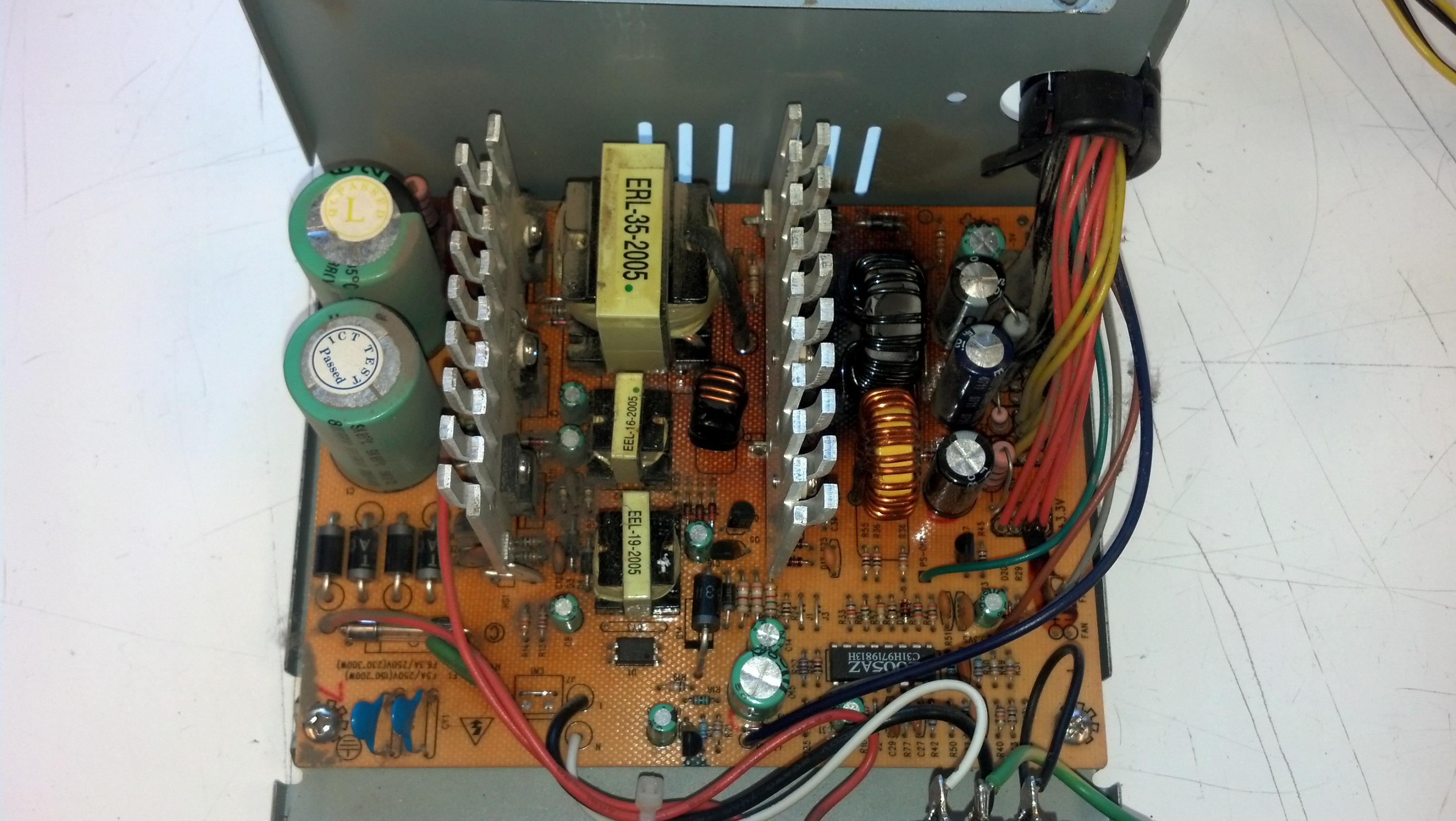

                                        This is a classic LC with the "chip-of-the-year," yeah I know, there are enough LCs here but I feel the need to post it because this one came pre-installed in a NEW computer case (TrueBasix brand) so it SHOULD BE A NEW P/S right? ...maybe a crappy one, but NEW nonetheless, well...Not this time!
                                        It's not just old, it's used, awfully repaired, not even cleaned, corroded, and ALL caps have date codes from 2004.

                                          #1000
                                          This is their 2003 design! How did it end up being sold as a 2012/2013 product?
