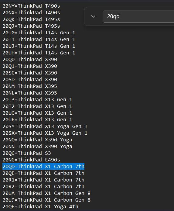

      Originally posted by wangbreeze
      did you update the product brand to thinkpad T**?
      Sure. I have successfully entered the brand name. Just like in the photo.
      But every time I start up, the laptop still reports error 2202.
      I don't know what to do anymore​
      Premium supporters get full download access and other benefits.
      • Maxpower3
        Bad Veteran
        • Feb 2018
        • 1642
        • France
        #403
        not 7th gen just 7th
        Click image for larger version  Name:	Nouveau Image bitmap (2).bmp Views:	0 Size:	1.14 MB ID:	3220764
        otherwise use planar service with your serial
        https://www.badcaps.net/forum/troubl...id#post3220825

            #405
            Thank you so much.
            I have been trying to enter Brand name for 1 week but without success. With your guidance, I succeeded the first time.
            Thank you so much.

              #406
              Originally posted by noktabiz
              Change the ec you use. and write another one and enter your information again
              I followed Maxpower3's instructions and it worked. Follow him, you will also succeed.
              Let's thank Maxpower3.​
