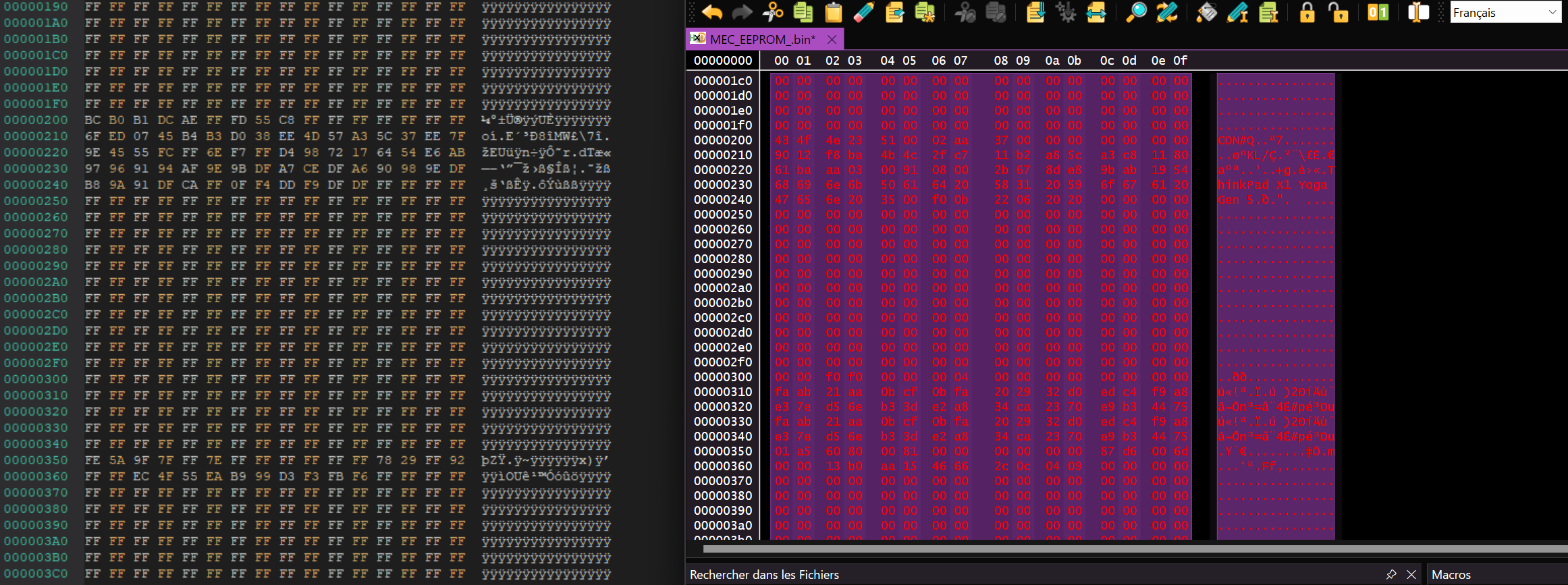

                Hello
                Can someone remove the password from this mec1663 flash and eeprom dump
                X1 Yoga gen 5
                PF-2CG9F9
                20UB-S05E00
                Best regards Chris

                  #428
                  Originally posted by rickjansen01
                  Hello
                  X1 Yoga gen 5
                  PF-2CG9F9
                  20UB-S05E00
                  Best regards Chris
                  try

                    #429
                    Hello Maxpower2
                    thanks it works perfect
                    Best regards chris
