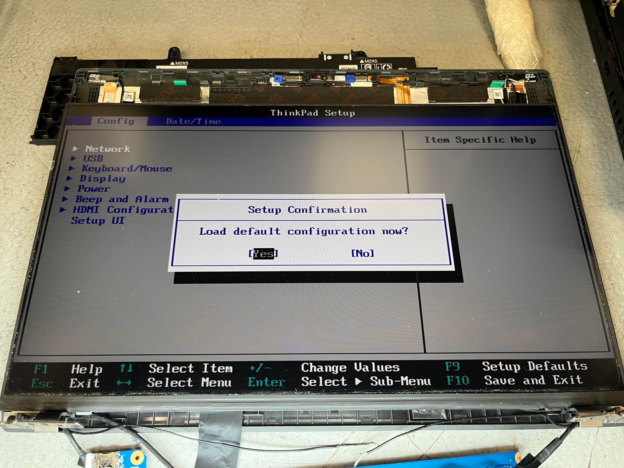

      Originally posted by Maxpower3 View Post
      edit
      after many try
      I managed to enter the bios, but the tabs are missing.
      Click image for larger version  Name:	441499388_881095270699214_2116687842734834106_n.jpg Views:	0 Size:	363.5 KB ID:	3279733 Click image for larger version  Name:	441409609_1406188906766540_432083223838718957_n.jpg Views:	0 Size:	336.0 KB ID:	3279734
      by the way, when I go through, with the 2 tabs, I have access to F9
      it loads well by default but the password is not cleaned.
      But I still have some access so I have to try to use the maintenance utility to initialize EC for testing.

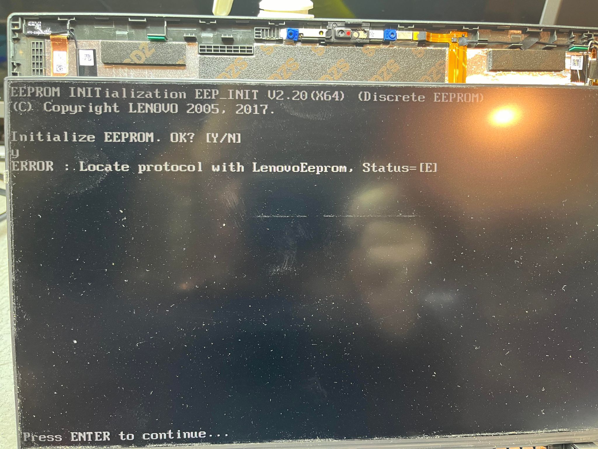

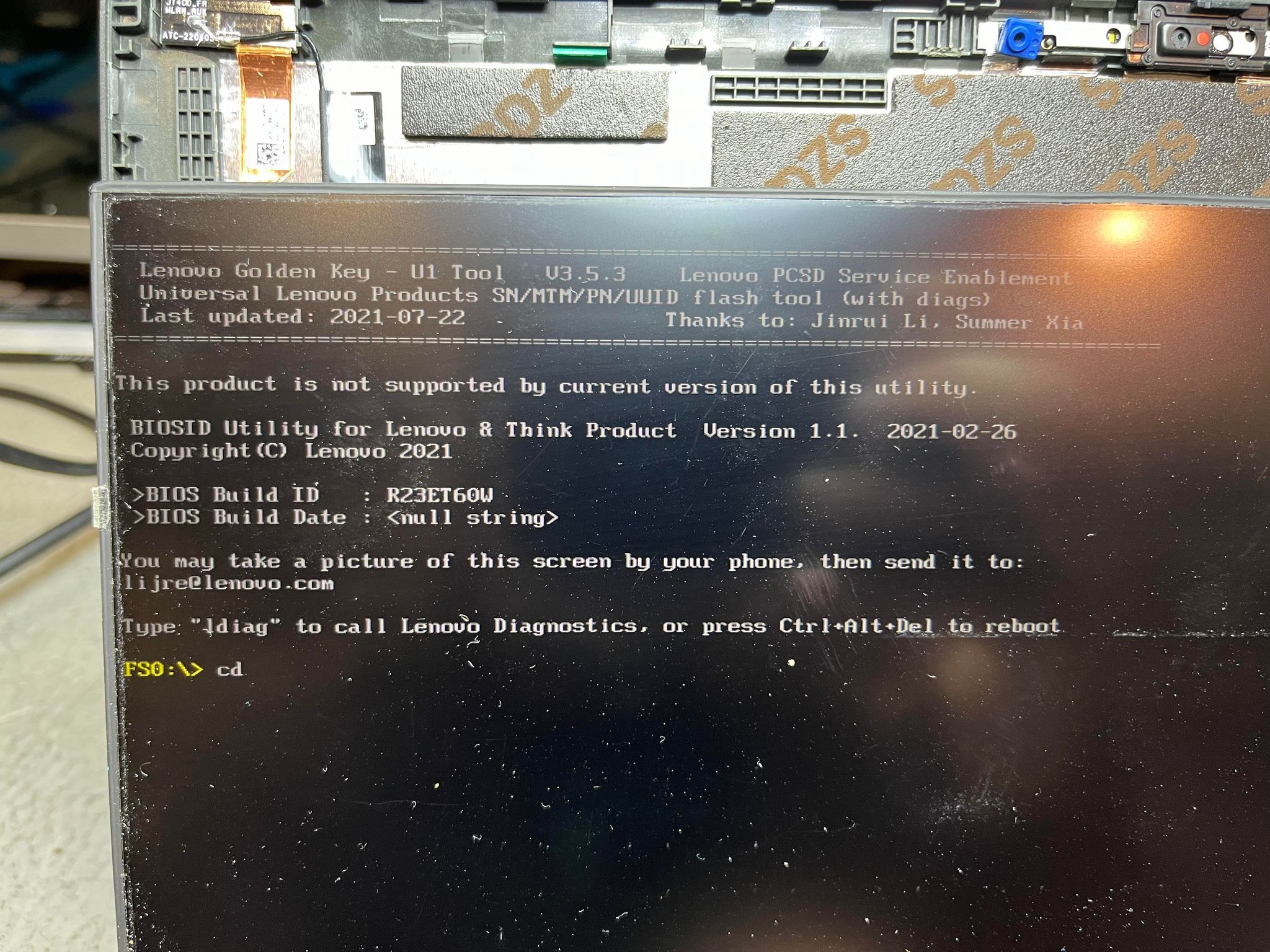

ID:	3280024 Click image for larger version
                what is the latest version of the utility ??

                    Latest is 3.5.64

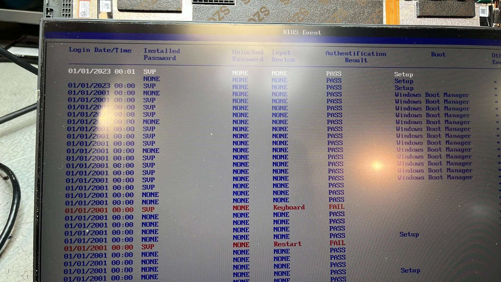

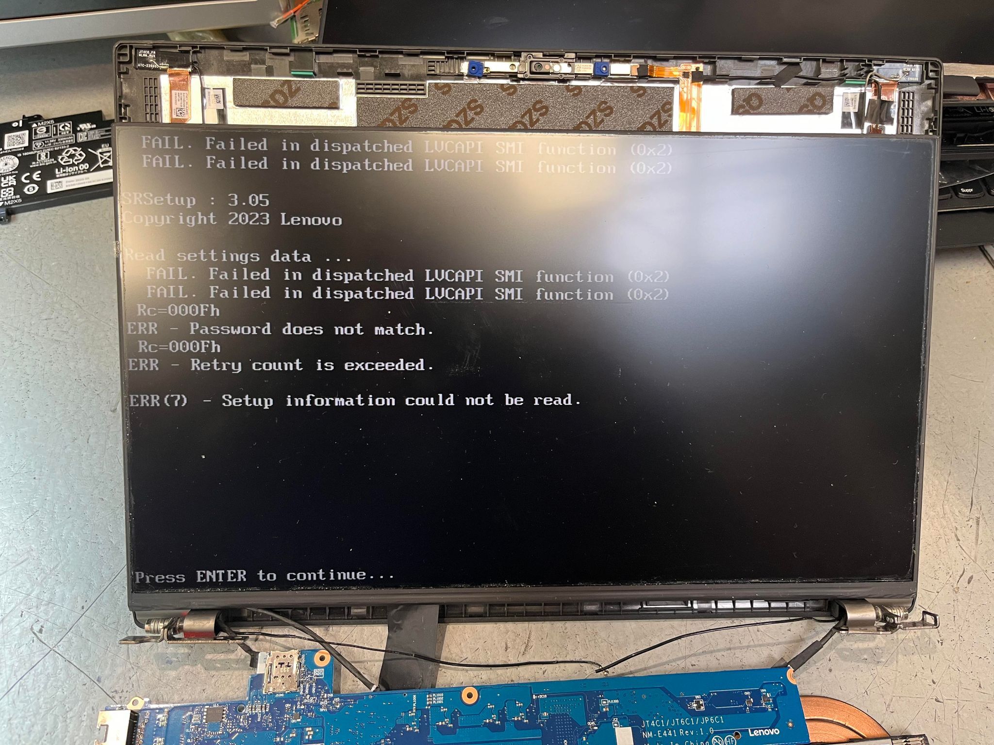

                        So you managed to remove the password?
                          no but I notice that the password is bypassed,
                          I can boot via F12 without password.
                          but there is a protocol error (LenovoEeprom)​
                            Try the latest U1 tool. Hope you can initialize the EC.
                              not worked

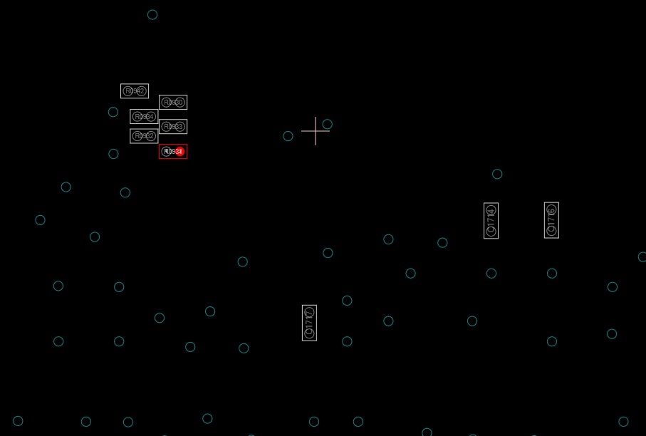

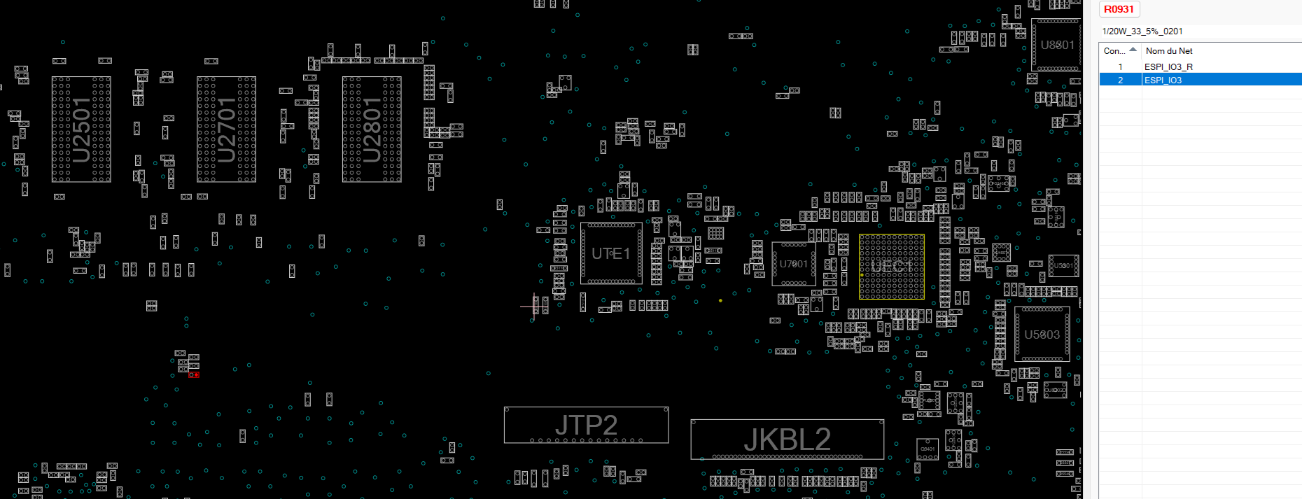

                                    NM-C651
                                    NPCX897KA0BX
                                    try
                                    Do you have tips on how to try this out?
                                    I'm stuck on needing the internal display connected, but its cable cannot reach while I'm trying to access the bottom side of the board. I'm thinking I need to remove the panel from its casing but haven't done so yet.
                                    I've also had the charger port outside of its metal holder so I would be able to access the bottom side of the board that contains JDBUG1 while charging.
                                      Solder to the point then touch that to ground might be eaiser for you maybe

                                          Originally posted by claudi View Post
                                          Does not work
                                          not unlock this model with this method
