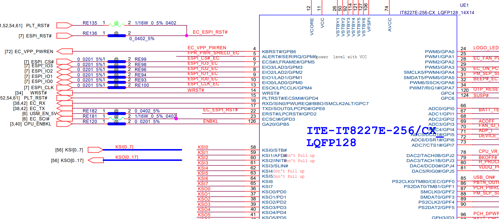

      GE4B0/GE5B0 NM-D011 board number

          7/8/9/10
          which pin?
          i try 7 8 10 but not clear
          lenovo IT8227E

              it is necessary to make a shunt for a short time on a pin of the EC. have you seen the videos to understand
                i know. but this model is not clear pwd

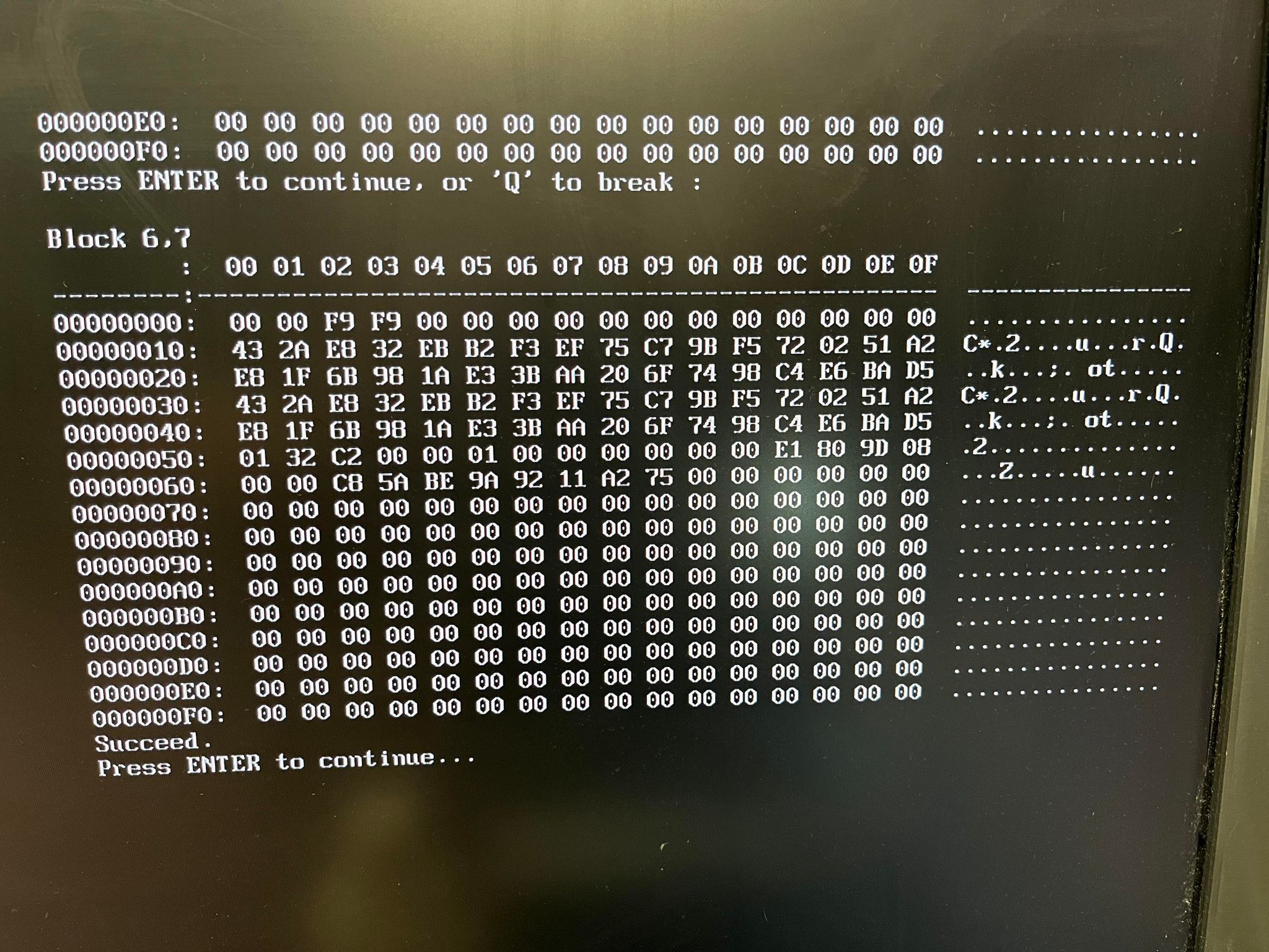

                          you mix the bios
                          it's not the same pc? original 2 and 4 .
                          normal late display if the file does not correspond to the original PC.
                          If no password forever starts on the other machine, clean the password and the security chip and put back your original
                          check with lenovo utility
                          dump eeprom block 6/7 if password is removed

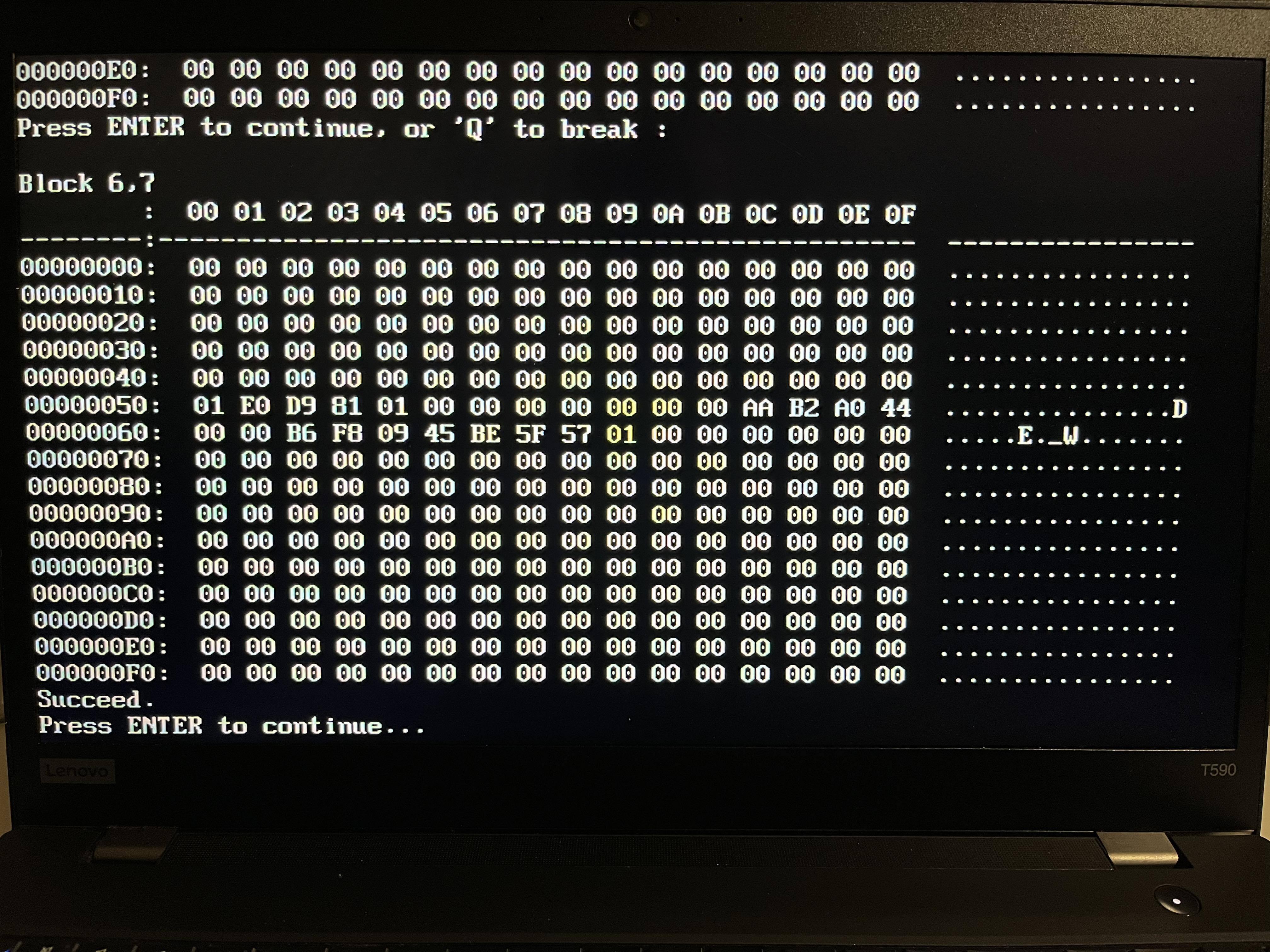

                          Click image for larger version  Name:	363863670_256985520526544_7408429739298972171_n.jpg Views:	0 Size:	562.3 KB ID:	3313555 Click image for larger version  Name:	406670622_284067567554636_3243226384332222195_n.jpg Views:	0 Size:	1.27 MB ID:	3313557
                          if it starts with another file, it confirms the bad reading
                            Of course I understand that. I'm doing oryginal4 right now. Downloading W25Q128BV@WSON8_20240721_123730 oryginal4_PATCHED. Now I will show the photo, because nothing works.
                            • svadikn
                              PC-expert
                              • Jul 2024
                              • 15
                              • Poland
                              #274
                              Everything worked out for me!😁 Thank you very much, you are a great professional.👍
