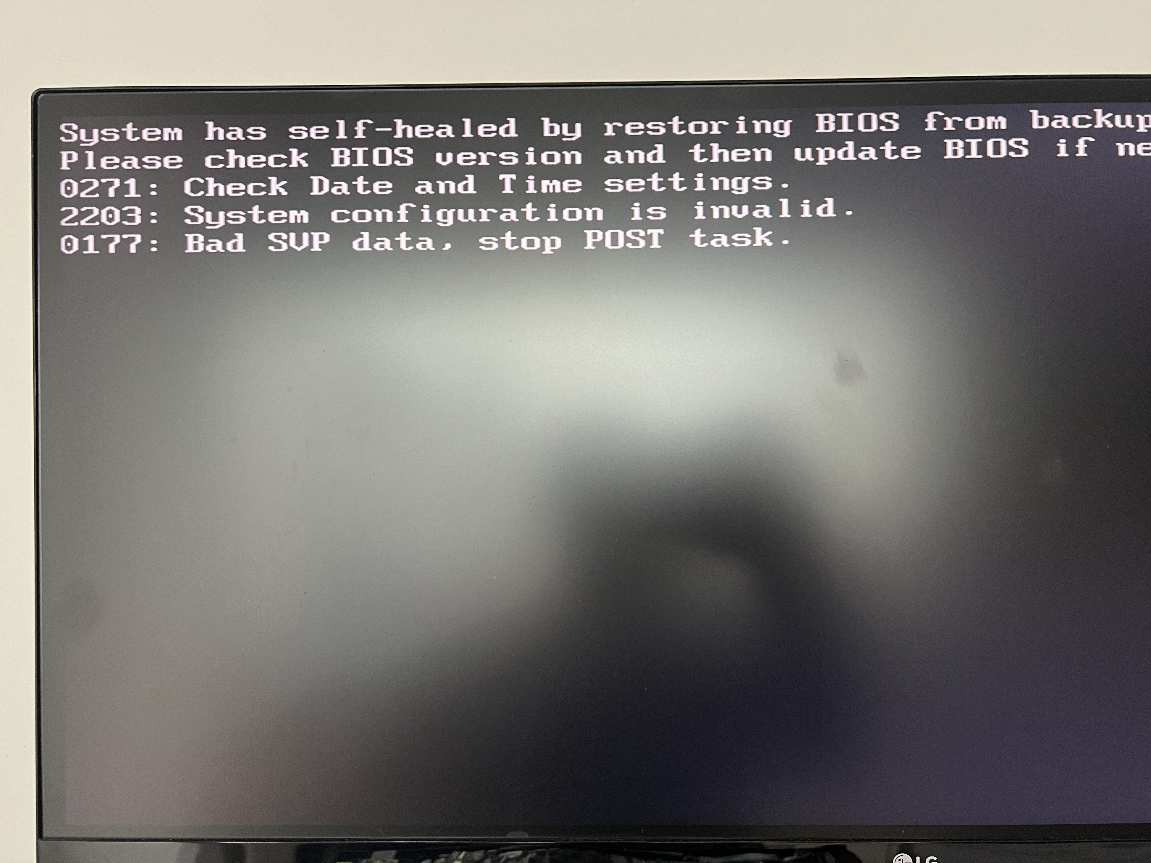

      I tried to do the procedure according to the video and descriptions, now the machine shows all the errors and "BAD SVP Data" and then hang up, how to proceed in this case?
      T14 gen1
      Click image for larger version  Name:	image_picker_E6B82653-3F10-4D5C-9A0E-300C5CFC33A5-1912-00000041BA564003.jpg Views:	0 Size:	2.91 MB ID:	3284714

        #183
        T14 gen1
        You have to still try, read the thread again, try different timings (always after the motherboard led shows you the full boot). It takes something like 30/40 times for me to enter the bios setup correctly.

          #184
          but did you lose the SVP data as I showed in the screenshot above?

            #185
            Yes, you have to still try.
            Like max told before :"start just before the logo and change your timing (more or less long)"

              #186
              I managed to solve it after using the Lenovo maintenance utility to restore, as it did not show the bios submenus and its information, only the clock, I believe it is because the bios is in the latest current version v1.31.

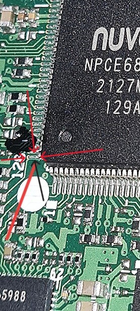

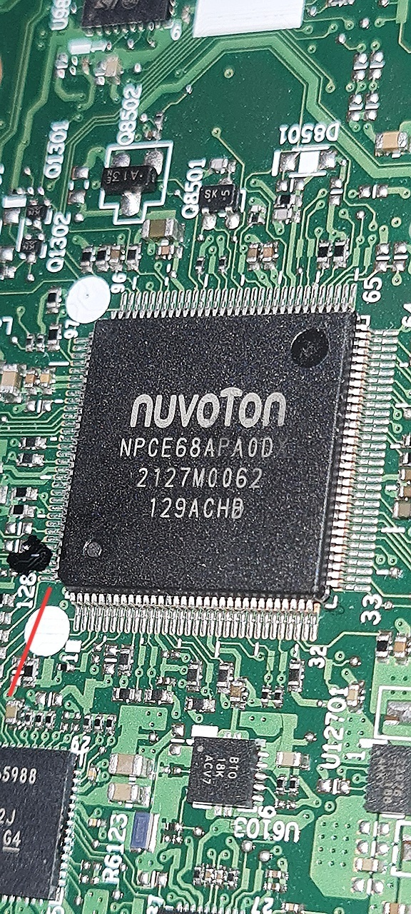

                Dear brother, can you please provide a clear picture of the injection site? Thank you very much

                  #188
                  No, it is an hardware bypass that corrupt a part of the memory. You have to still try.

                    #189
                    Can you mark the location of the touch in the photo, please?

                        #191
                        I think the model is different, my friend

                          #192
                          its work khoya . already tested

                            #193
                            momkin sora wadiha khoya barek laho fik PIN 128

                                #195
                                Originally posted by spacez
                                d
                                WORKING 100/100 BARAKA LAH FIK

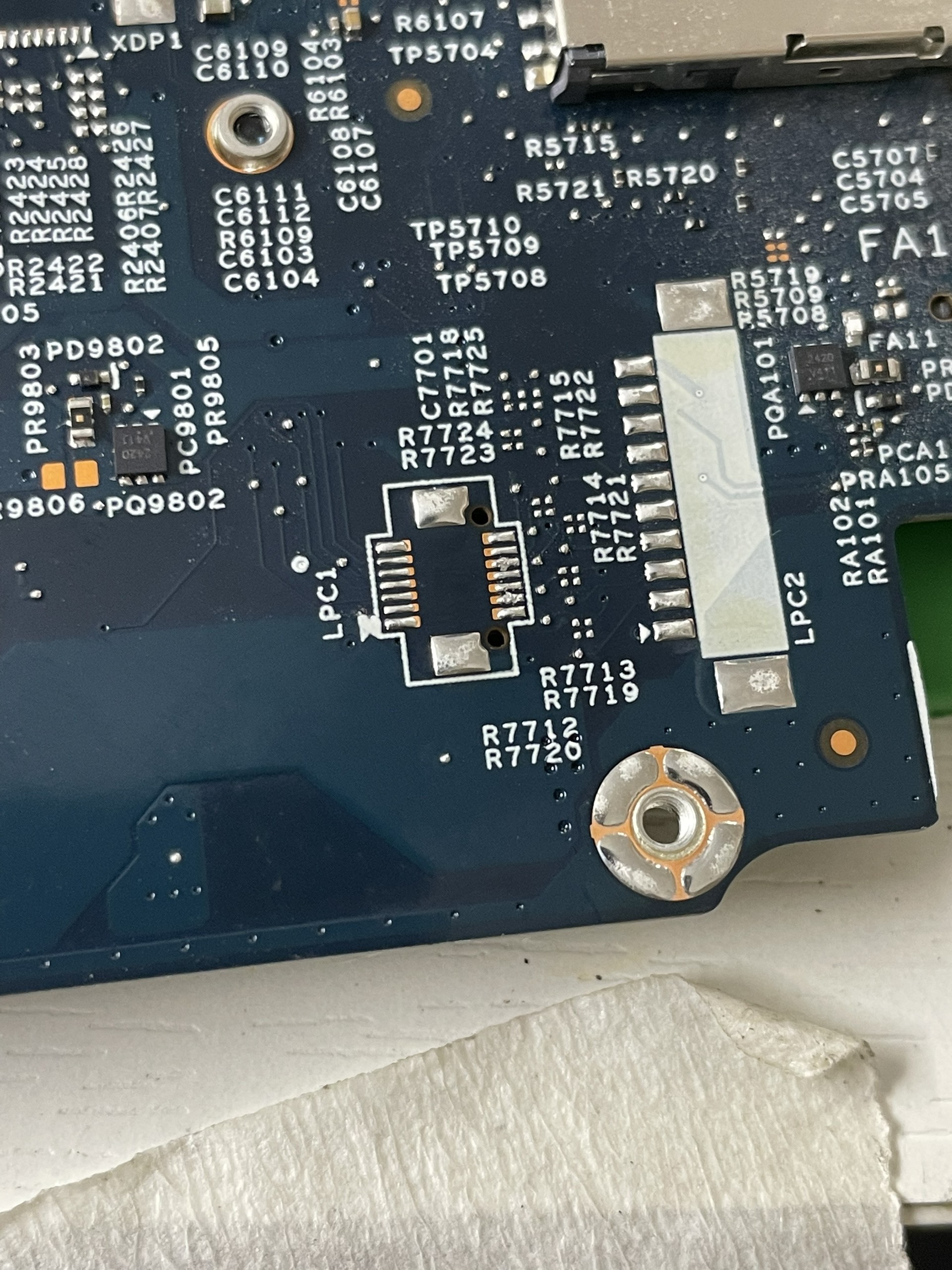

                                  • black0hackers
                                    • Jul 2020
                                    • 367
                                    #197
                                    P1 g2
                                    LPM-2 MB 18809-2 448 0GU06 0021
                                    WITH NPCX897KA0BX
                                    i try with pin 2 and 10 but not done.have other LPC2 but no have boarview

                                      #198
                                      black0hackers , read accurate 1_st post of Maxpower3
                                      = (Be careful, resistors may be missing on the path) =
                                      And use schematics and boardview -> https://www.badcaps.net/forum/troubl...09#post3287414

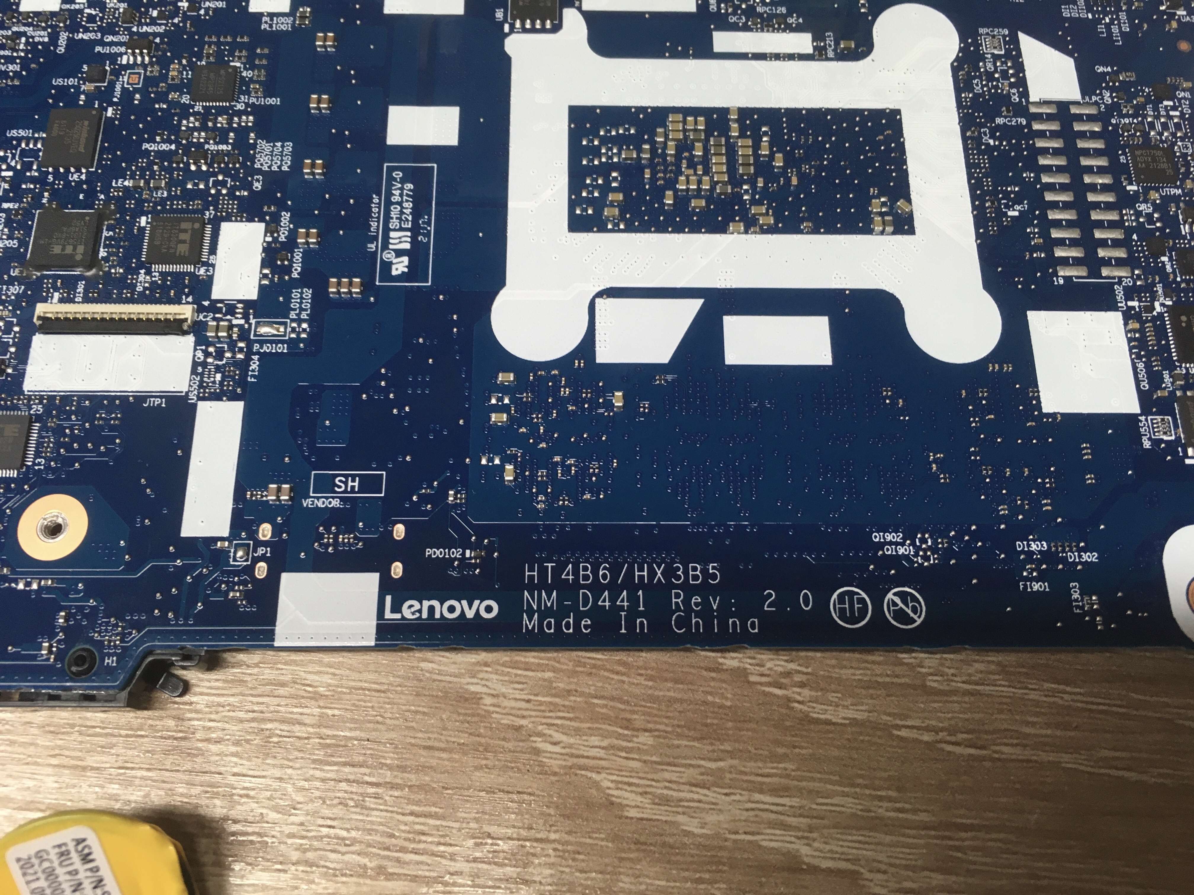

                                        #199
                                        Lenovo T14s Gen 2 (type 20XF, 20XG) Laptop (ThinkPad) - Type 20XF AMD
                                        Typ Number: 20XF-006JGE
                                        Serial Number: PC2AEHZD
                                        Board Number: HT4B6/HX3B5 NM-D441 Rev: 2.0
                                        Hello, someone has already unlocked it.
                                        I can't even find a schematic for NM-D441.
                                        Someone has already done a lot of it.
                                        Thank you.
