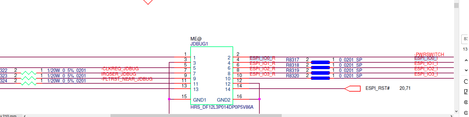

    Mec16
    look for j9301 if you have it
    https://www.badcaps.net/forum/troubl...61#post3250061
    yes i have j9301 i will try thank You

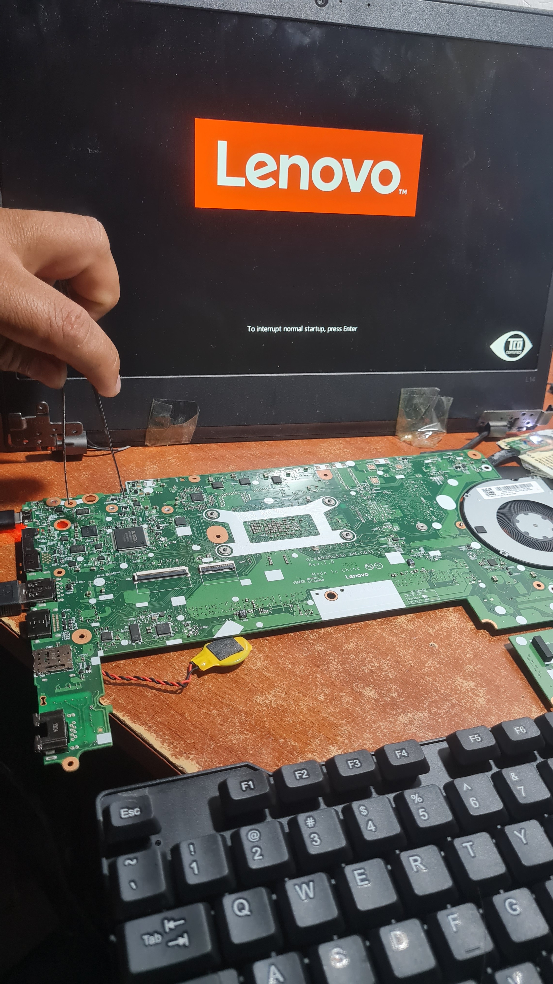

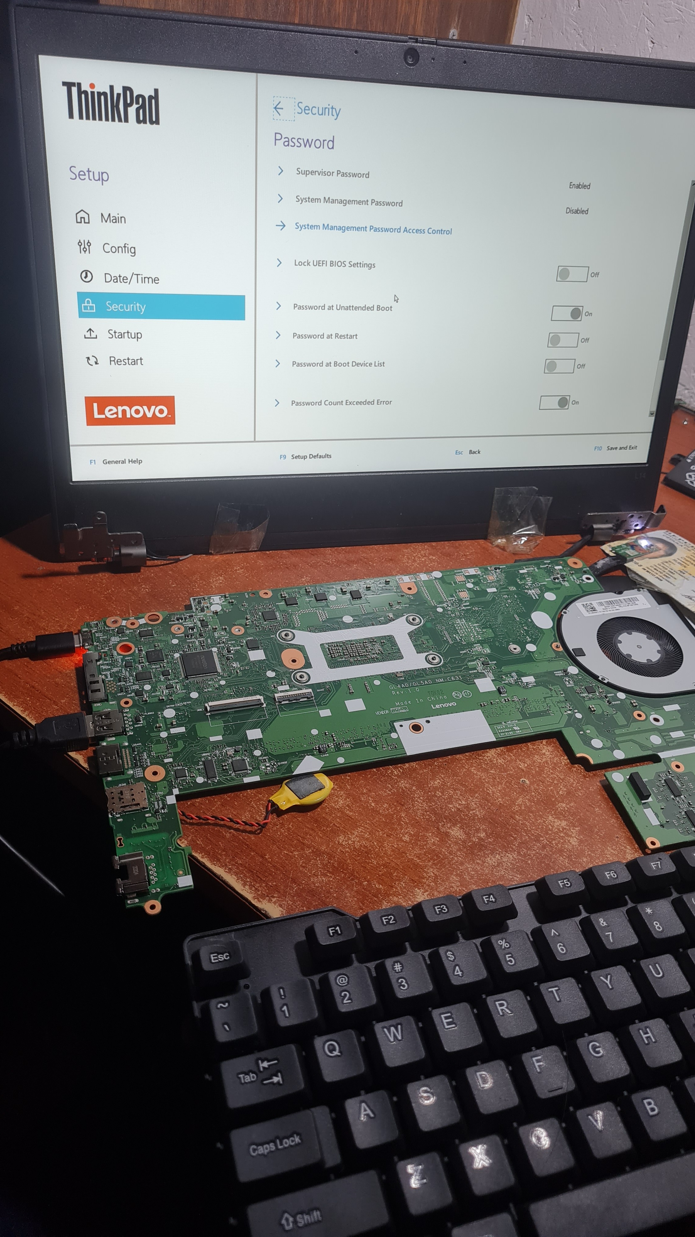

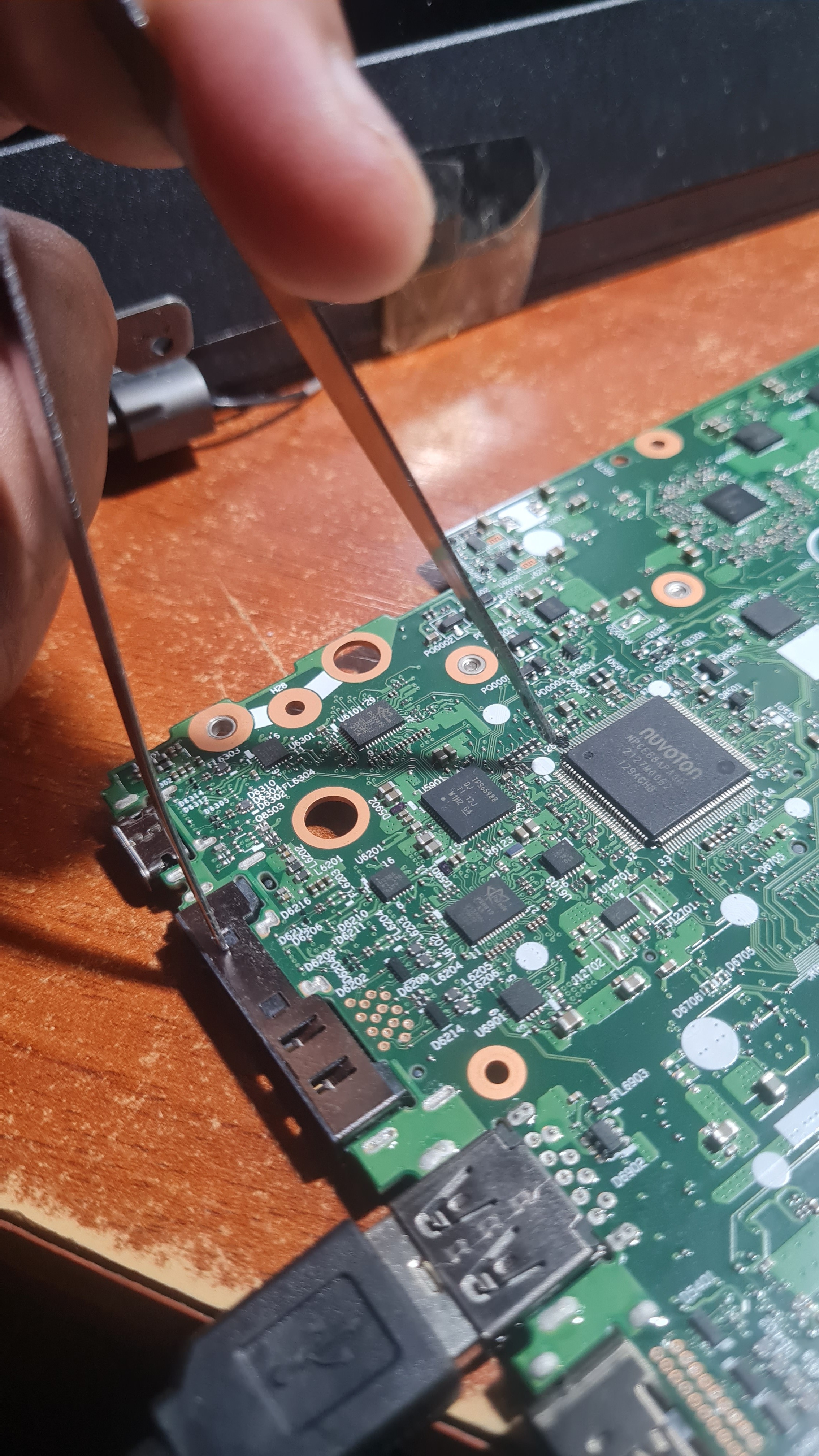

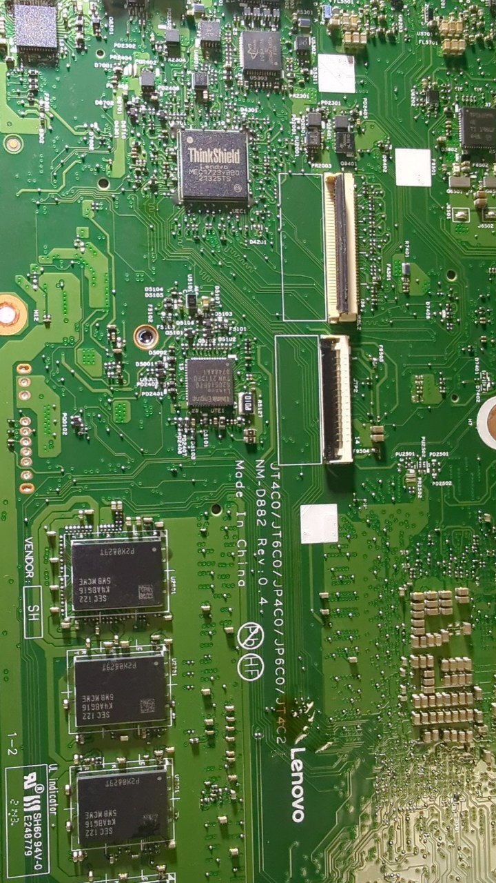

                  good night master chief Today I tried again...
                  I bought some metal tweezers and a Windows keyboard
                  I don't know what I'm doing wrong or what I'm not doing.
                  If you could leave me a message so I can follow the procedure to the letter, I would greatly appreciate it.
                  (I leave images)

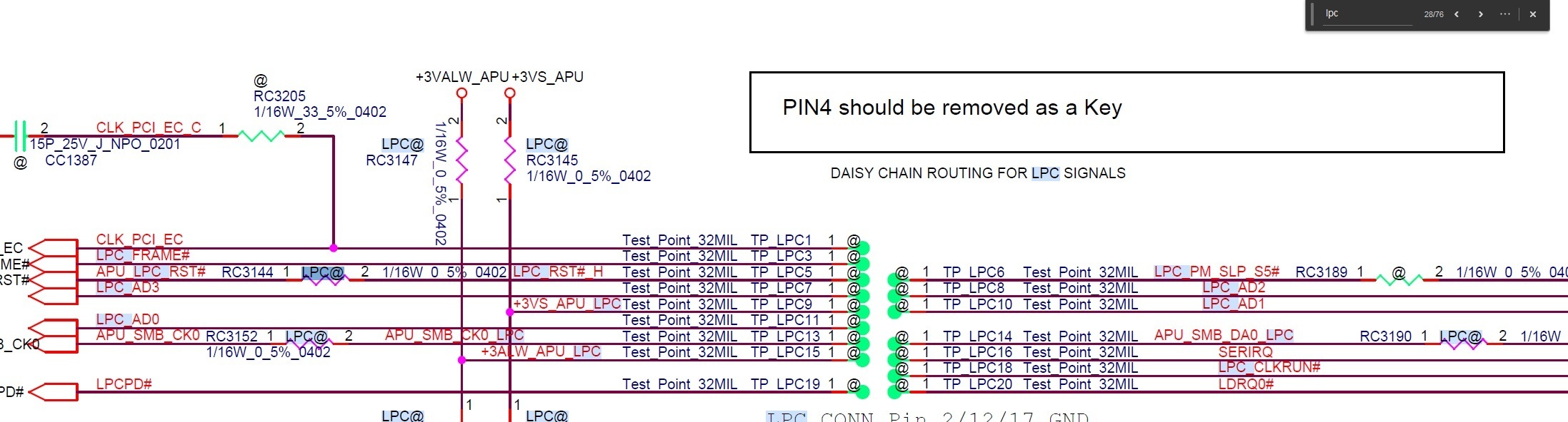

                    NPCE68BPA0DX Lad Pin 126-127-128 or 1 of EC
                    Not working for me
                        (I leave images)
                        In old Lenovo it was required to qround security chip just before pressing F1 or even during pressing F1, to brick communicTion, so bios don't read password from it.
                        Maybe try that way.
                        I also wonder if it is not necessary to ground all 126 127,128 and 1 pin at the same time to ground.
                        Also some hint here for older Lenovo:
                        https://davidzou.com/articles/bios-password-bypass

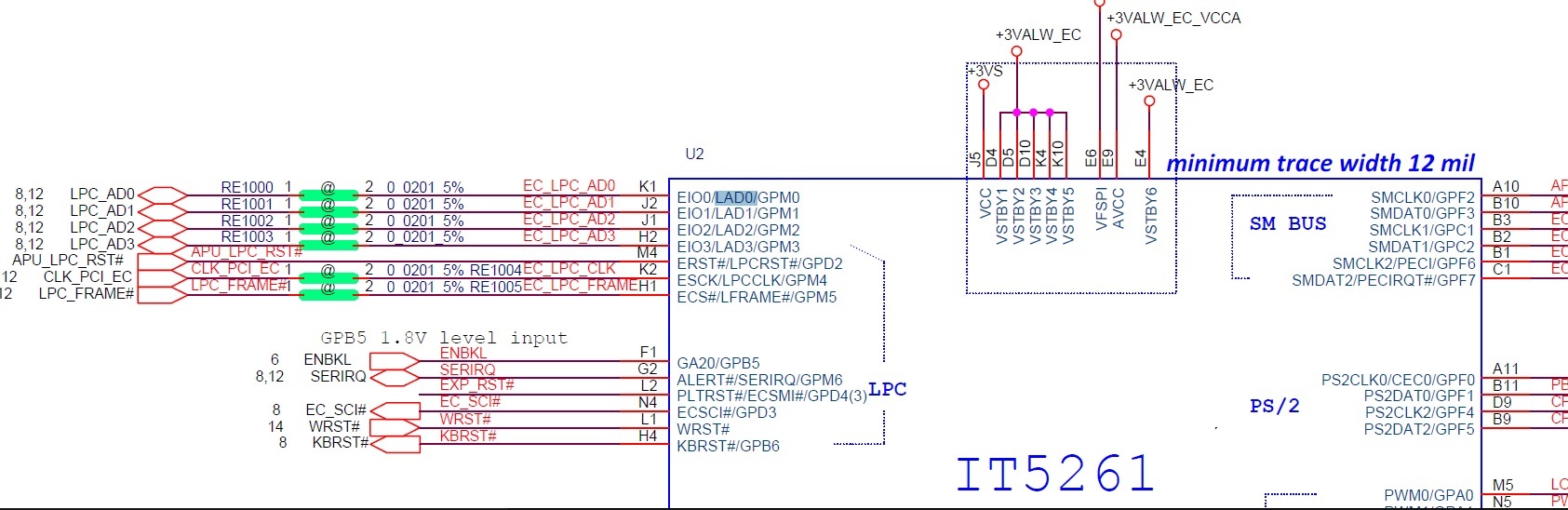

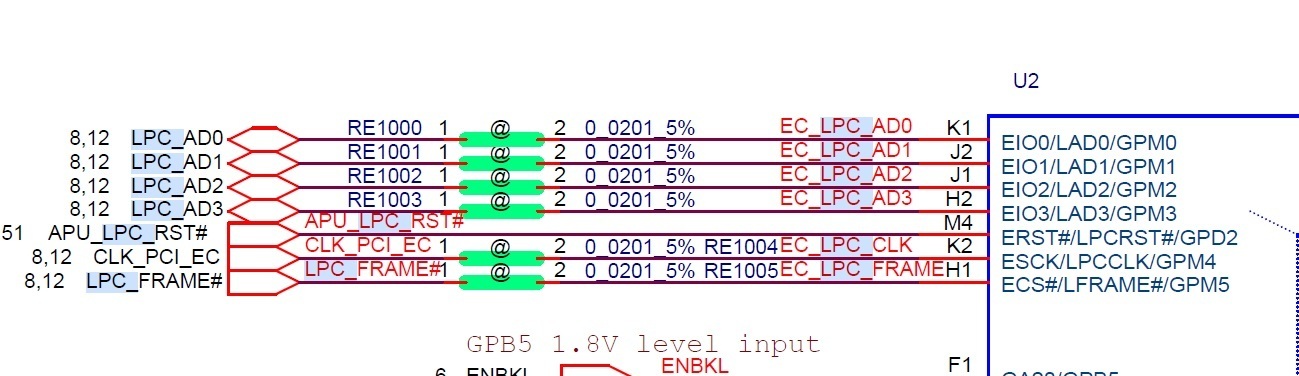

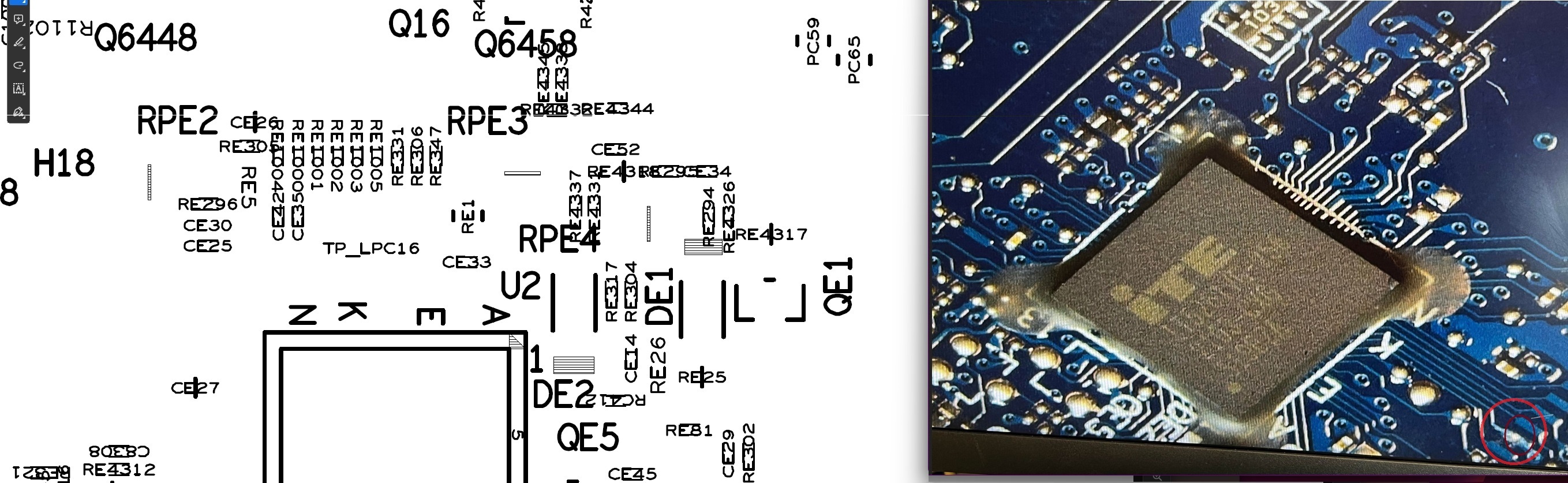

                              Hi Maxpower3, please help me with T14 gen 1 AMD GT4A1 NM-C801 rev.1.0, can't find boardview and don't know where to connect switch to motherboard. Thank you!
                              • Maxpower3
                                Bad Veteran
                                • Feb 2018
                                • 1312
                                • France
                                #95
                                NM-C801 IT5261VG

                                  Thinkpad x13/T14s Gen 1 AMD GT4A5/GX3A5 NM-C791
                                  IT5261VG

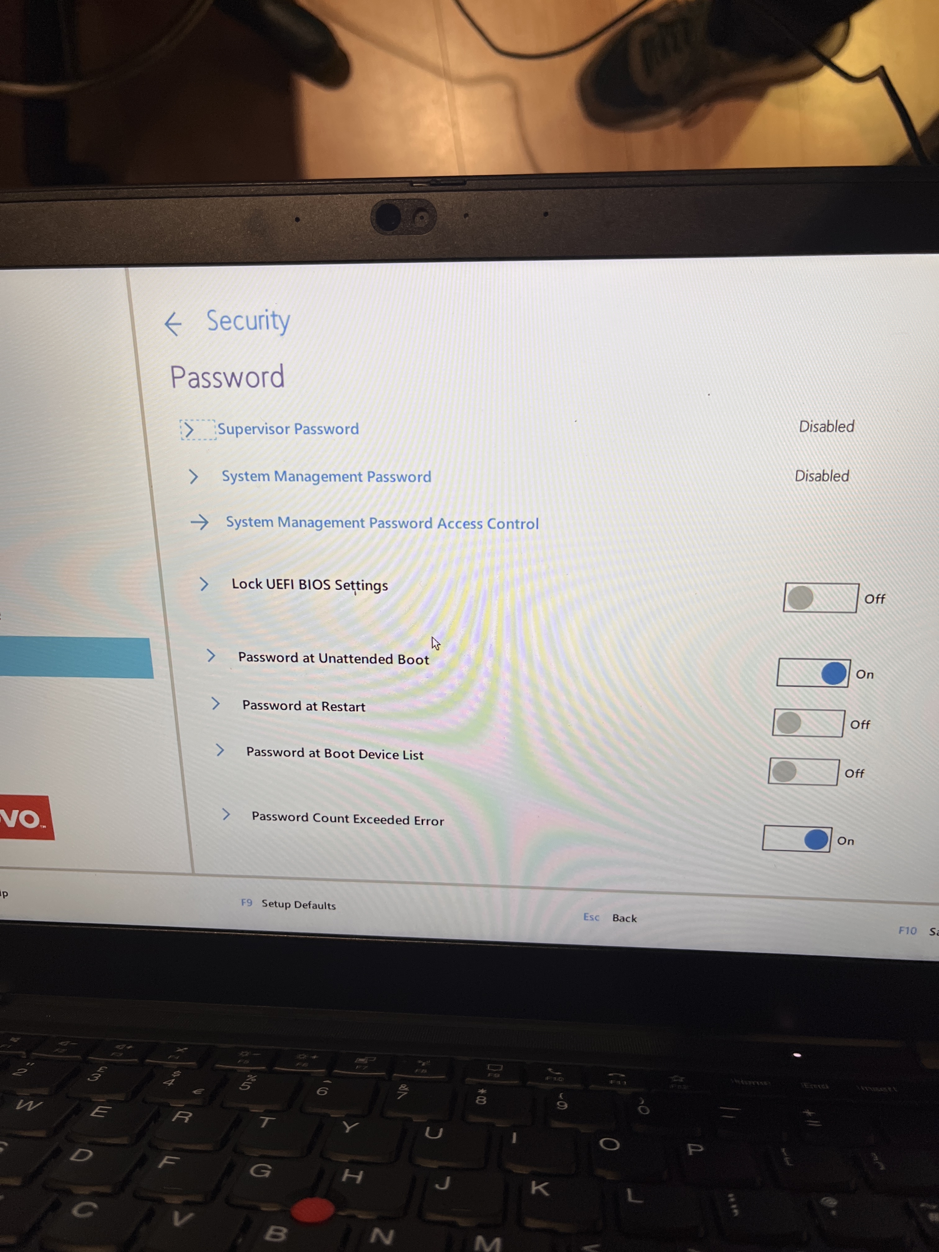

                                          This happens to me too,
                                          change the timing and start earlier just before backlight and stays short for less time.
                                          Mec16 is difficult
                                          many many tries
                                          I've a T14 NM-C931 rev1. after many tries with no lucky it now show me before the logo also if not shorted:
                                          0271 Check date and time
                                          0188 RFID serialization inform area (or something like that)
                                          2200 machine type and serial number are invalid
                                          ( before start to try i disconnected the big battery and also the button one and the check date and time error started for this)
                                          Is this normal so i should still try?
                                          In a post before i read to not short before the backlight, is still valid or with mec 1663 no?
                                          Thanks in advance for any advice​
