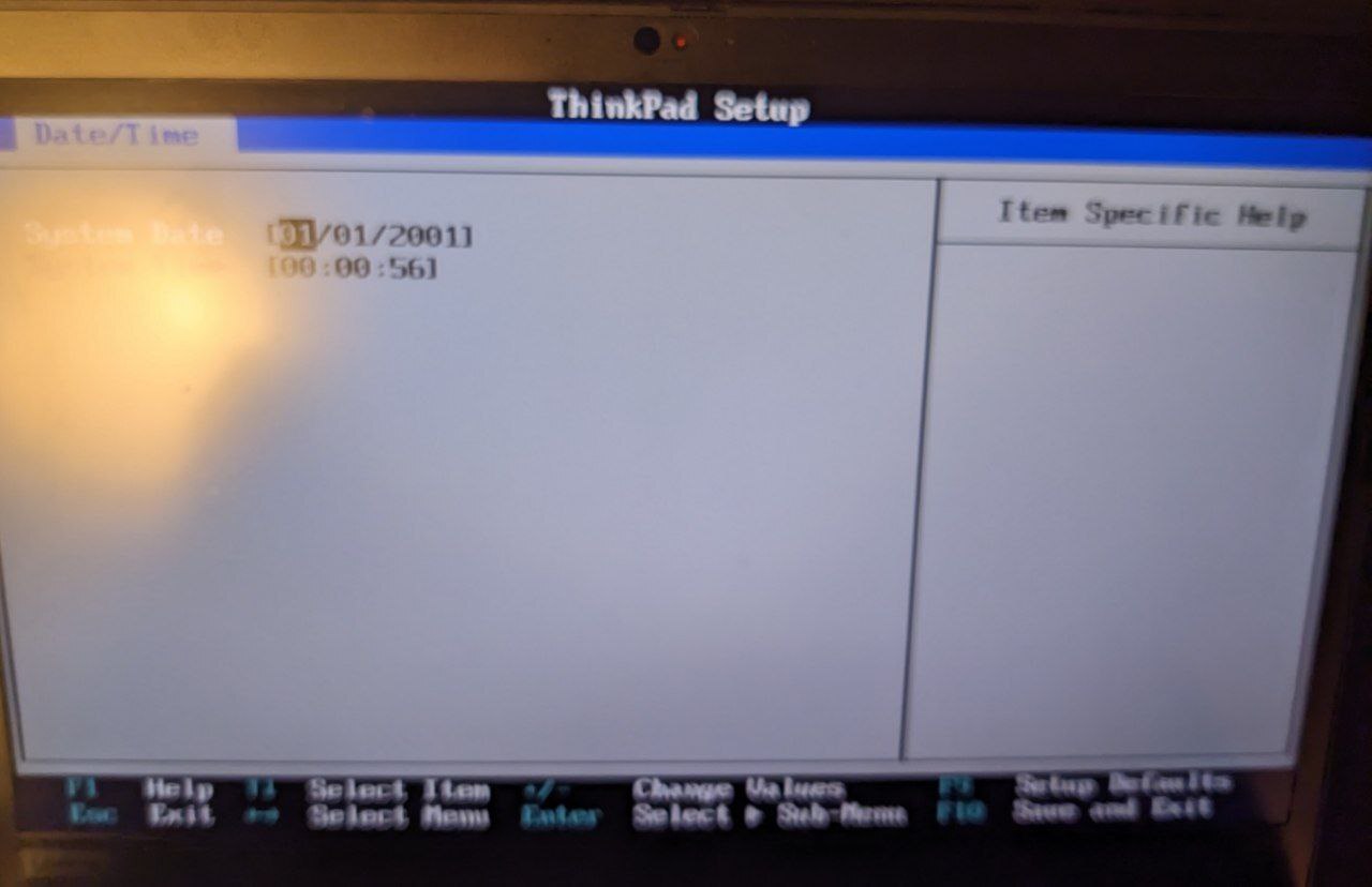

      if you get errors, you are on the right track,
      0188 RFID serialization inform area (or something like that)
      2200 machine type and serial number are invalid
      you have to keep trying.
      start just before the logo and change your timing (more or less long)
      After many attempts I was able to enter the bios setup in which only one DATE/TIME entry appeared.
      I set the correct time and kept trying but just went back to the same bios menu.
      (I am using an external keyboard without disconnecting anything from the motherboard) (only the speaker for the annoying beep)

        #103
        you're almost there, the safety tabs are missing, you have to keep trying. maybe stay less long

            #105
            It worked, thank you
            Now i have only to set serial number and model with the lenovo U1 tool

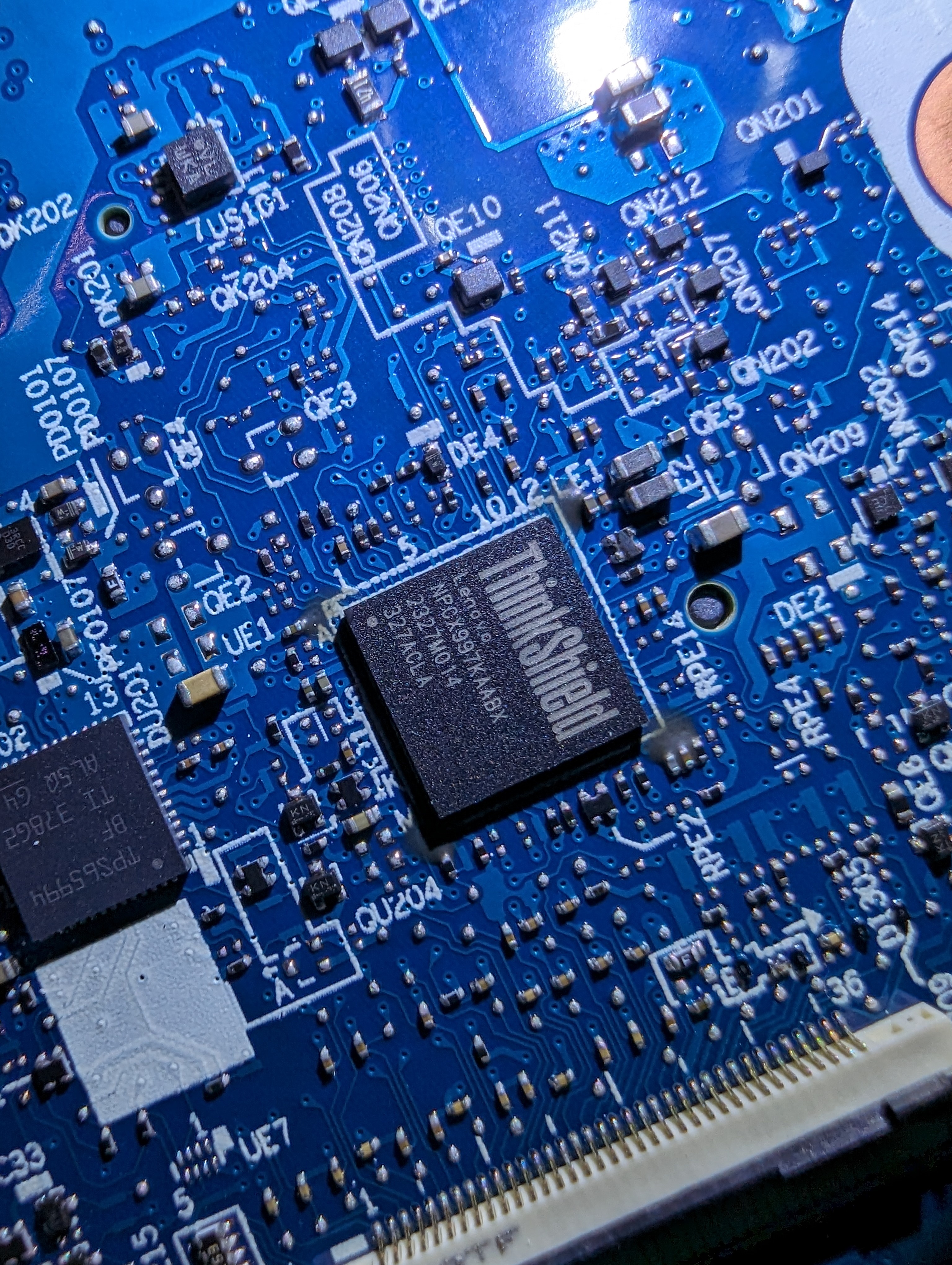

              #106
              NPCE68BPA0DX Lad Pin 126-127-128 or 1 of EC
              I try all process but not success Please You guide me step by step

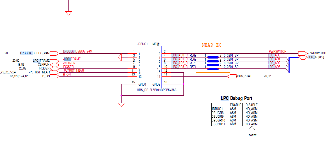

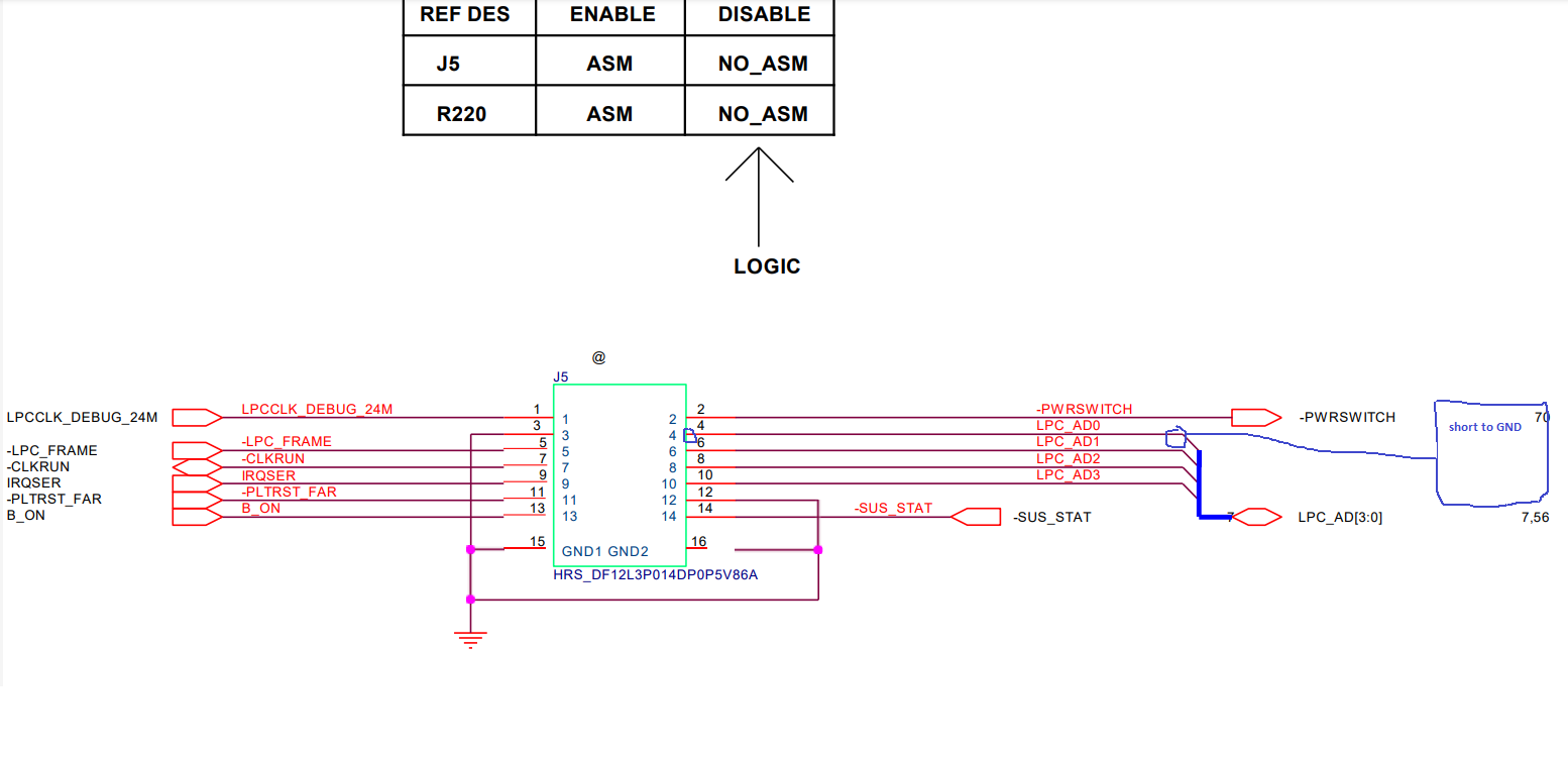

                  Hi, i try on X1 carbon G7
                  NM-C661
                  I short pin LPC_AD0 to GND but not done
                  do i wrong pin?
                  • danito
                    • Jun 2016
                    • 1259
                    • Romania
                    #109
                    NM-C661
                    do i wrong pin?
                    gnd with usb and pin 10?

                      #110
                      pin 4/6/8 or 10 it's good normally

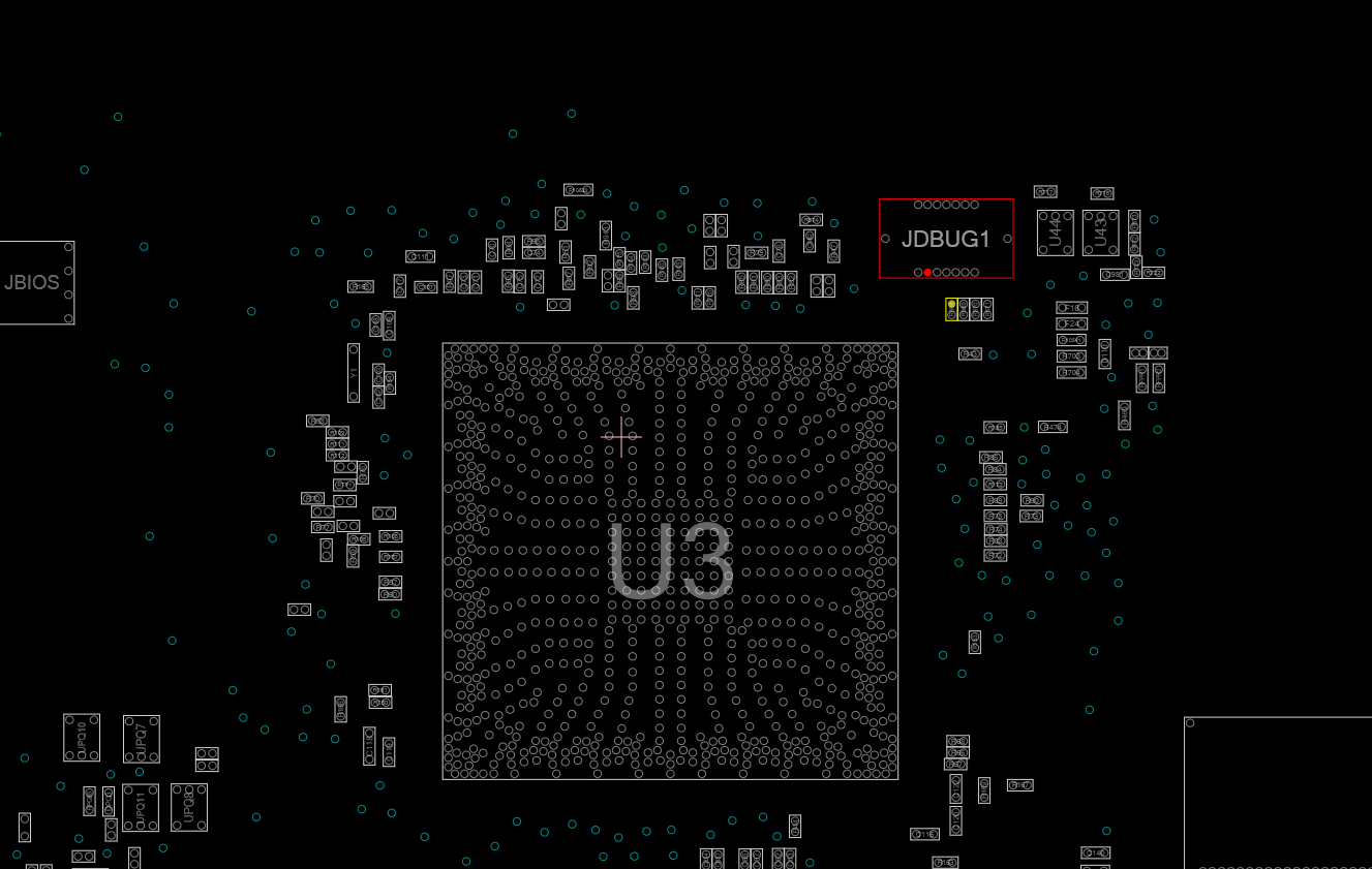

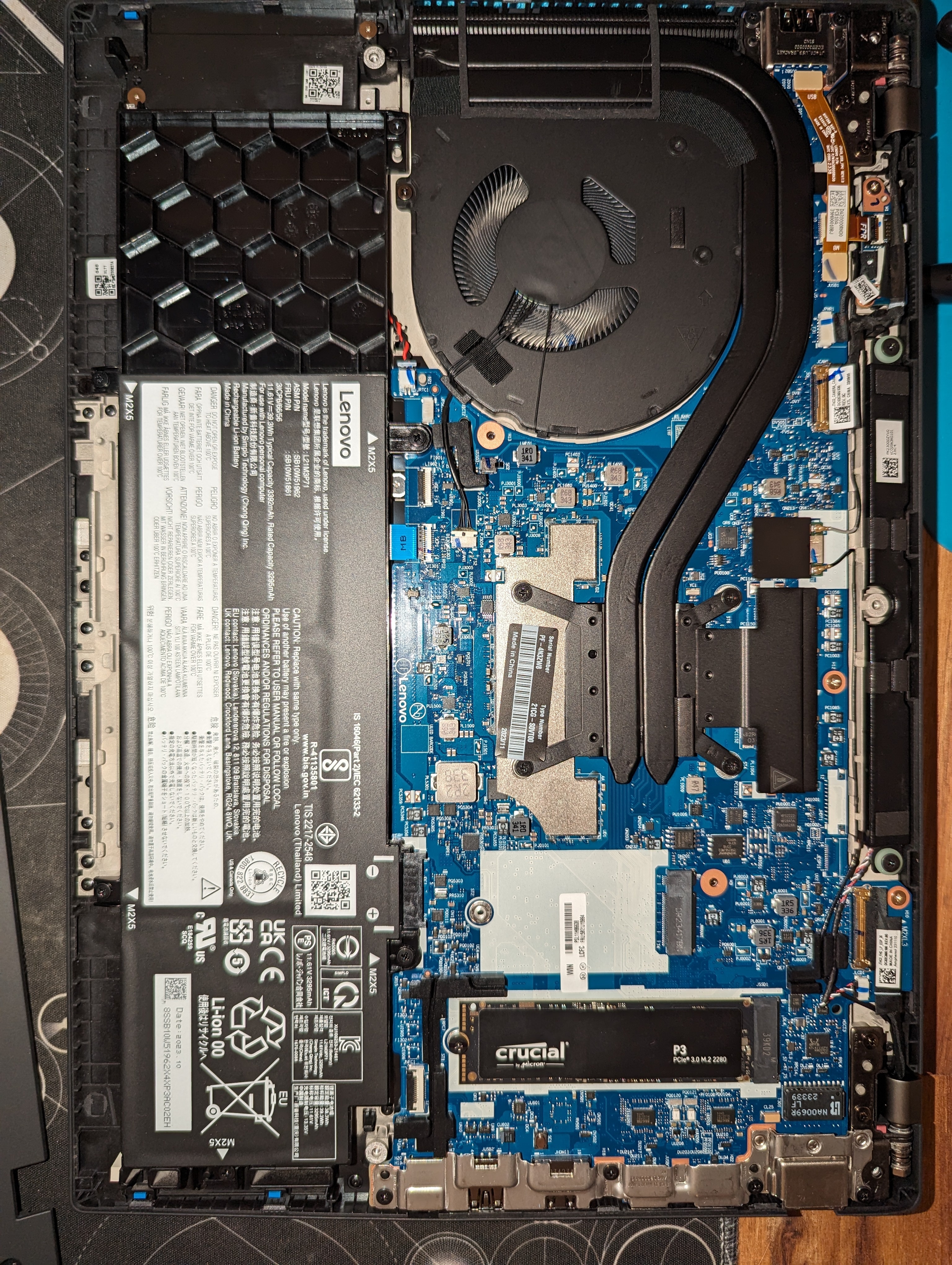

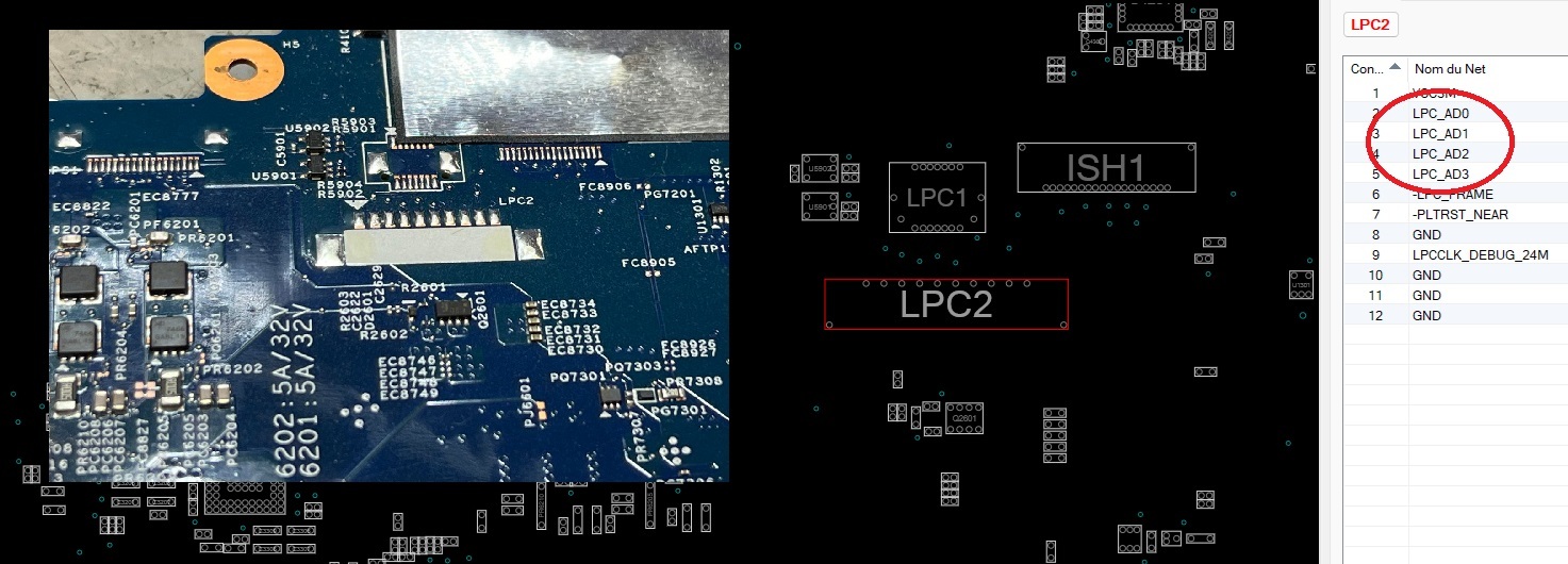

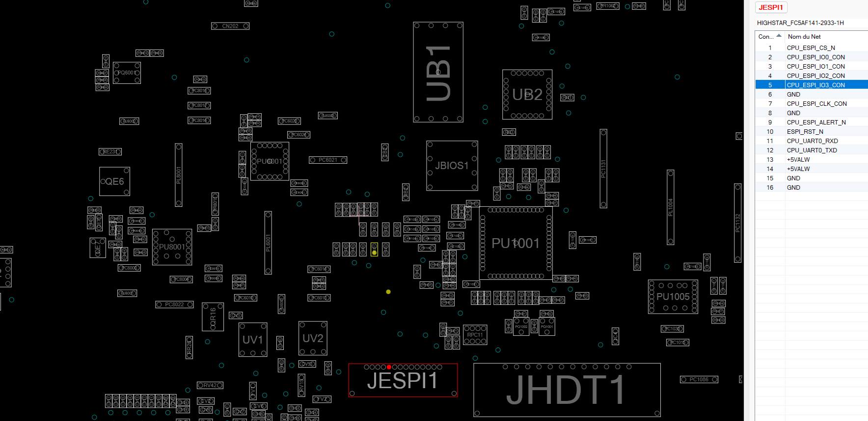

                          #112
                          Hi everyone, I'm having a hard time with understanding what I must short on my particular model (T14 gen 3 AMD). I have a NM-E441 rev1.0 board with NPCX997. I attached the schematics for the board and also photos of it.
                          I'll be deeply thankful if someone can give me advice.
                          Schematics and boardview : https://www.badcaps.net/forum/troubl...nm-e441-rev1-0
                          (Edit : added link to the schematics and boardview)

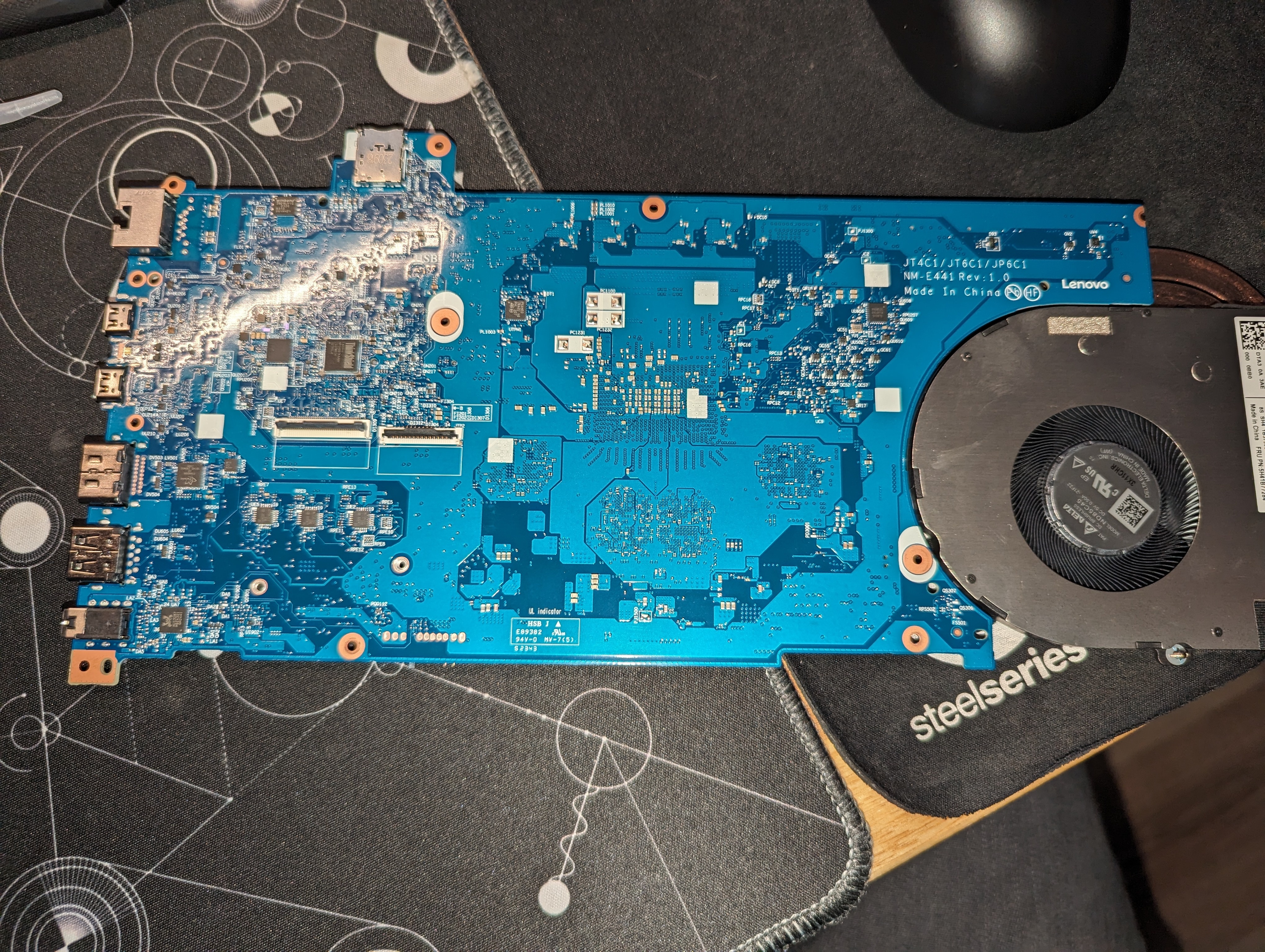

                            #113
                            Hi guys, P15 Gen2 NM-D491 Rev2.0
                            MxP, I saw you fixed this same NM-D491 in december with a burnt cap on a P17, may be you know how to ground it ?
                            Thank you for your help and for sharing your work !

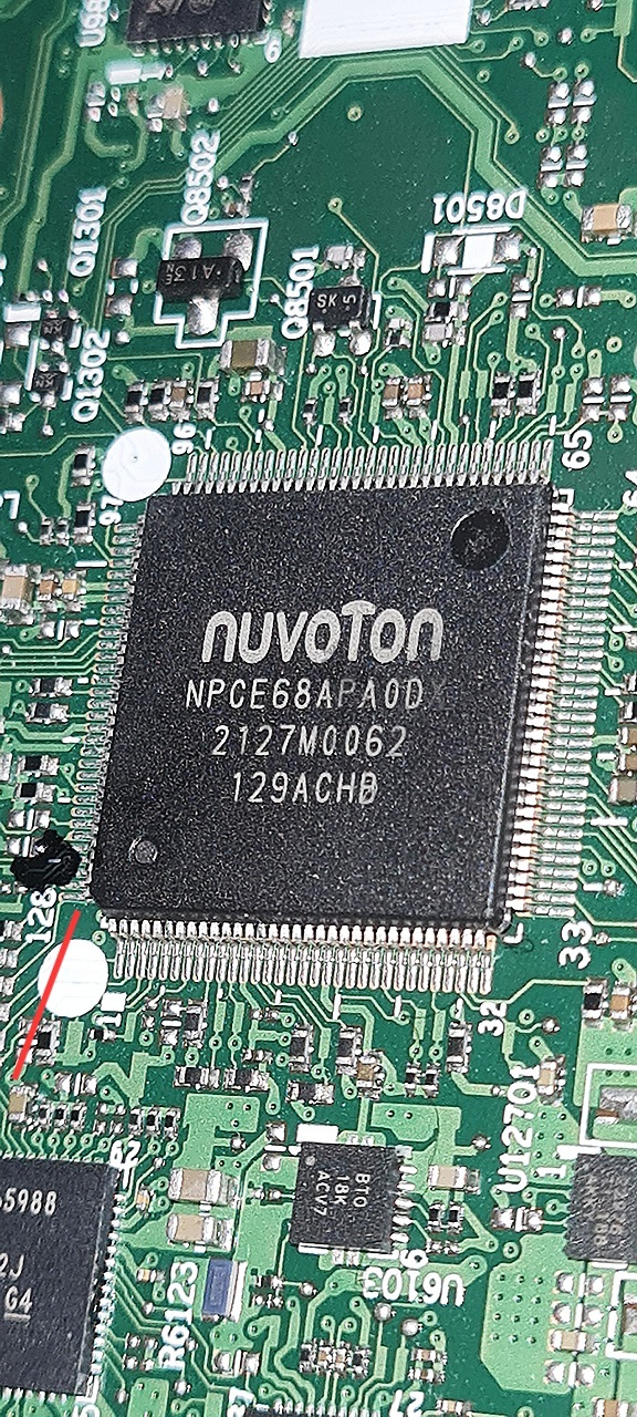

                                hello! master chief.. Good night..
                                I tried again watching the video the "enter password" sign appears then it is deleted (I imagined I pressed ENTER) then the red sign appears (LENOVO) and press F1 to enter bios... and then the PASSWORD logo appears (but this is deleted again)....
                                Then the red "Lenovo" sign comes back (that's where it hits) but it sticks to me... what am I doing wrong? because I don't know anymore and I've done it many times...
                                My chip might have something to do with it
                                NUVOTON
                                NPCE68APA0DX
                                2127M0062
                                129ACHB

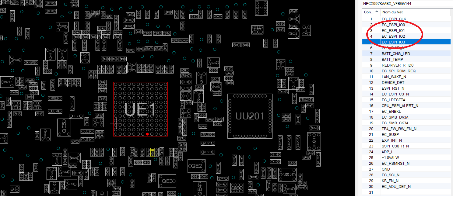

                                  Originally posted by imranromi
                                  Send board code will share you point i believe can unlock P53.
                                  nm-c262 share pinouts
                                  • Maxpower3
                                    Bad Veteran
                                    • Feb 2018
                                    • 1358
                                    • France
                                    #117
                                    Lenovo Thinkpad P53, P73 NM-C262 NPCX897KA0BX
                                    tested work
                                    https://youtu.be/Xw28inqitKk

                                      try
                                      • Arenz
                                        • May 2024
                                        • 8
                                        • France
                                        #119
                                        try
                                        Thank you ! I'll try that tonight and get back to you right after

                                          #120
                                          not diagram or not boardview.
                                          I have not tested this model
