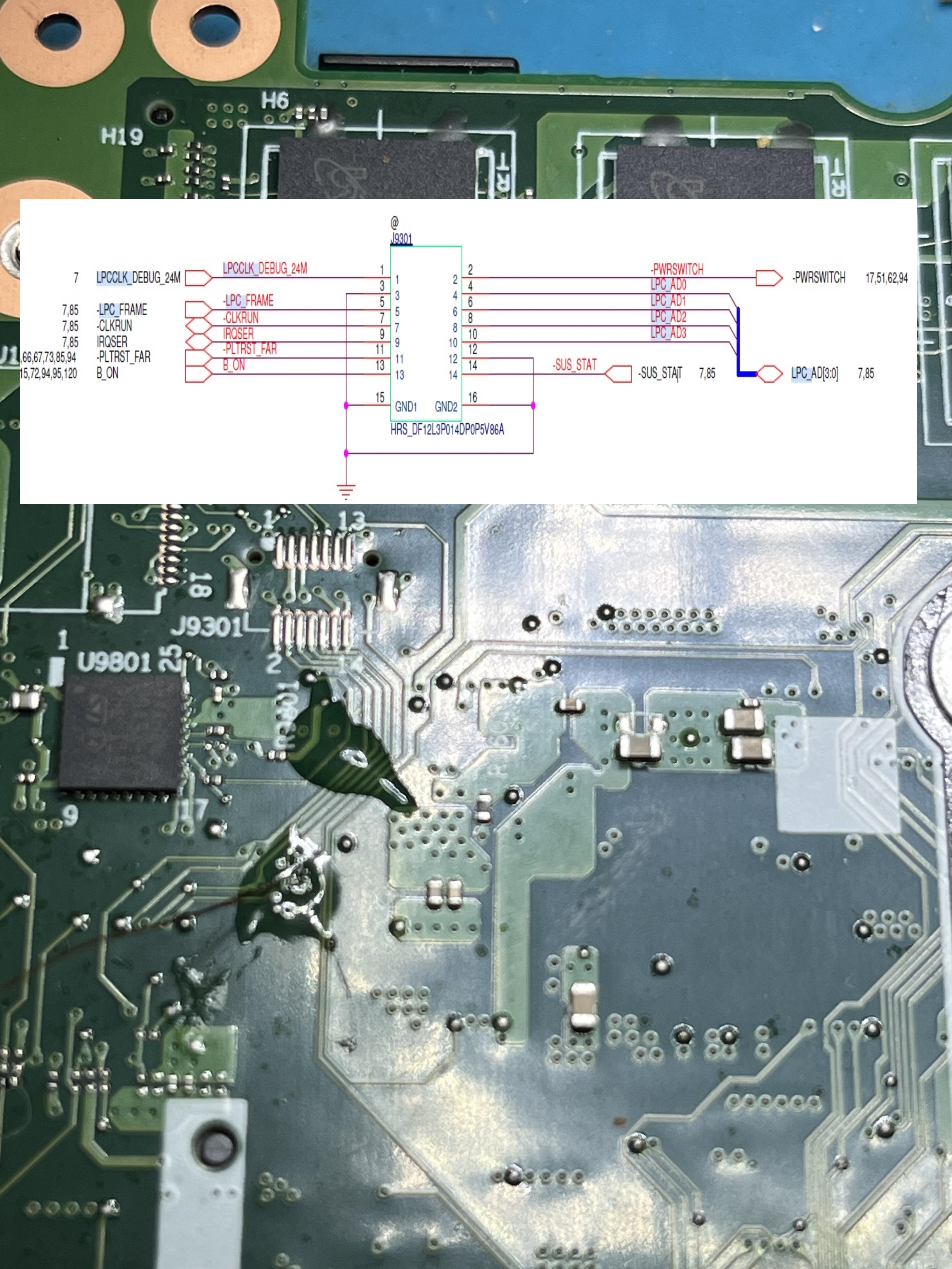

              #46
              i have thinkpad t14s moterboard nm-c891 with password please help me
              • Maxpower3
                Bad Veteran
                • Feb 2018
                • 1358
                • France
                #47
                try one wire (lad0-3) with Gnd
                wait for the backlight,before logo.wait 1-2 sec with contact ,release and press f1 to enter setup
                errors can occur
                EC can be corrupted if you save wrong info
                Clear supervisor password with twice blank
                and manager with twice blank password
                Clear security chip too
                After just Ctrl alt del and try​
                if Mec need many tries
                Click image for larger version  Name:	T14S X13 .jpg Views:	0 Size:	1.31 MB ID:	3250062

                  #48
                  Maxpower very much thanks for this simple method, today I was able to remove system management password combined with predesktop authentication with help of one microswitch on Thinkpad T490 NM-B901 MEC1633

                    #49
                    Originally posted by danito
                    Try
                    thank you sair work like charm with pad num 3 many thanks to you and maxpower

                                      I have some progress with T490 and MEC1663. Shorted LPC_AD0 to ground and sometimes i manage to get EAIA error 0187 and i got into BIOS with only 2 tabs - Config and Date/Time. Tried many many times with AD1,AD2,AD3
                                      Am i missing something?
                                        This happens to me too,
                                        change the timing and start earlier just before backlight and stays short for less time.
                                        Mec16 is difficult
                                        many many tries
