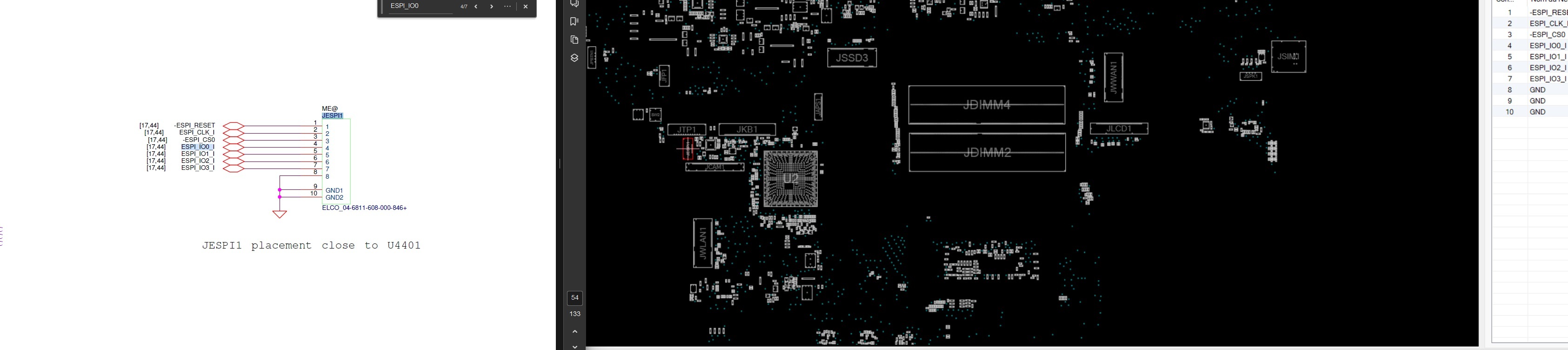

    I uploaded the schematic and boardview for p15/p17 g2
    in the schematics forum,
      https://www.badcaps.net/forum/troubl...ptor-blackbird
      P15 P17 Gen2 NM-D491 NPCX997KA0BX
      I have one to do, I will try soon

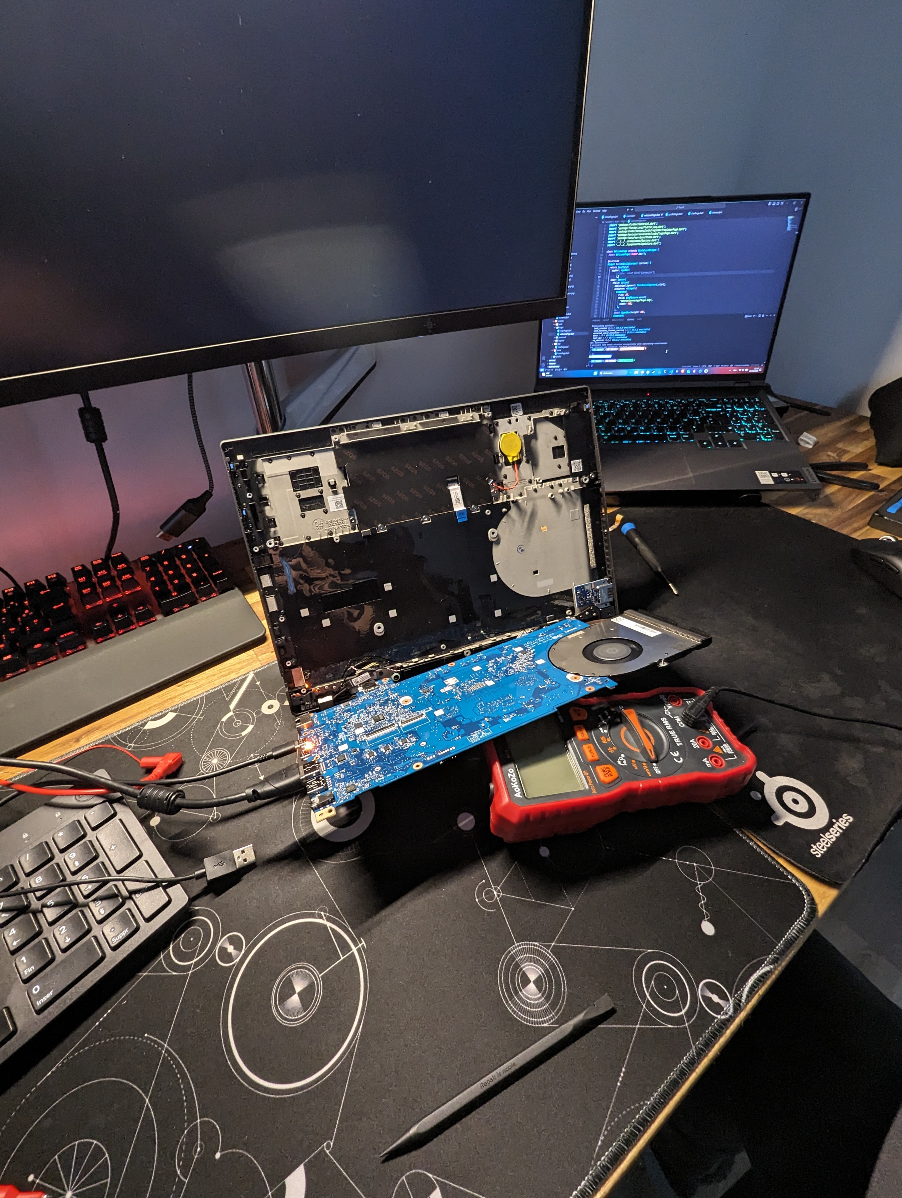

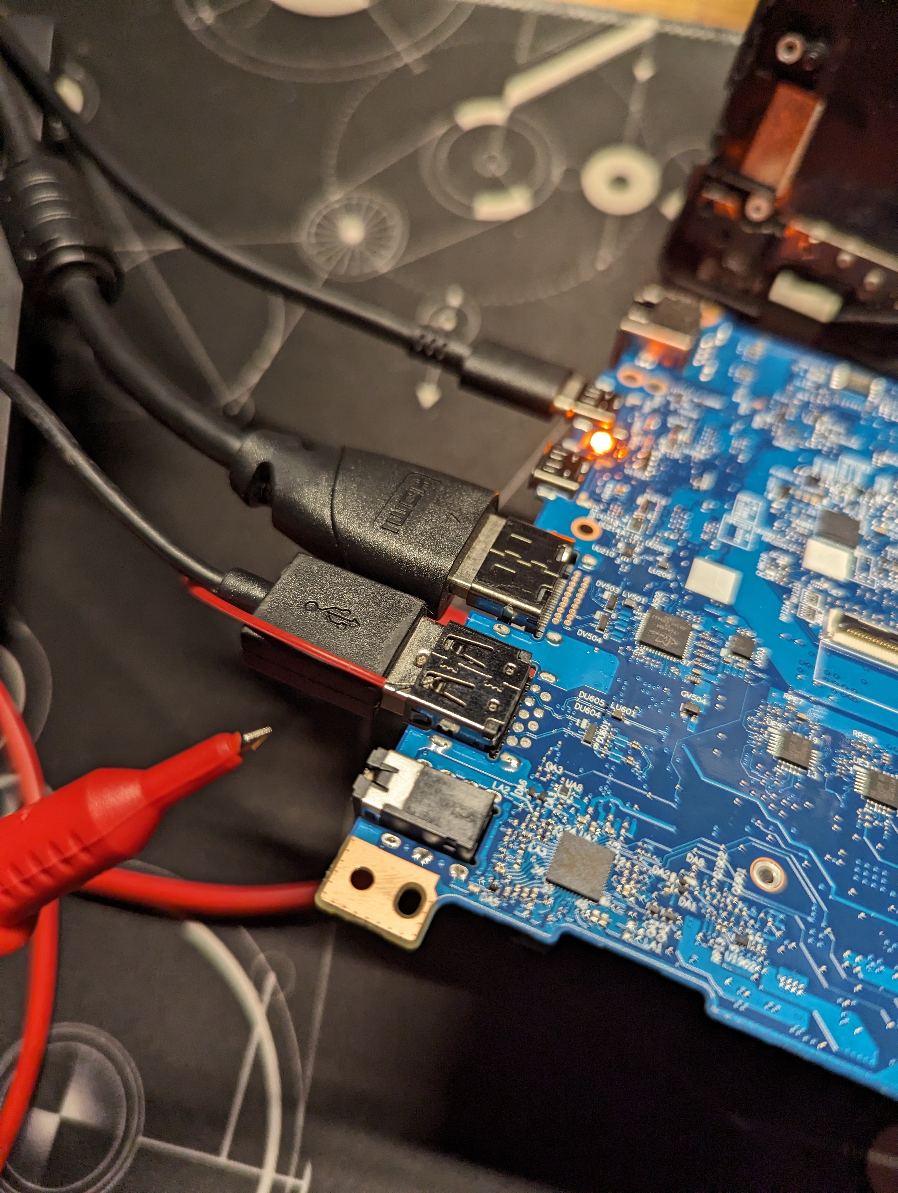

        try
        Unfortunately, it didn't work. I tried both but no success.
        I don't know if my "ground" is really good so let me know if I need to change it.
        I think the issue is probably the timing because sometimes (2 times on the +50 I did) I got error message (two times different) but the other tries were just normal.
        In the video, you have a lenovo startup screen and then you do the magic trick, but me, I don't have the first lenovo "Entering setup" image so I can't refer to that.
        I don't know if you have any tips or something else but I'll gladly take it.
          if you have mistakes, it's a good sign. you have to keep trying.
          check your pencil, it may be cut in the wire.
          maybe
          https://www.badcaps.net/forum/troubl...32#post3257932
          or try test connector JESPI1 with pin 2/3/4 or 5 with pin 6 Gnd
          https://www.badcaps.net/forum/troubl...82#post3274982

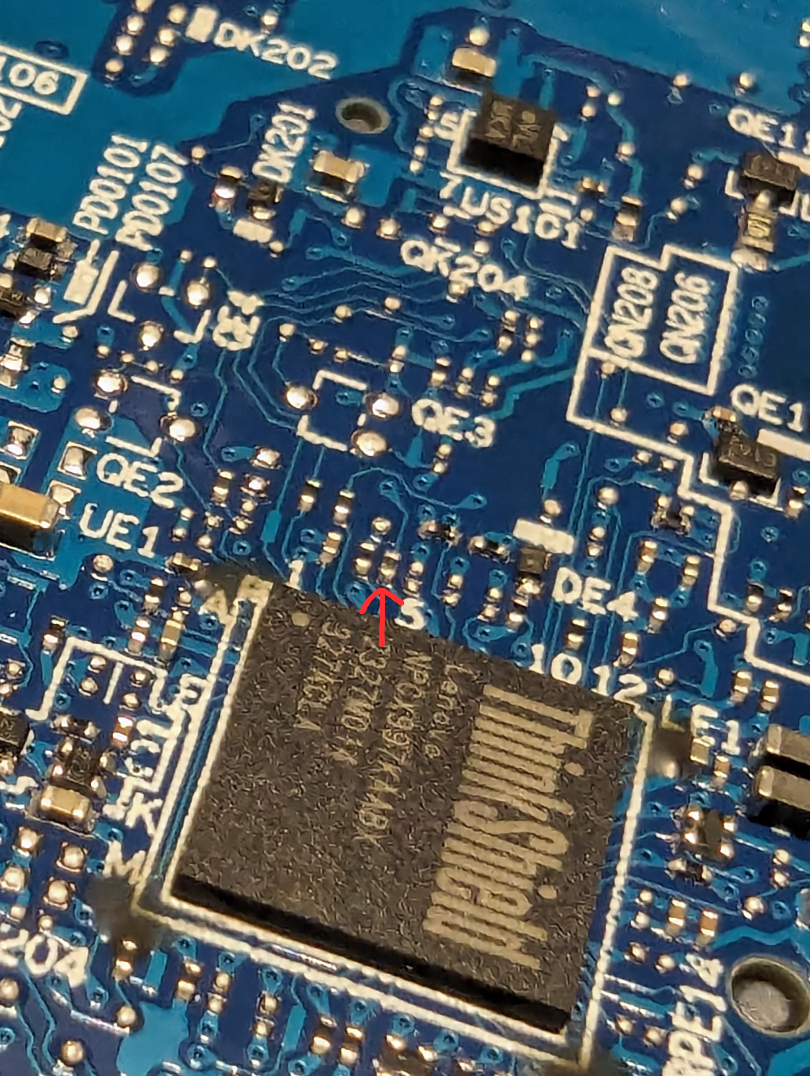

                    Maxpower3​, I have ThinkPad P15 Gen 2 with SVP
                    I shorten any pin ESPI_IO0..3 , but after it freez

                        Originally posted by CraterM
                        X997 not work
                        I tried this morning, didn't work, freeze on P15 NM-C651 NCPX897​

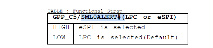

                          I think the problem is which interface is used LPC or ESPI.
                          NM-C262 (NPCX897) use LPC - work https://www.badcaps.net/forum/troubl...46#post3274946
                          NM-C651(NPCX897) use ESPI - dont work , freez https://www.badcaps.net/forum/troubl...69#post3276369
                            I tested with 1.8v instead of gnd, but continues as normal. no error or freeze

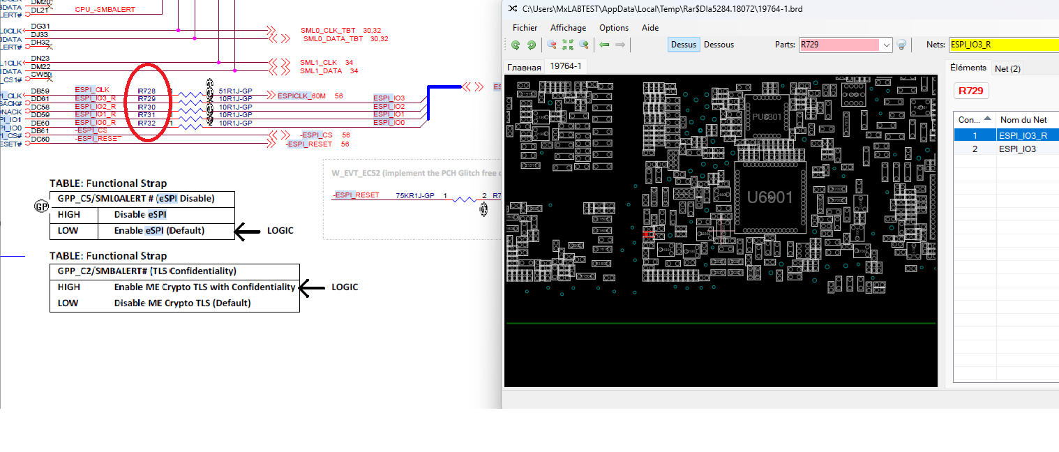

                                  what would happen if we disable the espi ?
                                  • Maxpower3
                                    Bad Veteran
                                    • Feb 2018
                                    • 1315
                                    • France
                                    #137
                                    I believe he is testing injecting 1.8v on
                                    P15 NM-C651 NCPX897
                                    exact
                                    here?
                                      I haven't tried. Do you think, I should try Disable ESPI. In my NM-D491 , I must add resistor R1310. This is right?
                                      • Gernet
                                        • May 2021
                                        • 60
                                        • Italy
                                        #139
                                        I have installed resistor R1310 =Disable eSPI= on my NM-D491.
                                        But no initialization - nо image and Fan on max.
                                        Next
                                        I remove R1310 - there is initialization and image.
                                        Maybe on NM-D491 not possible use LPC.
                                        • Gernet
                                          • May 2021
                                          • 60
                                          • Italy
                                          #140
                                          PCH Tiger Lake dont have LPC? 🤔​
