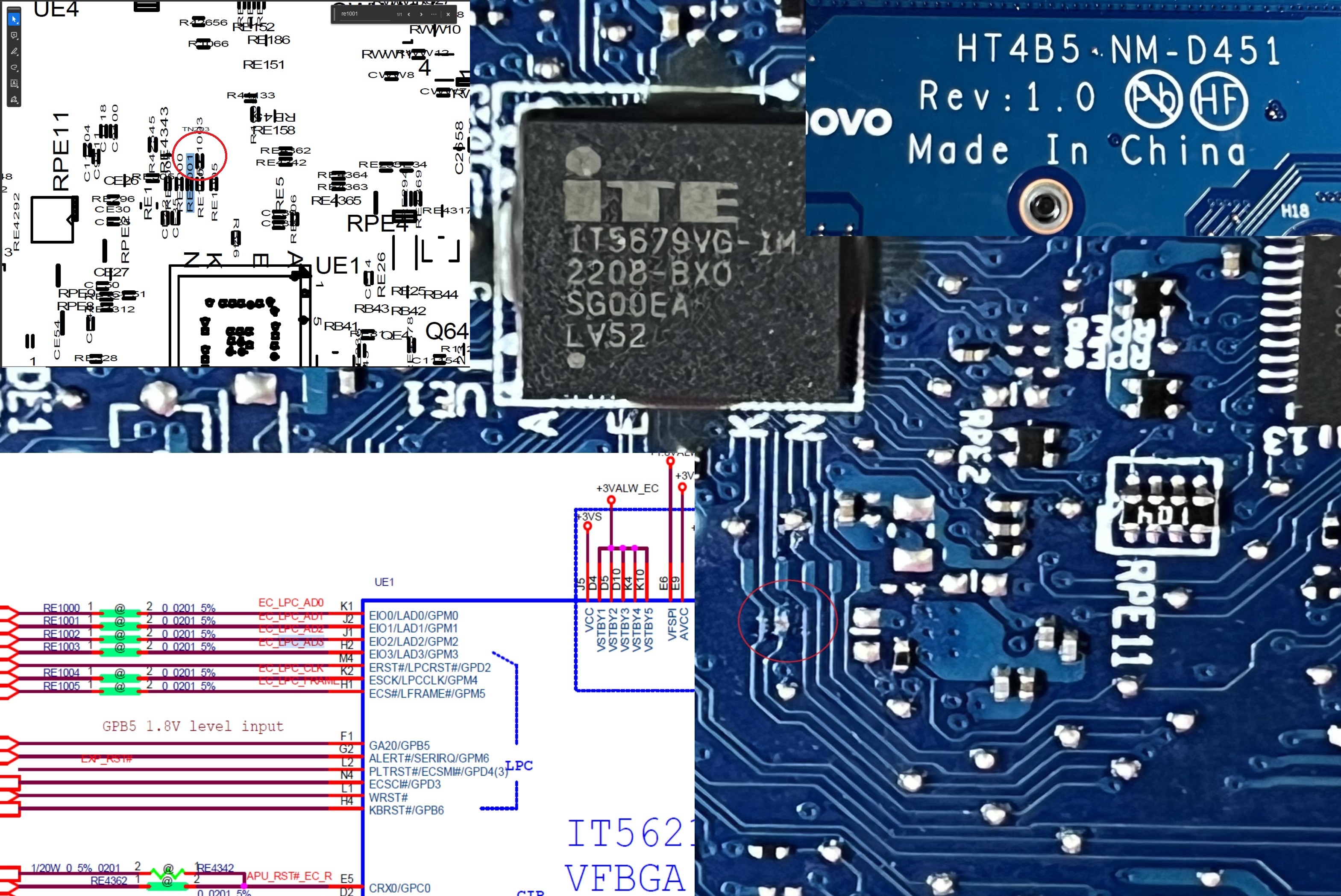

    T14 Gen2 Amd NM-D451 IT5679VG
    Tested ok

      As written in another thread, L14 G2 AMD, NM-D391 + NPCE68B works fine

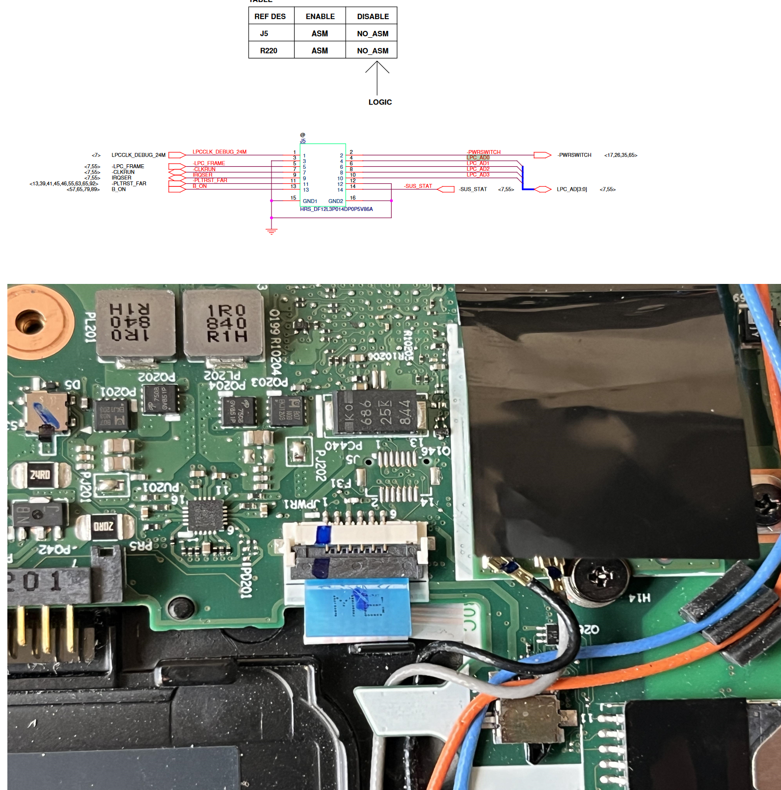

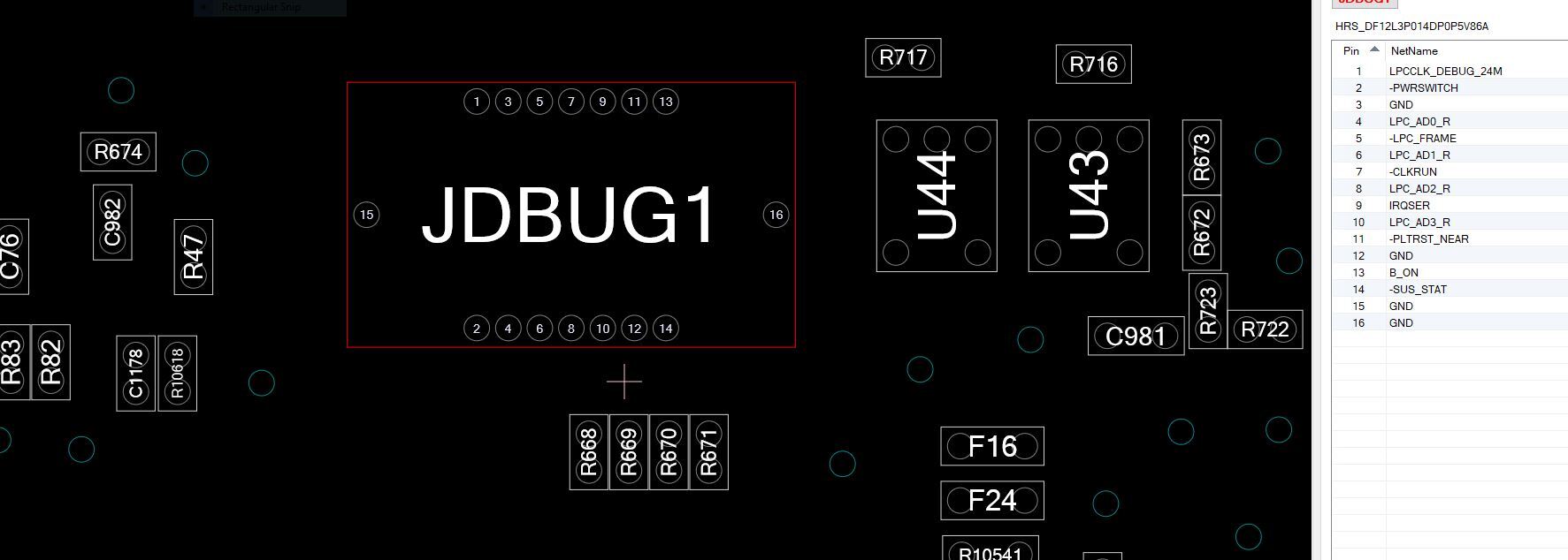

                I have a Thinkpad T15 Gen2 with mec1503. i can try to unlock if the pin is known to short.
                NM-D352 Board
                • Vesko356
                  Vesko356 commented
                  Editing a comment
                  Read post #1:
                  ...but my tests failed with the Mec1503
                  The LPC bus is no longer used, it has been replaced by eSPI

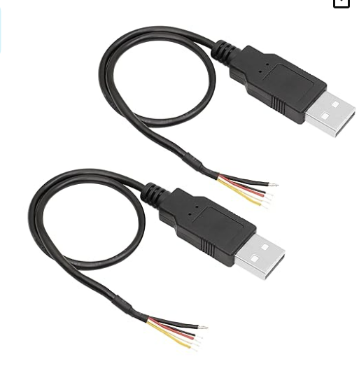

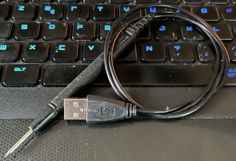

                      Where can I buy a cable with one end USB type B and the other end a pen/stift?
                      For shorting are you holding the pin on GND already when starting up the laptop and then releasing it at a certain moment while keep pressing F1. It is not clear to me when exactly releasing the pen?
                      I suppose it doesn't matter to use GND1 or GND2?
                      • Maxpower3
                        Bad Veteran
                        • Feb 2018
                        • 1316
                        • France
                        #32
                        Do it yourself
                        wait 1-2 seconds after turning on or wait for the backlight.
                        make the contact, wait 1or2 sec, release.and,press f1
                        Sometimes you may get a fan error which turns off the PC, sometimes you can bypass it by pressing Esc.
                        other error may occur bad data /uuid /serial etc..this is good sign
                        just the timming doesn't is not good
                        The method depends on the Ec (timings are different)​, it takes several attempts before you succeed and understand.

                                For making the cable yourself. I do not known what to do.
                                Can I take for example the following piece and just take the red cable of it and connect the red wire (+5V) to a probe? And cutting off the 3 other cables?
                                Links:
                                https://shorturl.at/vAFI9
                                For connecting the red cable to a probe do something like in the following video?
                                How to make the best DIY back probes in 2 minutes.
                                  • 21604
                                  #37
                                  Links:
                                  Thats overkill, you can just use a piece of wire or even tweazers
