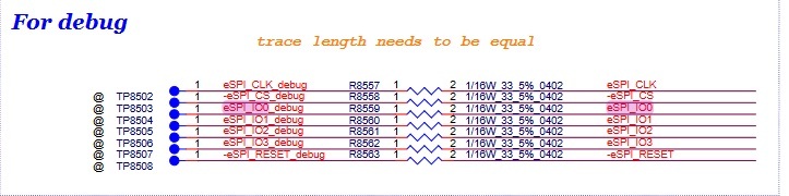

        Originally posted by LASTname
        HELLO SIR, whoever addresses you with the utmost respect is a humble follower of your work...I would like to ask for your help...it can be done on a L14 GEN 1...i5 10th...THANK YOU VERY MUCH​
        Thinkpad L14 GEN 1 - GL40-GL5A0 NM-C631
        try
Name:	Thinkpad L14 GEN 1 - GL40-GL5A0 NM-C631.jpg
                    try

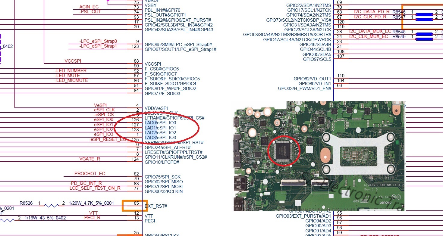

                    I tried to understand the image but it is too advanced for me... when I saw his video on YouTube bypass 2 minutes... where it seems that he uses a jumper by touching 2 points and breaks the bios key... I thought it could be done like this as the video... I don't know how to read schematics, I'm very new to that level...
                    • LASTname
                      • Apr 2024
                      • 10
                      • PERU
                      #70
                      I found that it has 2 bios.. I attach photos.. thinkpad L14 i5 10th bios paswoord
                        1 wire to ground on one of the points following 1 or 128/127/126 of your choice
                        at startup as indicated in previous posts
                        EC : NPCE68AP
                        L14/L15 gen1 GL40-GL5A0 NM-C631
                        of course, check that the diagram matches

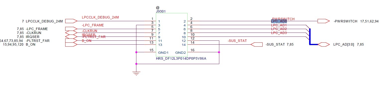

                        Click image for larger version  Name:	Thinkpad L14 GEN 1 - GL40-GL5A0 NM-C631.jpg Views:	0 Size:	372.8 KB ID:	3259076

                        Who has now used this technique and is satisfied with it here ??
                          EC : NPCE68AP

                          It took me a while to disassemble because the keyboard is somewhat difficult to remove... before trying anything I preferred to consult and thus have safe advice... am I going to connect the ground jumper to 128? for 3 seconds straight? or how should I do it? thank you master!
                          ​​​​​​I leave images so that someone else can help

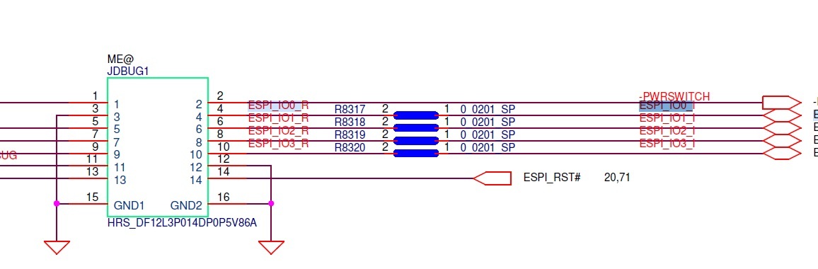

                            Click image for larger version  Name:	Nouveau Image bitmap.png Views:	0 Size:	6.76 MB ID:	3259195
                            Connect your motherboard to an external screen or with the original LCD, being careful.
                            Uses a USB keyboard to make things easier and avoid communication problems with the KBC(Ec)
                            Prepare a ground wire.
                            When everything is ready.
                            You must put a wire on the ground and make a light contact (1 -2 seconds should be enough).
                            If too long, errors occur : Fan error, Bad data, Thermal sensor etc ... and power off​
                            Wait the Logo or just after the backlight.
                            Short contact with pin 128 or 1, wait and release
                            and press F1 to enter setup
                            After clearing security with blank password
                            and clear security chip.
                            Simply restart with Ctrl Alt Del
                            And test now
                            Warning:
                            Do not short before full startup (backlight), nor during shutdown.
                            Follow this carefully, otherwise there is a risk of bricking or corrupted data.

                                        Mec16
                                        look for j9301 if you have it
                                        https://www.badcaps.net/forum/troubl...61#post3250061
