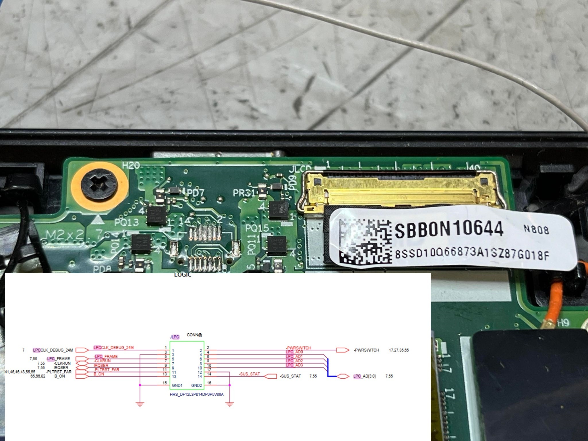

          try one wire (lad0-3) with Gnd
          wait for the backlight,before logo.wait 1-2 sec with contact ,release and press f1 to enter setup
          errors can occur
          EC can be corrupted if you save wrong info
          Clear supervisor password with twice blank
          and manager with twice blank password
          Clear security chip too
          After just Ctrl alt del and try​
          if Mec need many tries

          Hi i've had a question, should i connect lad 0-3 all together with one cable to gnd or each one separately? or maybe how to use button method? can you do me a favor and draw me a mor beginner schematic?
          Best regards, Staszek
          • EGUG
            • May 2024
            • 11
            • Deutschland
            #205
            @204: You only have to connect one of lad's to gnd.
