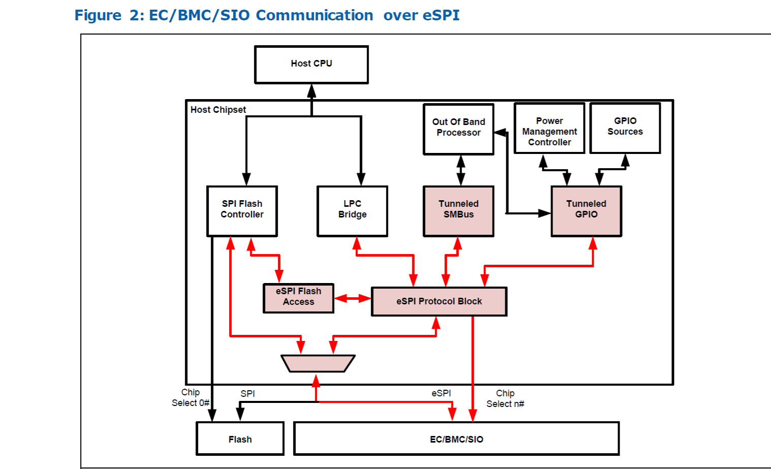

          I think the problem is which interface is used LPC or ESPI.
          Originally posted by Gernet
          I have installed resistor R1310 =Disable eSPI= on my NM-D491.
          But no initialization - nо image and Fan on max.
          I tried several things too, but without results

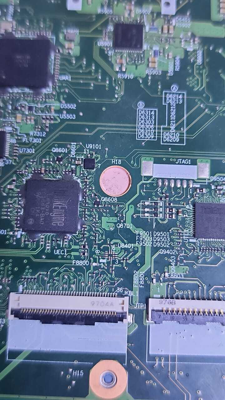

            about T14 gen 3 AMD NM-E441 rev1.0..locked with svp password ... I managed to remove this SVP password with test point in ESPI-IO3 and gnd . but instead of entering bios he asks for another password but not the SVP one . by clicking only on enter it can go into the bios. but password change is not accessible..

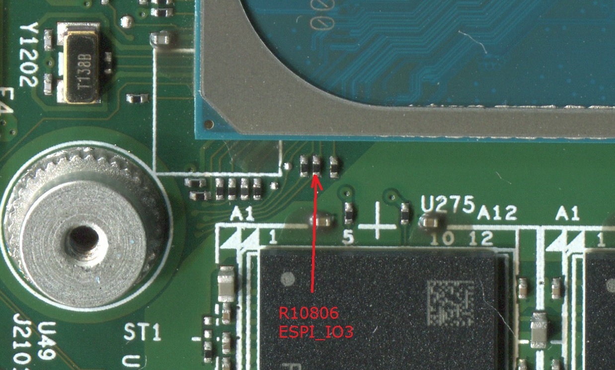

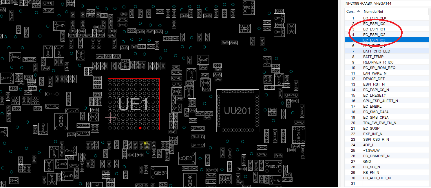

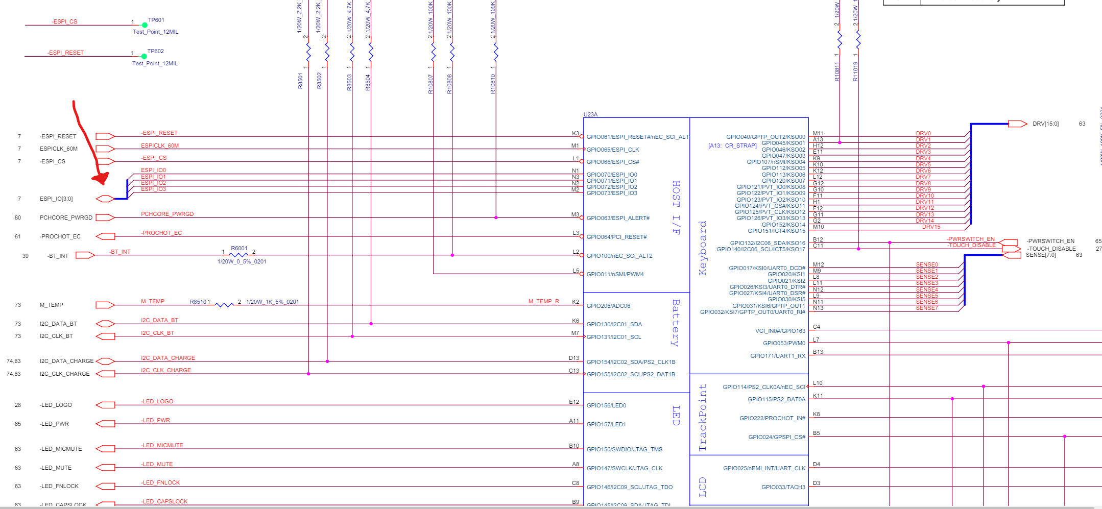

                    #149
                    hello ..IF somebody can locate ESPI_IO3 for NM-D341 X1 Carbon 9th Gen . TO test somethinq. thanks in advance
                    • Gernet
                      • May 2021
                      • 60
                      • Italy
                      #150
                      Use shematics and boardview https://www.badcaps.net/forum/troubl...tic#post102868

                          #152
                          THANKS a lot for sharing test point .. unfortunatly didnt work.. .. i need the one who is close to MEC1503H....i have aleready boardview but not clair .
                          • feherhollo

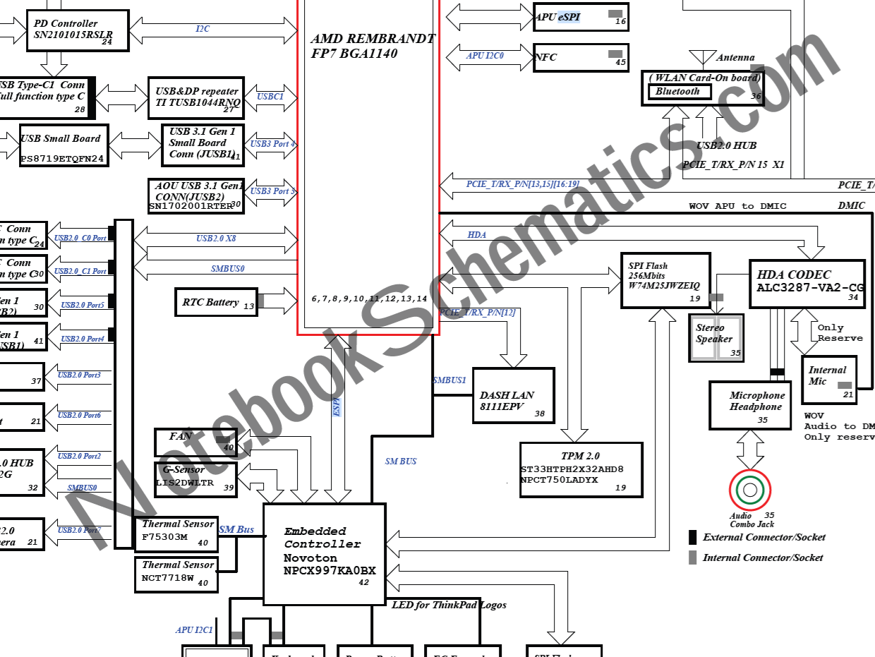

                                  try
                                  T14 gen 3 AMD NM-E441 with NPCX997
                                  try this morning ,not worked
                                  • Maxpower3
                                    Bad Veteran
                                    • Feb 2018
                                    • 1356
                                    • France
                                    #157

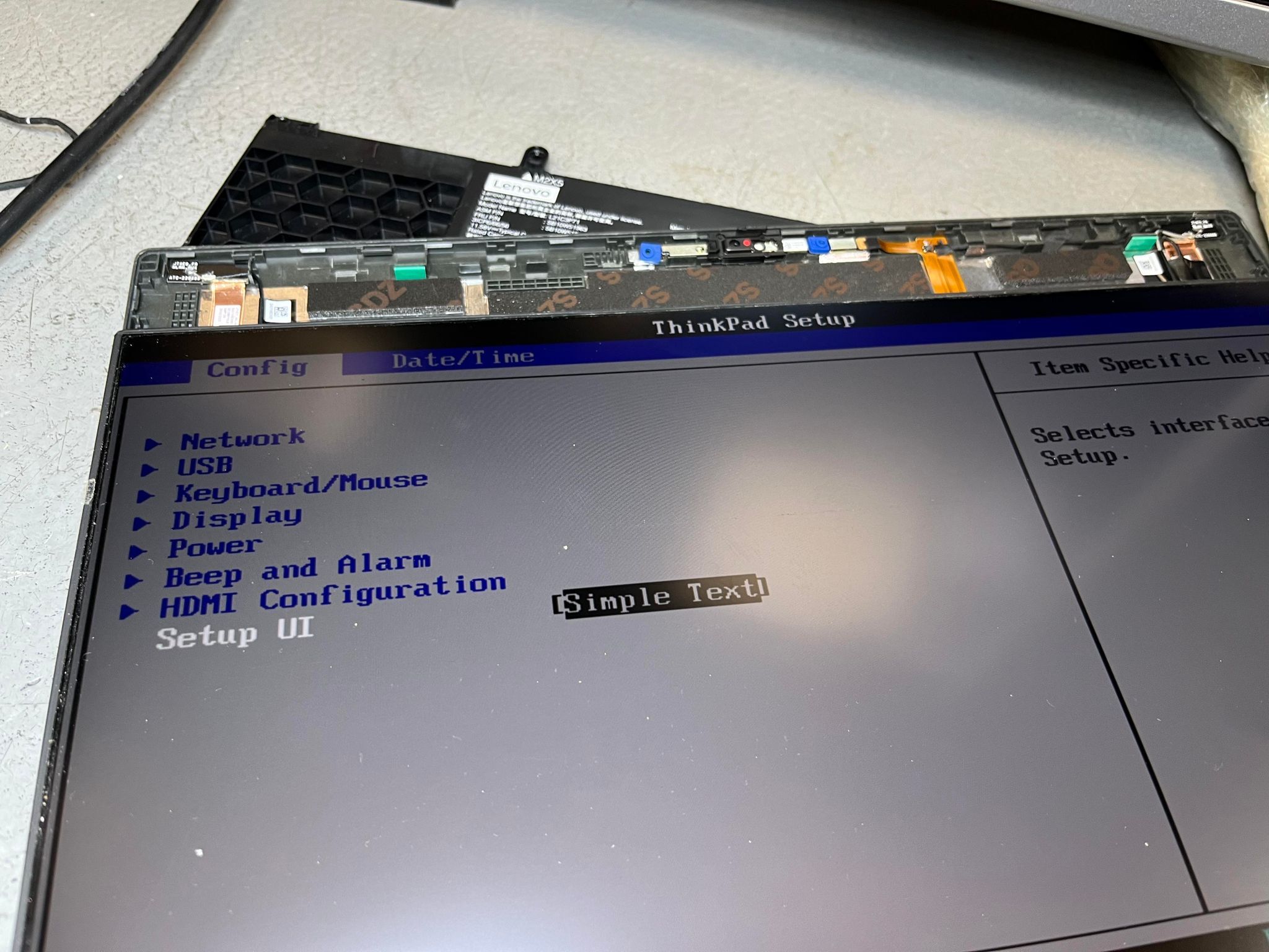

                                    edit

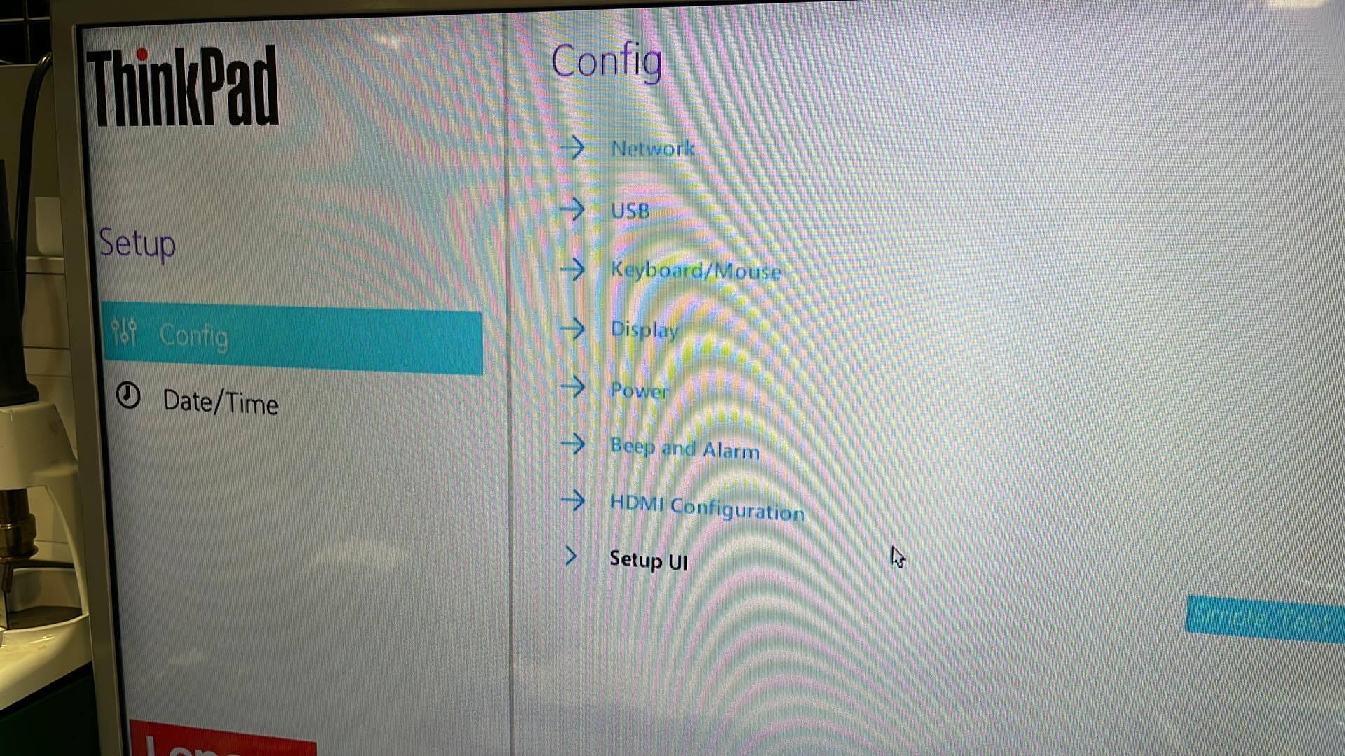

                                    after many try
                                    I managed to enter the bios, but the tabs are missing.
ID:	3279733 Click image for larger version

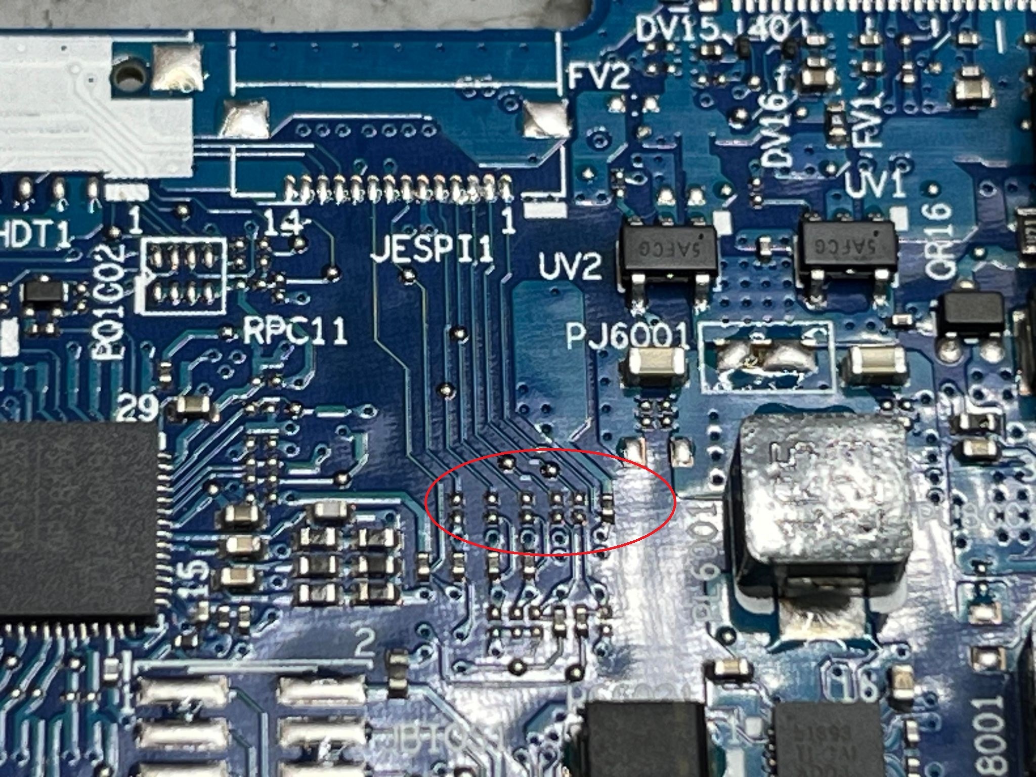

                                    The Espi connector is not connected, the resistors are missing
                                    so it must be connected near the EC
                                    I have to start very early to pass, well before backlighting.
                                    I have not yet fully understood how.
                                    I also managed to get errors like uuid or others
                                    not yet able to remove the password
