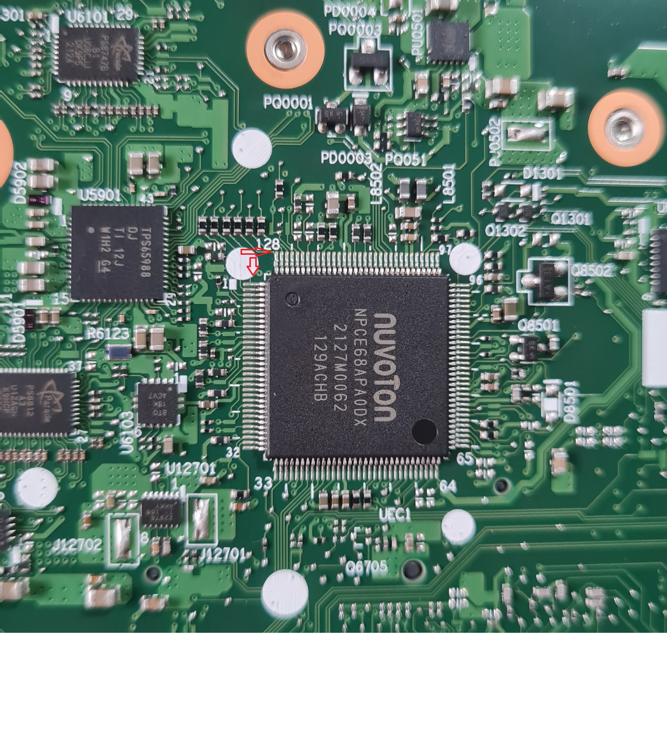

                          #733
                          Click image for larger version Name:	Nouveau Image bitmap.png Views:	0 Size:	6.76 MB ID:	3259195
                          Connect your motherboard to an external screen or with the original LCD, being careful.
                          Uses a USB keyboard to make things easier and avoid communication problems with the KBC(Ec)
                          Prepare a ground wire.
                          When everything is ready.
                          You must put a wire on the ground and make a light contact (1 -2 seconds should be enough).
                          If too long, errors occur : Fan error, Bad data, Thermal sensor etc ... and power off
                          Wait the Logo or just after the backlight.
                          Short contact with pin 128 or 1, wait and release
                          and press F1 to enter setup
                          After clearing security with blank password
                          and clear security chip.
                          Simply restart with Ctrl Alt Del
                          And test now
                          Warning:
                          Do not short before full startup (backlight), nor during shutdown.
                          Follow this carefully, otherwise there is a risk of bricking or corrupted data.

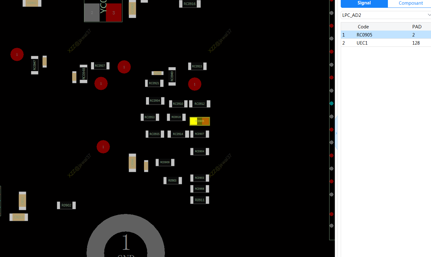

                          • jawal37
                            • Feb 2013
                            • 41
                            • afric
                            #734
                            LPC_AD2 WORK GOOD IN RC0905 NEAR PROC
                              • 21582
                              #735
                              What model is that ?
