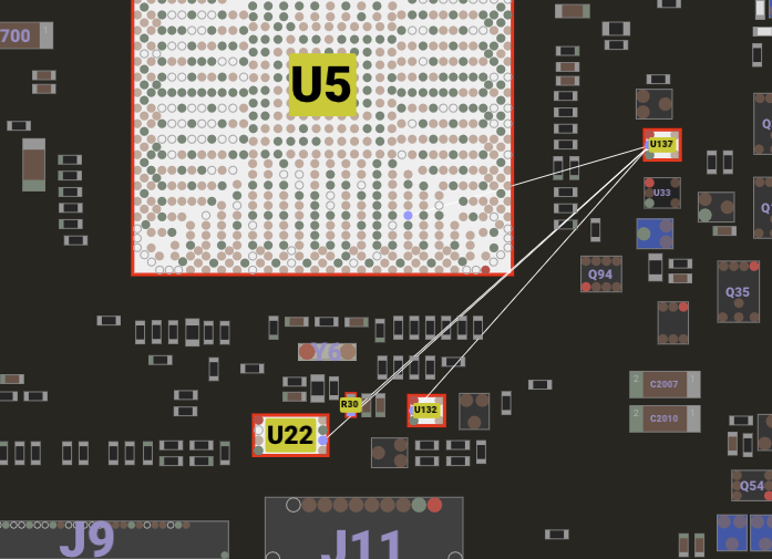

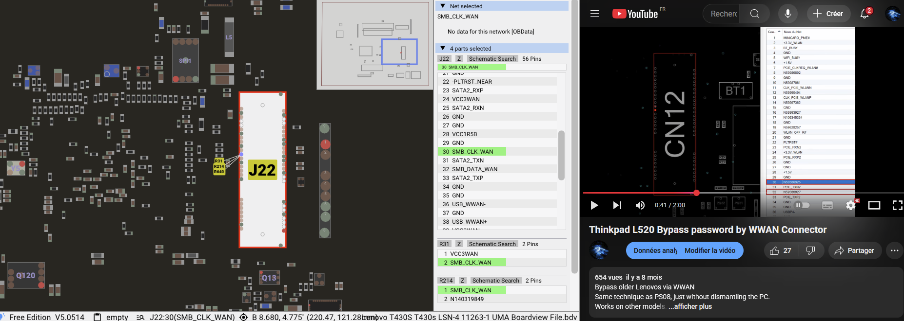

      Originally posted by Andreasbest
      Anyone had success on T430s?
      look u22
      Click image for larger version  Name:	t430s.jpg Views:	5 Size:	377.7 KB ID:	3726367
      Click image for larger version  Name:	image.png Views:	0 Size:	141.1 KB ID:	3726373
      try short Pin 30 and 32 of WWAN port
